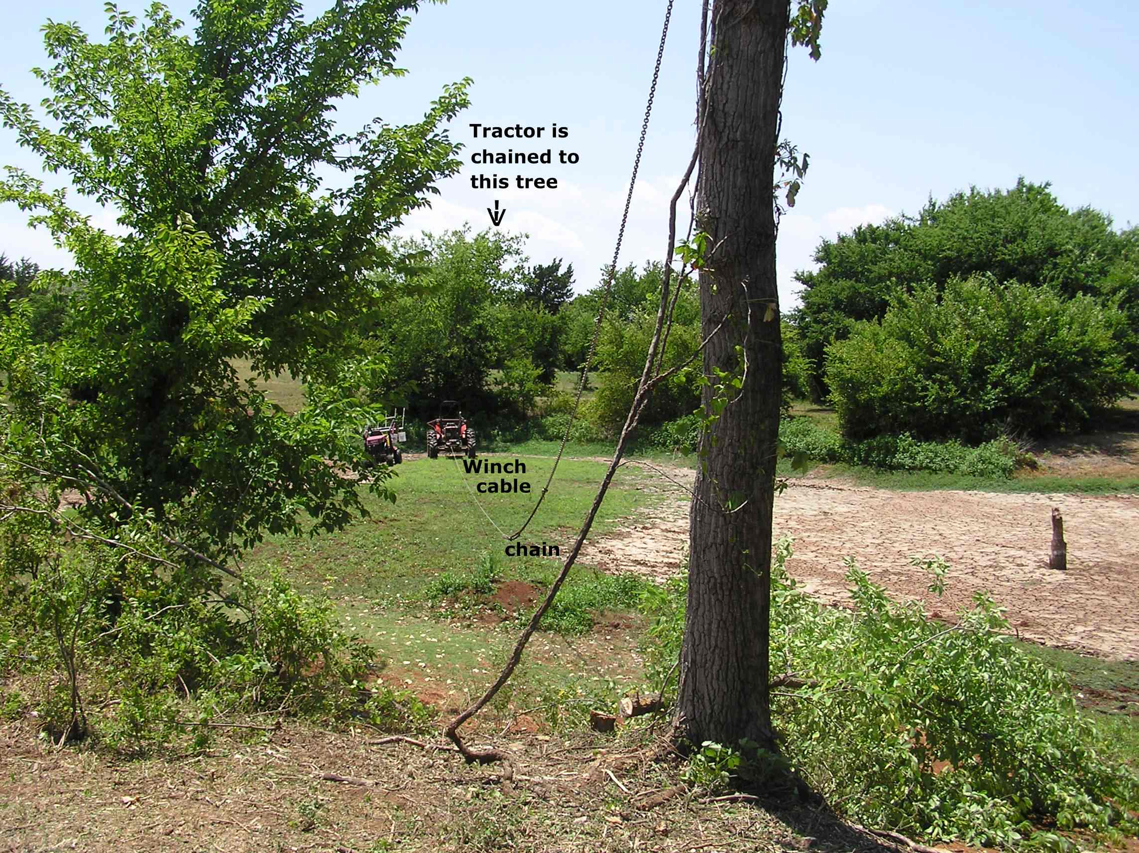

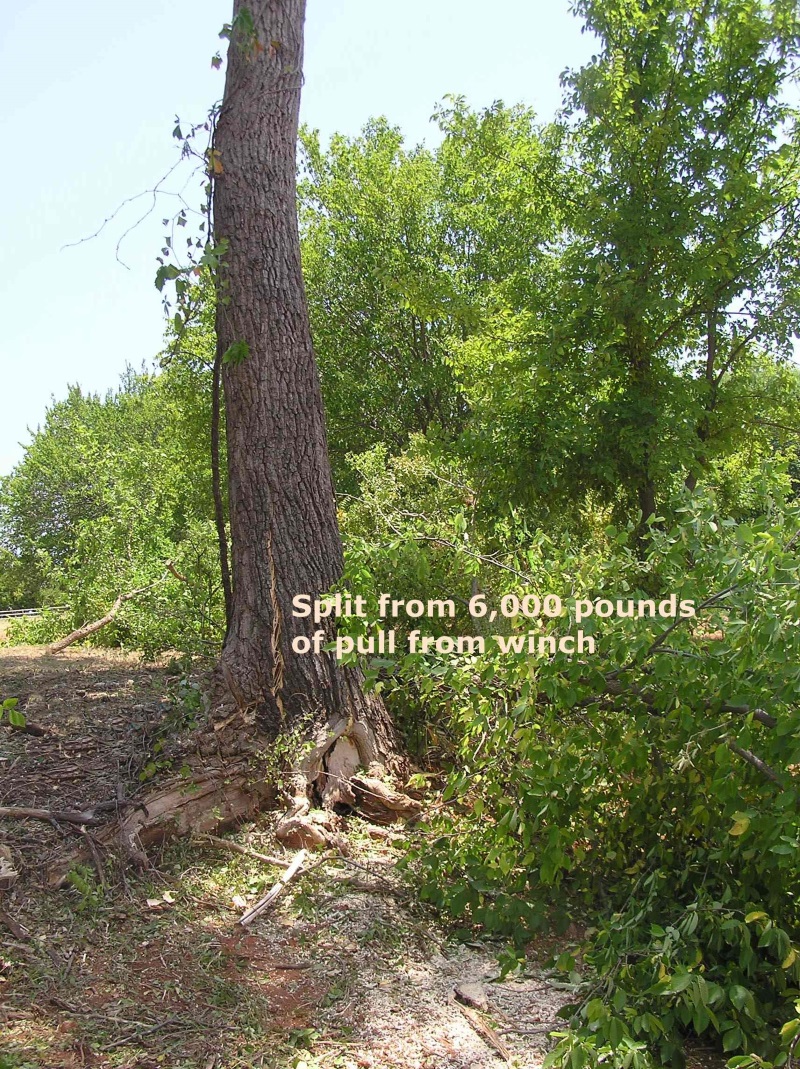

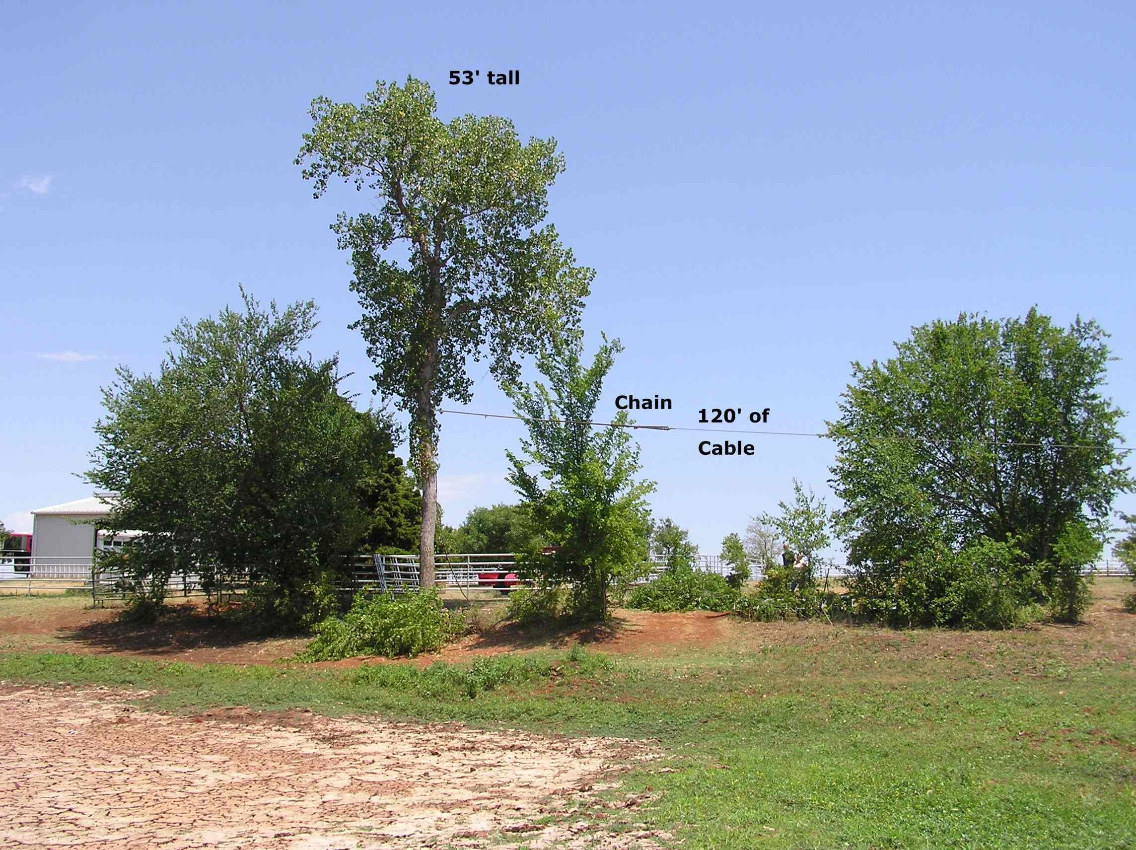

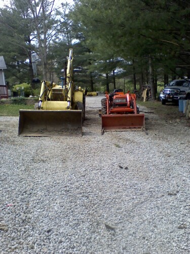

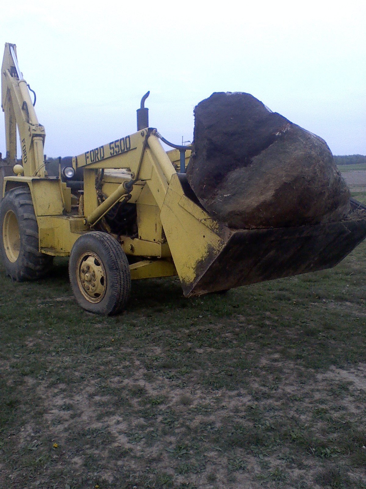

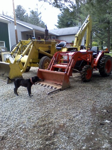

I realized that big boulder I lifted with the backhoe (which only has 4500# lift to max height) didnt really have anything to reference the size. The bucket is alot bigger than it looks.
Here is my 5' standard kubota bucket next to the 5500 bucket.
So that should give some perspective to the size of this boulder
A loader than can only lift 4500# shouldnt have made that lift. But my breakout spec (lift cap at ground level) is 8000#

Got an estimate on the weight of that boulder? Looks real close to the size of the one I moved.
How far forward do those forks tip? I have always though one of those would be awesome at stumping. Tip forward and drive the forks under a stump and pop it out. For their size, forklifts have enormous lifting capacities.
Ever had it buried?
/ How much does that log weigh? #155
After all this discussion I feel compelled to buy a big scale!
/ How much does that log weigh? #156
I'm thinking 6 to 7 tons for that boulder... to me it looks quite a bit bigger than the one in the bucket of your TLB.
/ How much does that log weigh? #157
/ How much does that log weigh? #158
Thats why judging from pictures is hard. To me it looks similar, using the guy on the forklift as a reference.
The one in the bucket of the ford I posted, is a little over 6.5' long. My bucket on that hoe is 6.5', and it is wider than that. It was touching the far side, and hung over a tad on the near side. IIRC, it was about 36" wide, and the height is kinda tapered. The Near side in the picture sticking out of the bucket is ~36" tall, and the far side maybe 24". The cutting edge to top of bucket is 32".
I figure somewhere between6000-7000 40-45 cubic ft. Granite being ~160lb/cubic ft.... 6000-7000# best I can guess.
The boulder on them forks appears to be ~6' long and about 3' high x 3' wide as well. Pretty close. But again, hard to guess the scale. Them could be 12' forks on that thing and a 10' long boulder....
The one I pictured is out by my parents flagpole, I'll try to get a picture of it later today with something in the picture for size reference.
