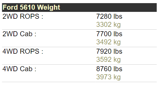

We have a 5610 Ford that weighs 13,600 empty. Yes, I weighed it. With tractor brakes I'd pull it. If you had brakes on the wagon, even better. Lock brake pedals together. Always remember, some people can mess up a soup sandwich. So you'll have to factor that in too. One person may do it all day, the next one will wipe out on the first trip.
/ How much can a John Deere 4440 pull? #7
5000 + #s of added ballast to shipping weight is A LOT OF added weight.
I agree with others that stated pulling 500 bushels is no problem but STOPPING that load is a totally different matter.
I agree with others that stated pulling 500 bushels is no problem but STOPPING that load is a totally different matter.View attachment 766652

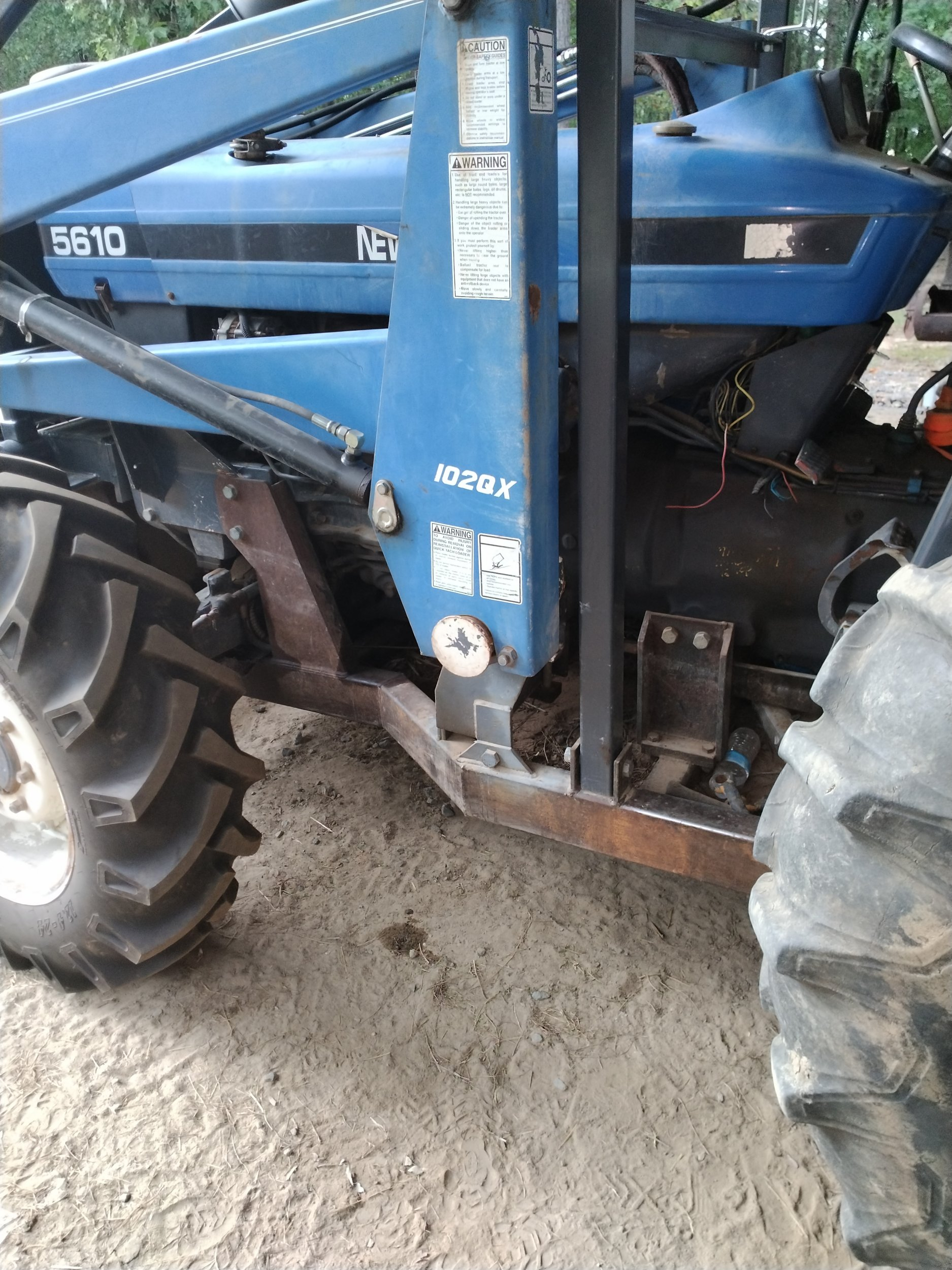

It's all in the weight. I had a neighbor pulling a 33' stock trailer jam packed with cattle, couldn't fit another one in it. He would come by in a short wheel base, regular cab, 4x4, Ford ranger, pulling that trailer in low range. We was pulling them cows and none of us even had a driver's license yet. Hauled square bales with a trailer and an old Chevy truck. Brakes wore slap out. Metal to metal. If you barely touched the pedal, front right tire locked up and skidded until we stopped, so we was always slow go with that rig.
But the 5610 does weigh that much. Filled 4 tires, belly pan, loader.

You must have a "very thick belly pan" on that Ford tractor.
3x6 runners, cab and all are 3/8 thick tubing. Belly pan is 3/8" plate. We wanted weight.
/ How much can a John Deere 4440 pull? #15
3/8 plate weighs 15.3 per #s per sq foot so an 4 X 8 sheet weights 489.6#s belly pan plus the attaching frame/hardware. That still requires a lot for weight for liquid ballast & FEL to achieve 13,600 #s total weight.
