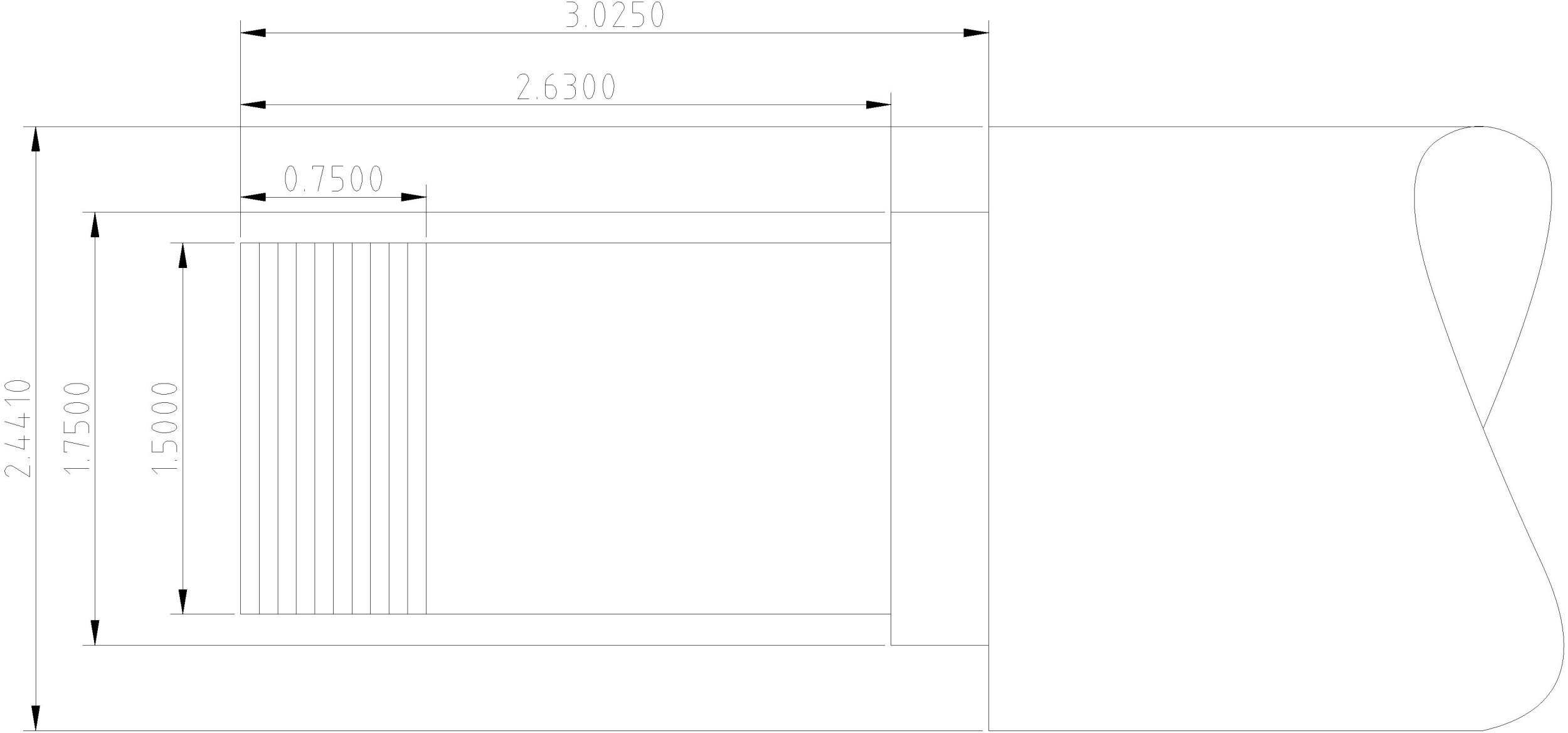

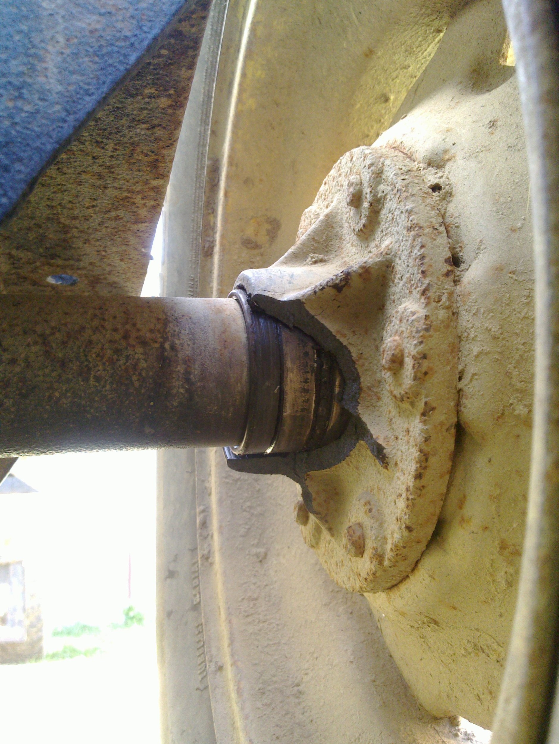

I need help identifying a John Deere wheel hub.
I am running out of ideas, and despite my pride, I think it's time to take my wife's advice and just ask someone.

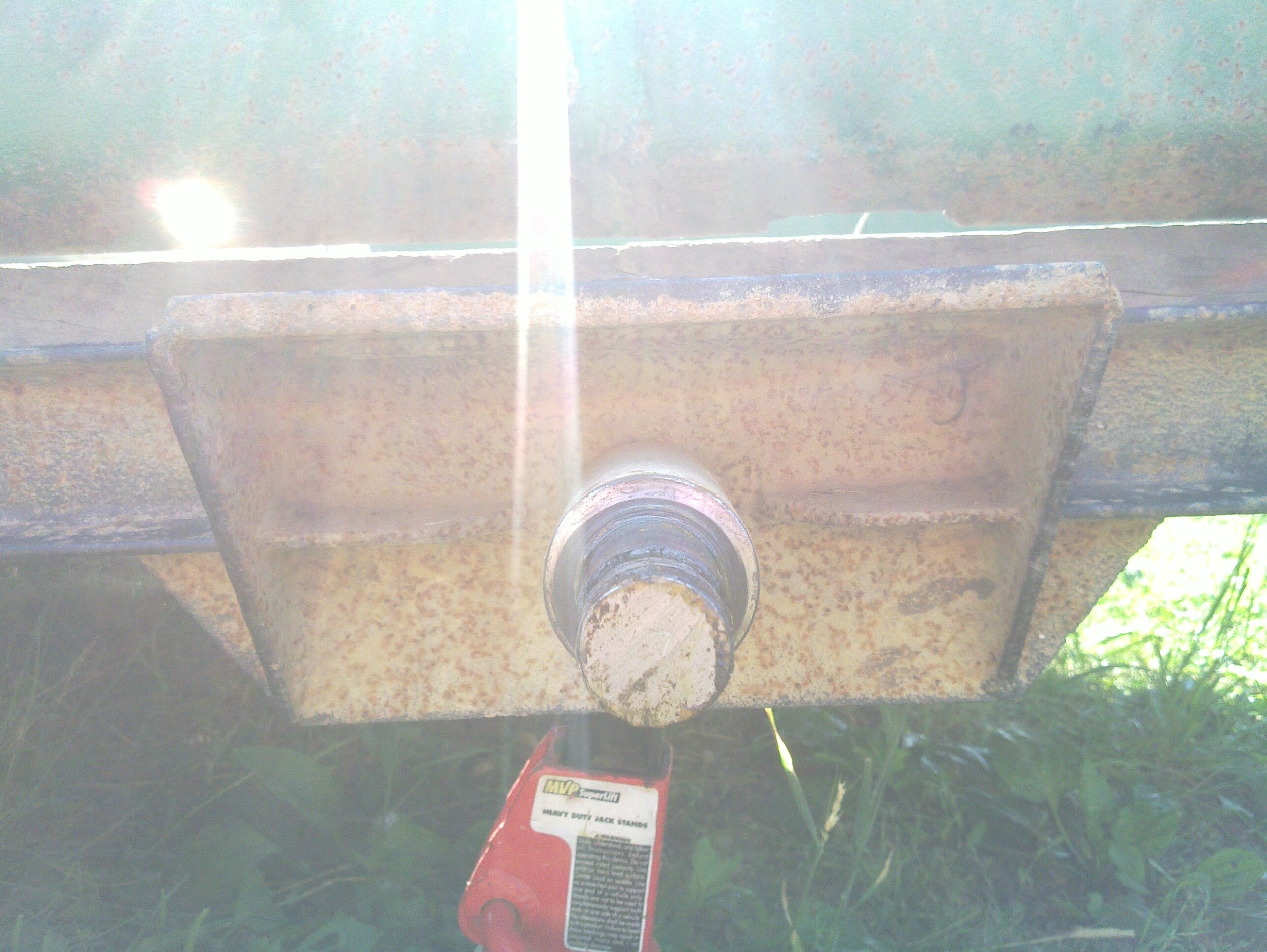

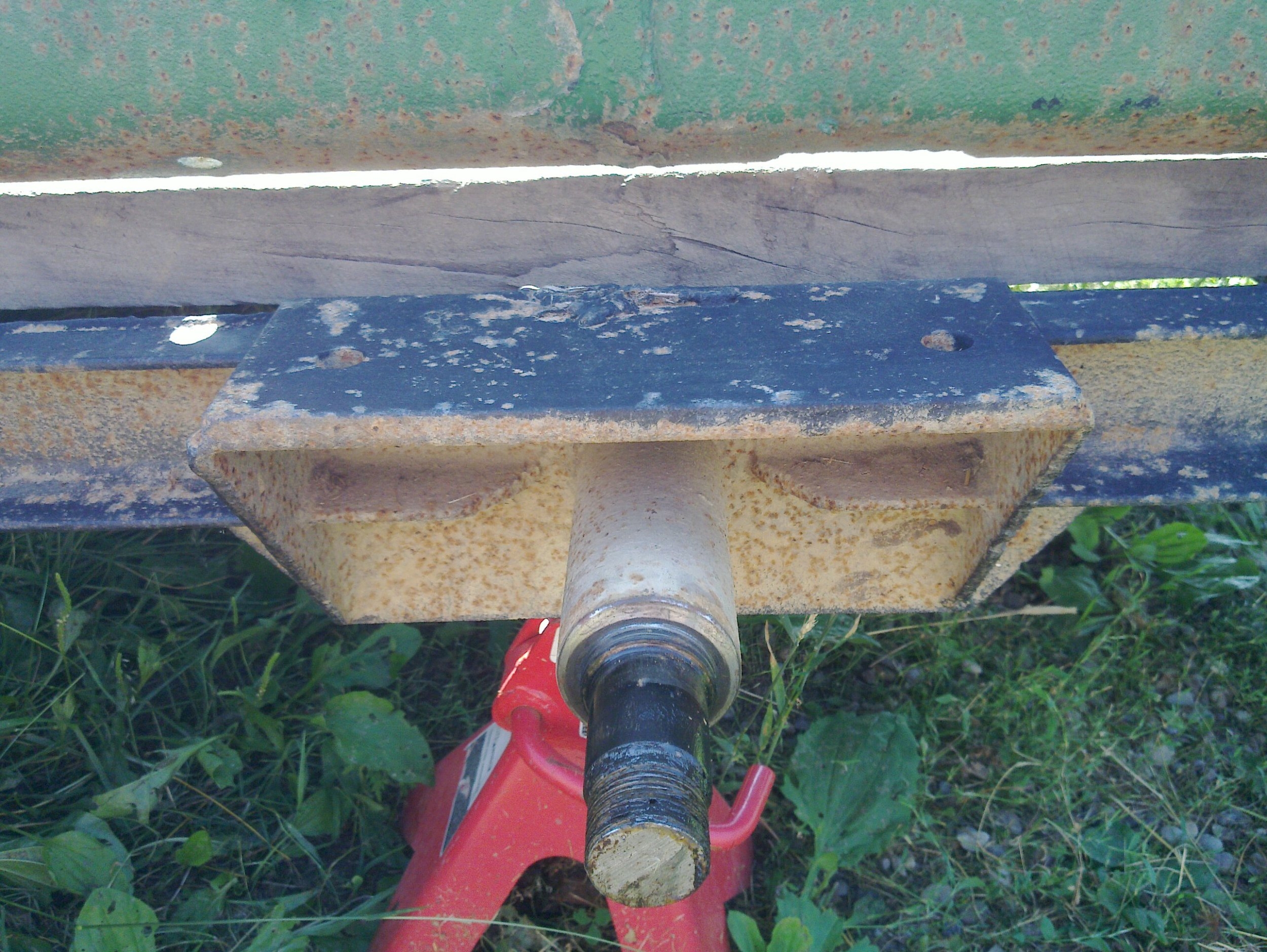

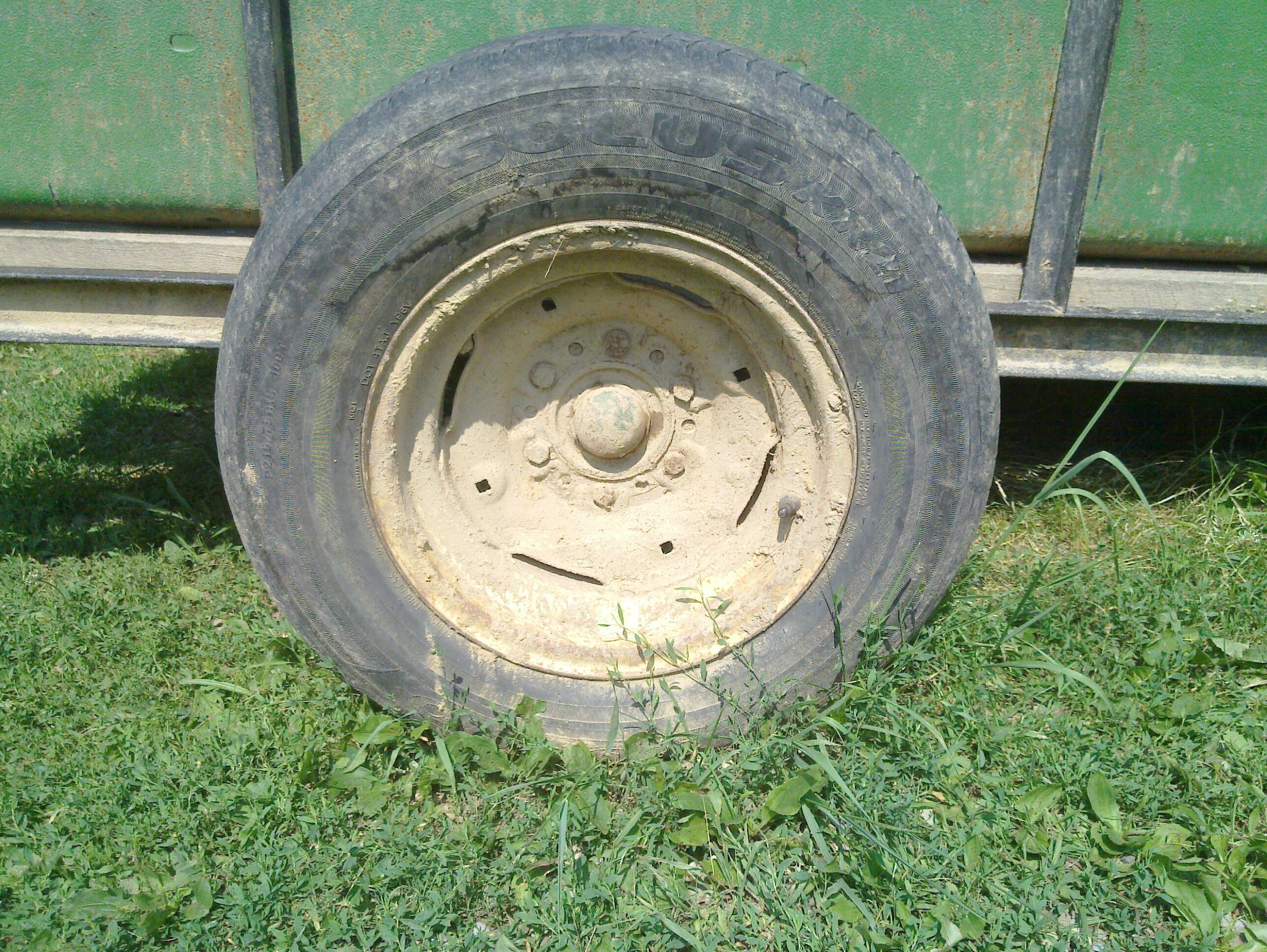

A wheel hub on a custom trailer, which has large sentimental value having been built by my late father, broke due to a freak accident. The trailer, with a full cord of red oak, was parked on a slight side incline when the downhill tire went flat and rolled off the bead. That caused the upper tire to be pulled downhill which broke the wheel hub. I was not present at the time, but I was told that there were some 'strange noises'.
The axle, hubs, and rims of this custom trailer were sourced from some piece of equipment that nobody in the family can remember.
There are no markings on the wheel hub to identify it such as a mold part number, but the remaining paint clearly identifies the hub as originally being from a John Deere something or other.
Trying to guess the equipment and checking whether the axle and hubs look similar has not been successful. I have checked the relevant parts on all derelict equipment that I, or anyone else, can remember my dad having(e.g. 16a chopper, lf-8 drop spreader), and I cannot find anything that looks remotely similar.

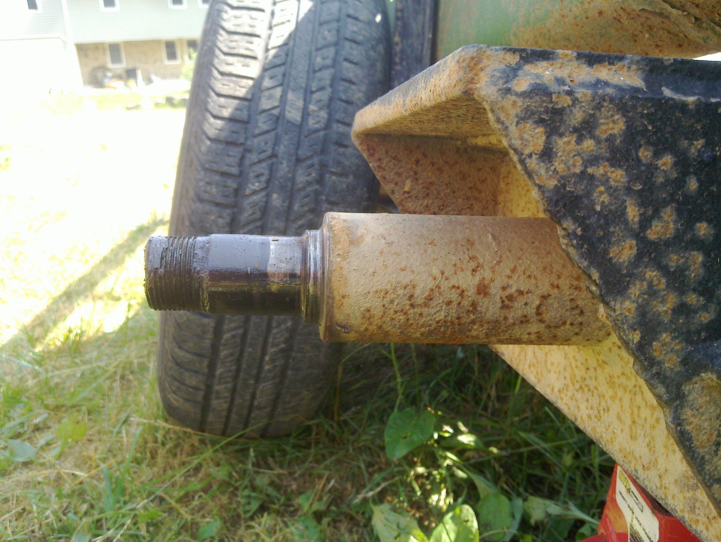

The axle is a single solid piece roughly 75" from tip to tip(could not measure directly) and still appears to have the original axle mounts.
The wheel hub has 6 bolts(1/2") on a 6" diameter. I measured 4.632" for the pilot hole, but there was considerable rust, and the true value is probably whatever the standard number is around 4.6".

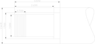

See the attached drawing(jpg) for the axle measurements.
Any sort of guidance would be appreciated.

Deere like most others was pretty good about having a number cast into the piece somewhere. You might need to get it really cleaned up or sandblasted to see it. That may help your ID

most times it was cast into the part, most you see are less that 3/8" type, no telling where they'd put it, I'd start on the back of the flat flange

It's been a year, and I've gotten nowhere. So I tried using AI, and it wasn't quite helpful, but it did give me the suggestion of looking at the bearing/race part numbers. The hub had a pair of LM29749 bearings matched with a pair of 14276 races.
I'm still not finding much on the internet, but I've got some hints leading me toward a non John Deere agricultural axle of some kind that was probably just painted in Deere colors. Electric wheel company seems to be popping up.
So I know the spindle dimension. I know the bearing and race part numbers. The trailer was fabricated in the early 1980s. So the axle is probably a decade or two older than then. How do I turn this information into a hub?

Bearing numbers won't do much good. They're pretty much universal within the size. I would have purchased a new hub before a year went by. Trailer parts can be had in many styles, sizes and loads. Or just take your hub into a trailer dealer and see if he can match the size and bolt pattern. There really aren't that many variations. Here's an example of a 6-bolt hub for less than $40.
/ Need help identifying John Deere wheel hub #7
I am very familiar with a hub failure exactly like that: John Deere 14T baler hub. Plunger side.
