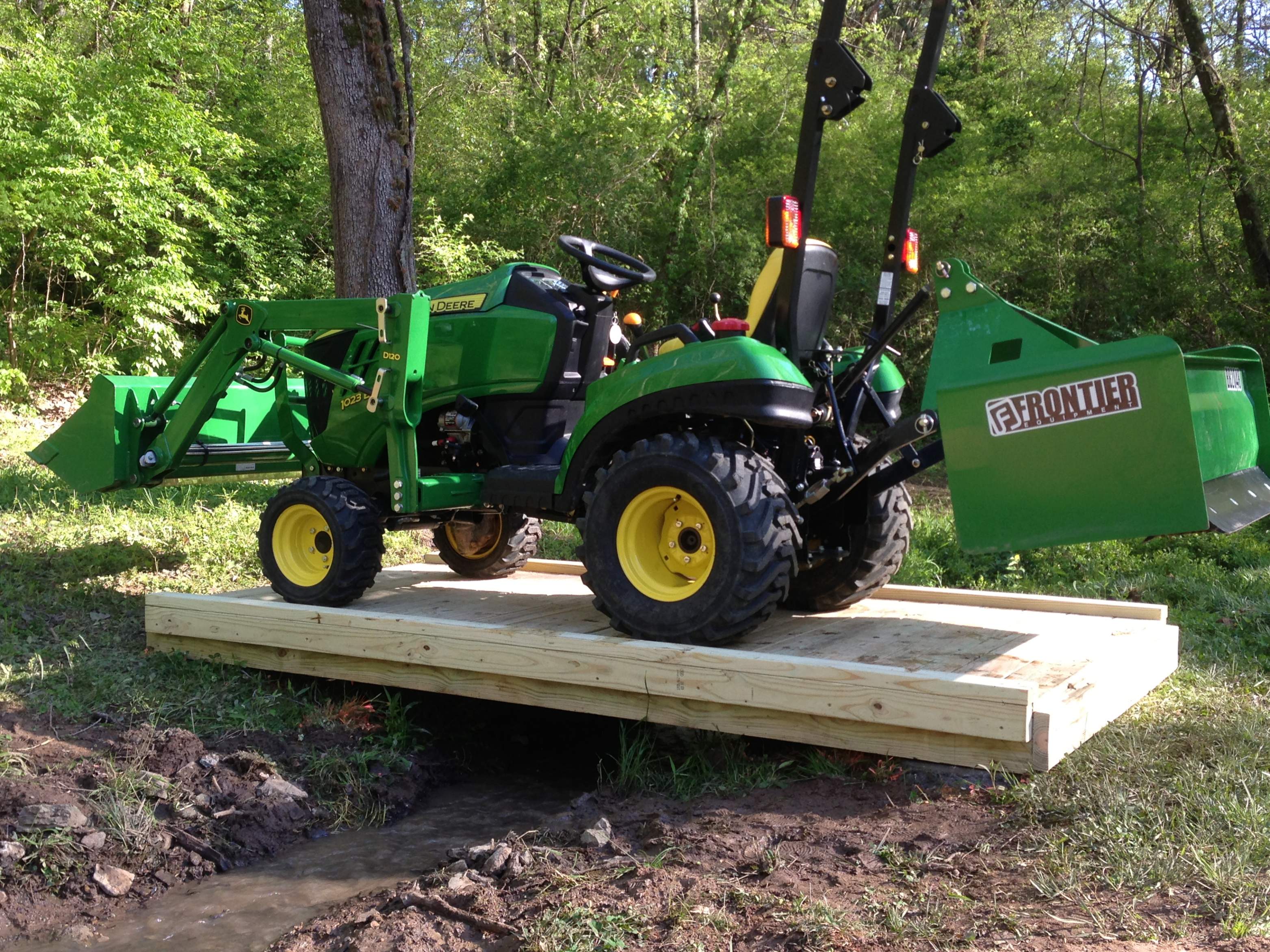

Here is the finished bridge, I need to put a load of gravel on the front and back to level it up a little.

I used (4) 6x6x10 pressure treated lumber. I set them on footers that I dug out friday night filling each one with 5 bags of 80lb concrete and bolted them down.
Total cost was less than $400
Darin

I see that pix above is your new bridge.. very cool.
James K0UA

Wow that was fast work, Bridge looks good !! a little dirt and gravel to ramp up to it and your all set. looks like that will last for years. and looks good too. !
