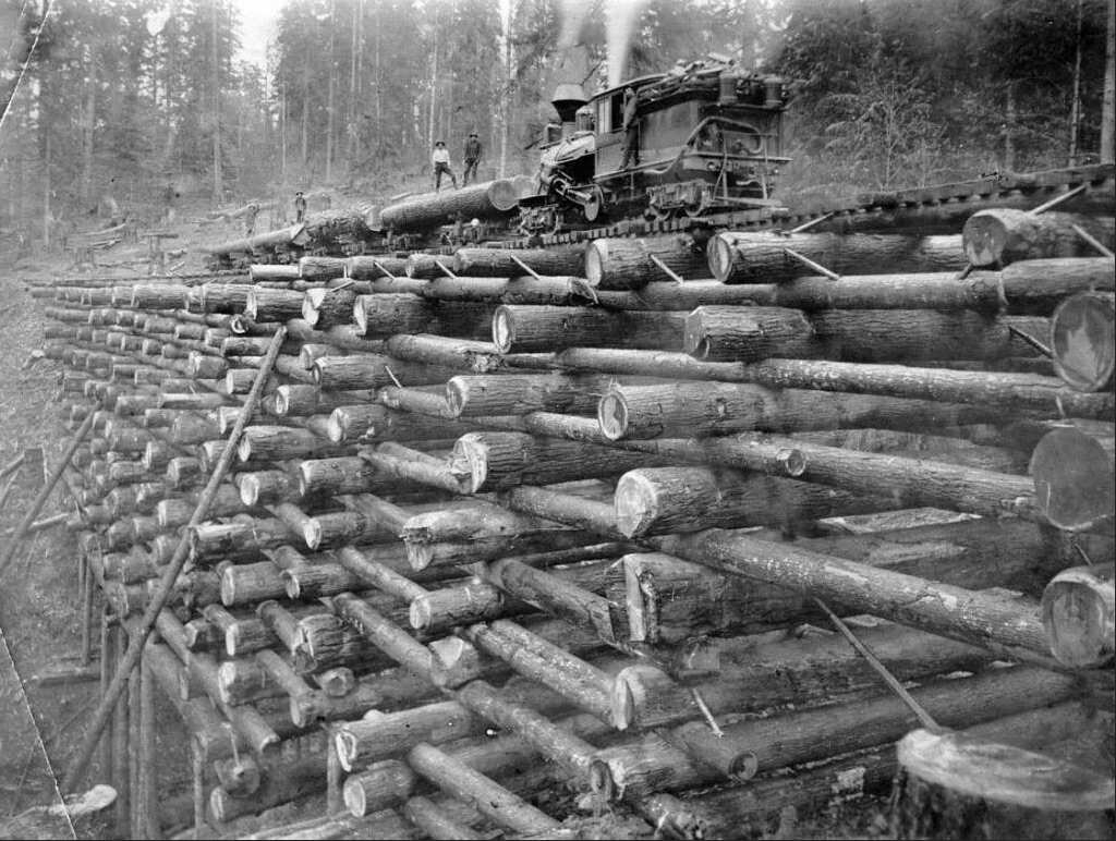

The other extreme, when you have plenty of logs/poles.
Bruce
Bruce
That is a truly nutty amount of trees used just to.... go after more trees. Looks quite sturdy though!
I wonder if they disassembled it to harvest those logs also, after the clear cutting was done on the other side of the ravine?
   / Building my tractor bridge across the creek #46
If you look at the men standing on the logs, it gives you an idea how large those logs are.
