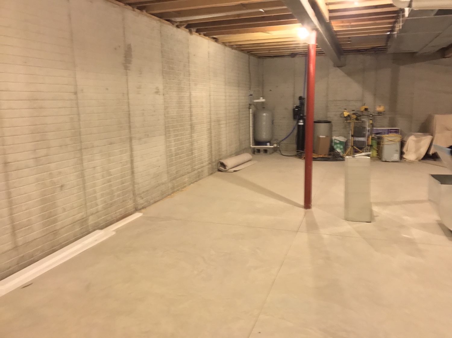

We built with thoughts of finishing out one side of the basement... but have put finishing off the basement to another day. It's plumbed for a bathroom and I will get that "finished" hopefully this year. We've always had basements and would not want it any other way. The greatest Man Cave!!! I don't think finishing it is that good... I would make the first floor larger!
Dehumidifier is your friend... if you don't want it to smell (that's our case).
Stress to your builder, that if it cracks (because too much water in concrete) for 5 years, it's his dime to fill the cracks!!

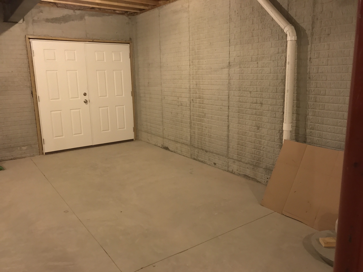

We had planned ahead and add 3 pipes from the basement straight to the attic. We had them capped, I'm using one for Radon mitigation (fan piped from the basement floor) I would have them put in a 4" pipe into the ground. We have 3" pipe... doesn't matter either way. (look up the radon thread.)

You mentioned putting a wood stove in the basement. Consider the path of the wood from the outside to the stove location. When you burn a lot of wood you realize how dirty it can actually be. We built out house with a walkout basement and the wood boiler room has a separate door directly to the outside. Regardless of whether you do full basement or walk out basement I would widen the stairways to 42". It makes getting things up and down a lot easier.

I have always had walkout basements. One piece of advice I can give you that I haven't seen mentioned yet is to go with steel I-beams to really open up the basement. We went with 12" I-beams and the support posts are MUCH further apart than if we went with wood. It would have been something like every 6ft there would have been a support post. A ranch style house would probably be different than our 2 story. We also did 9ft basement walls.
