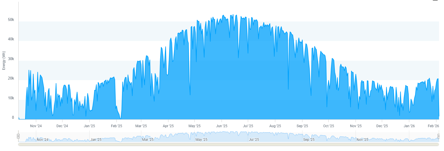

Our PoCo must charge a whole lot less per KWH, that is an excellent amount of savings for your investment.
Woops, see my edit: my array has produced 12.7MWh lifetime. Retail rate looks to be about 17c/kwh (last bill was $265 for 1577 net kwh).
The big dip in February '25 was when we got 5' of snow in a week.
It's been a good investment, but I still need more panels, lol.
daily production since it got turned on:
