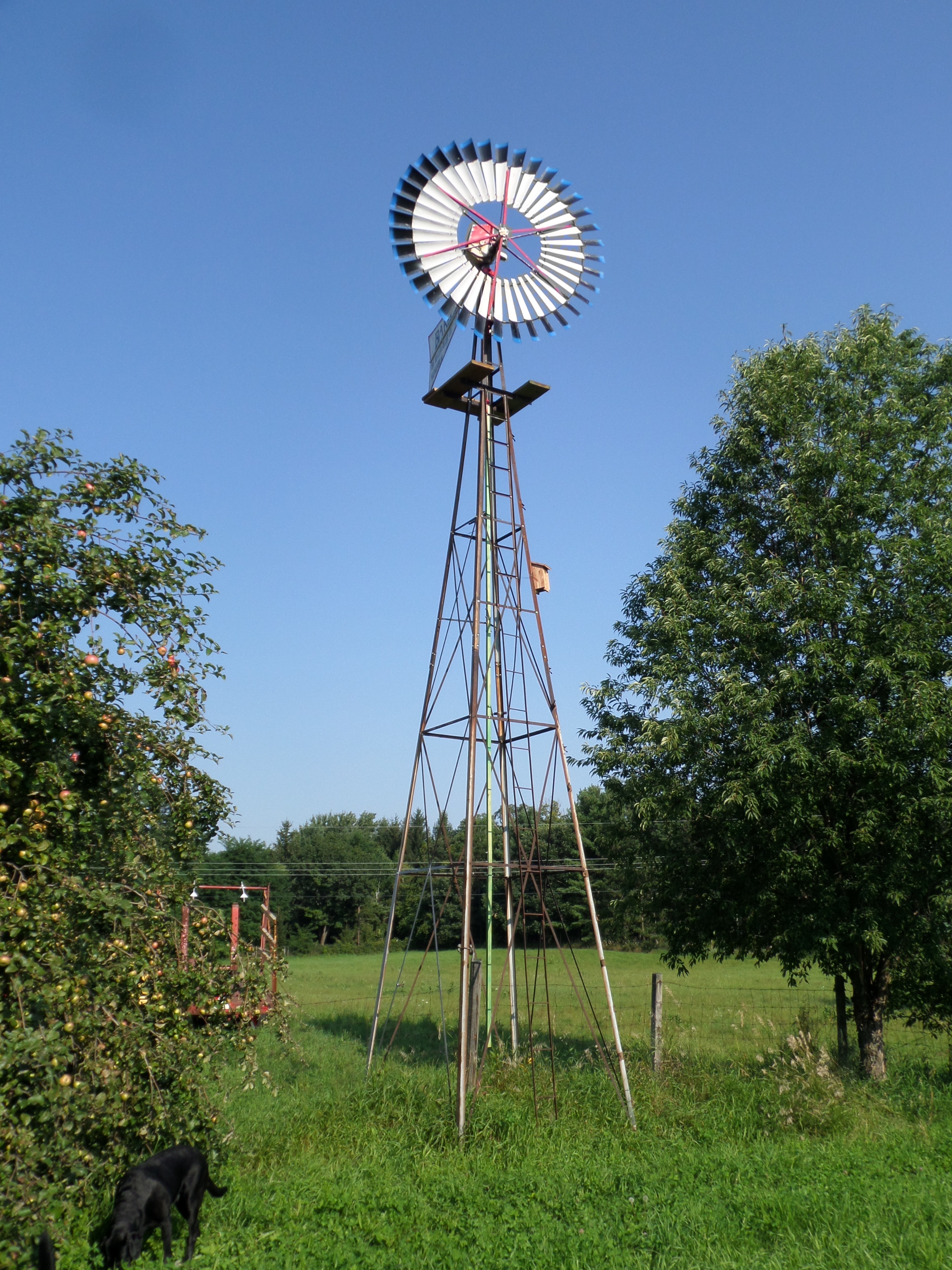

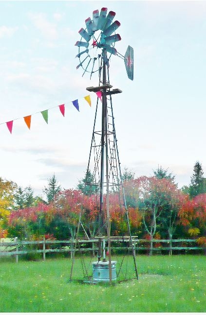

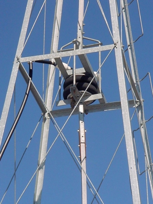

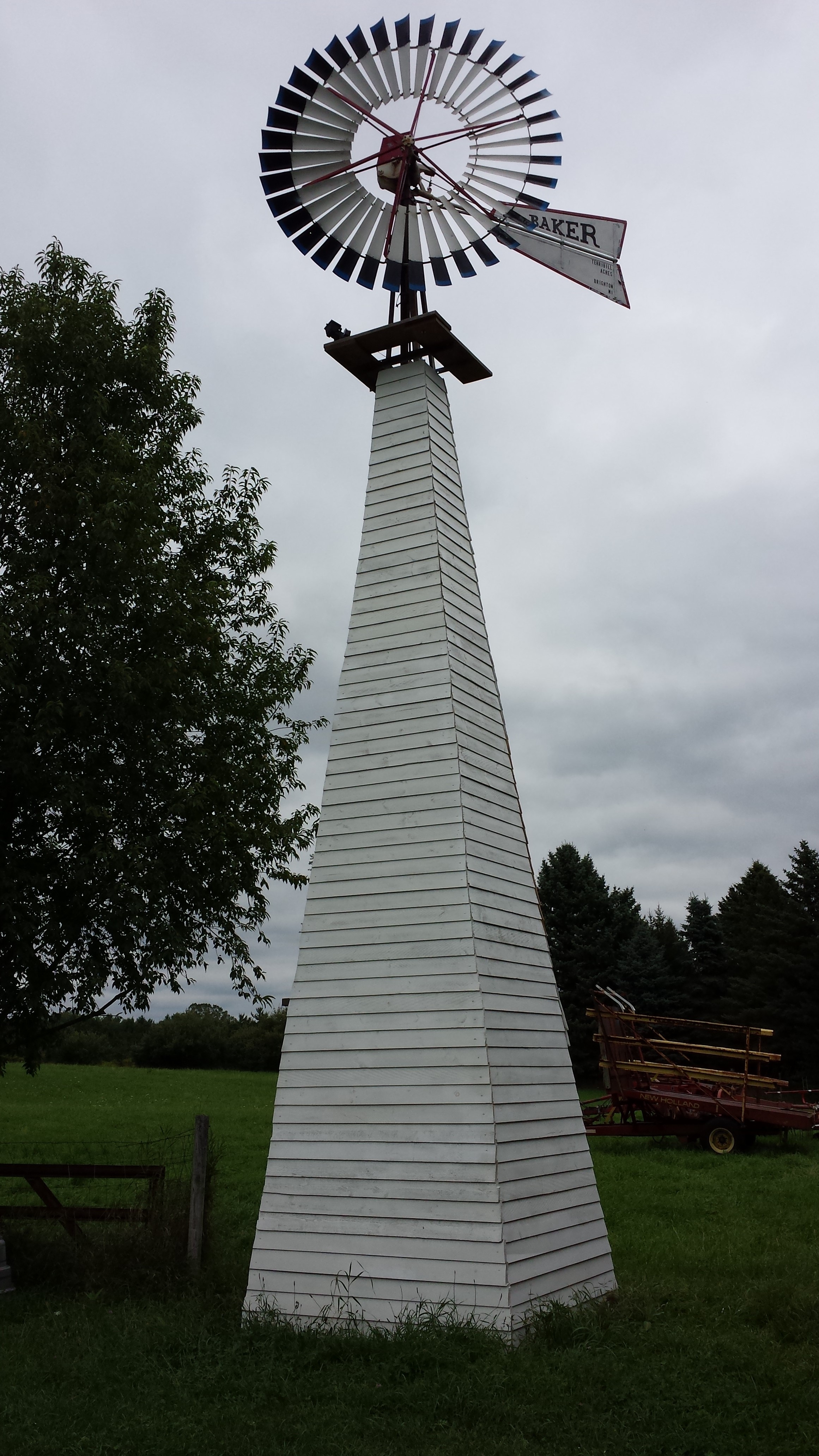

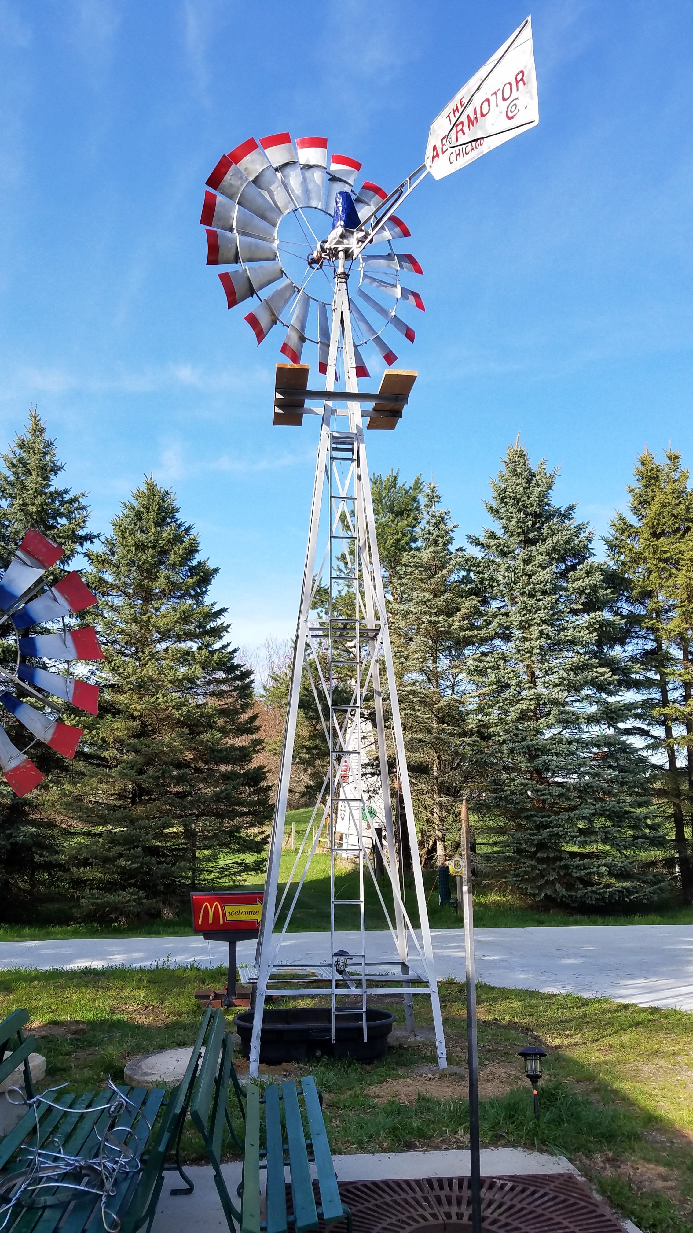

I have 8 windmills of all sizes & brands up and around my property. One compresses air for a pond aerator using a truck air suspension chamber connected to the pump rod with a criss-cross (pump rod pulls, chamber is compressed). A standard old, vintage, or brand new Aeromotor mill will get you plenty of water in any 24 hr cycle to the extent that you might want to use a float mechanism to shut it off. I prefer the Aeromotors (still buy new from Texas plant, and the old-school Flint & Walling mills. They had real bearings, an oil pump good brake design, and the offset tail to pull the fan out of the wind when the wind speed gets too high.
Used ones around here go for $1500 - $2500 including the tower. I have a JLG boom lift to make this simple as possible. Rent one locally for a couple of hours.
