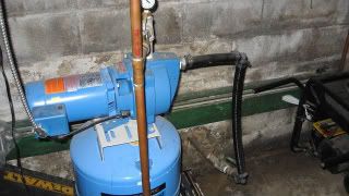

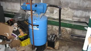

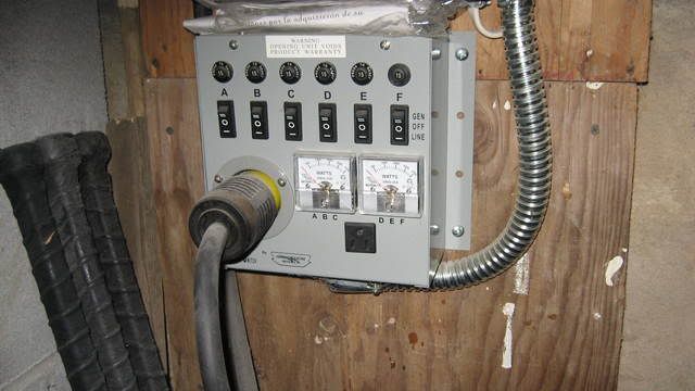

here is a pic of my transfer switches:
and of my current pump setup:
i understand the theory of the 220 vs the 115 volt pumps,
but wiring into this generator switch doesn't look all that
"easy" to do.

Is there a 220 volt outlet on generator?
I think so because of how the transfer panel is set up.
You could pump on demand unplug house plug in pump and pump and switch back.
How big is the gen can it run house and pump at the same time? (always the $64.00 question).

the genny is 5500 , and i'm sure it has 220 someplace,
but the way this house was wired, i bring the genny outside
to the garage, slide it inside the open garage door, and plug
it into the receptacle in the garage, and then the power wire
comes underground to the house and into that transfer box.
really nice setup, keeps it out of the weather and nobody dies
from fumes! (detached garage)
so, i'll have to look at this more, see what amps
existing jet is pulling etc..

My bet is that you currently have a 1/2 hp on that jet pump and you are probably looking at a 1/2 hp submersible. Amperage draw should be roughly the same. As I remember it (and I could be wrong but someone will tell me :eek:) the choice between 220 and 115 is usually made due to wire size and amperage draw on startup. For example if you have a 14 gauge wire 15 amp circuit on your pump and it draws fifteen amps on startup you will be close to maxing out the draw on the circuit which is not good for the motor or the circuit. If you rewired it to 220 the startup amps would be 7.5, well within the capability of the circuit and easier on the startup windings of the motor. Since your distance to the well is not overly long, you can avoid the problem by going with thicker wire and leaving it 115 (my other bet is the amperage draw is not that high) The pump manufacturer provides a table of wire size for required distance on their web sites and in instructions with the pump.
Of course the other thing you could do is go 220 and wire it into a plug run from the main box and then buy a long enough cord to run from the generator to the pump plug and use the manual connect/disconnect method -- how often does your power go out?

I have a 45' well with a 240V 1/2 HP submersable pump (Red Jacket brand) it is the 2 wire type without a capacitor box. I also have the a lightning arrestors installed at the switch and the pressure switch is the type that shuts off the pump if the pressure continues to drop below the kick on set point (it has been in service for 21 years).
I also run my house off of a 240V 4500 Watt gen. that is hooked up in my detached garage. I like this setup for the saftey factor. From the looks of the transfer switch an electrician could possibly rearrange the circuts and fit your 240V well pump circut in. It would depend on what the other circuts are feeding and the wire sizes.

took a look at the pump tonight,
it's a gould, and it's dual voltage.
currently wired into 115, the label
says it's draw is 8.6 amps, with a
max load of 10.8
obviously the 230v ratings are 1/2
the 115.
i'll have to investigate sub pumps more,
i'm leaning towards a good 115v,
1/2hp, 7gpm.......
