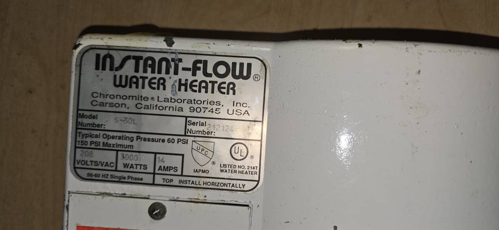

Thankless unit. You get a 208 volt AC unit to get good results. Been in use 25 yrs! Chronomite unit. Would work great for a bar sink also.

Here's the unit info that I have mounted under sink.
