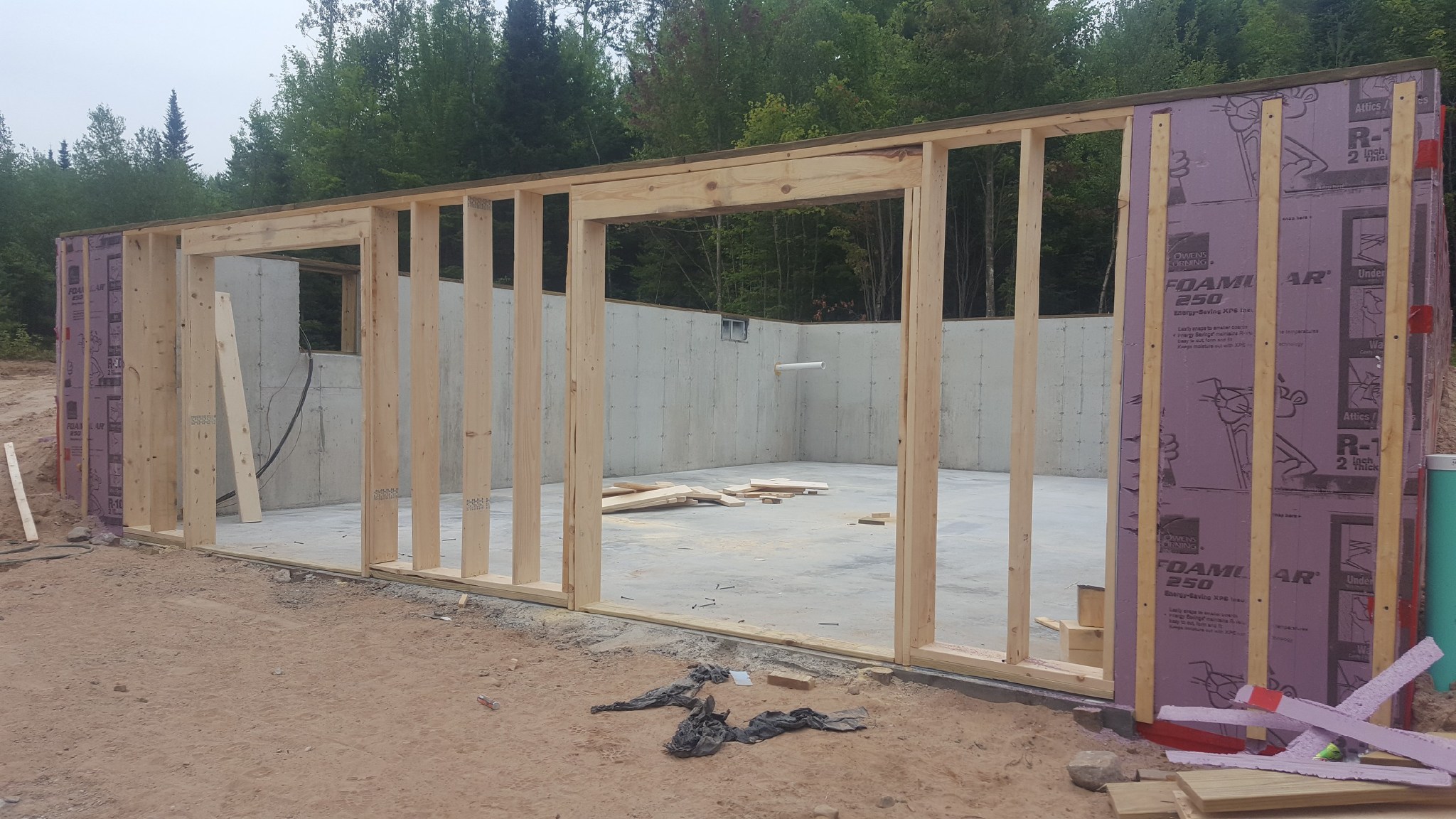

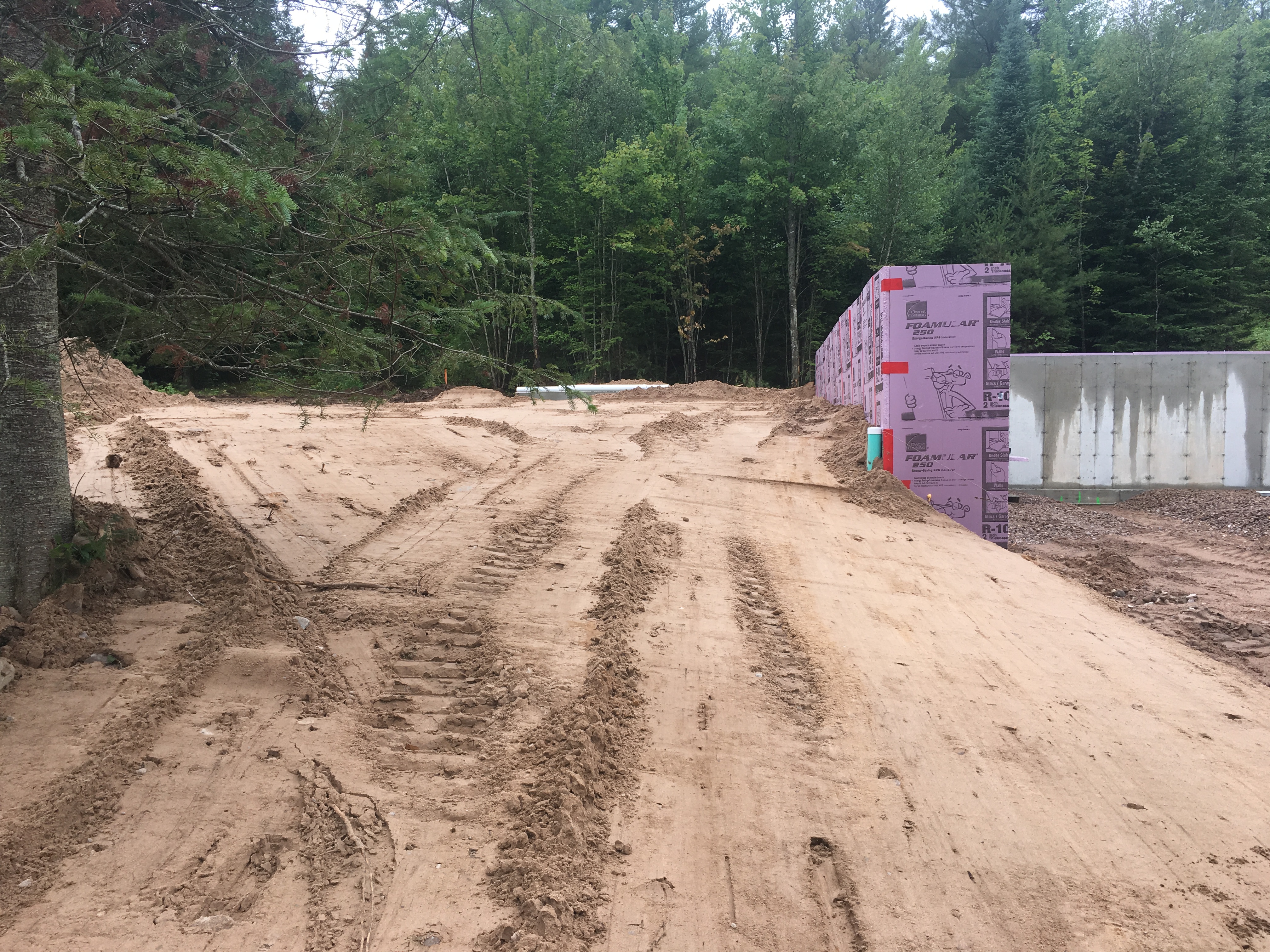

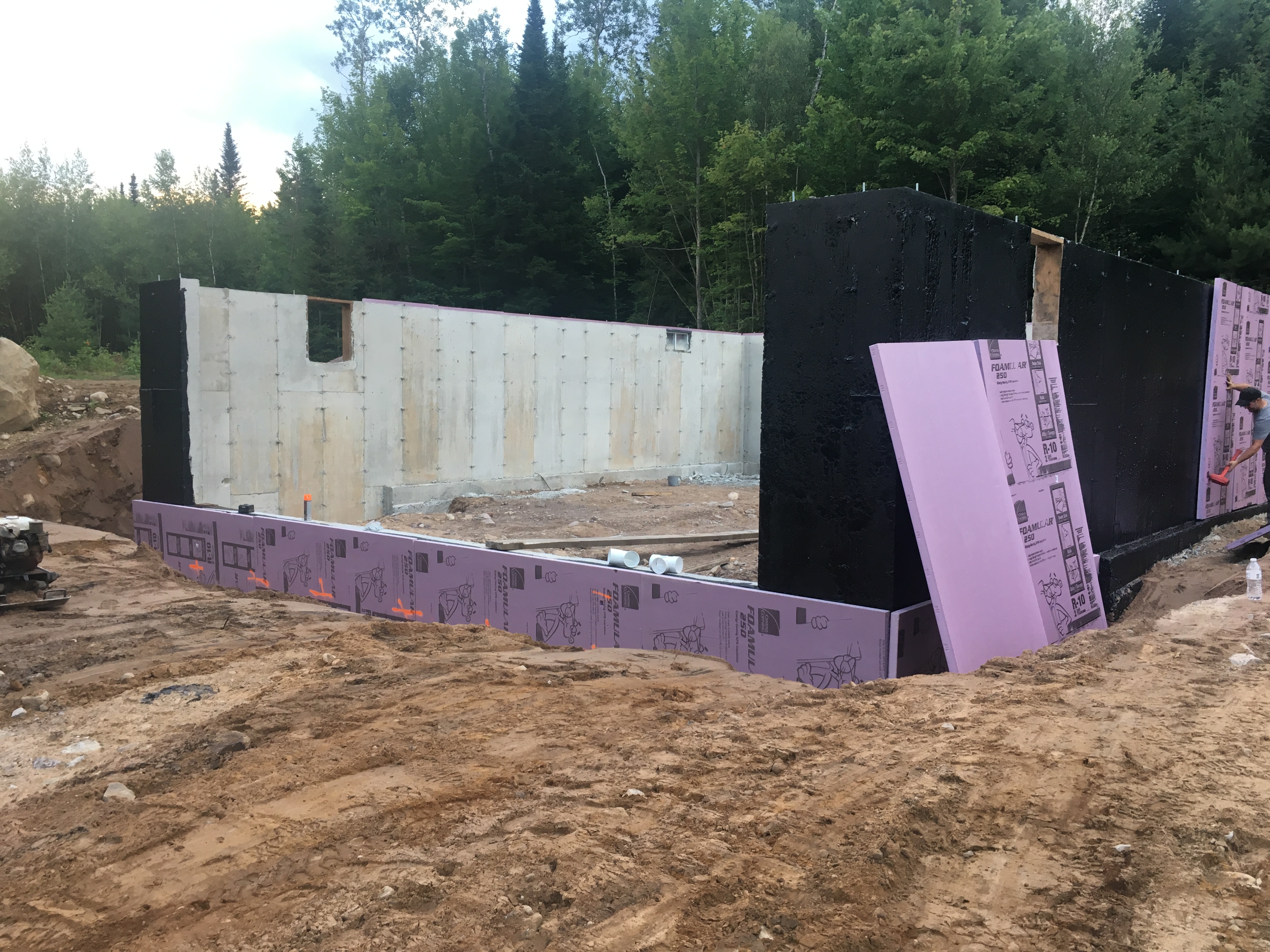

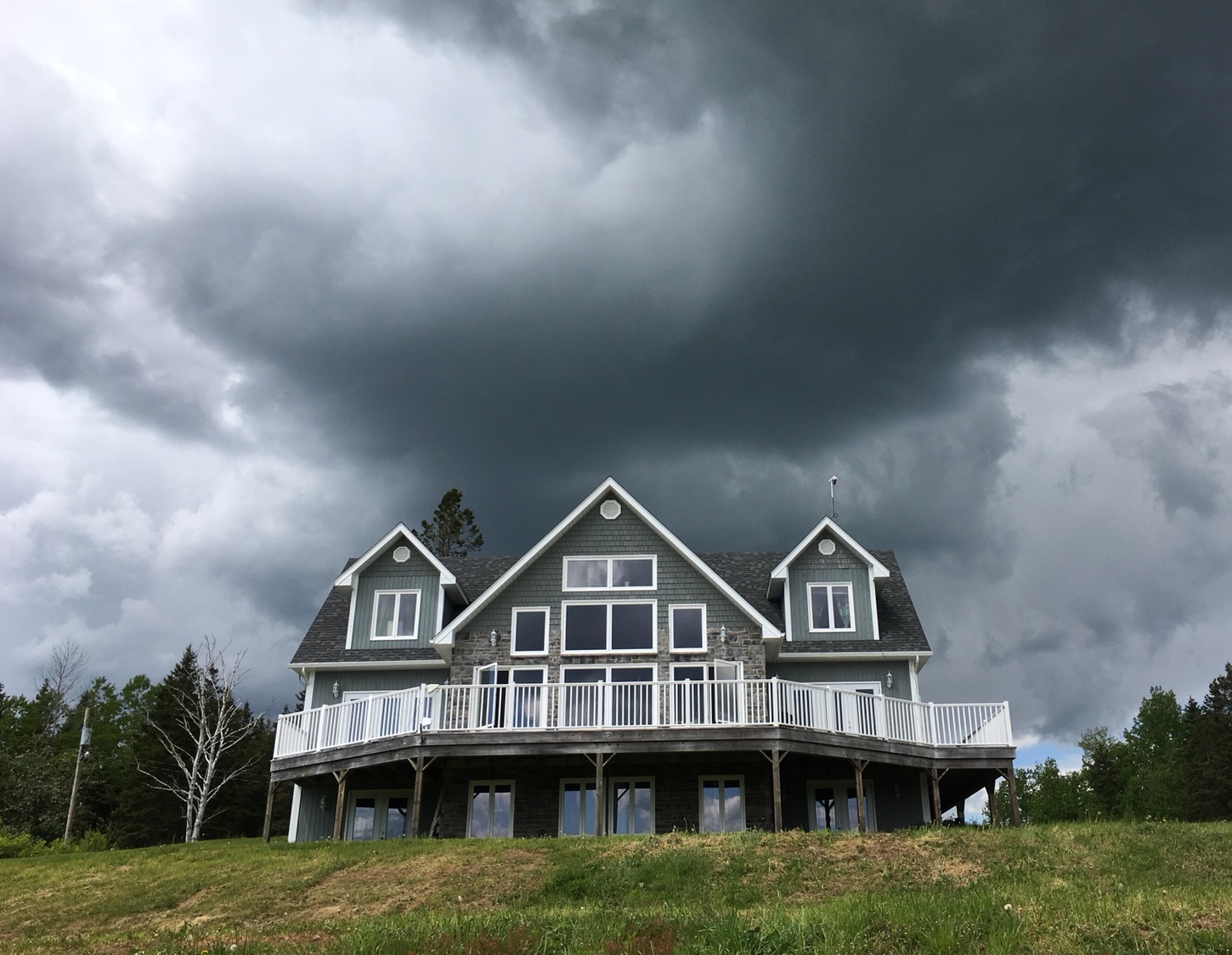

If you’re built into a hill like I am you can do something like this:

My house is East facing and it gets a lot of morning sun. With all the windows it warms up really nice even on the coldest winter day.

That is the huge PRO to a walk in basement, you do not have to use the stairs if it doesn’t permit.
As u can see from my previous post, I have two French doors, they both open completely, no center support column, I drive my tractor right through them.

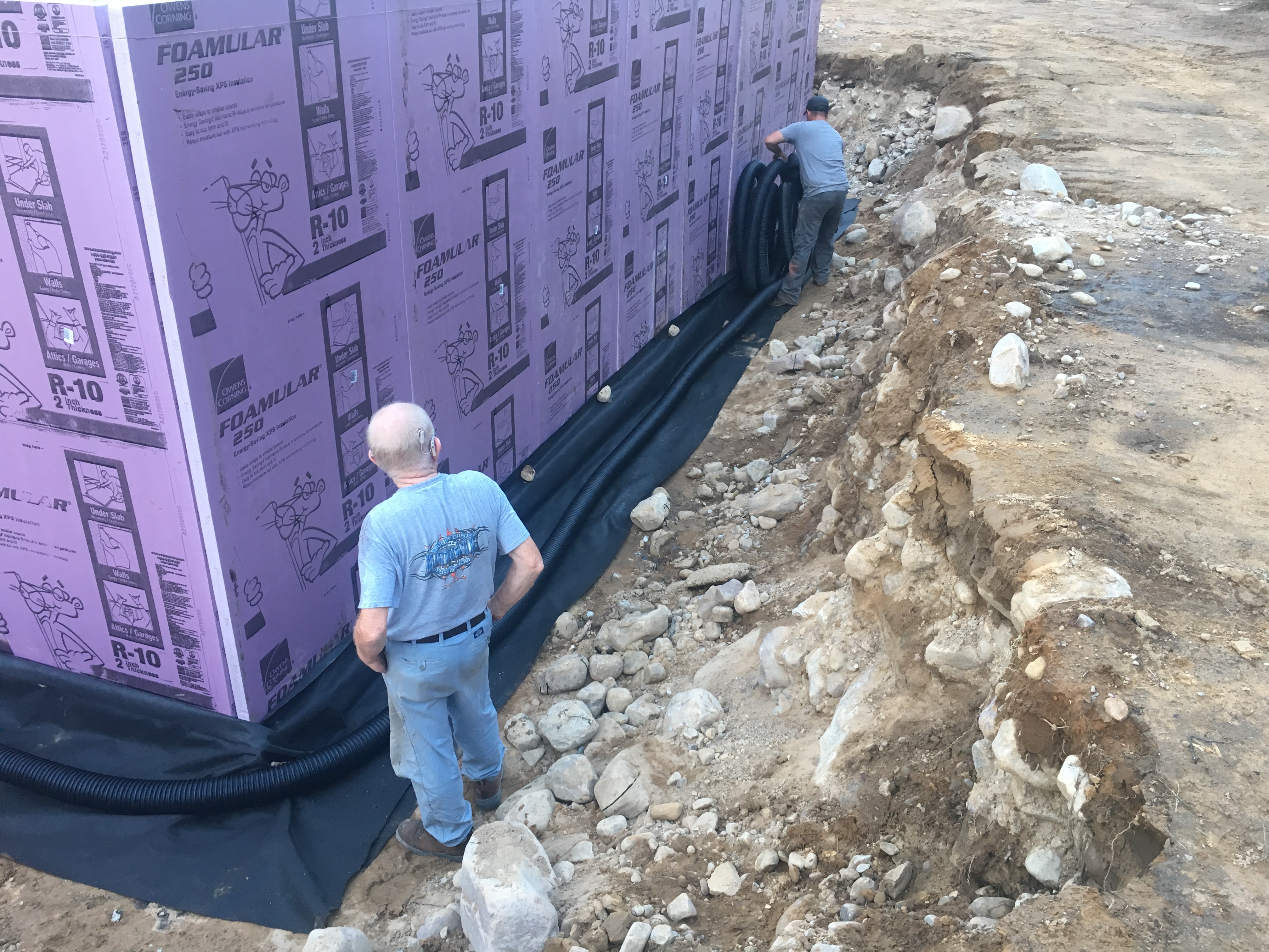

If you decide to go with a basement, build it with I.C.F.'s, (insulated concrete forms) it will be much cheaper to heat and cool.
