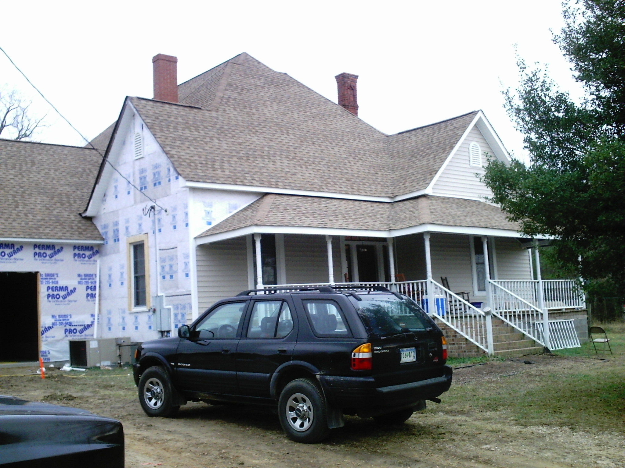

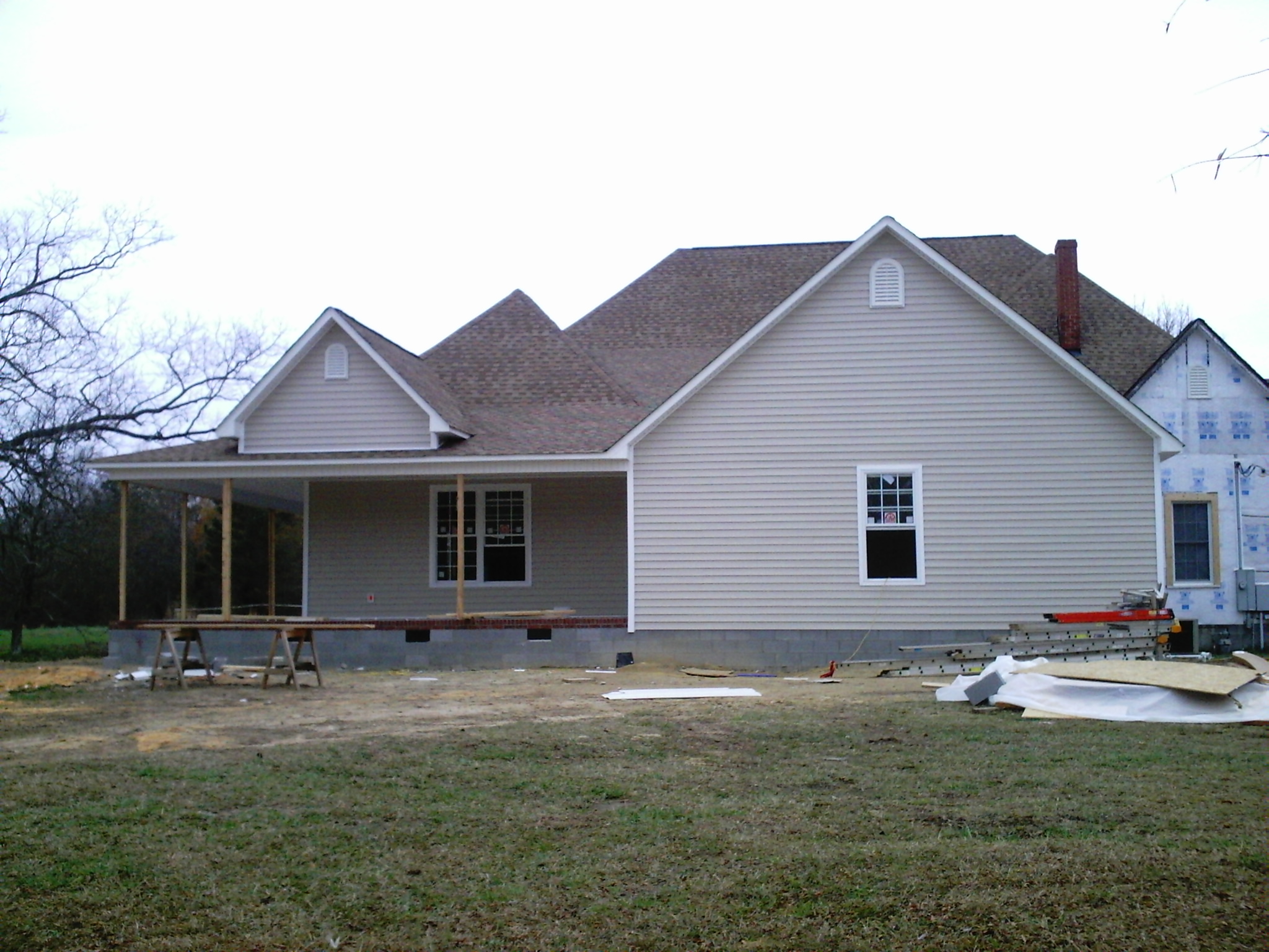

here are some before and after pictures of the project for those who are interested.

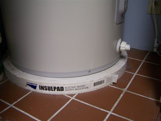

Fortunately you don't have to worry much about earthquake strapping. I go along with birdhunter1 and recommend the insulated pad to keep the tank high and dry above the concrete.

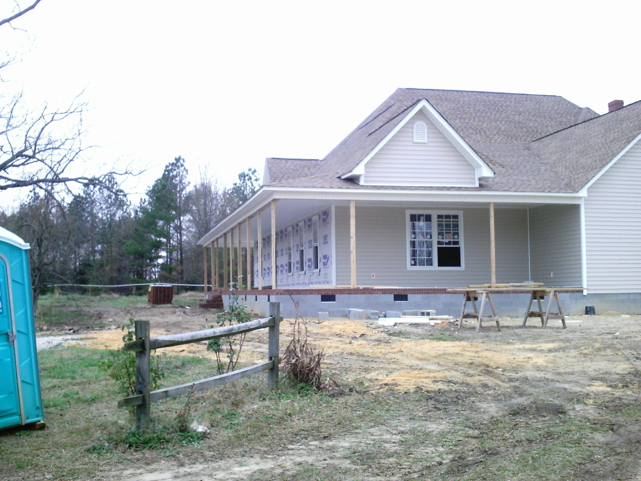

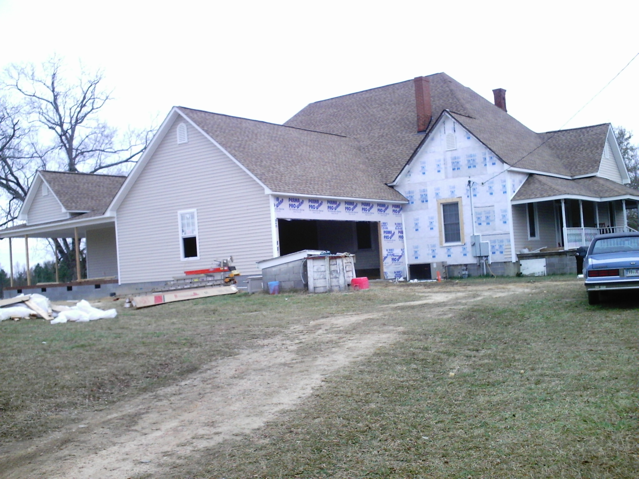

thanks guys for the advice and interest in my project i will be roughing in the
water heater this weekend here are some more pics they are few months old i will try to take some this weekend
