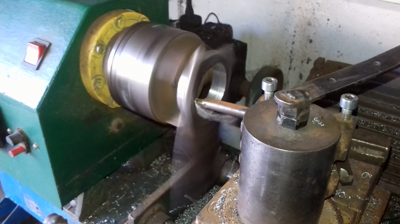

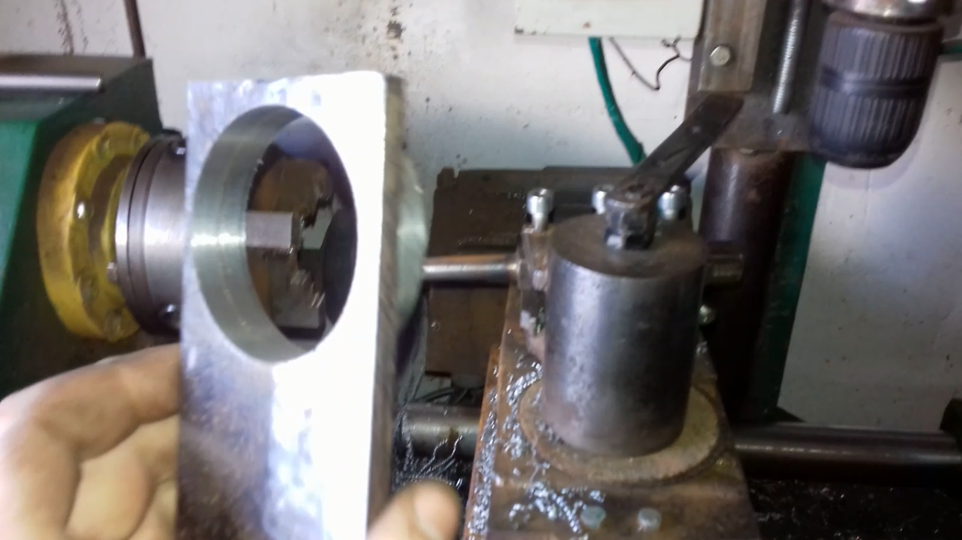

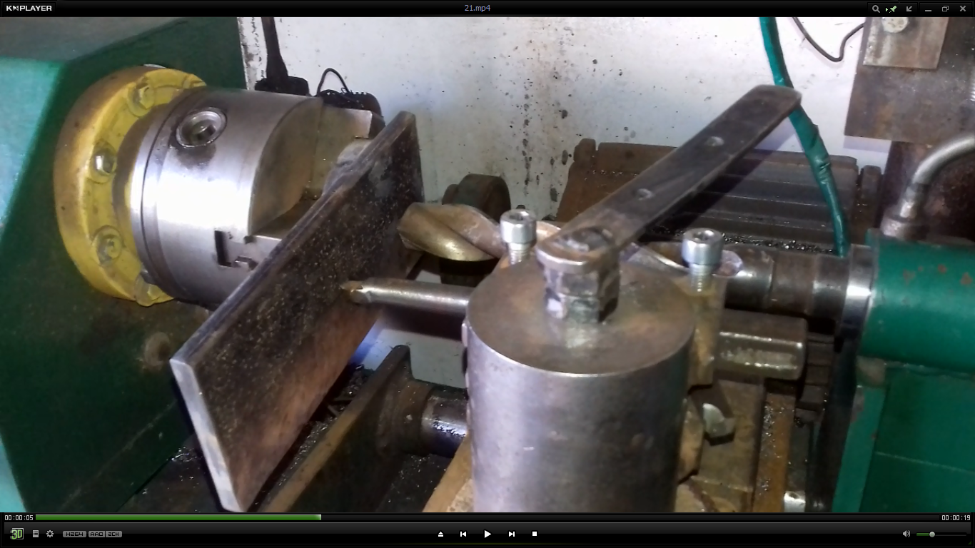

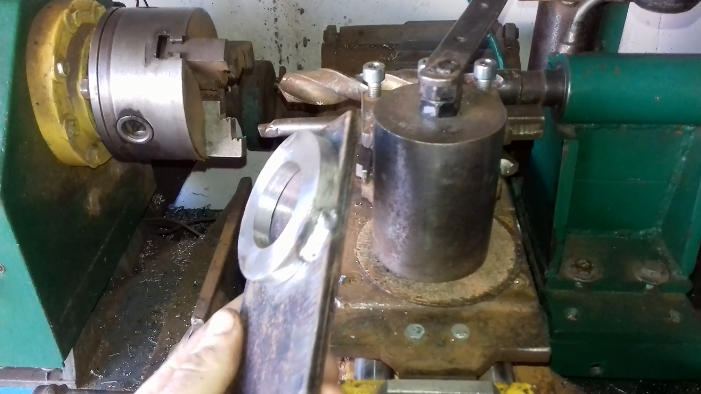

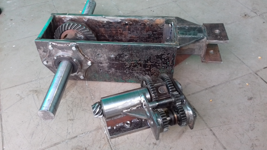

so, how did you slot the axle for the wheel hubs??.. a milling machine is needed for that because of the tight tolerances and accuracy needed..
/ Homemade Two wheel tractor #45
I don’t think he did. It looks like the hubs are clamped onto the axles.
/ Homemade Two wheel tractor #47
Can mill it on the lathe
/ Homemade Two wheel tractor #48
how?. I've worked for a defense contractor for years making parts for jet fighters and helicopters, using all kinds of machines, and that was NEVER done.. the only way possible to do that on a lathe is VERY unconventional, you'd need to lock up the chuck, either by tying the brake on with a rope, or make a jig for that, and drill the ends of the shaft for a live center, and make it tight against the shaft, and make a special bit with the exact width needed, and use the power feed to essentially scrape the steel horizontally a little at a time. and I don't see the shaft drilled for a live center..
/ Homemade Two wheel tractor #49
He built a horizontal milling machine. Anyways, can be done on the lathe, specially if you have a milling attachment like he also built in his lathe.
/ Homemade Two wheel tractor #50
Mount shaft to cross slide, end mill or keyset cutter mounted in the spindle. Done all the time.
Would like to see the mill the OP made.
/ Homemade Two wheel tractor #51
Put the endmill in the chuck to spin. Mount the shaft in your toolholder.
