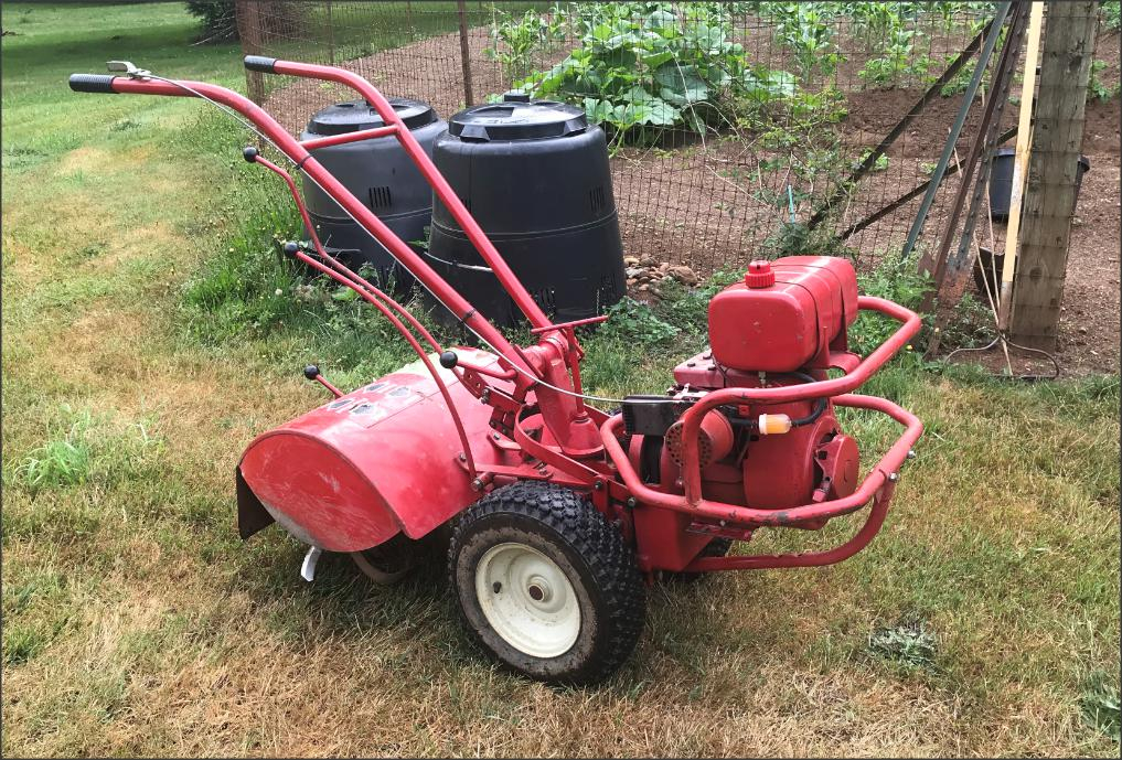

Are used Troybilt Horse model tillers not available in your part of the world?
I bought mine for $200 couple of years ago and did few very minor repairs.
They are quite capable for creating & maintaining small garden area, but ofcourse one needs to take it easy if the ground is rock hard at first.
There may be "some" however that would easily go for 1000$ plus, nonrunning. Which when a little Chinese one is half the cost. Or 1/4 the cost of a running unit, it sadly makes more sense, I really don't know why they're so expensive here though. The Chinese one should be here in about 3 weeks hopefully and by then I should be finishing the tractor plans
