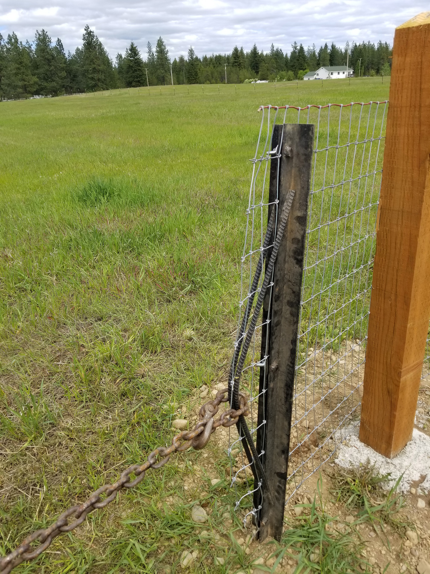

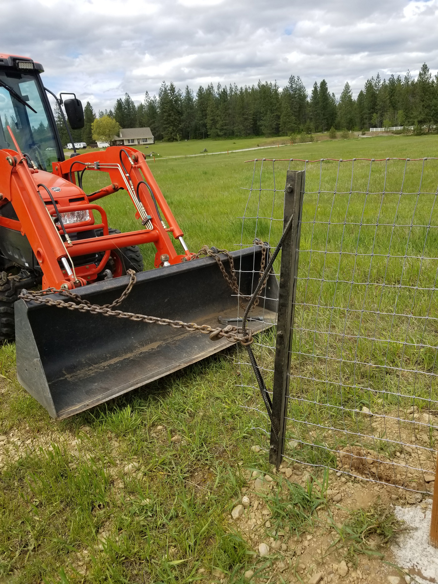

i onlky use mine as a transporter, unroller. believe me the ones with built in tensioner dont last. i read the reviews on them before making my own. i welded up a simple tensioner and use it with a chain on tractor bucket. fence 2.jpg fence3.jpg fence 1.jpg

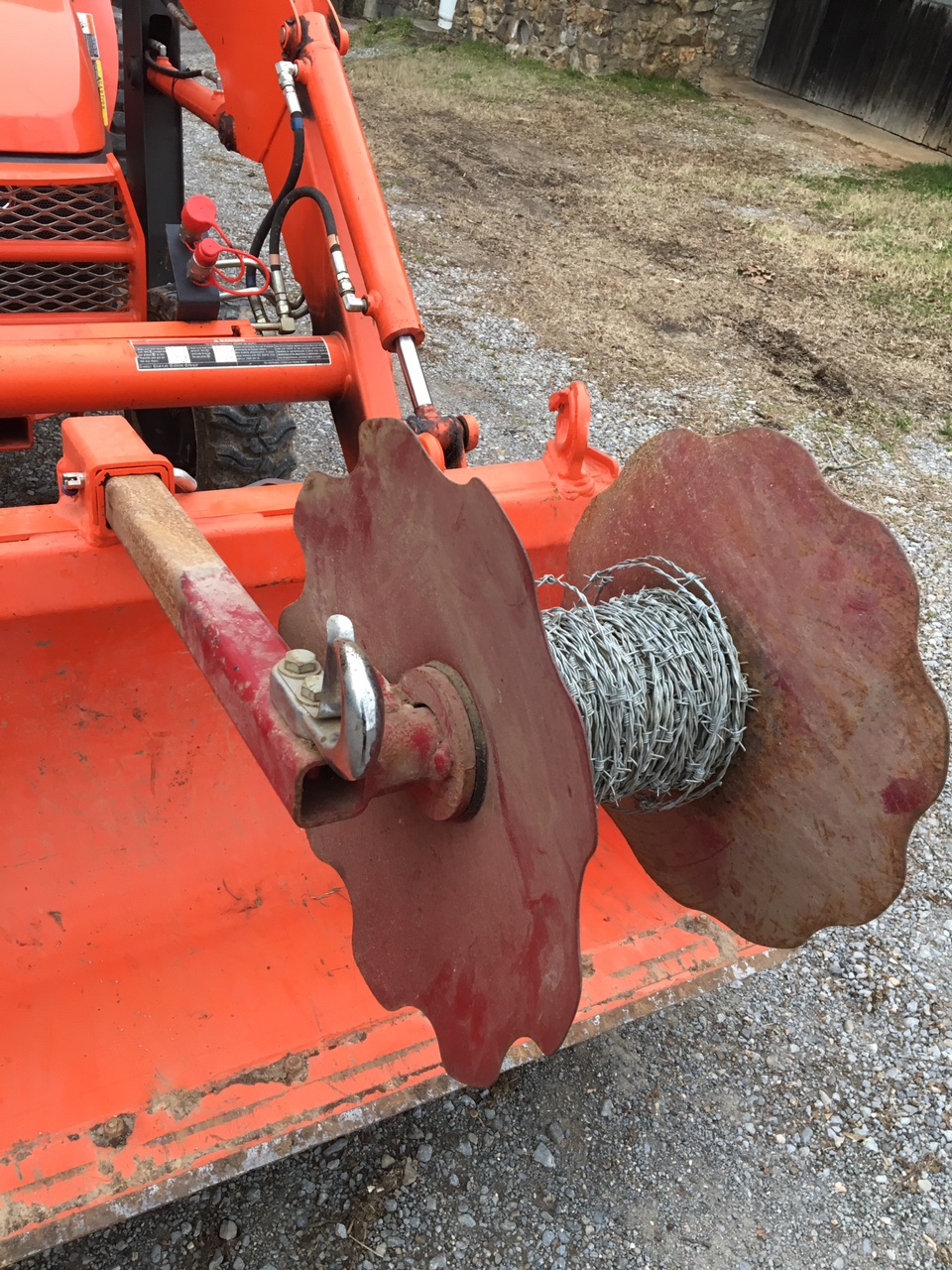

Adjustable friction brake. Can unhitch and have a handle I can pull on the ground for tight spots.

That looks pretty good for barbed wire, but how will it work for 60" horse fence?

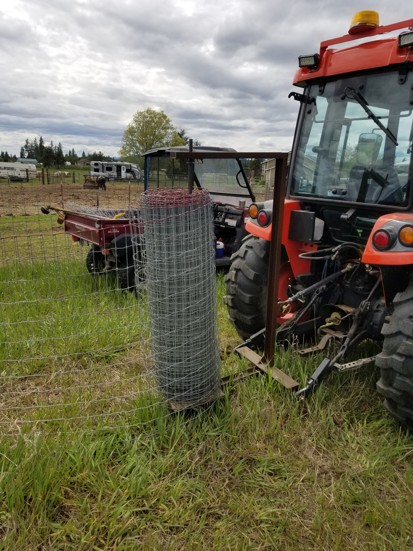

It will not. Have installed lots of woven wire without an unroller and thought a design for a 3pt and ssqa attachment. Have some 3” well drilling pipe with tapered threaded ends I thought would be nice for the pole thru the wire roll. Have some steel pallets with thoughts welding the pipe female socket to. Have an idea to make a combination man basket and wire fence unroller pallet. Have use for both.

The fence unroller also worked great, a real time and back saver! We needed to put a piece of 2" pvc pipe about 4" tall at the base of the upright post. The fence would unroll about Half way, then snag on the bolt at the bottom. The pvc stopped it from happening. The next 4 rolls unrolled perfectly.
