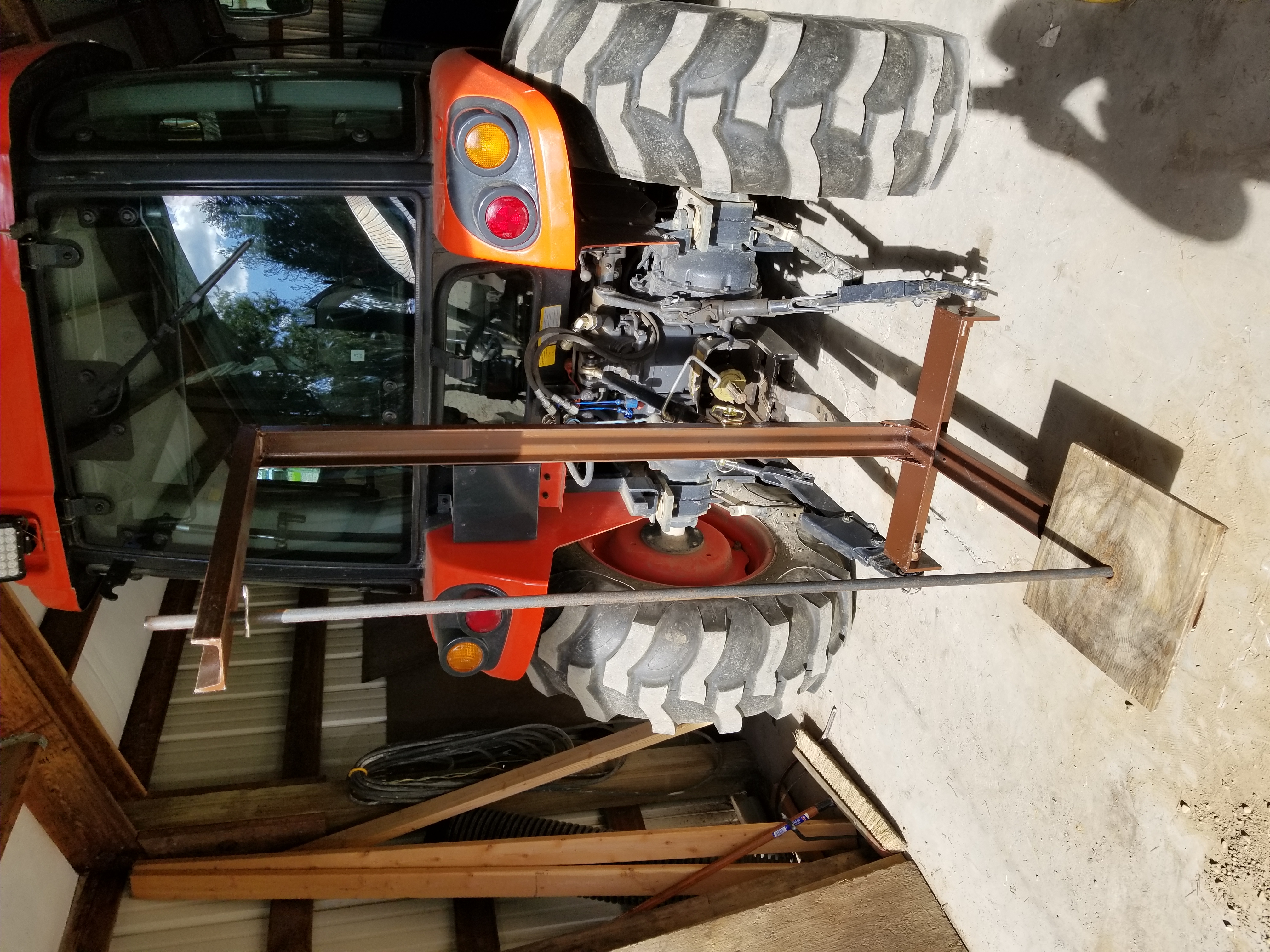

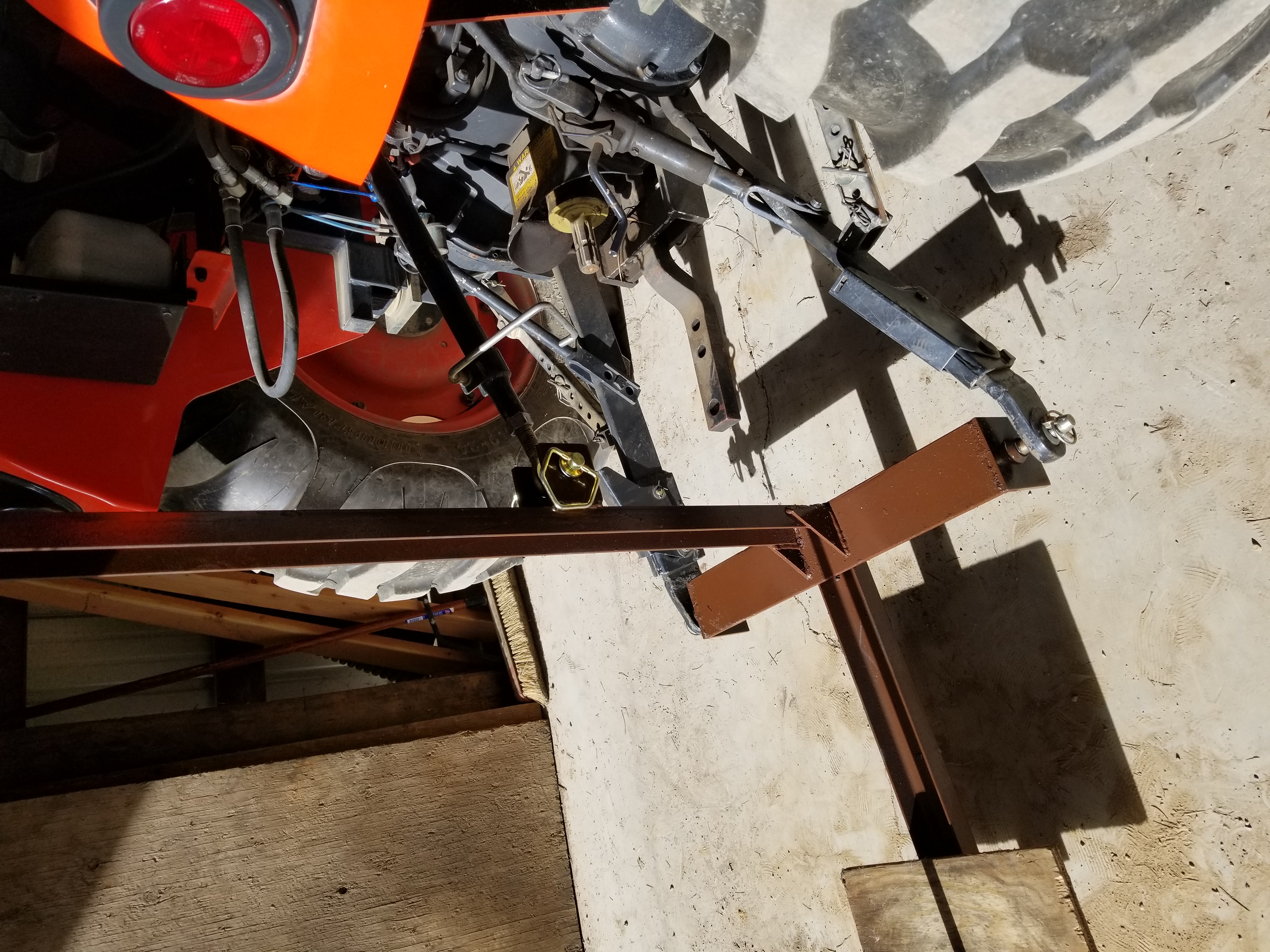

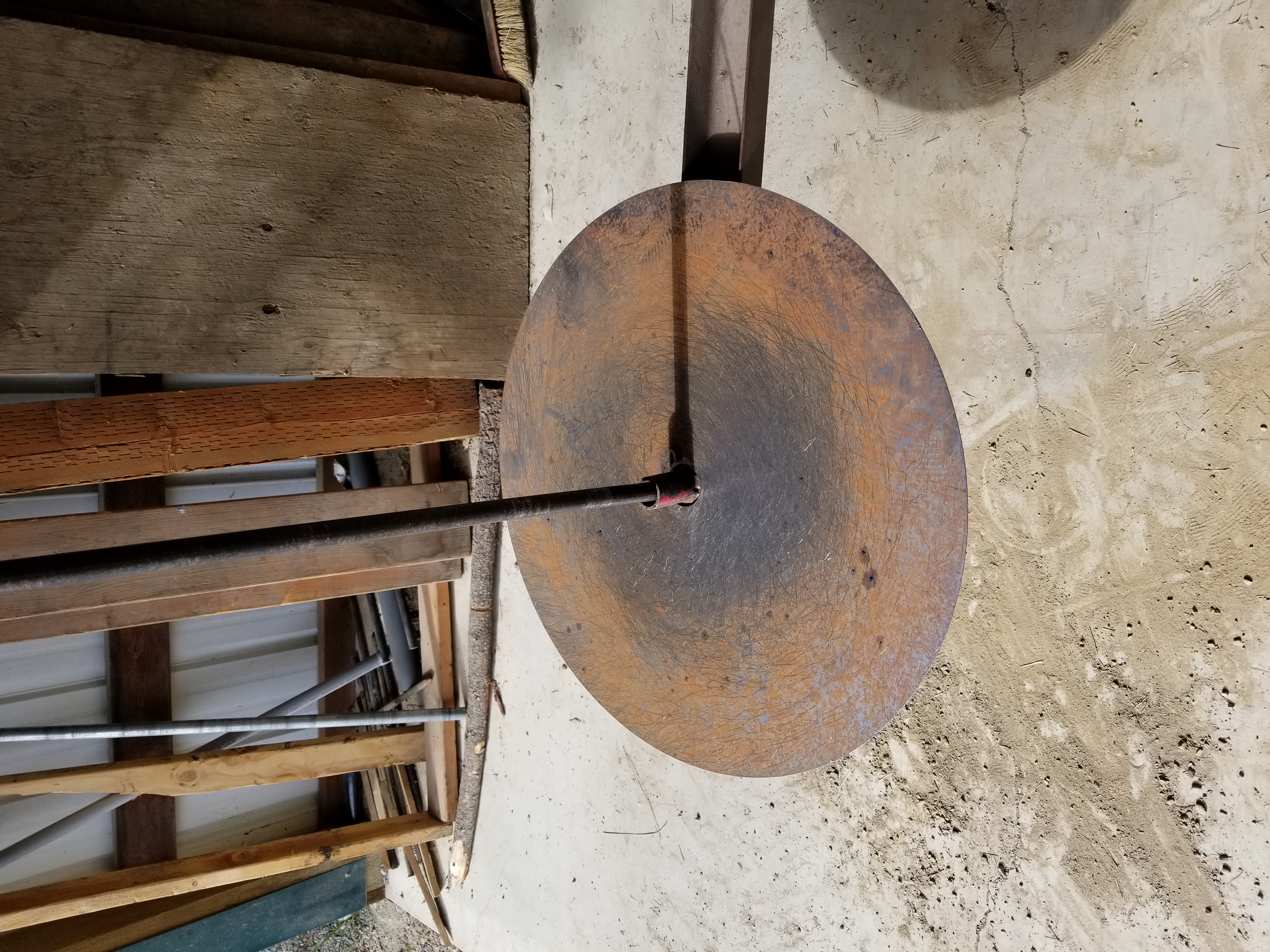

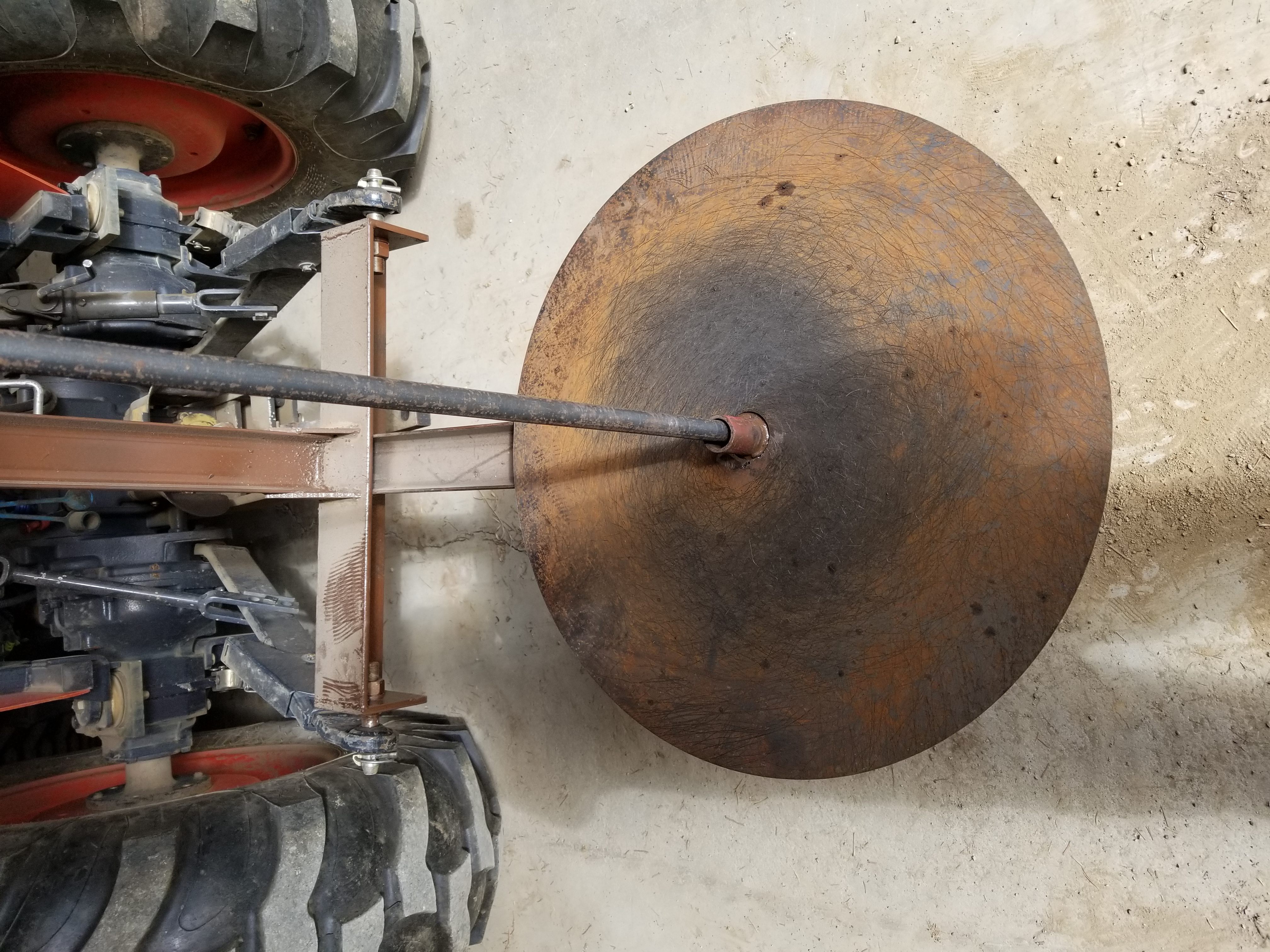

I built one out of scrap that mounts to my 3 point hitch. F76C4185-7645-40BB-A24B-BF64C4561862.jpeg. 63DE8C8A-C46A-41F5-B2F8-A690569B0AB6.jpeg. 3750D8DF-ABE7-459A-815B-D35D5F02DDA4.jpeg. 848F2E49-111F-439F-BAE3-A3EA5D8C2BDC.jpeg. The large round piece freely spins. A bar slips thru roll of fencing, thru hole in bottom plate. Pin on top locks it in place. Works slick. No jambing and can hold it down near ground level. Best part...just so plasma cut time. It was all built from scraps except for mounting pins. Funny thing though.... i cant recall for the life of me why i had that old steel stock on my racks. Was barely rusted. I cant recall what i was planning on making with it.
