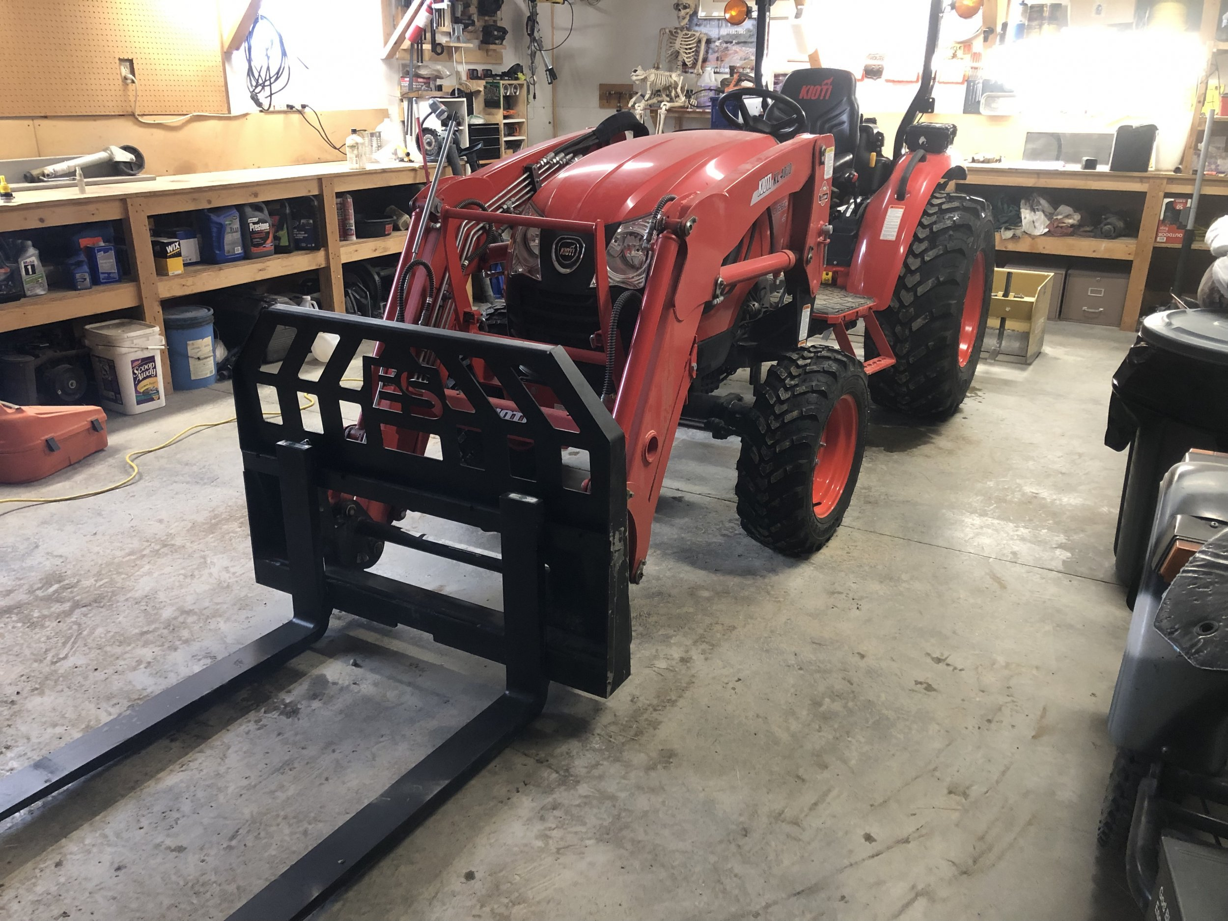

I received my Express Steel HD fork set the other day... it's probably gonna be a while before I get outside to start picking up stuff, but I thought I'd report back on my decision...
1st: $825 delivered to my door or place of business (I had them delivered to my work as they come strapped to a pallet and I didn't have a set of forks to unload the truck... well, DUH!!! that's why I bought them...) Std. forks are $740 delivered...
2nd: Made in U.S.A.

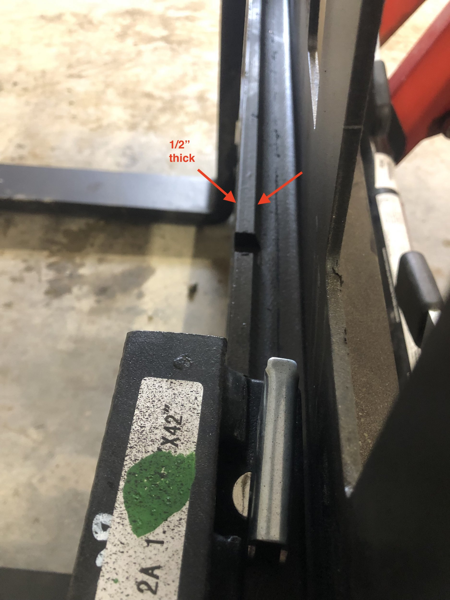

3rd: The HD forks have a 1/2" thick, machined top rail (the rail that holds the top hook of the forks)
Std. forks have a 1/4" thick, bent rail... either set would work for my purposes, my decision was personal preference...
4th: Each 42" fork weights 94.2 lbs (don't tell Julie I borrowed her bathroom scale...), the mast weighs 127 lbs (according to the affixed manufacturers label)... Tare weight for the set is just under 315 lbs...

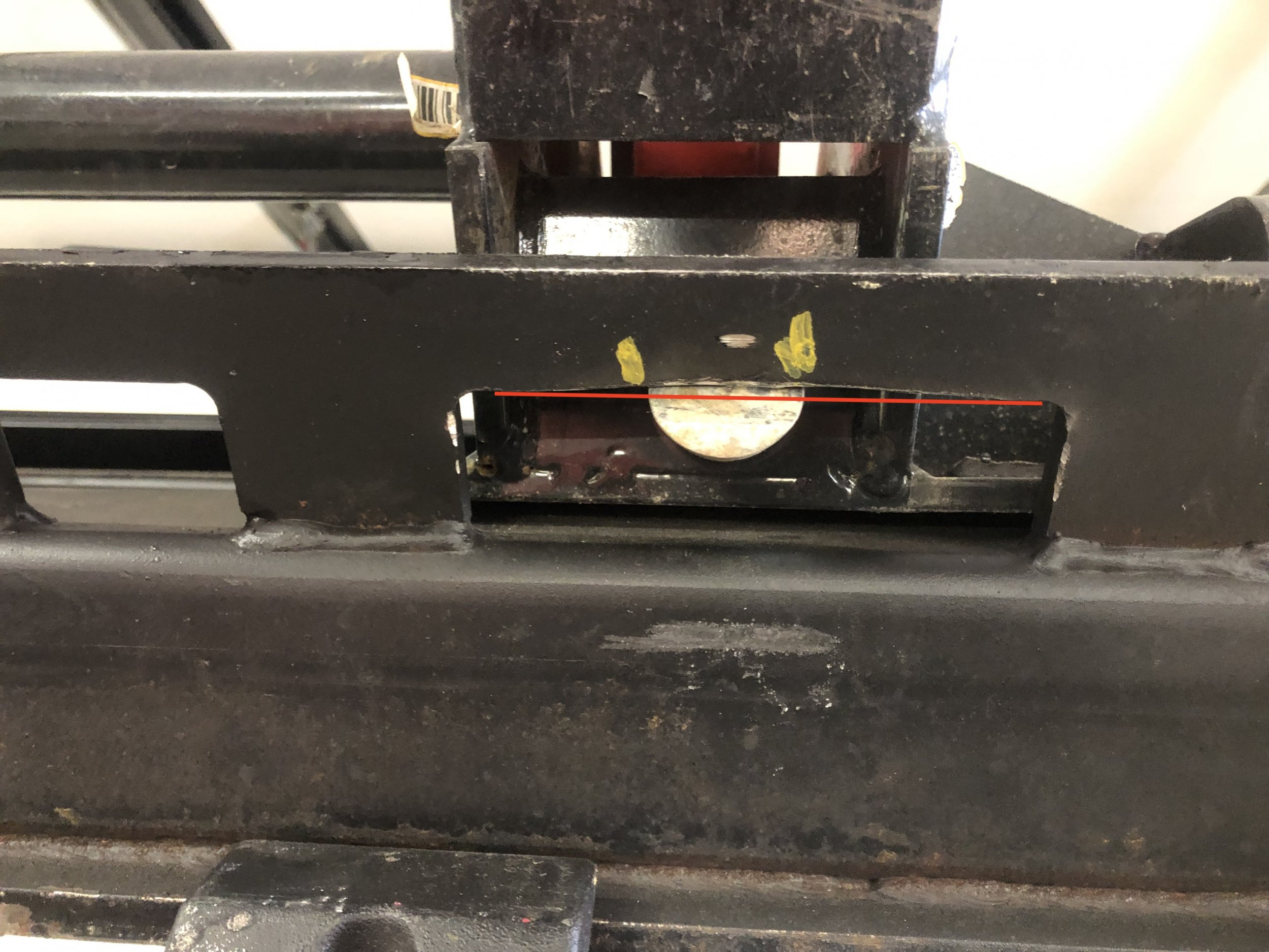

I've seen numerous YouTube videos of people attempting to attach aftermarket things to a tractors SSQA... most of the troubles occur when the lower, tapered pins engage the lower attachment bracket before the handle becomes totally locked down... and this was the case with the ES forks...
I ended up grinding about 1/16 - 1/8" off the back side of the lower mast attaching holes... that allowed the tapered pins to be slid into position... (looking up from bottom of fork mast...)

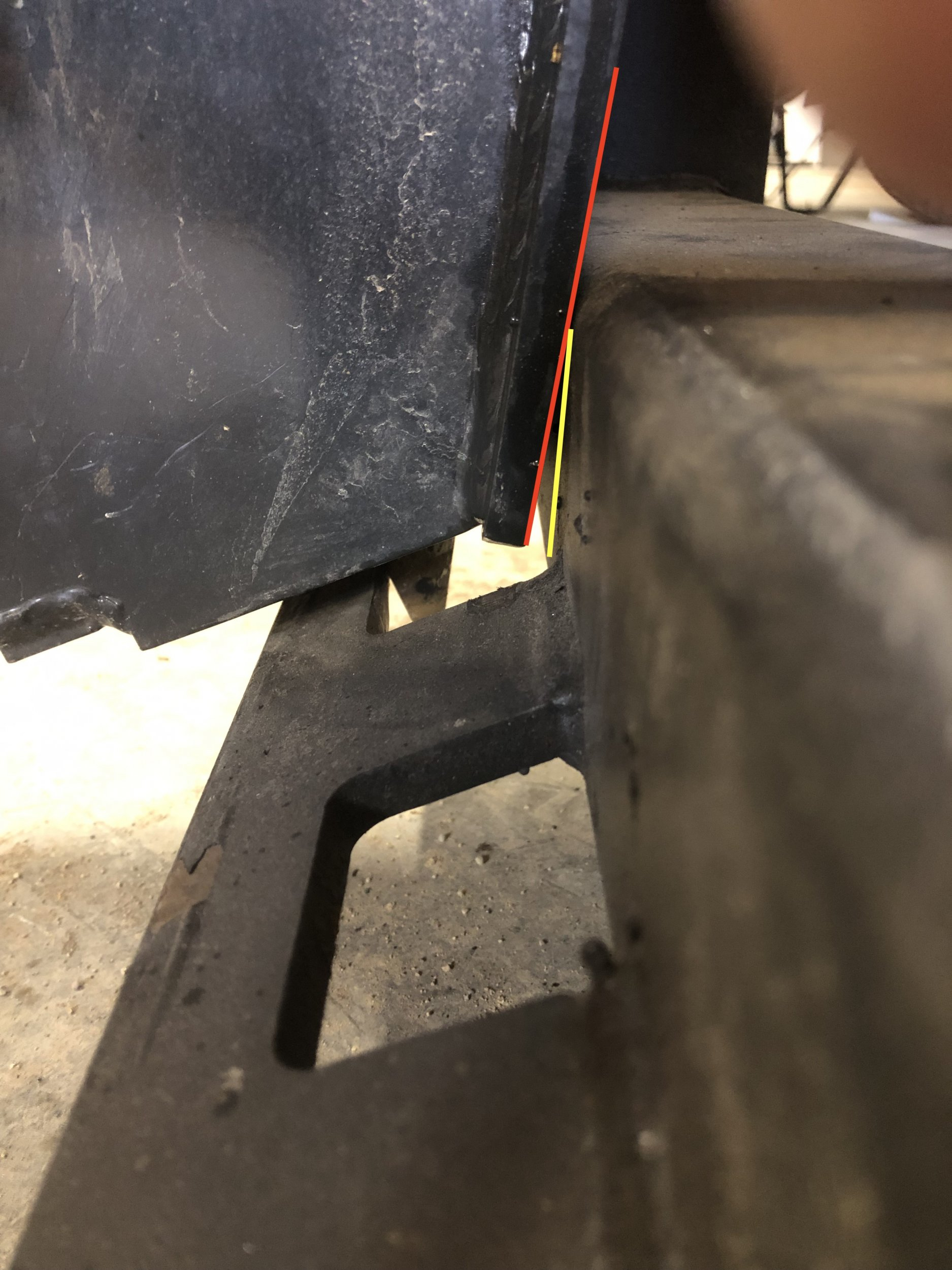

Your picture looks like the tractor mounted plate was not fully against the fork mounting bracket. Unless it is an illusion there is a gap.

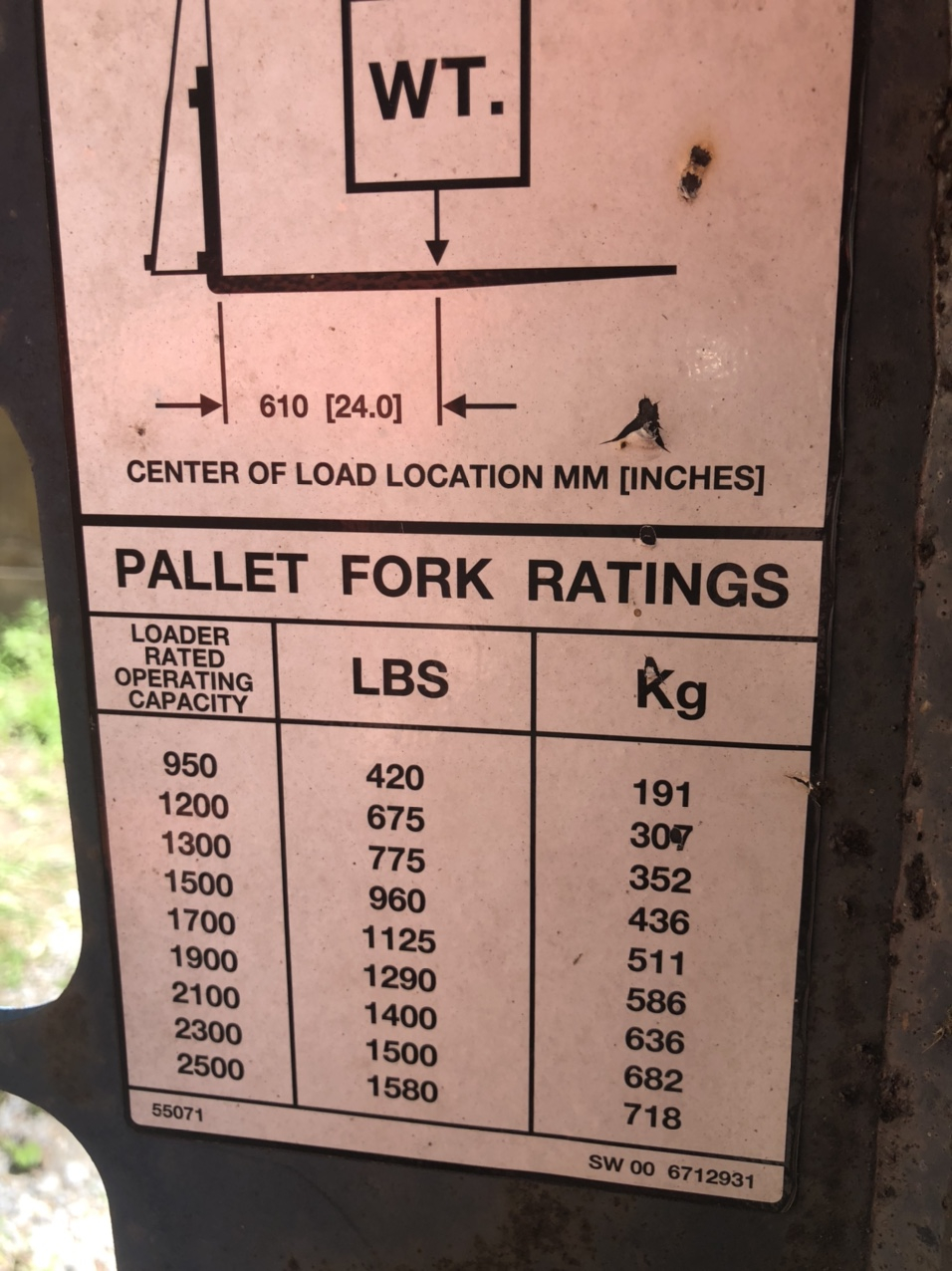

Look at the lift spec for your tractor and buy the appropriately rated forks.

There is a gap at the bottom...
The tractors quick attach plate (red line) connects with the mast at somewhat of an angle... the mast lower square tube (yellow line) is more upright when attached to the tractor...
It's the top of the masts 3" square tube that mates with the tractors QA plate... (where yellow and red intersect)
Sounds like the SSQA bracket specs are similar to the 3-point quick attach specs... each manufacture has their own set of rules...:unsure:
You want me to buy another set of forks?
If you read the entire thread you'll see the reasoning (and all the brain damage) behind buying this set of forks...

This fitment issue didnt happen on mine. Locked right in first try. A bit of adjustment via grinding isnt the end of the world though.
I should read 6 pages of replies because ....the thread title is not really what is at question here? Okay..

I dont think it has anything to do with manufacturers using the wrong specs. I would say it is all down to how picky they are when building it. Something shifting in or on a jig, something cut slightly wrong, a little bit of distortion from welding too long or out of order, etc.
Forks put less stress on that pin/hole than most other types of attachments because you are hardly ever pushing down or pulling backwards on anything. If you can get the pin to go in with slight grinding i think you're 100% set.

…Forks put less stress on that pin/hole than most other types of attachments because you are hardly ever pushing down or pulling backwards on anything...
When I first tried to engage the pins I thought… ”Great… should I send them back or just ‘half-engage’ the pins and use them that way…”
As I studied the issue I realized the stressors on them were exactly as you say… most of the leverage is hanging/pulling on the upper bar (the reason I went with HD) and pushing against the lower bar…
The bit of material I removed with the grinder will have little-or-no effect on the durability of these forks…
