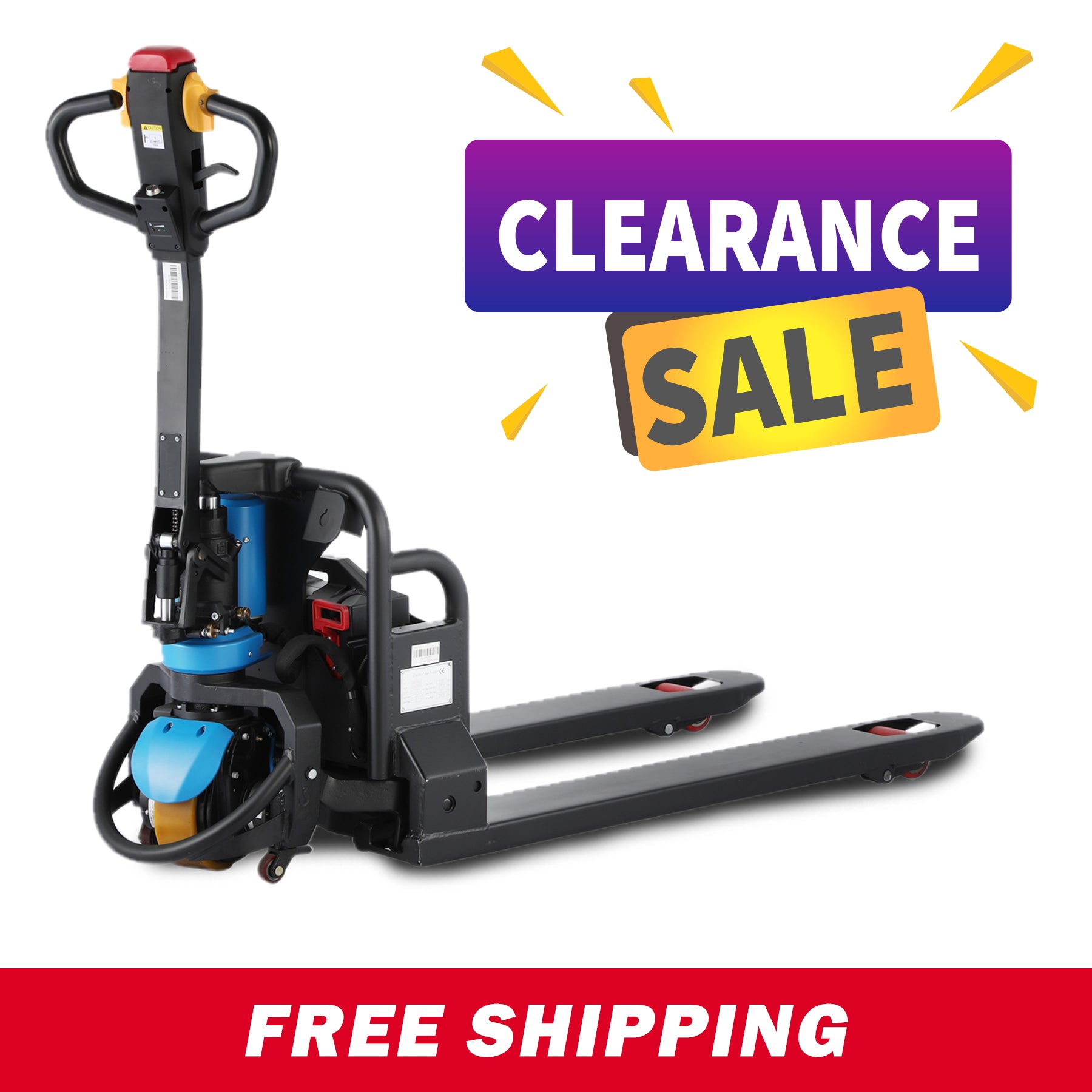

I considered a powered pallet jack but they were heavy, bulky and expensive. Lately, I've been seeing these newer, lighter, more compact and reasonably priced jacks powered by lithium batteries. I'm considering this one from Apollo:
Has anyone had any experience with these relatively new jacks? The specs are impressive and what reviews I can find are favorable, but it seems a lot to expect from an $1800 jack.

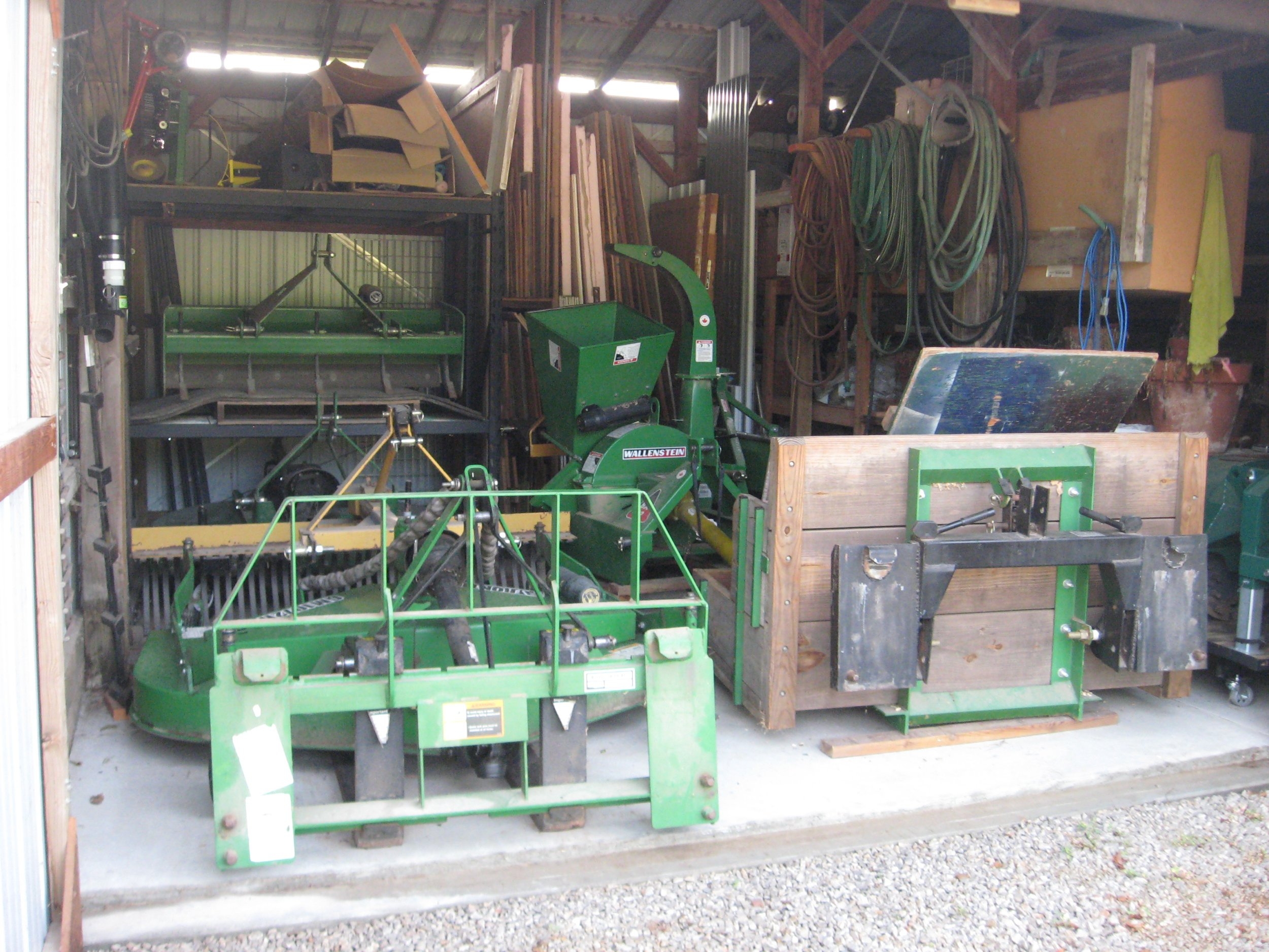

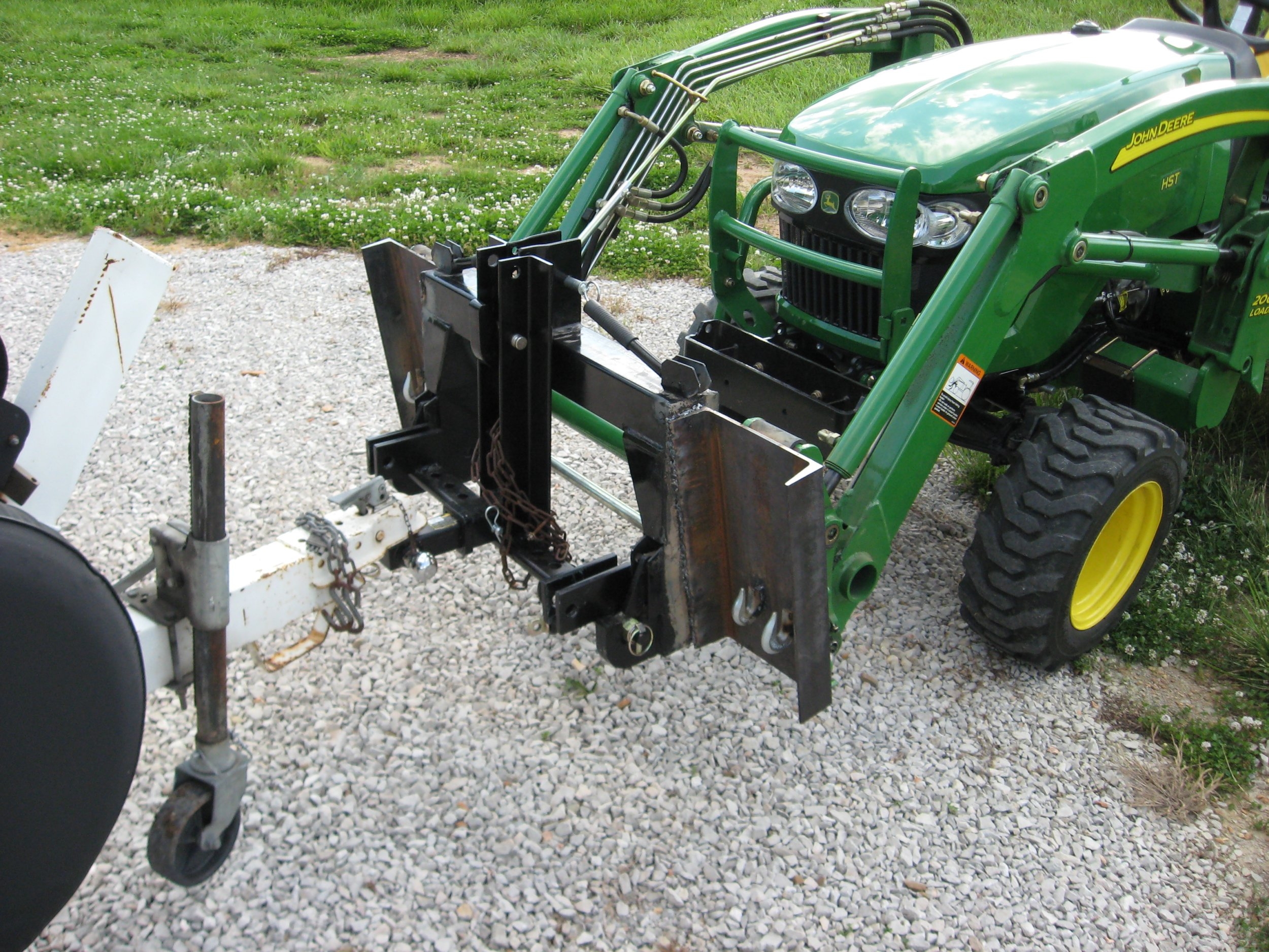

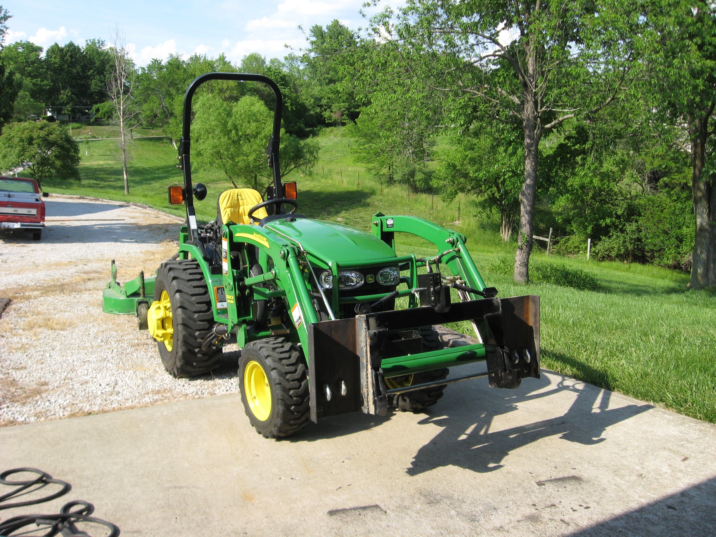

I have your exact same problem, i.e., a barn full attachments that have to be moved. I don't know if you have a quick hitch, but I do, and I made a loader-mounted quick hitch and use it to move attachments around, among other things. I never have to leave the seat of the tractor until it's time to hook up the PTO.
Obviously, this won't work if you can't access the attachments with the tractor, but all of mine are parked in line from front to rear of the barn. Sometimes I have to move
3 or 4 items to get to the attachment I need, but it is easy with this setup. I try to keep the less used items toward the back of the barn.
Looking at the last pic of my storage bay, here is what I would do to gain access to my rotary cutter, which is on the bottom, left side under the pallet rack.
1. Move out the pallet forks.
2. Grab the carryall (which is also where I store the front quick hitch as seen in this photo) and move it outside.
3. Release the front quick hitch from the carryall (OK, so I do have to get off the machine to do that).
4. Grab the rear finish mower with the front quick hitch and move it outside.
5. Grab the landscape rake and move it outside.
6. Grab the rotary cutter and move it out where I can mount it on the rear 3-point.
This works for me because I only use the rotary cutter 2 or 3 times per year and really doesn't take more than a few minutes. Main point is, I don't have to physically move anything myself, just let the tractor do the work.
Also in the picture are my chipper and overseeder, which are on dollies and can be moved with minimal effort into position to hook up.

My buddy used that type of battery jack when he worked for a freight company. He loved it until it broke but not sure what went wrong with it. Anyway, I am looking at getting his and fixing it or buying a new one.
It is not going to stall on a small stone or piece of bark like a manual jack.
He used his every day for about two years. That is a lifetime of service for me. I need a pallet jack maybe 50 times a year.
Same here. I'm not too concerned about longevity, since it will be used infrequently. I am a bit concerned about the battery though. The barn isn't heated or insulated and Lithium batteries don't like to be charged when it is too hot or too cold. I may have to store & charge it in the heated shop
That is a good point. It can get really cold in northern MI. I suppose I could use a battery blanket depending on how tight the battery area is.
