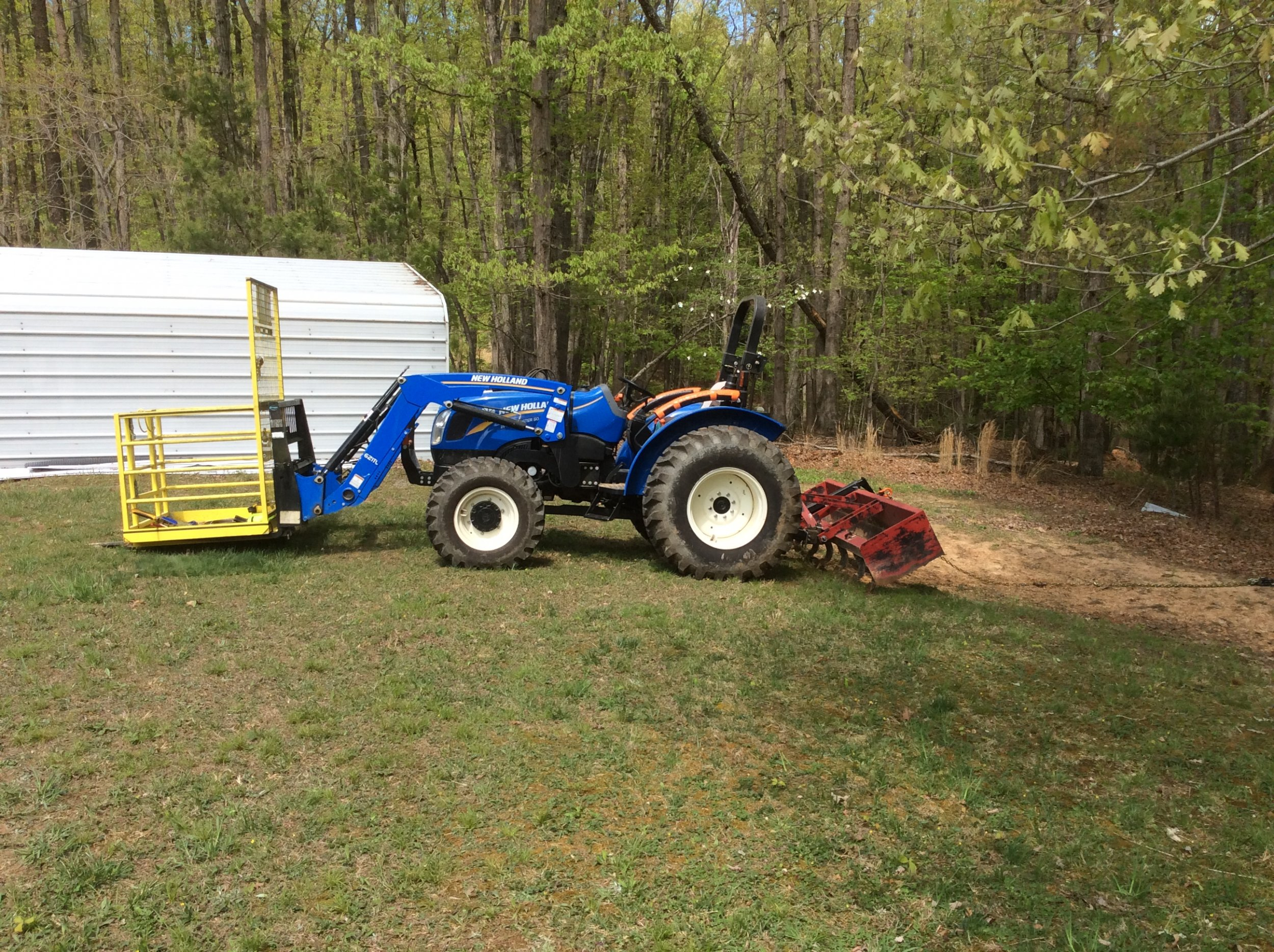

/ 2000 lb or 4000 lb pallet forks? #24
Useful for other things than lifting heavy loads...
