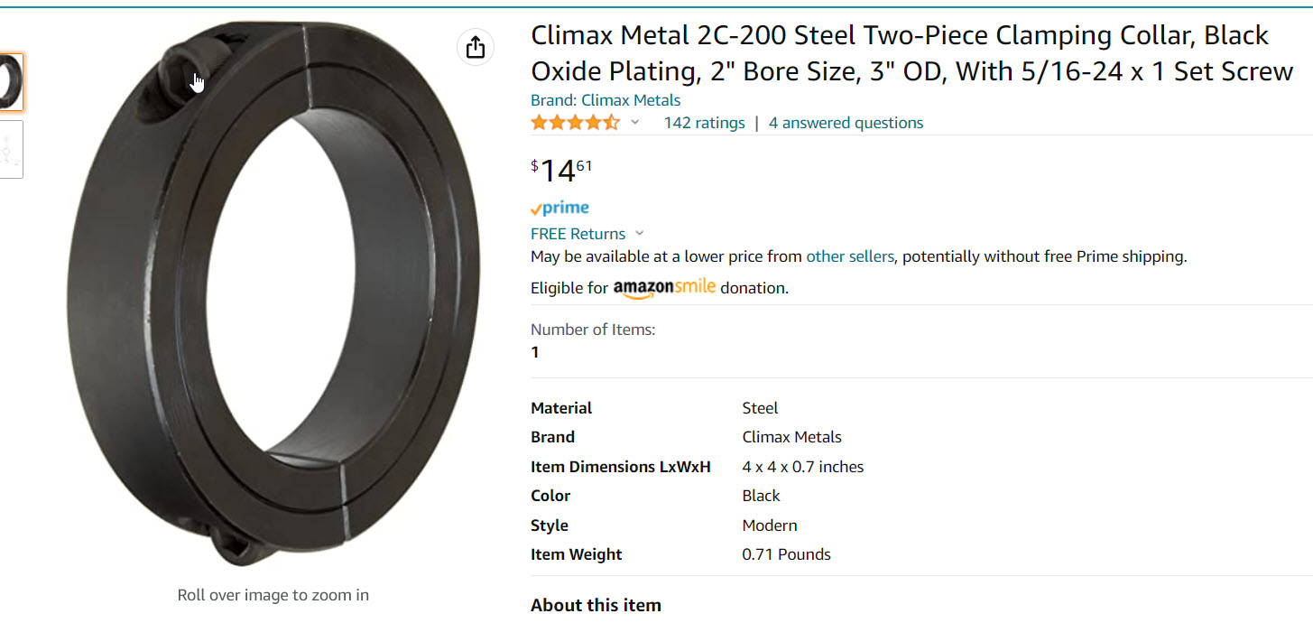

I took this, removed the screws, and installed my pallet forks. My Kioti bucket is reinforced at about a 32" spread, I put them there. This split ring is the exact size of the clamp buttons on the Titan forks. I then welded 1/2 at each mount point. Now if the forks simply loosen, they won't fall off and I'll see them wiggle and can retighten them. Sure, I could have purchased the skid loader forks but I didn't, nor am I likely to.

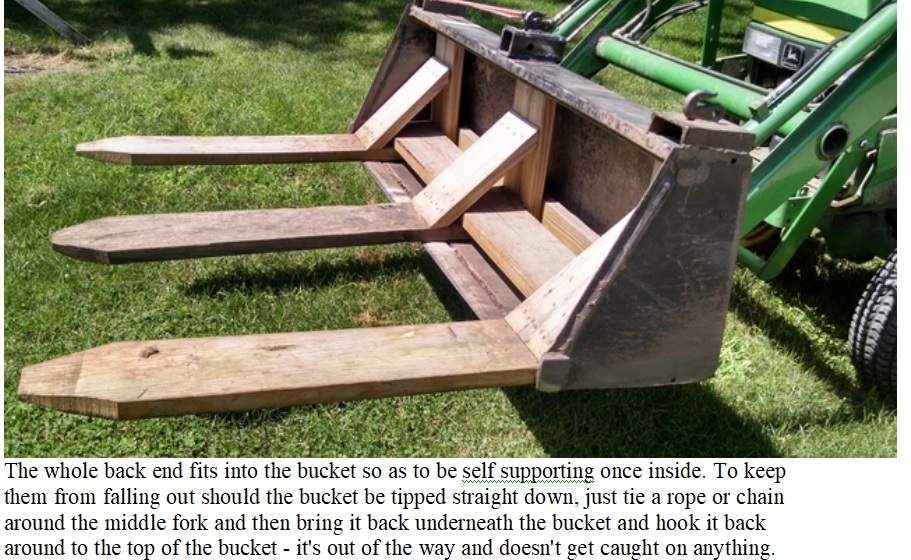

I'm sorry, I wasn't clear in my post, I was talking about the flip over forks you see on 4 in one buckets on the front of a backhoe loader, not the buckets of the actual backhoe, ie on the rear of the tractor.
Like this:
I kinda get it,and I kinda don't. It would be nice to see a pic of them mounted.

Here's the attached pictures. Please ignore my crappy welding.

Not bad and help keep the forks tight.

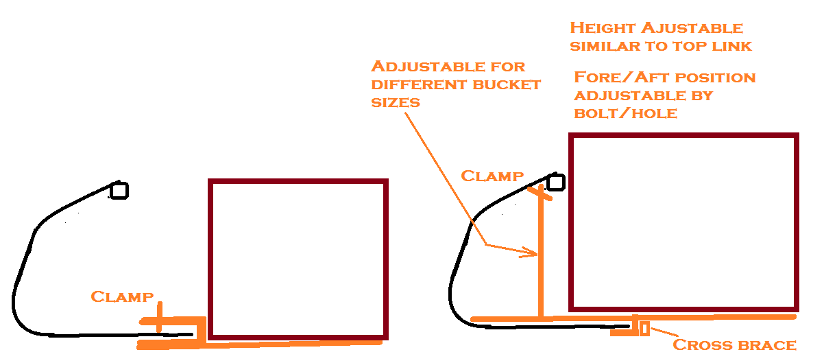

Gonna toss this out into the meat grinder to get shredded. If anybody likes it and decides to produce it, remember, I get the first million bucks. Maybe @kennyd ???
If you have ideas, let'em sail.
If you hate it, that's OK too.
Typical Clamp On Forks as shown in left sketch clamp on to the lip of the bucket with a screw clamp that prevents the load from passing that point. The entire load is forward of the bucket edge which can lead to bending and greatly reduced capacity.
Proposed version on the right would allow much of the load to sit back of the lip and against the top edge of the bucket, bringing part of the weight further back towards the pins. This would reduce or eliminate the risk of bending the bucket lip and reduce the loss of capacity.
Back end of forks would be perforated every two inches or so to allow placement of the uprights for different depths of buckets --- square holes for carriage bolts maybe. Uprights would have female threads and screw down tight on the top of the forks. There would still be a small lip over the edge of the bucket lip to help with position retention, but would bear little if any force. This could be a spring clamp/force fit of some kind. A cross brace could still be used also.
Most all buckets have some kind of top edge for strength, angle, channel, square tube, etc. Top of uprights would seat behind this edge to keep them from moving forward. Clamping force would be provided by a turnbuckle type of assembly similar to a top link that should provide sufficient force for locking into position without putting stress on the bucket.
Quick sketch that doesn't show a lot of detail. There would have to be some sort of gap between the bucket and the bottom of the forks to allow for a pallet to slide back over the bucket edge.
Too stupid for TBN????
That's definitely an improvement on the standard bolt on forks, but my only question is why this as opposed to getting a set of ssqi forks (besides price)?
