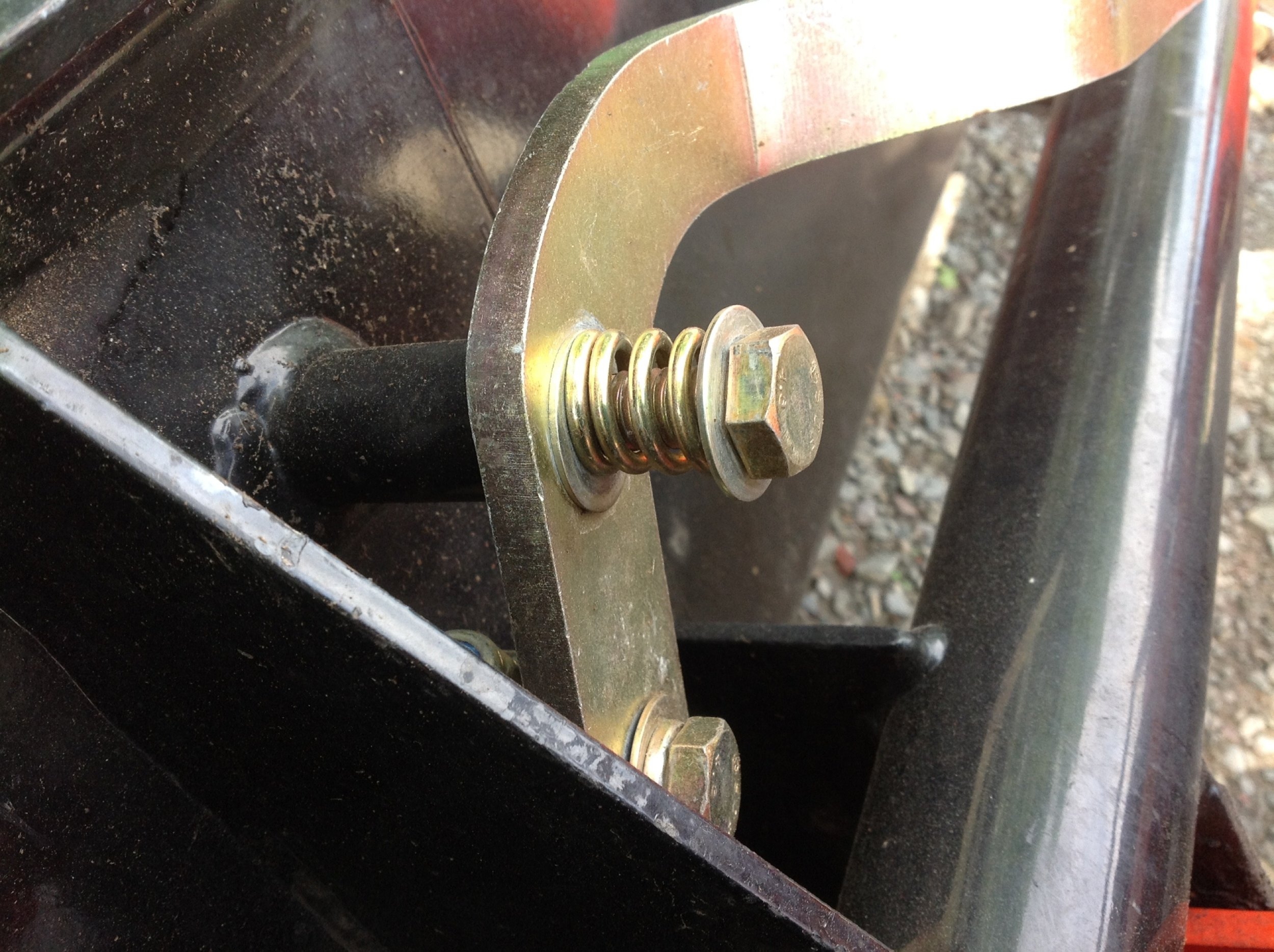

My brand new CK4020's QA handles won't stay in the up position (released). when approaching whatever attachment with the QA unlocked; movement and vibration cause either, or both handles to fall inward toward the locked position enough that I have to reset them upright. The left QA handle will not stay upright and falls. the right handle usually falls too.
I've tried tightening the nuts that tighten the spring on both 17mm(?) nuts that hold the handles snug?
Am I missing something?

How about a close up picture. Perhaps they are not assembled correctly.

Thanks guys for your replies. I'm fairly certain they are installed correctly, BUT they were floppy as heii from day one. I did tighten the spring loaded pivot bolt until more tightening would have done damage, I suspect. This approach is NOT, IMO, a solution, but a poor result workaround.

On the QA release handles, FWIW, I tightened the spring loaded bolts as tight as they could go and backed off slightly.

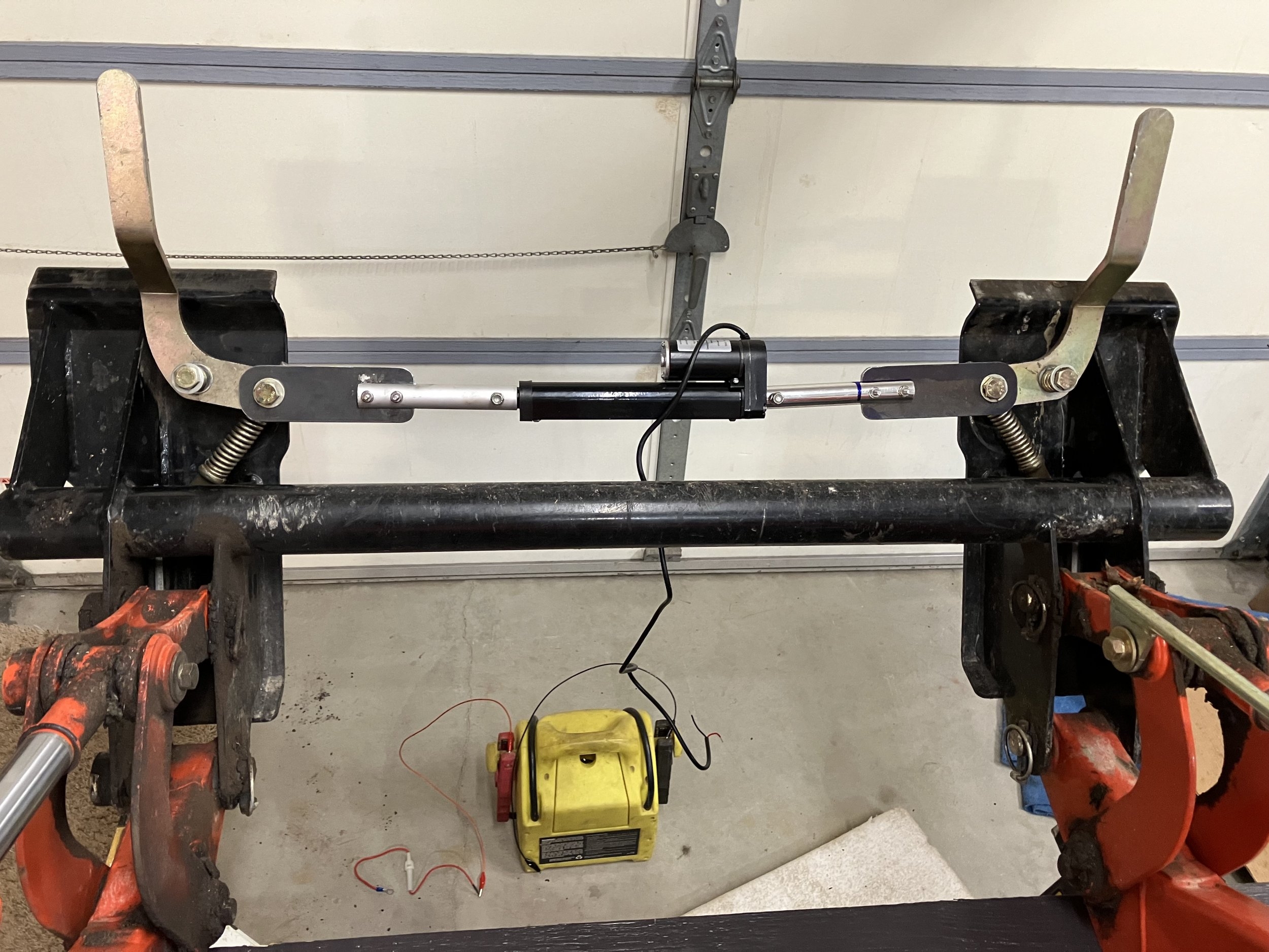

I had the same issue with my CK35 when new. There was a lock washer under the spring which just kept loosening the bolt with every swing of the handle.
My solution was to place a thin washer on each side of the spring. The bolt would eventually loosen a bit, but it took a long time.
Eventually I got tired of getting on and off the tractor to flip the handles.
I purchased a 225lb 6" stroke, 14mm/sec, 3 amp linear actuator and a switch for $50. Been working great, wish I would have done this years ago.
If you are running wires up front for a camera, add a couple more for an actuator.
Andrew[/QUOTE]
Now we just need to figure out a good way to work the third function hydraulic connections and we can get the entire change done without leaving the seat. I like that!

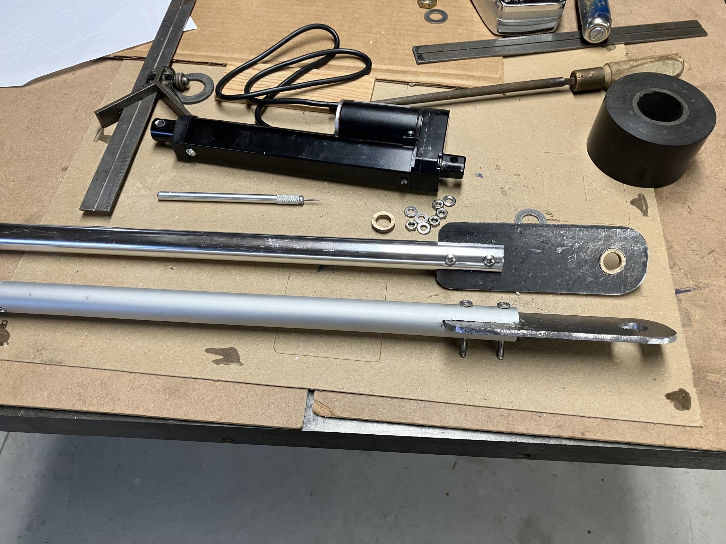

/ CK4020 QA handles flop over... #15
Amvcane,
I like it, big time.
Can you give more detail of the process, level of skill needed, etc. And what, where you got the parts to do the conversion?
Found the actuator and switch on Amazon.
The aluminum tubes are filled with wood so they don't crush where the plate is attached.
Make sure you have enough room for the body of the switch,where ever you choose to mount it.
The actuator has 2 different size studs on the ends, so the aluminum tubes are 2 different inside diameters.
This Video should answer many of the questions that you have,there are 2 parts.
