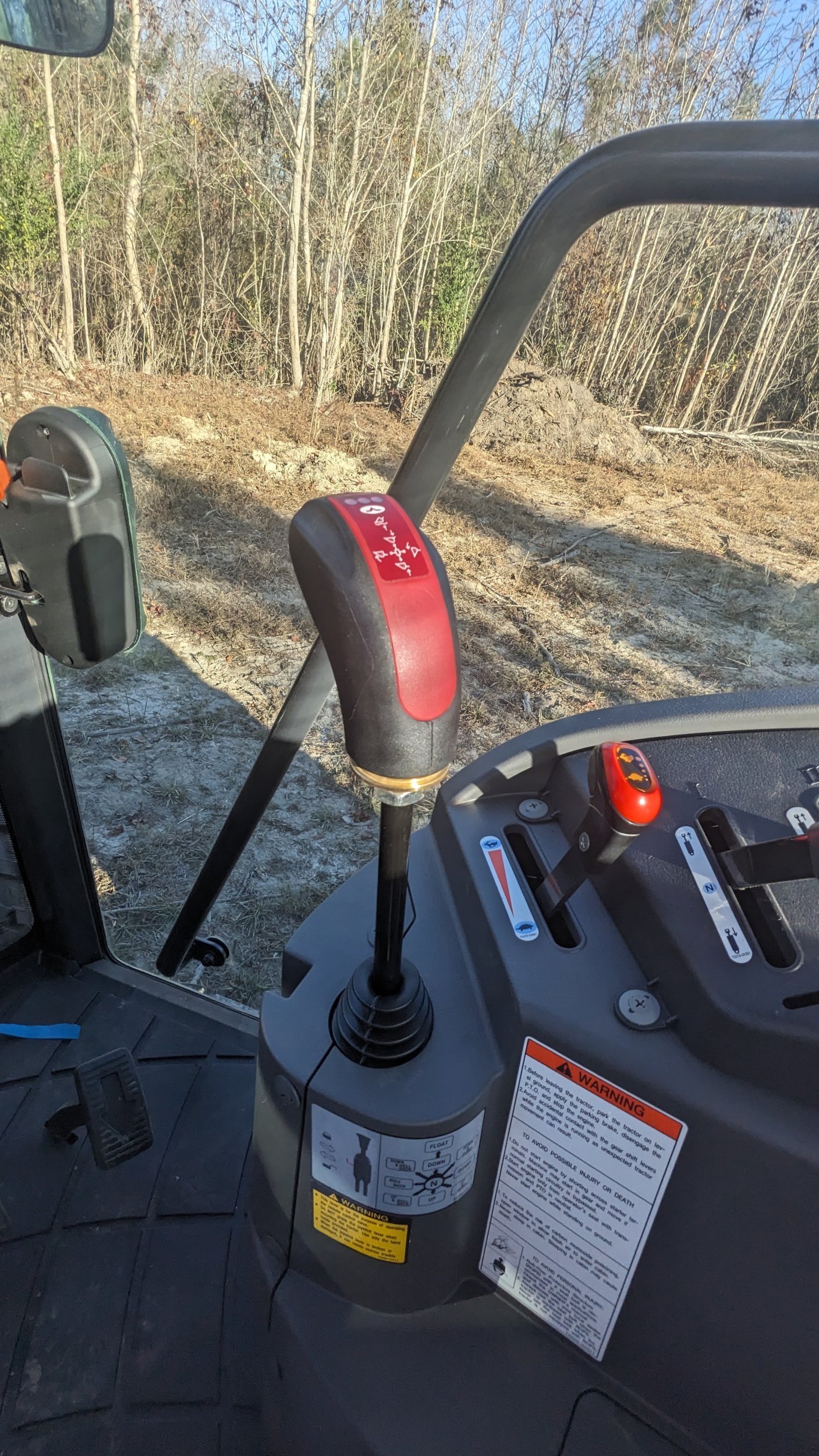

Send a picture of the joystick. Or, did you order the 3rd function as part of the tractor purchase from the dealer? The float function should be there. Lower the Loader to the ground. Push the joystick toward the front of the tractor with the heel of your hand - harder and harder until you hear/feel a snap
The detent is a bit too stiff and loud for my taste! But, float is really handy for smoothing the place where you just made a mess of the surface of the planet. Keep in mind that the rear axle controls the roll attitude of the bucket when back dragging in float mode.
man I'd love to send you a picture or even just explain it to you but I don't have a picture (and it's an hour and a half away) and I don't remember EXACTLY what it looks like as I haven't studied it and only been around it 2-3 times. After scrolling through the internet for 20 minutes trying to find one that looked close I gave up. I know the tractor loader has a directional diagram including float. I'm not sure about the joystick but I think it goes as well. I don't think I've tried getting to it by lowering the bucket all the way down and then pushing more. I think I was stupidly interpreting the diagram to mean push it further forward whilst in any position. another "fix" hopefully! You're killing it Dave! so far more helpful than my dealer. lol

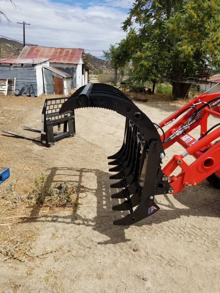

I couldn't find a good picture of the joystick. The grapple I still like is from Everything Attachments. Wicked 60. Be sure to size the grapple to your tractor. They are noticeably heavy, so don't go too big. The first picture is how I connected the hydraulic lines to the 3rd function.
Pallet forks are a must. Kioti sells a good pair. View attachment 832114View attachment 832115

oh. hey. one other question if there is anyone left. what's the situation with ordering implements online? especially in terms of delivery. my initial concern was that they were expecting equipment to be onsite so that the (heavy) implement could be unloaded but I guess they use lift gates and pallet jacks which seems obvious now. dont have much experience with such things so Im curious if they could typically unload it directly into the bed of a truck?
I had the dealer receive the grapple. Everything Attachments does not ship to rural.
