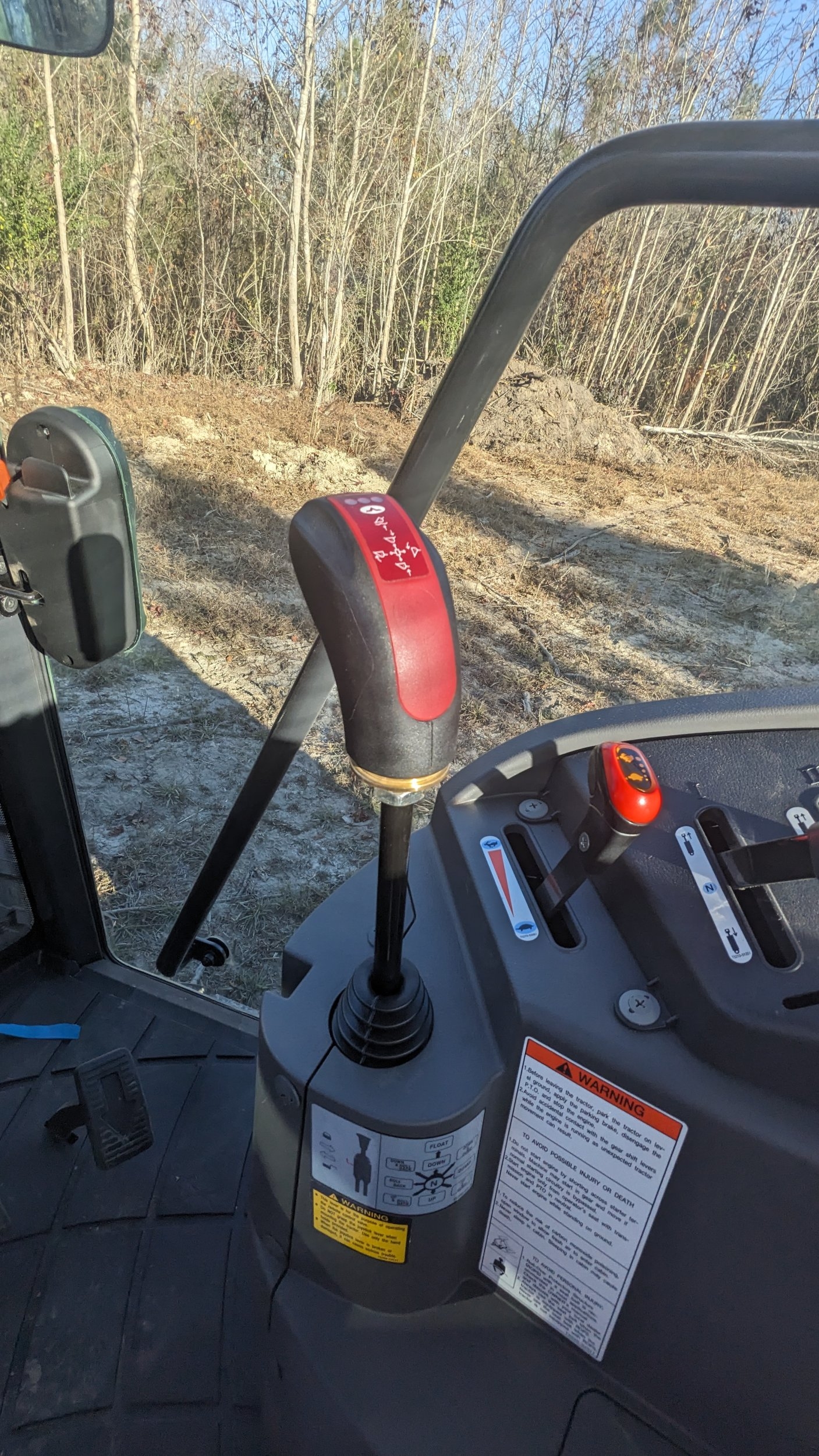

Send a picture of the joystick. Or, did you order the 3rd function as part of the tractor purchase from the dealer? The float function should be there. Lower the Loader to the ground. Push the joystick toward the front of the tractor with the heel of your hand - harder and harder until you hear/feel a snap
The detent is a bit too stiff and loud for my taste! But, float is really handy for smoothing the place where you just made a mess of the surface of the planet. Keep in mind that the rear axle controls the roll attitude of the bucket when back dragging in float mode.
I tried this again. today with no luck. the joystick indicates float. the loader and instructions below joystick indicate float but I'm not able to get to it. should it engage without moving bucket down much? I try pushing it firmly and quickly from top and it just gets to ground. I tried the same when it was on ground and it just lifts tractor up..
did get hydraulic leak fixed. just needed tightening. first time ever that a fix has been that simple.
Just FYI. I was able to get into float. I'm not sure what the deal is but it seems like the joystick is rotated or something. float is not "behind" down. it's behind down and roll back. once I noticed that I realized down wasn't straight ahead (in relation to mount) like the diagram showed. down is push ahead and to right. which makes it seem like joystick functions shifted, except for float which I can't wrap my brain around but whatever.
would guess I can loosen one of those nuts and rotate it back into a more appropriate position?
/ First Time owner questions (NS4710) #26
Yes, that is weird! Perhaps the control cables are out of adjustment so much that all functions of the joystick are rotated?
