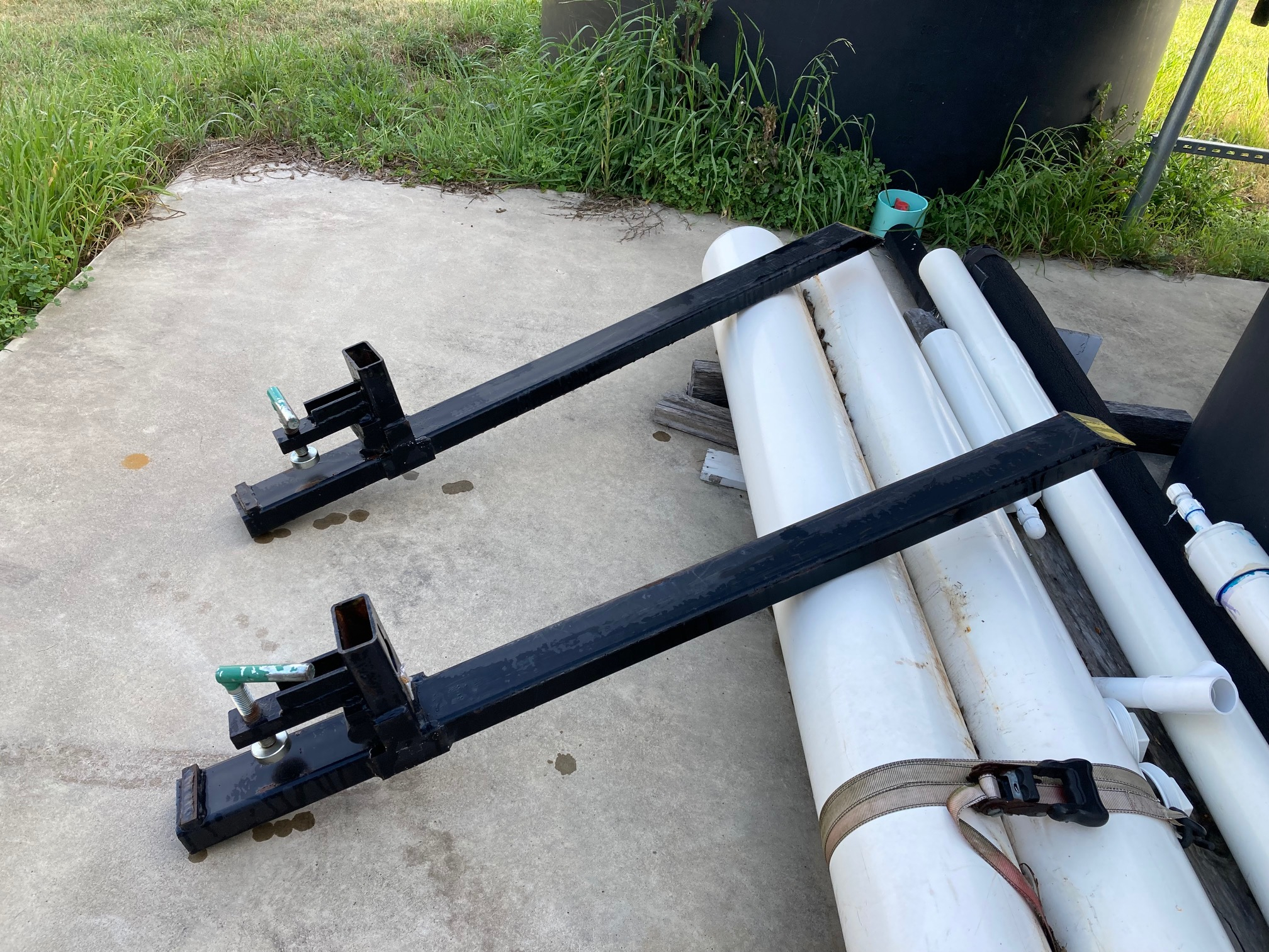

I bought a set of "Titan Attachments" pallet forks for a couple hundred bucks from Amazon ("free shipping!"). Another of those things that once I used 'em I can't figure out how I lived without 'em. No, they're not for everyone, yes the "quick attach" kind would be way more convenient, but for occasional use these things have served me well. Handle all kinds of awkward loads (pipe, fence posts, metal panel siding/roofing, ...), self-palletized loads, unloading LTL truck deliveries, tree trunk work, ... Yes, the strength of the forks greatly exceeds the lifting capacity on my Jinma's Koyker 140 loader, but so what. Yes, the clamp-ons will move side to side on ya if you're not careful -- one trick I learned is to tighten the heck out of 'em with a hand sledge -- not a rubber mallet, a hard heavy hammer. What's that big ell-bar on that clamp screw for if not to beat on? ;)

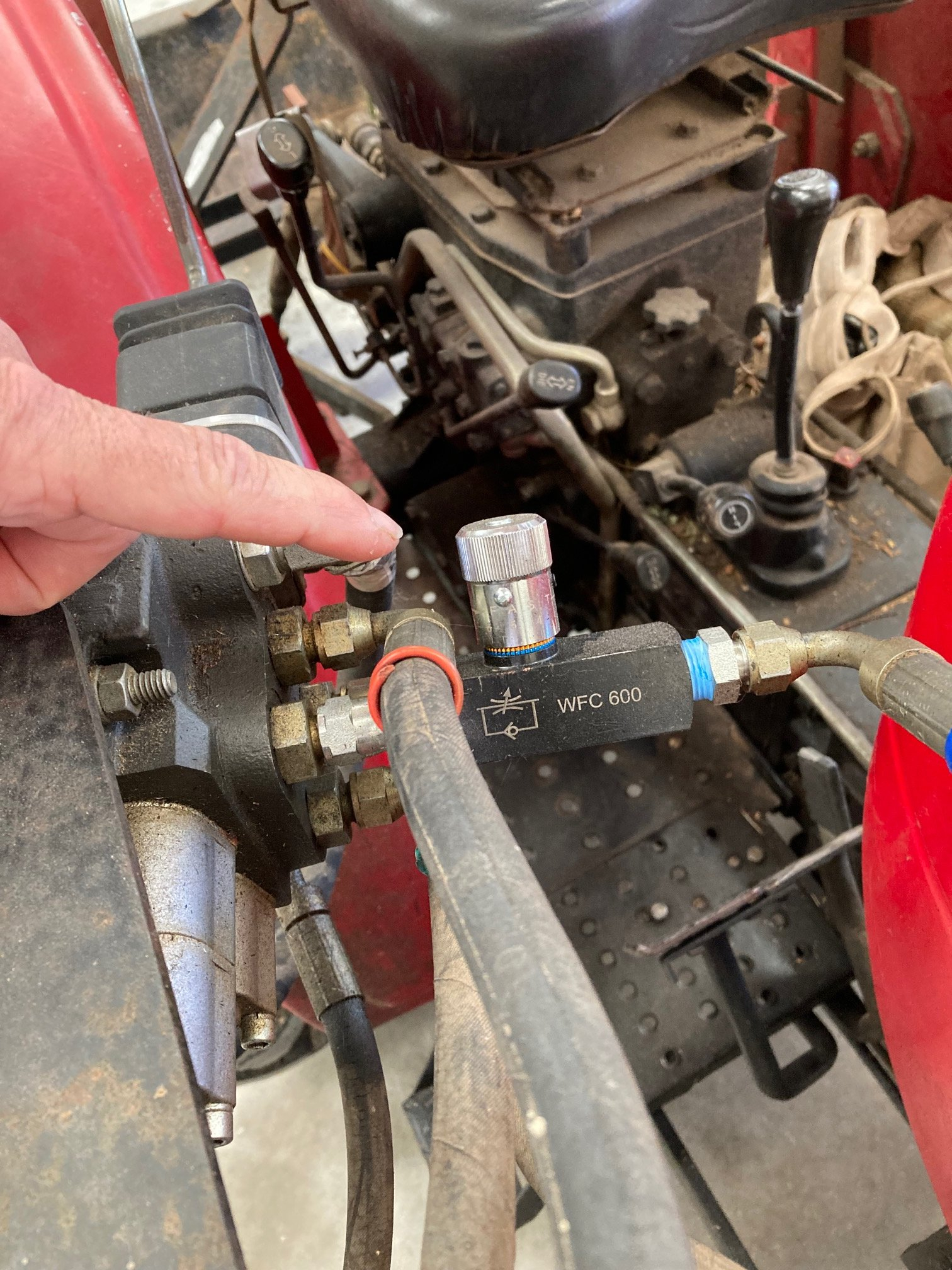

One problem I did encounter (on my loader, anyhow, YMMV) is that with the load cantilevered out there ahead of the bucket, it can drop FAST even if you're careful with the loader controls. This had been happening even with bucket loads ever since I replaced the joystick valve, but the pallet forks really show up the problem. Dangerous to property, life and limb. I solved this by putting a flow restrictor in the loader hydraulic line.

The flow restrictor sounds good as well was it difficult to install and werrtheir modifications needed?
Mine was easy to install. The flow restrictor itself doesn't come with fittings, so you need to buy them for your particular equipment. It's convenient to install it near the joystick as I did, but it doesn't need to be there -- you can put the anywhere in the line where there is clearance. You need to figure out what line you want to restrict -- lower, or dump, or both (both would require 2 restrictors). I just restricted the "lower" direction. It restricts flow in only one direction, kinda like a check valve, so you need to put it in the right way. In other words, you want to restrict "lower" but have full flow on "raise". And of course use standard hydraulic system best practices on the install (incoming lecture on using teflon tape on hydraulic NPT threads in 3... 2... 1... :ROFLMAO:).
All that said, I would not even put in a flow restrictor unless you need it. You'll find out with the first heavy load you lift. I didn't have the fast-drop issue with my original valve, it showed up only when I replaced it with a supposed "work-alike" valve because I broke the original valve. Don't ask me how I broke it, my screw-ups are nunya bidness :LOL:.
