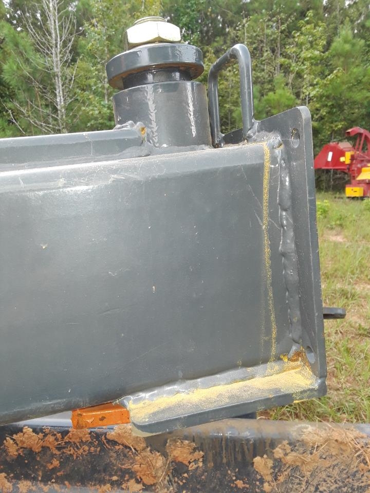

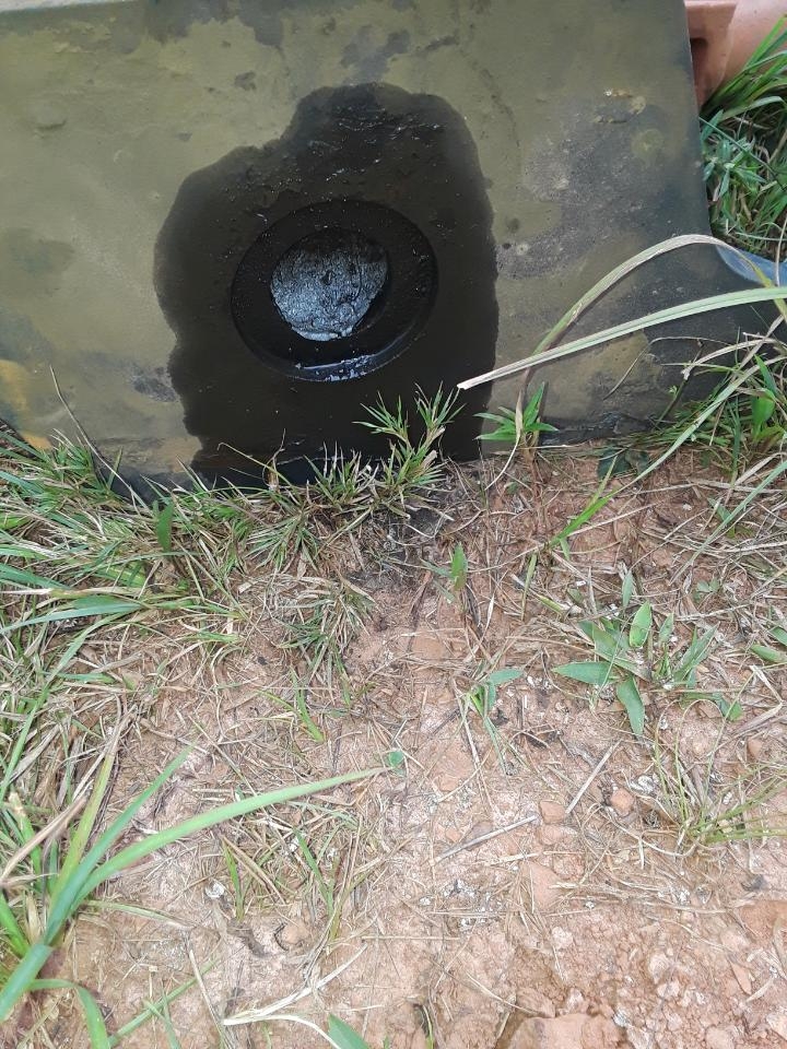

I also bought Titan's 8' hydraulic rear blade. Due to some health happenings and other commitments I didn't actually use it for over a year after I bought it. two weeks ago I used it for the first time for 4-5hrs. The next day I decided to go over what I did the previous day in one section. There was an old stump about 2 1/2" in diameter that had been buried. When I was making that pass the blade caught it and snapped the main blade pivot pin which is a 1 1/2" diameter solid steel.
I couldn't believe that it broke it. It caught the top edge of the stump and the blade jumped over it. It wasn't like I had the blade dug way down and hit it and it stopped my tractor.
I called titan and told them I only used it 4-5hrs. They said too bad it was over a year by about 6 weeks. The main pin is part of the blade pivot assembly. I had to buy a new one for $500.00. Put it on today.
Remind me to dig up photos of a "better brand" blade that got bent to crap - without hitting any stumps.
Not being a fan of warranty claims I ended up adding (much needed) material in the area of the pivot pin, mimicking an RV 5th wheel if you will.
Bad designs aren't brand specific.

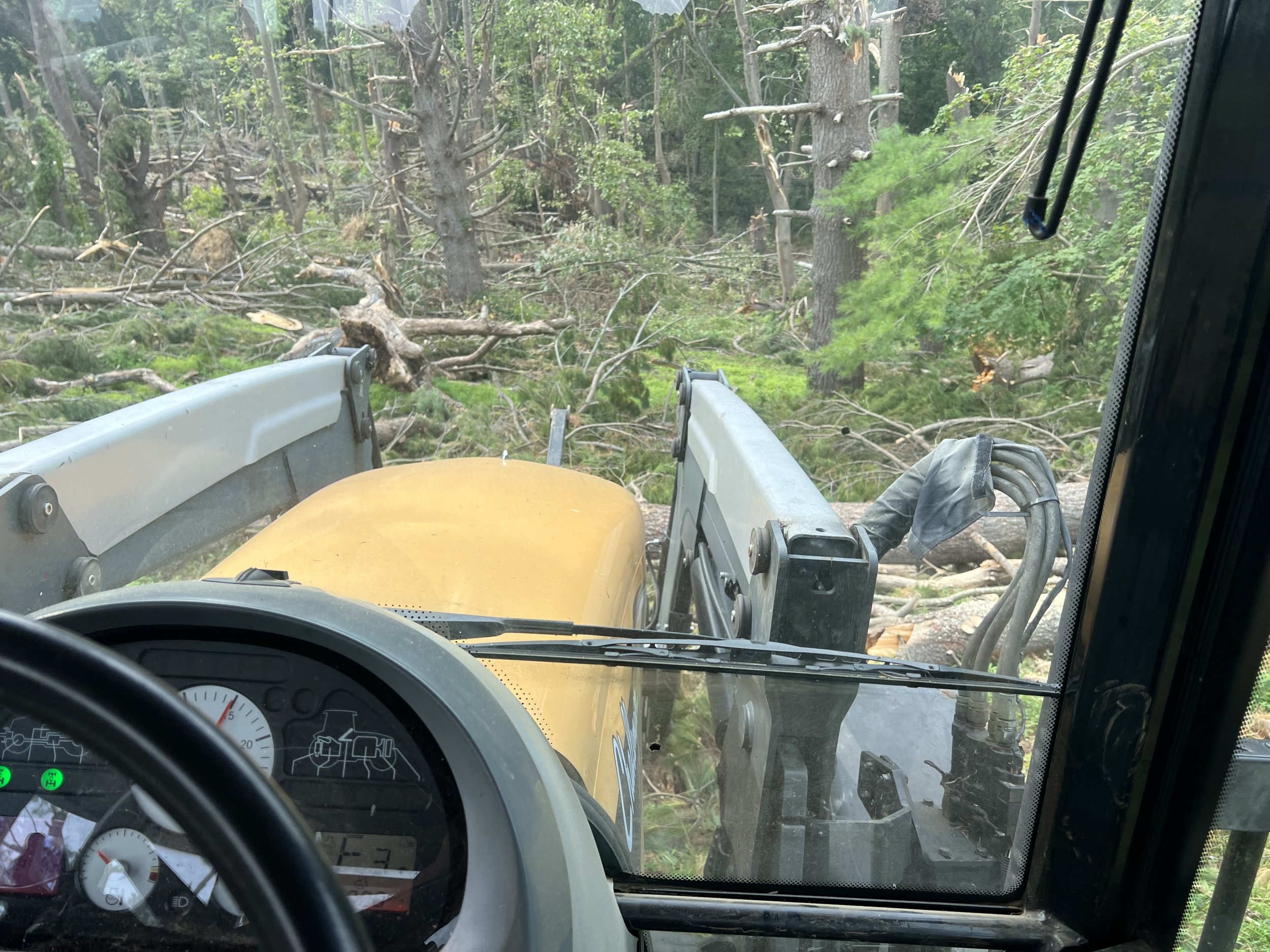

Do an experiment. Tape some 36” sticks to the inside back of your bucket, like the pallet forks would be positioned. Do the same with 48” sticks. Get on your tractor and see if you can see the tips of the sticks. If you can’t see the tips from your tractor seat, think how hard it would be to use them.

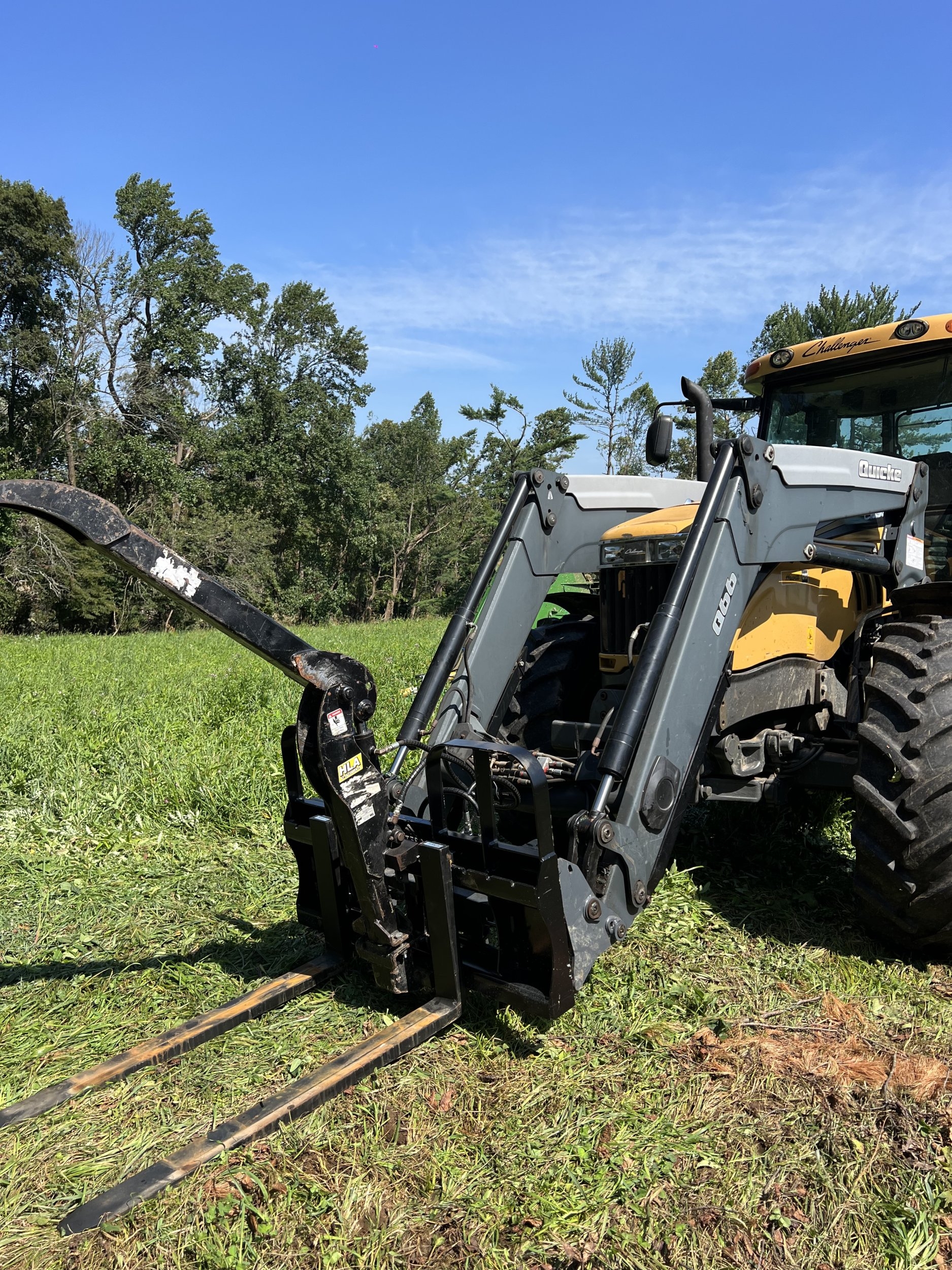

We have a couple of titan attachements, 36”pallet forks and the 72”finish mower for our jd3320 the tips are hard to see but they can be seen,however I did have to grind one pin to get it to fit the hole, I use the forks for logs and such,work just fine. As for titan them selves,my experience has been awesome,we had a wheel bend on the mower and they sent out the whole arm assembly with 2 wheels. I WILL buy more from them.
