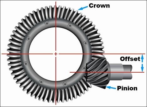

Egon's request for "diagrams" had me doodling on a bit of scrap paper.
IF one can get over that silly notion that the tractor front end is some how lifted by the pinion gear climbing the ring, a simple vector diagram allows the LOAD to pull on a stationary tractor with equivalent results to the opposite. In fact, the tractor engine need not even be running, and the transmission can be in neutral. The BRAKES must be set however (or the axle shafts welded to the housings ;-)
In such a diagram, The ONLY vector opposing the "pull" from the dynamic load is AT THE TIRE CONTACT with the ground, Opposite and equal to the horizontal component of the "load" vector, regardless of the height or direction of the load vector. Also, infinite tire traction is assumed (right up to the moment when the load lifts the rear wheels off the ground, should that condition exist.)
Something to consider
With the tractor in gear, clutch out and motor running the pinion gear is turning!

Silly Rabbit,,, you cannot discount any notion that best suits your ideas. And you also cannot add notions that no one else is talking about.....
Everyone in this thread except you has fully embraced the concept that the front is in fact lifted when power is applied.

You can call it pinion gear climb or I call it rotational torgue. It make sense and all the physics world supports it that the front end will get lighter as the power is increased initially. As the tractor starts to move the rotational torque decreases but, it is always there, however small that it is.

OH Now I see, You mis-understand.
I do fully embrace the front end lifting when power is applied and resistance is present.
But the reaction occurs at the GROUND. Not at the pinion. As I have repeatedly stated. The pinion forces are taken out inside the transmission. It is only when the WHEELS try to move relative to the ground that ANY forces appear outside of the tractor. For the WHEELS /TIRES are the ONLY part of the tractor that can apply "tractive force". Without that, no other forces can be generated that will disturb the motionless tractor.
Silly to believe otherwise
Absolutely!.

Pinion forces taken out inside the transmission is pretty sure to happen in neutral. If you want to move the tractor there better be some pinion forces. Note, when converting the forces that pinion/ring gear combination turn into a mighty long lever!
Or better yet go sit on a tractor and pull a heavy load! Get some insurance first tough.

What you say is true about long levers, but where are no fulcrum within the tractor that will lift the front end. Perhaps the lever is located somewhere else. A more accurate discription of the location is wanted. Could it be under the front axle? It is so long, It must be obvious..... Nope! Not there..... Where Oh! where could it be? Where could a long lever be hidden?
There are many options to ring and pinion drive, all with the same reaction components that will tip a tractor over backwards when forward motion is inhibited.

The fulcrum is; why it' hidden and disguised as the rear axle. Meanwhile that lever keeps hiding between the ring and pinion gear ratio's that play with engine's ability to rotate it's crankshaft. Call it a wound up worm hole!.
You may also note the engine is so fastened to the tractor so that when the crankshaft turns the pinion turns. Provided that the power distributing gears and shafts are all in order and turning.

Pinion connected to the pinion housing connected to the axle housing connected to the frame (either solid or springs). Frame goes all the way to the front bumper, which would make it a long lever???

Right back to the point.
IF the tires and wheels are not allowed to turn relative to the tractor chassis, leaving only the reaction at the ring and pinion, that long long lever, does absolutely NOTHING.
Yet if a lever is applied at the same locked tires/wheels, Over it goes ;-)
Simple
I suppose we could move up the line and say that is the piston pushing on the connecting rod that causes the turn over, for there are the "head waters" of all subsequent reactions.
But alas, the cranks on "most" tractor engines are arranged 90 degrees to the desired reaction, and this just leads to confusion for the "pinion climbing" to explain.
What is needed is direct coupled steam power. Maximum torque at minimum revs. No confusion regarding the gearbox there ;-)
Might as well describe what is really taking place ....;-)
If the load lever is longer than the pull lever, no amount of pull will tip the tractor over backwards. For it is the pull that produces the load. Despite the futile antics within the differential.

The complete tractor rotates on the axle that is in the center of the tire. And it's those futile antics of a turning pinion gear that make it possible.
Ever heard of recirculating ball gear box or right angle gear boxes?
