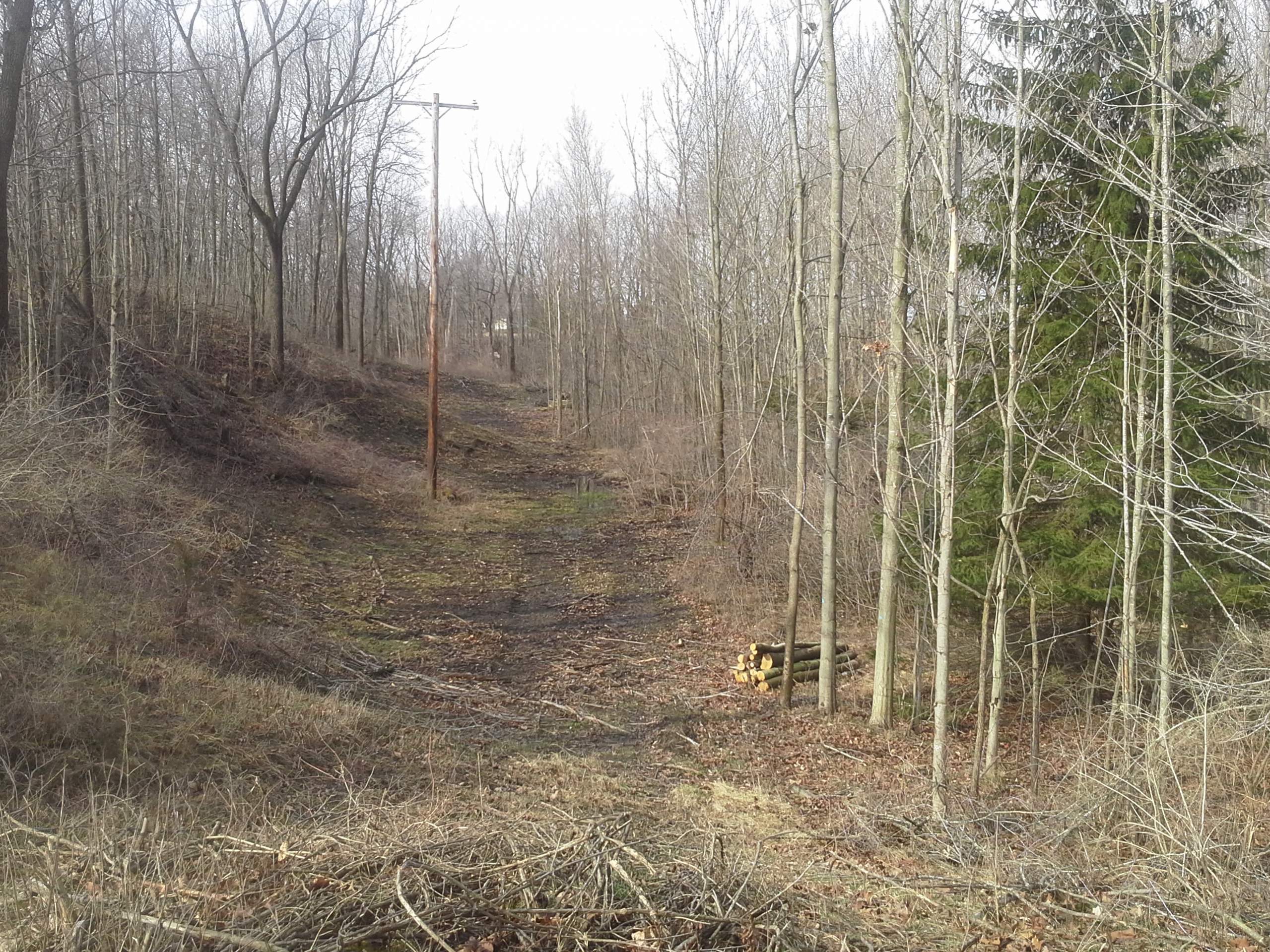

The entrance into to low area from the top looking down on a 2nd pile of small logs. I'll start with these in small loads and gradually increase the number of logs per load to get a feel for the task.
Brought this pile out this morning chained to the FEL in one trip after making a dry run empty. Low range, 2nd gear, 2000 RPM, 4WD & diff lock engaged the whole way. This was maybe 600 -700 pounds and very close to the limit of what the tractor will haul up the hill using the FEL. Had power to spare, but the back end got pretty light. Definitely going to need that log arch for the big logs.
