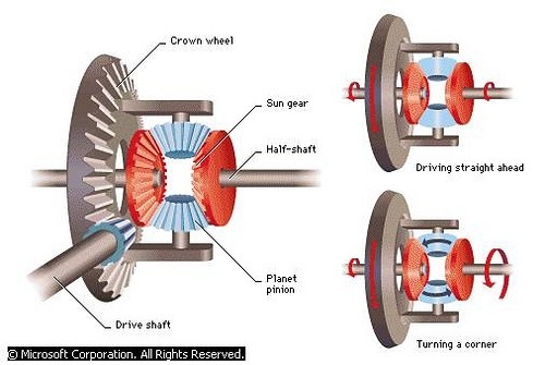

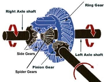

Well, for the hydraulic motors at each wheel it depends on the gearing setup.
In reality I see vectors not levers. Some mornings maybe an elephant or two!
For a regular tractor you got:
Load lever A variable dimension of vertical and horizontal force vectors that depend on the angle of pull depending on how the tractor is sitting.
Wheel radius lever
Ring gear diameter. This gear is fixed to the axle via another set of gears.
Pinion gear diameter. This one transfers the engine force to the ring gear and has the ability to rotate around the axle. You will note that the pinion centreline is fixed to the frame which is fixed to the axle housings which hold the axle bearings allowing the axle to rotate in the bearing. Stop the axle rotation and the tractor frame can rotate around the axle. Bearings help that out a lot!
And the distance from the center of mass to the rear axle. The force vectors exerted are functions of sine and cosine angles the tractor has to the horizontal.
There are even some spyder gears mixed in there.

Lets put some numbers to it so we can check whats happening; 1] Diameter of Ring Gear = 1 foot, 2] Diameter of Drive Wheels = 4 feet, 3] Torque on Axle = 20,000 ft-lb.
,,,,In order to impart that torque to the axle the ring gear face must be pushed downward by the pinion with a force of 40K#. There is the potential for this force, but since we have not applied a load the tractor just glides forward in lo gear. No force since theres no opposition to movement. ... Now we stop and apply a resistance to tractor motion. We apply this resistance to the end of a rigidly fixed lever extending straight down to the ground from the tractor body directly below the axle. The distance from the end of the lever up to the axle is 2 feet - the wheel radius. The tether runs straight back, horizontal and at ground level.
,,,,Now as the tractor moves incrementally the force and torque builds until 20K ft-lb is being imparted to the ring gear ... and consequently the axle and onward to the wheel. Since the wheel has 2' radius the rearward force it delivers to the ground is 10,000#. The tractor tries to move forward, but the tether resists that force with 10K# pulling back. The lever it acts on is 2 feet long so the 10K# force on it produces a torque reacting into the tractor body of 20,000 ft-lb around the axle. This torque acting at the point of pinion/ring gear drive - 6" from the axle center - puts a downforce on the pinion of 40,000 lb.
,,,,,,,,,,,,,,ANY other set of numbers would produce the same balanced result. Its the way it works.
