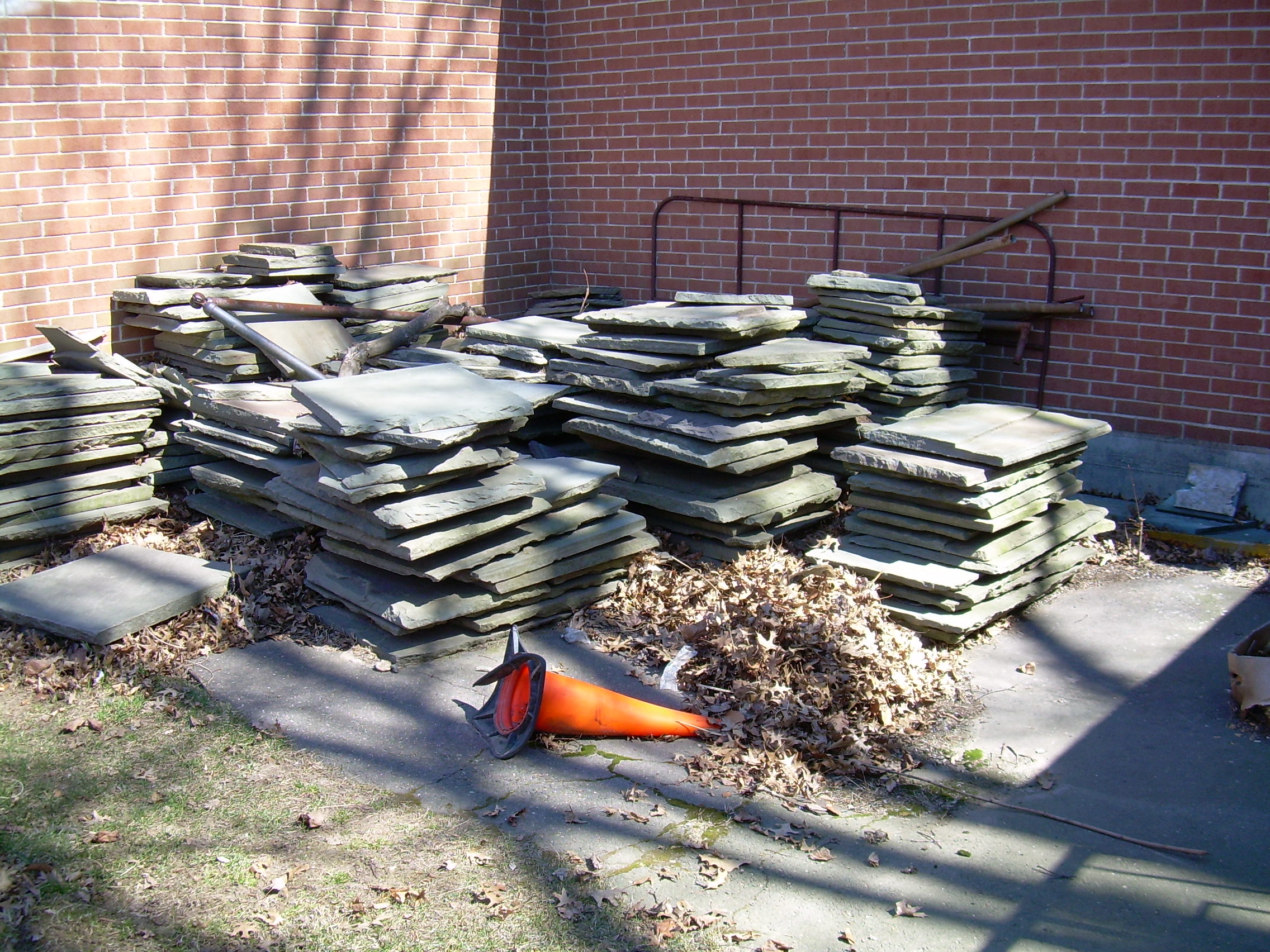

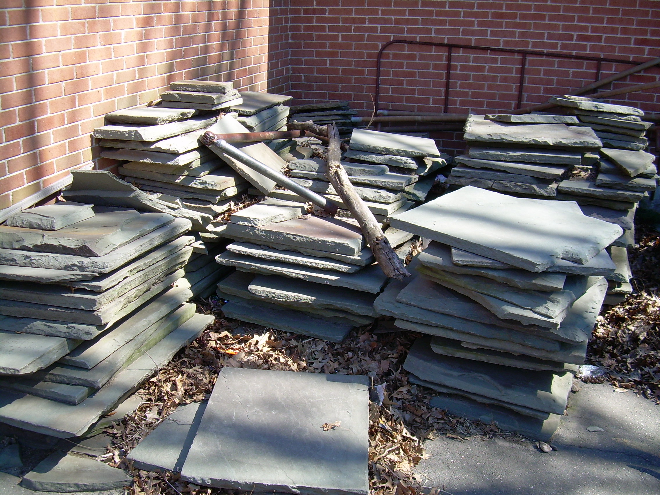

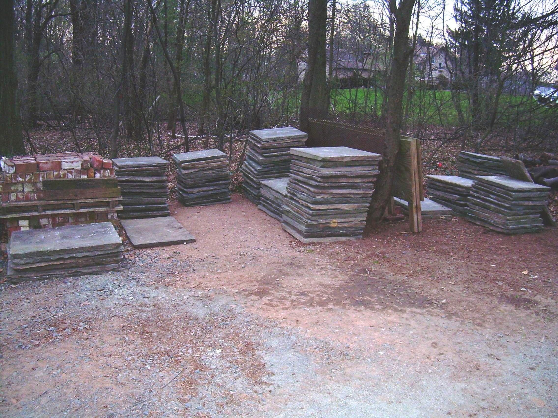

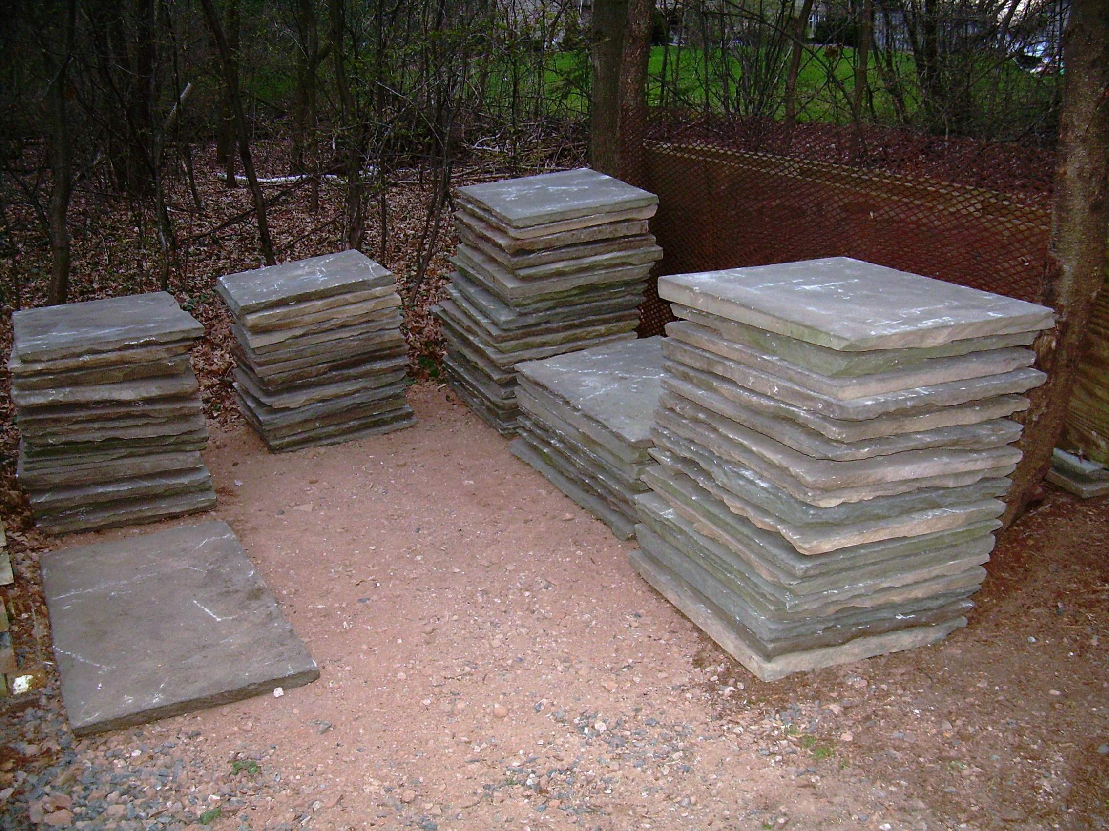

SWMBO (love that one) wants a patio, I've got the time as contracting business is slow, got the stone for barter, beautiful heavy blue stone, was at a convent and they had to remove it to install a play yard for the daycare that's there now. It's been piled up for 20 years, had my eye on it, when they asked me to do some minor work I asked for the stone, they were more than happy with the deal as they were tired of looking at it. only cost me about $300. to do the work.
So the question is, is there a simple program to lay out the stone within the dimensions I want the patio, tried cutting little pcs of graph paper, but that's not working. This stone is 1.5-2.5 inches thick, to heavy to place down just to see if it works and move again and again. I've got to have a plan as to where each stone will go, already handled them 4 times just to get them home. Will use tractor for all prep work and use forks to move them to work area.
There are many sizes but all are 24" wide, and all come out to an exact sq ft dimension, so there must be a formula to lay out randomly, I know it would be easy to lay them all in straight lines, and wouldn't really need a blue print, but then there would be straight lines every 2 feet all the way across the patio, would like to break it up more.
The sizes and quantities are:
24"x18" = 30 pcs.
24x24 ----23 pcs
24x30 ----43 pcs
24x36 ----15 pcs
24x42 ----10 pcs
This all comes to ~550 SQ FT I want to build a 20'x24' patio which is 480 SQ FT so I should have enough to do what I want even with the random pattern.
I also have 200 SQ FT of 18" wide stone if needed, and some monsters 3'x4'
Any ideas on a simple to use program that I might already have or free to download? I have the deluxe office edition of MS word, never used much of it though. never done any CAD work.
Thanks, JB.

what a great find. Blue stone is not cheap. I would love to come upon a find like this. I would not set up for any particular pattern and just go randum and don't line up four corners. All your joints should be "T's".

Thanks everyone for the replies,
I'll start at the tile shop I've done business with before.
I'm sure the cost of this stone would be considerable, once in awhile I have to buy 1or 2 pcs for a repair and it's $25-40. apiece, maybe twice as much for the bigger ones.
These stones will not be mortared but set in stone dust over a prepared base. There's just no way to start placing them to try and see how they look, they are way to heavy I've got to know where each stone is going to be placed before we get started.
Me and my helper had all we could do moving these things, all except the smallest ones require 2 men to lift and some are real BB's.
If I have to I'll put them in a straight line, with all the different lengths there would be random end joints but will have straight lines every 24" but in 20' that's only 10 courses.

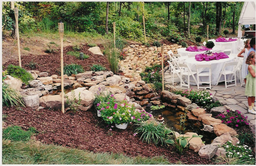

Looks like flagstone? We (I) put it down also however, ours was irregular. What made it interesting is on the parts where the wife was helping me we'd have a spot for a stone...look at it and say "honey, have you seen a Texas or Ohio????" and ended up using the states as descriptions to the shape we needed.
Of course, the person who was asked the above question, ALWAYS responded with "why yes, honey, I have seen a nice stone over here...would you like me to bring it to you sweety...."
Seriously... we never ever vented our frustrations with laying 20 tons of the stuff.... would I lie to you?!! :rolleyes:
Crud... I can't find a quick picture that really shows the back patio. you can see it but it has tables all over the place (taken day of our wedding which we held on patio)
