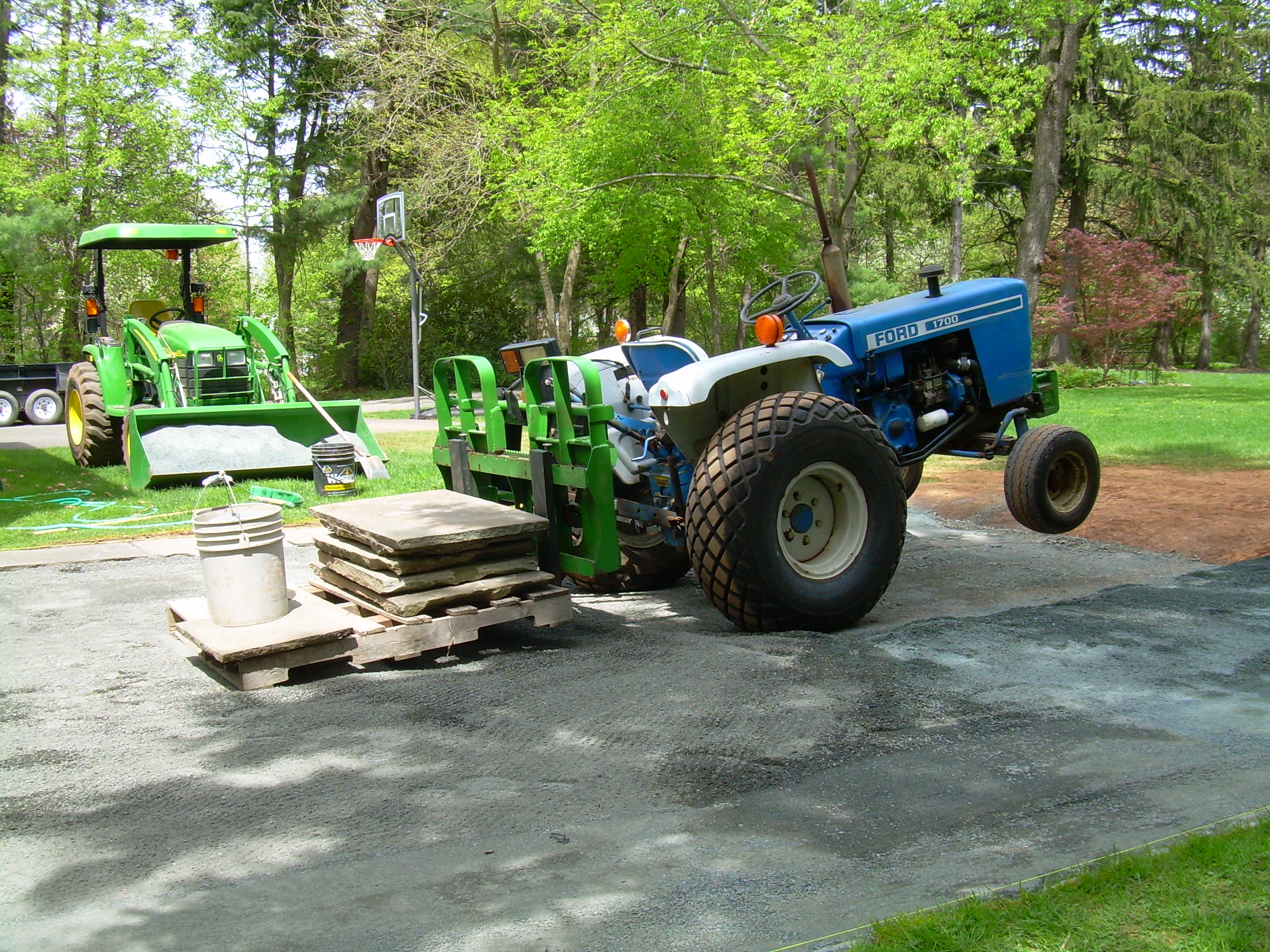

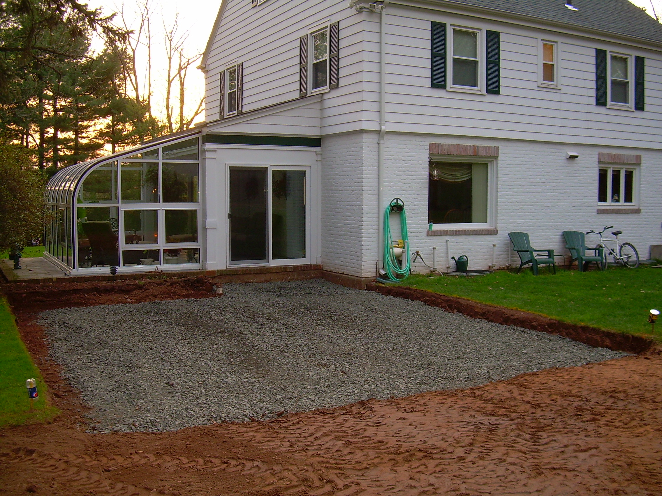

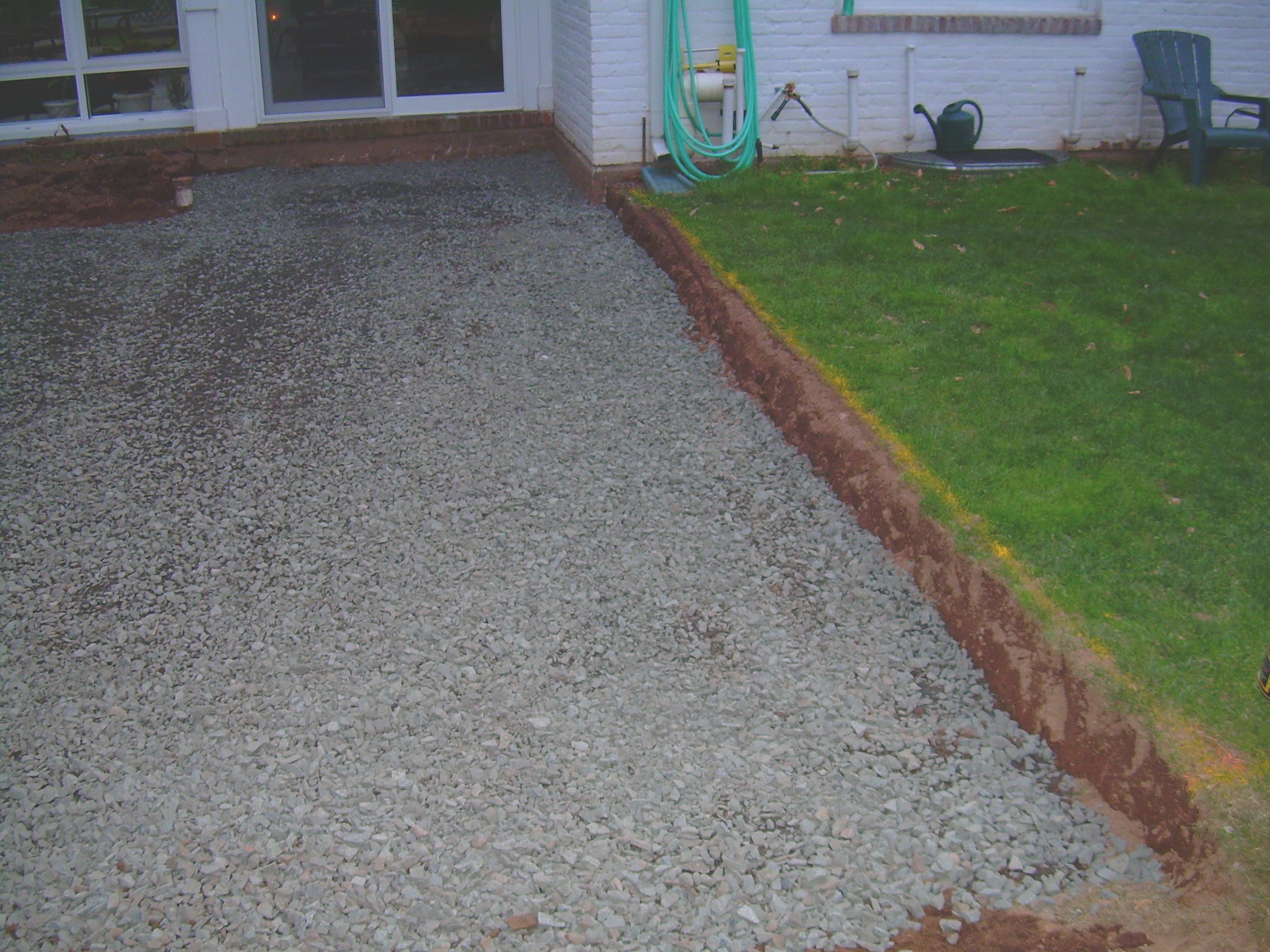

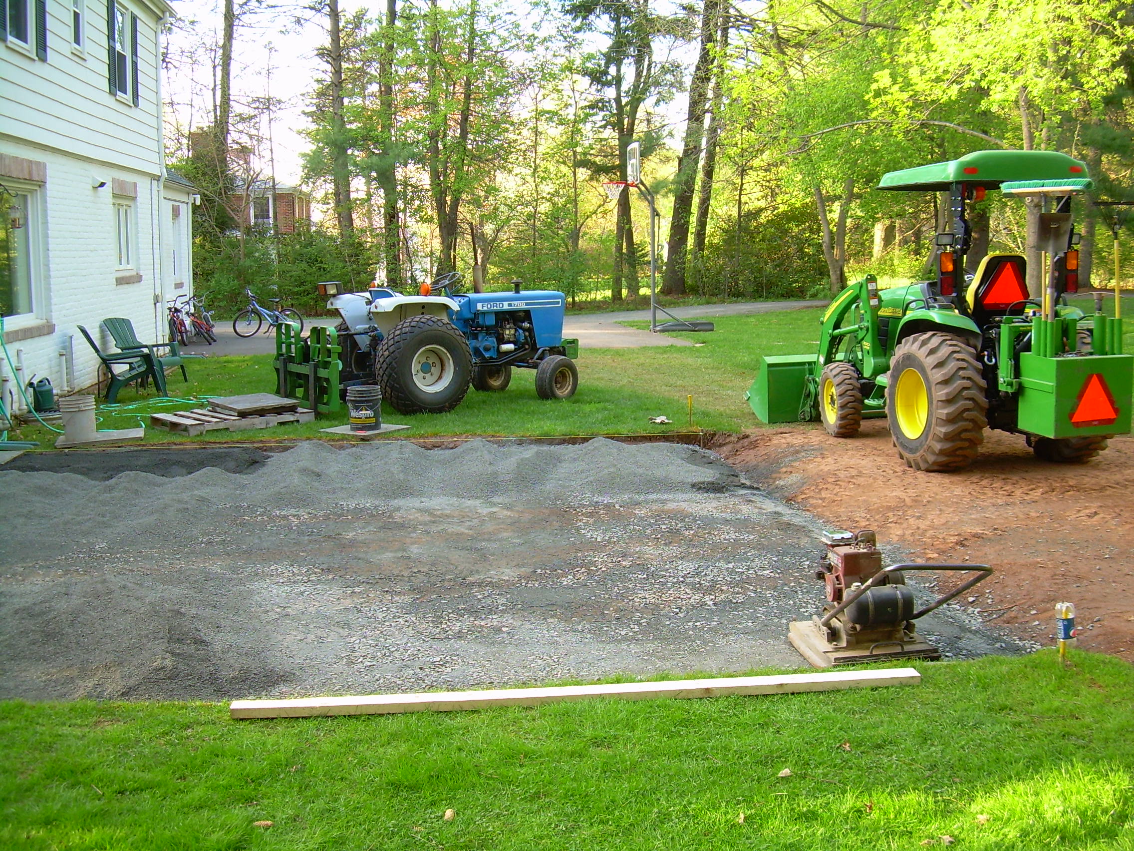

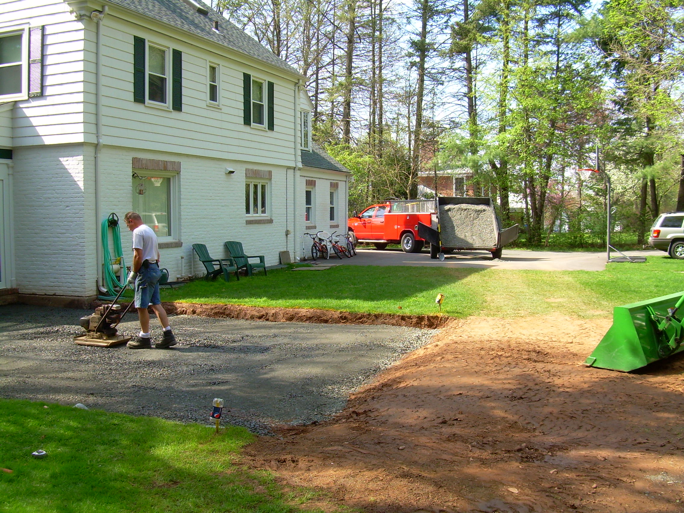

Don't think I'll have weeds for a while, no organic material :eek: got carried away digging!
There's different names for the material depending on location, around here we call it process, which is larger stone mixed with smaller, down to dust.
It's also called road base, compacts like a son of a gun. I'll put that down first, about 4-6 inches. Then top that with stone dust which is more like little pcs of grated cheese, it's a little easier to add a little or scrape away a little as your bedding the stone.
JB.

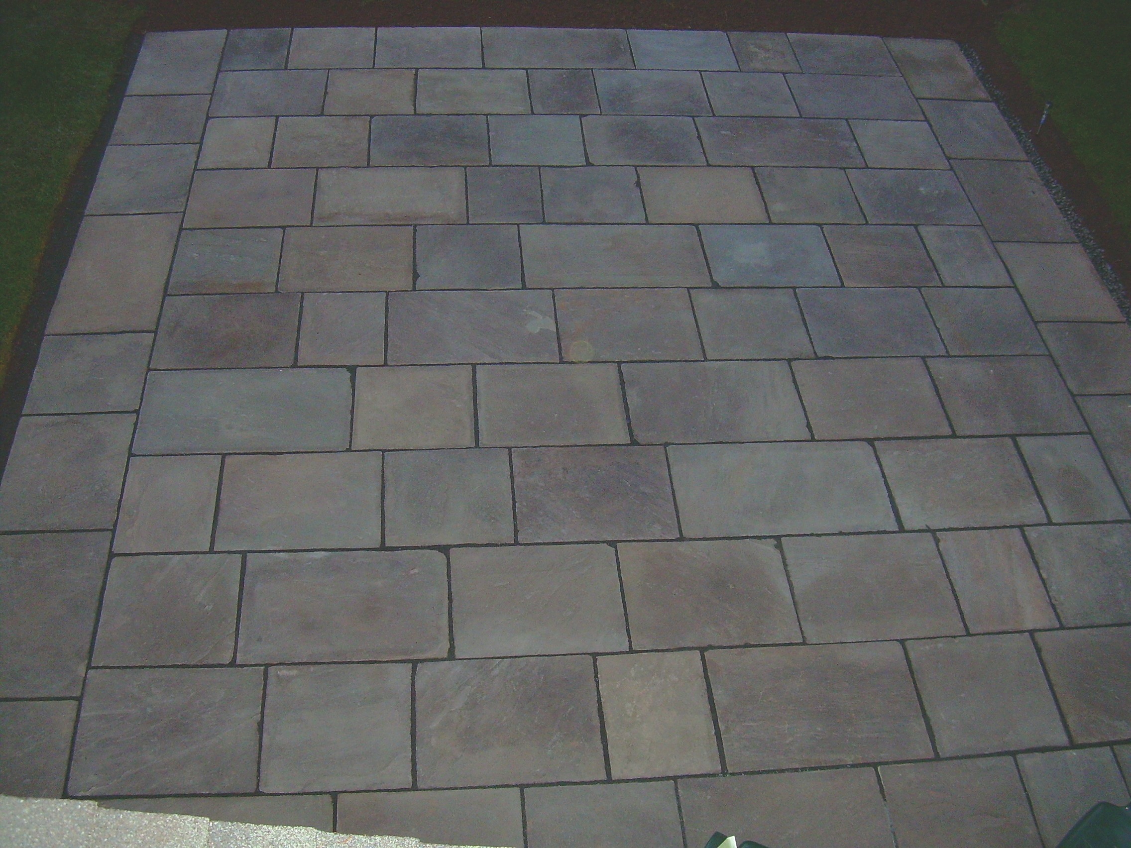

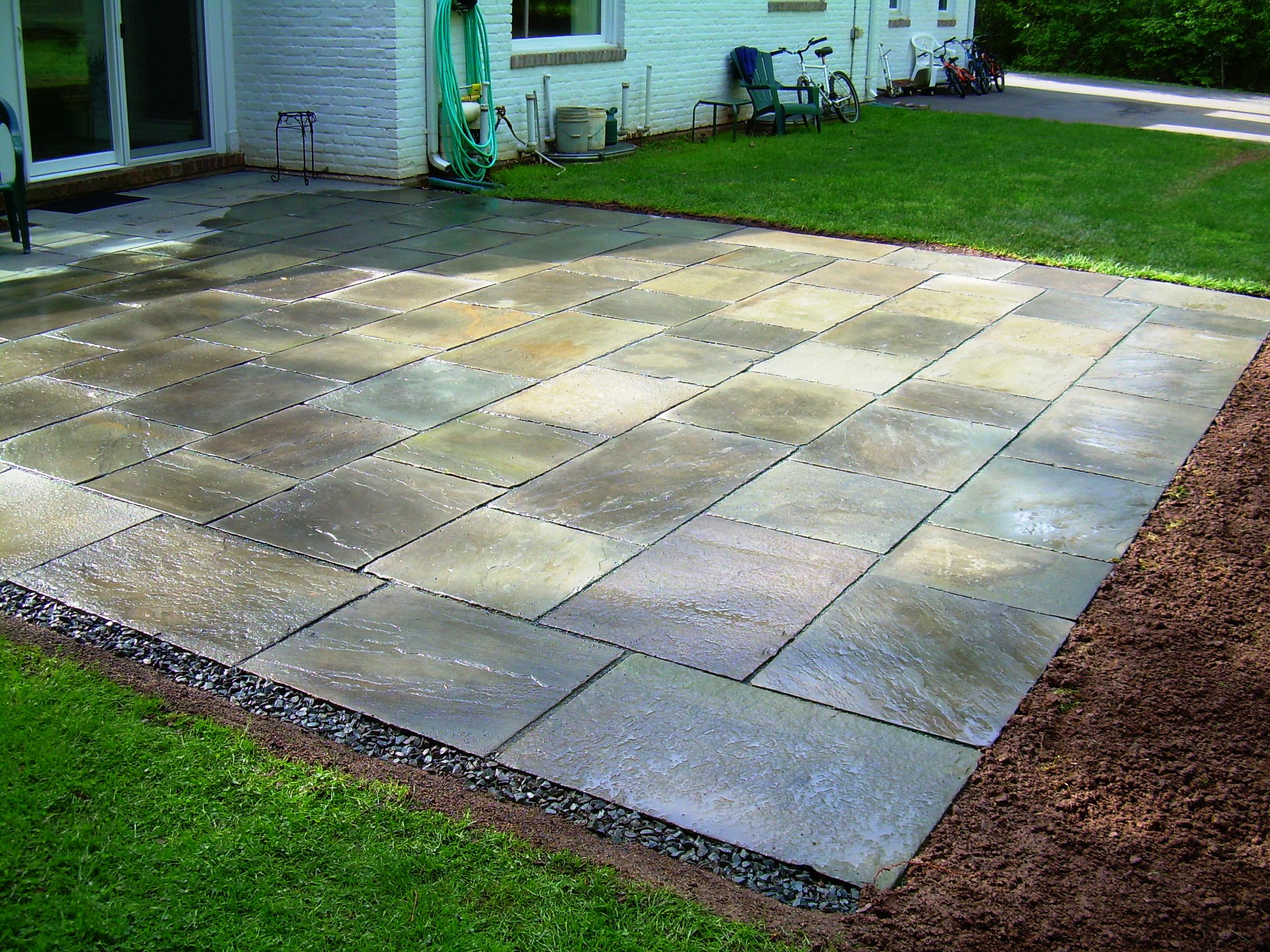

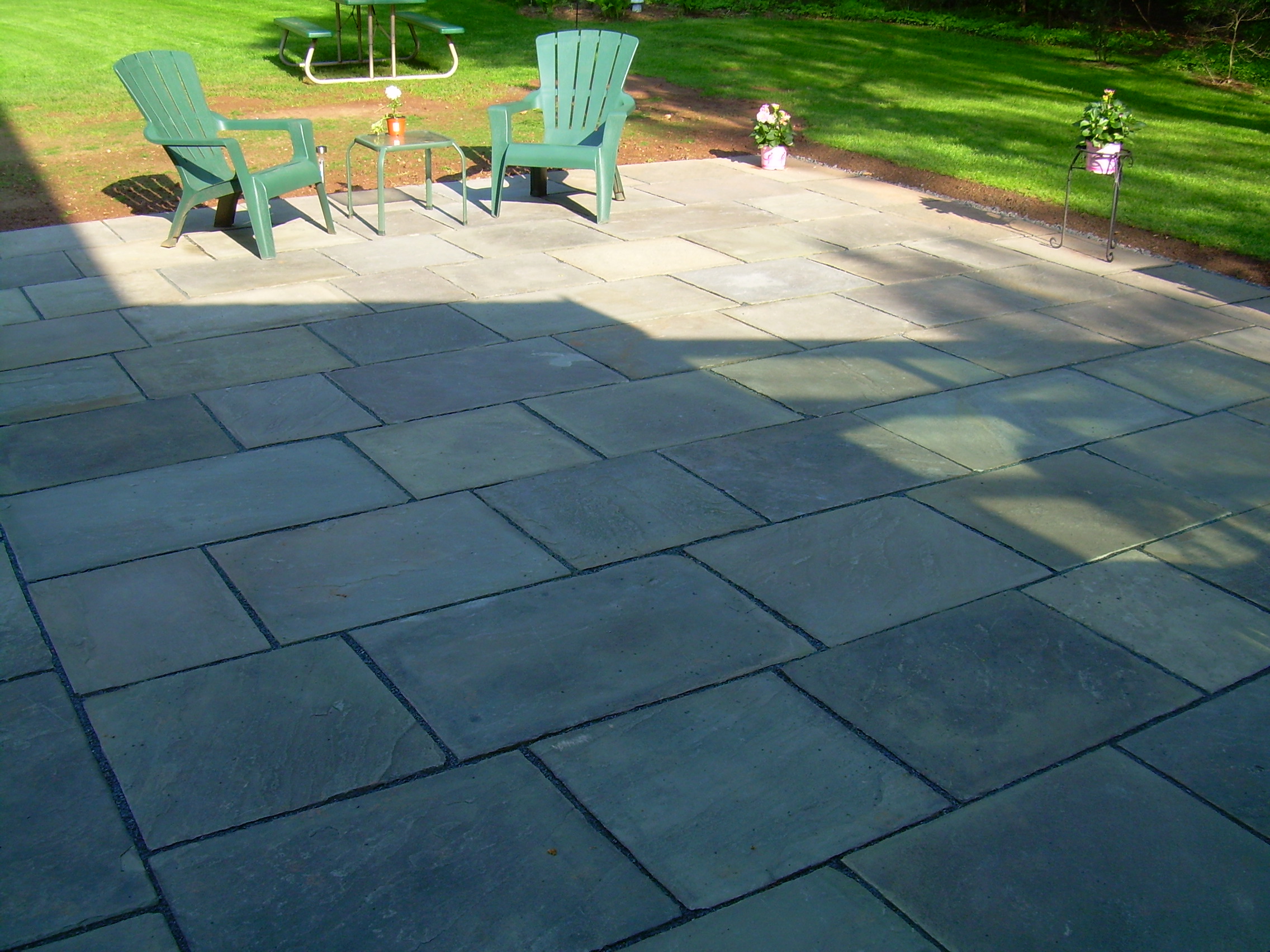

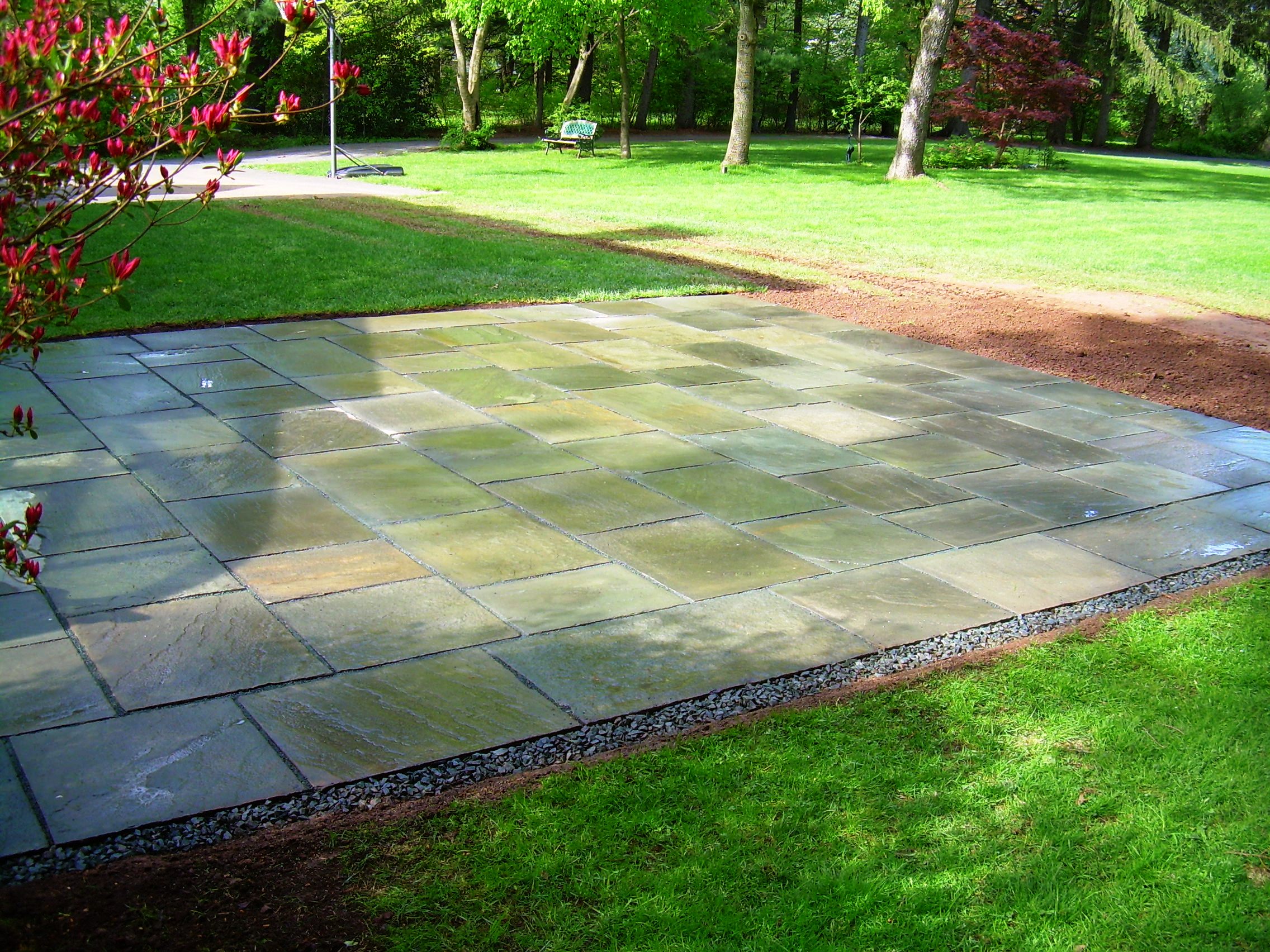

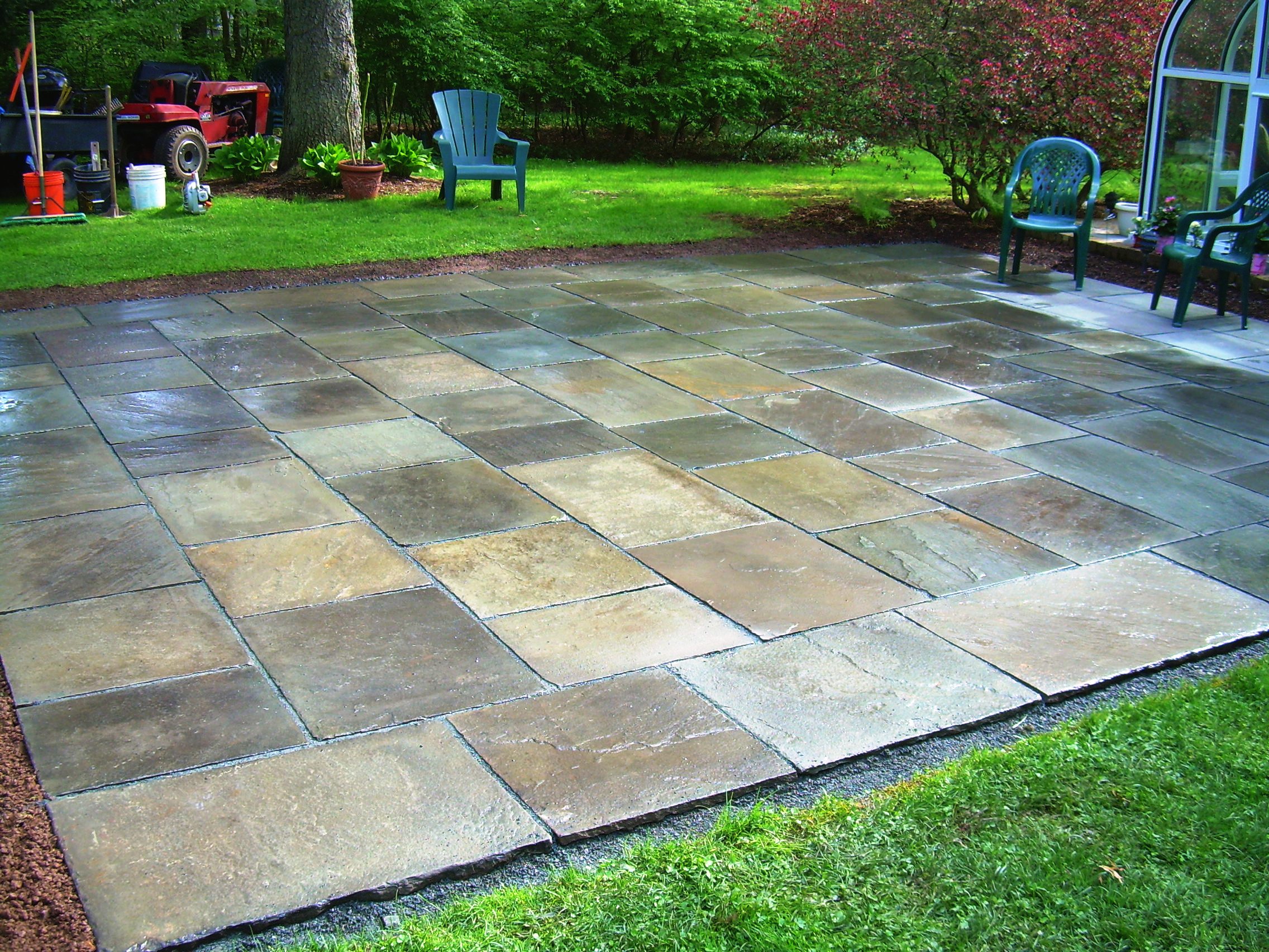

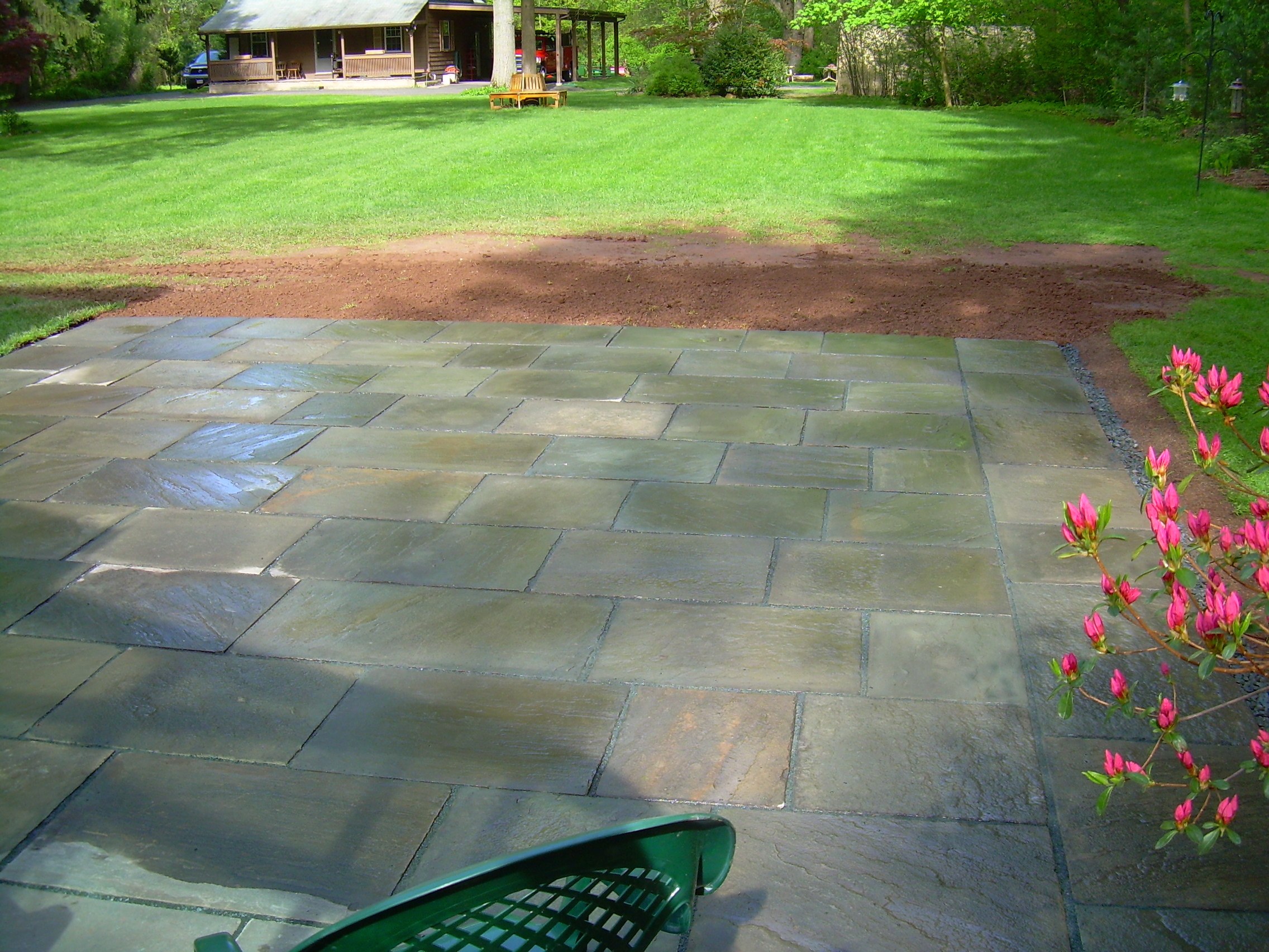

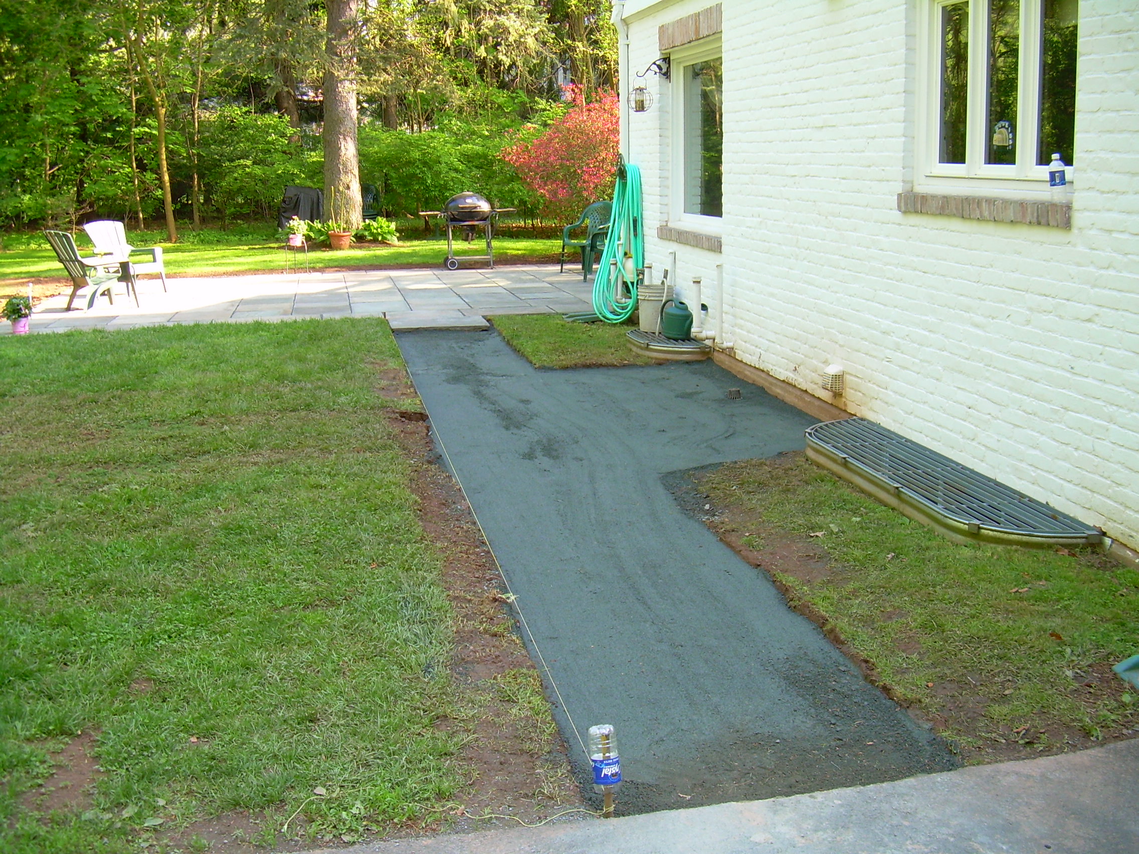

Sorry this took so long, travel ya know,
So here is a snapshot of the project.
Me and the stones. notice the varying thickness of each stone. This is a problem I had not anticipated. I thought I could level the work area and be done with it.
Working in a "confined" area was another problem. I butted up against the house on two sides, a hand well, and an outbuilding. This taxed my math and pattern analysis skills. :)
The handwell proved challenging. It was encased with field stone and concrete. I ended up busting it out by hand. Very carefully of course.
An overhead shot of the random pattern.
An almost done final shot. I hand cut around the well. I had to run back to the store for two or three pieces to finish up. Talk about a lucky estimate of material. :)

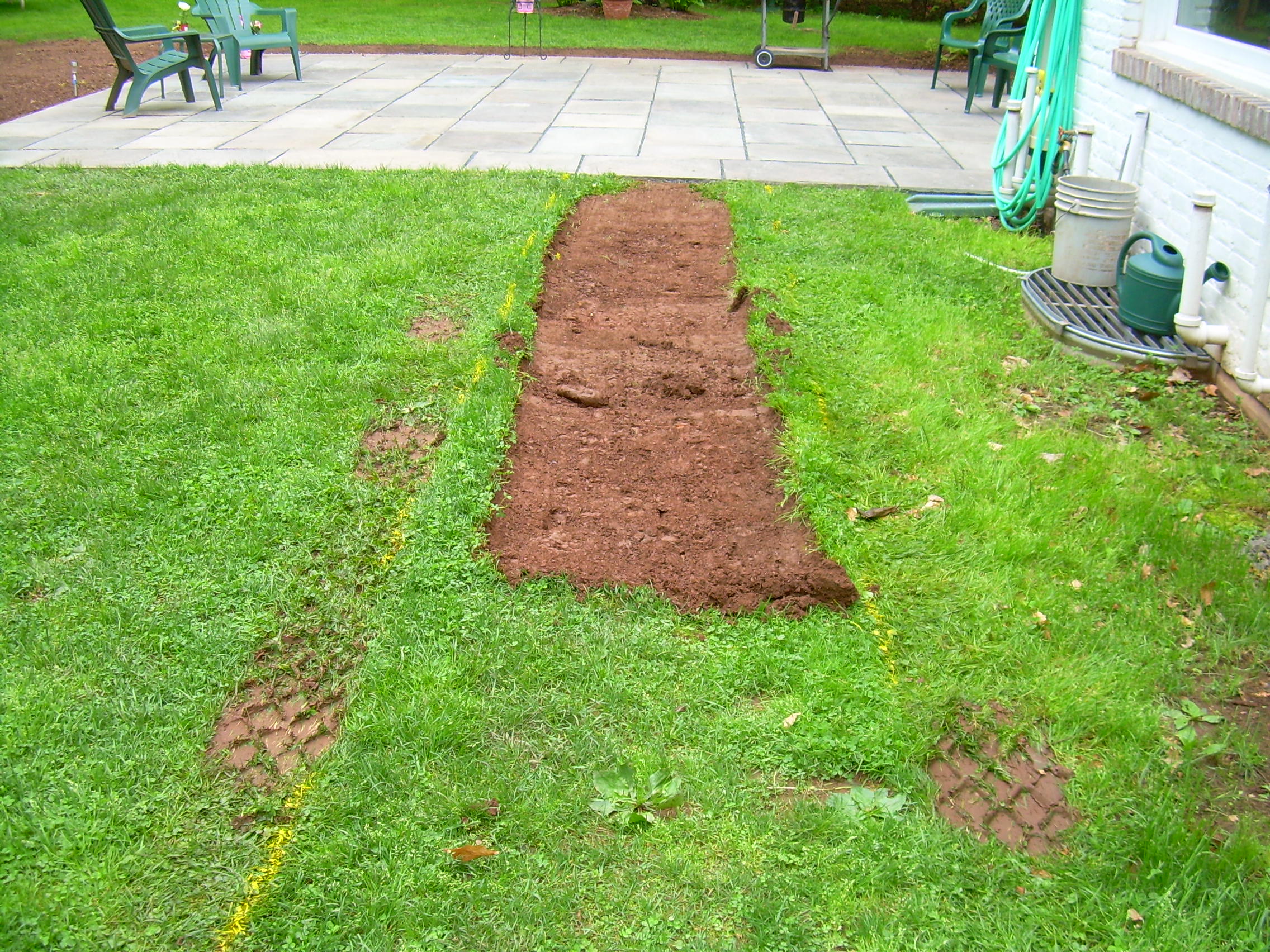

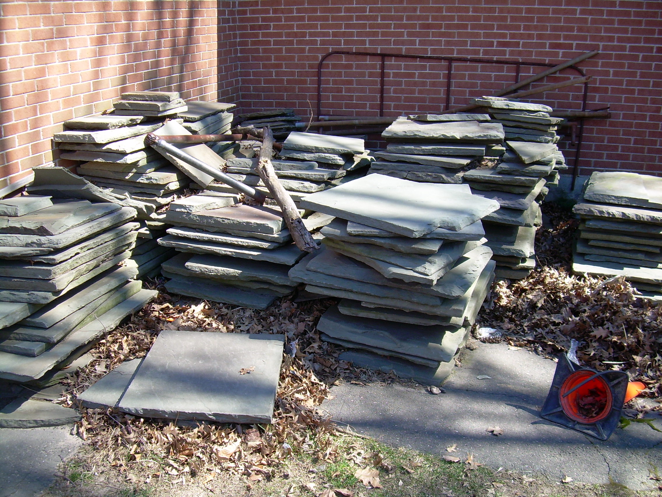

Yeah riptides that looks like something to be proud of, now that puts more pressure on me :) better not show those pics to my wife.
I'm just gonna go with straight courses, I going nuts with my little model pcs just laying them out in lines trying to stagger the end joints as best as possible. I doubt I could ever handle the random pattern with these stones.
I see your stones are cut square, mine are rougher and I think are designed for a 1" joint, since they all measure at least a half inch less than their nominal size. I'm gonna try and keep a tighter joint, I Just hope I can get them to all lay level. should start laying some stone in a day or so.
JB.
   / Help with Patio Stone Lay out #26
Good luck with it.
I must profess, that I laid about 60 square feet worth, didn't like the way it was looking, tore it up, re-graded, and started again.
I thought it would be about five days worth of work. It turned out to be much more than that over a three month period.
I called in a few professionals to give me estimates to finish the job, just laying the stone. Needless to say, the price.... was still crazy. So I just ponied up. It was hot dirty work. Some of the stones were in excess of 100 pounds. I just loved digging them in, settting them down, only to find they needed to be rotated, or graded another inch or two. :) :) I got real **** about level. I must have had about 3 levels working the area.
I think this was done over two years ago now. I have fed the patio lots of beer. For MOSS, in between the cracks. :) And have not reset one stone. So victory is still mine.
I grill on it, and sit out on it every night when I get home. It was worth it. :)

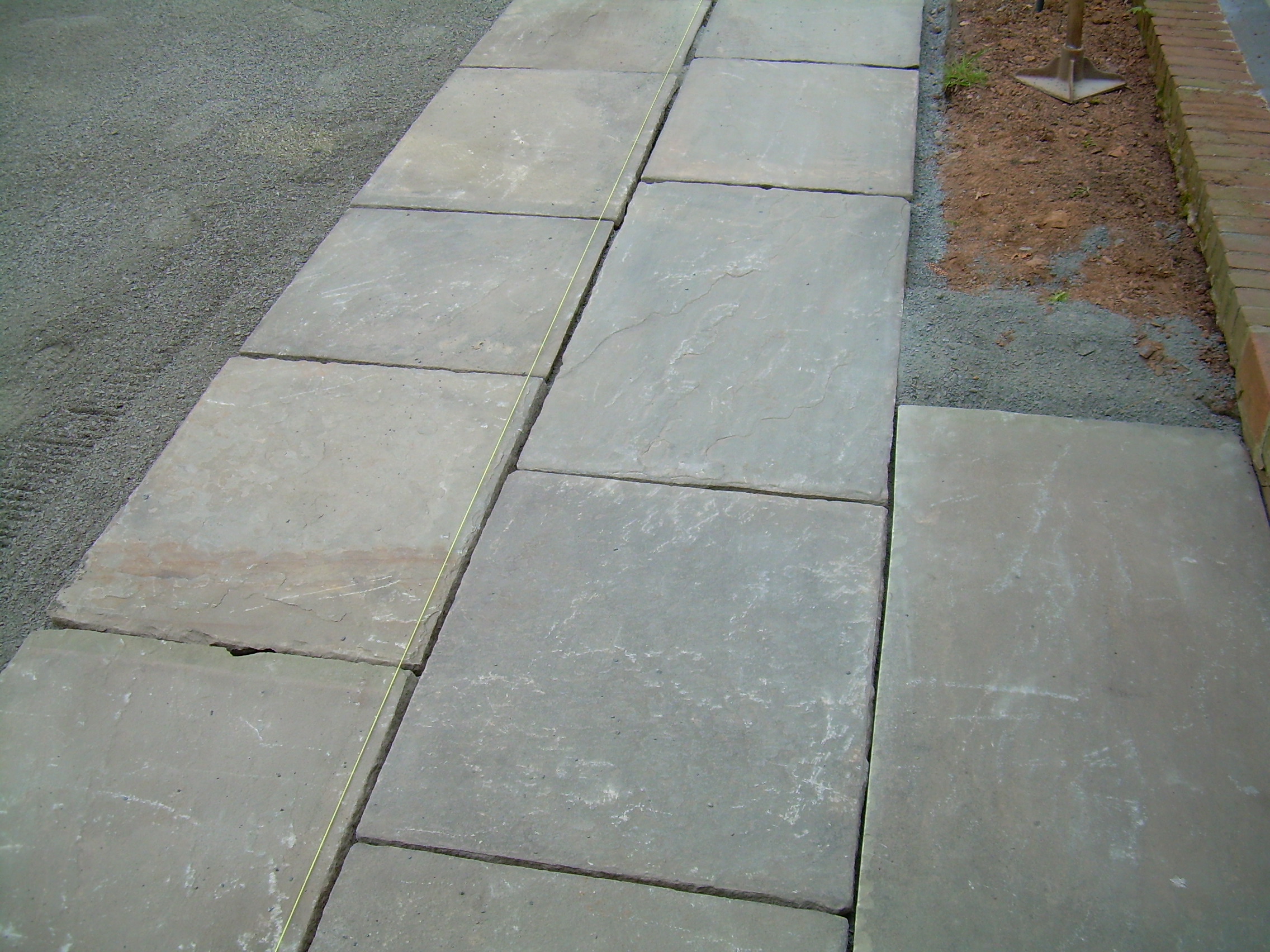

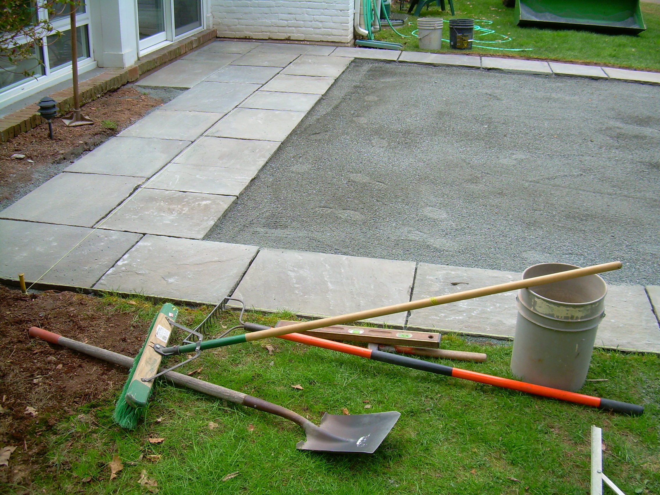

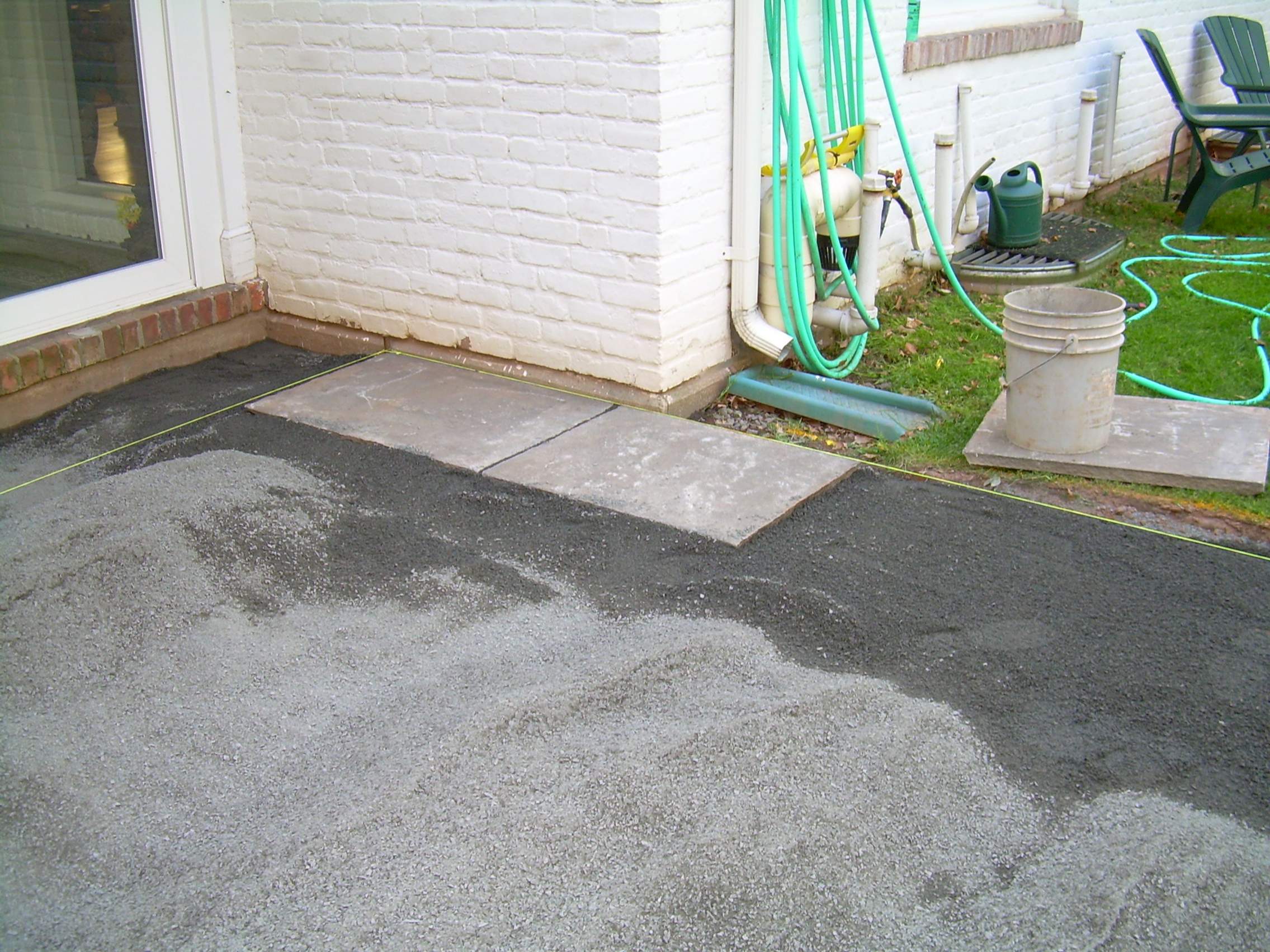

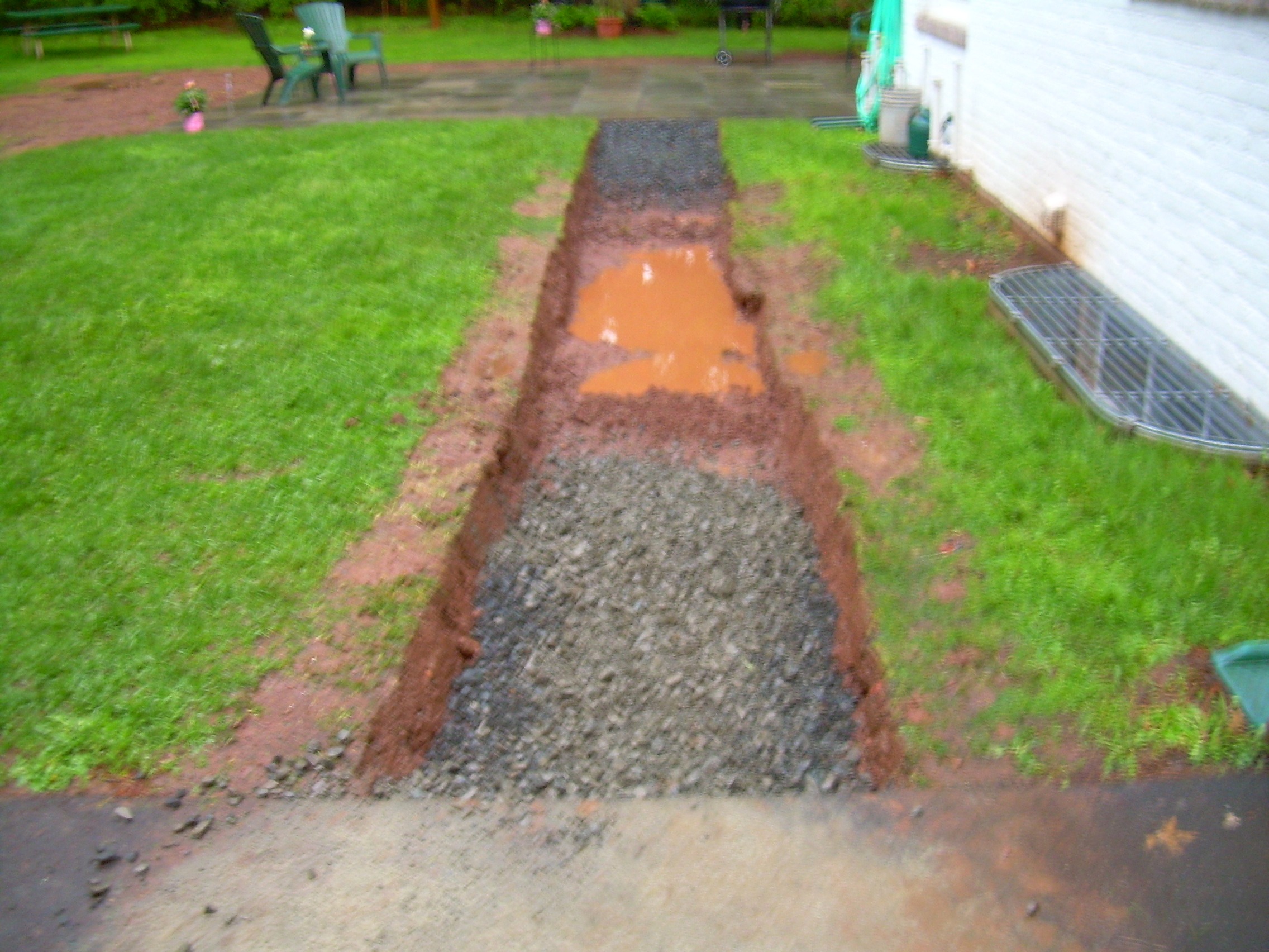

A little progress, should get more done today.

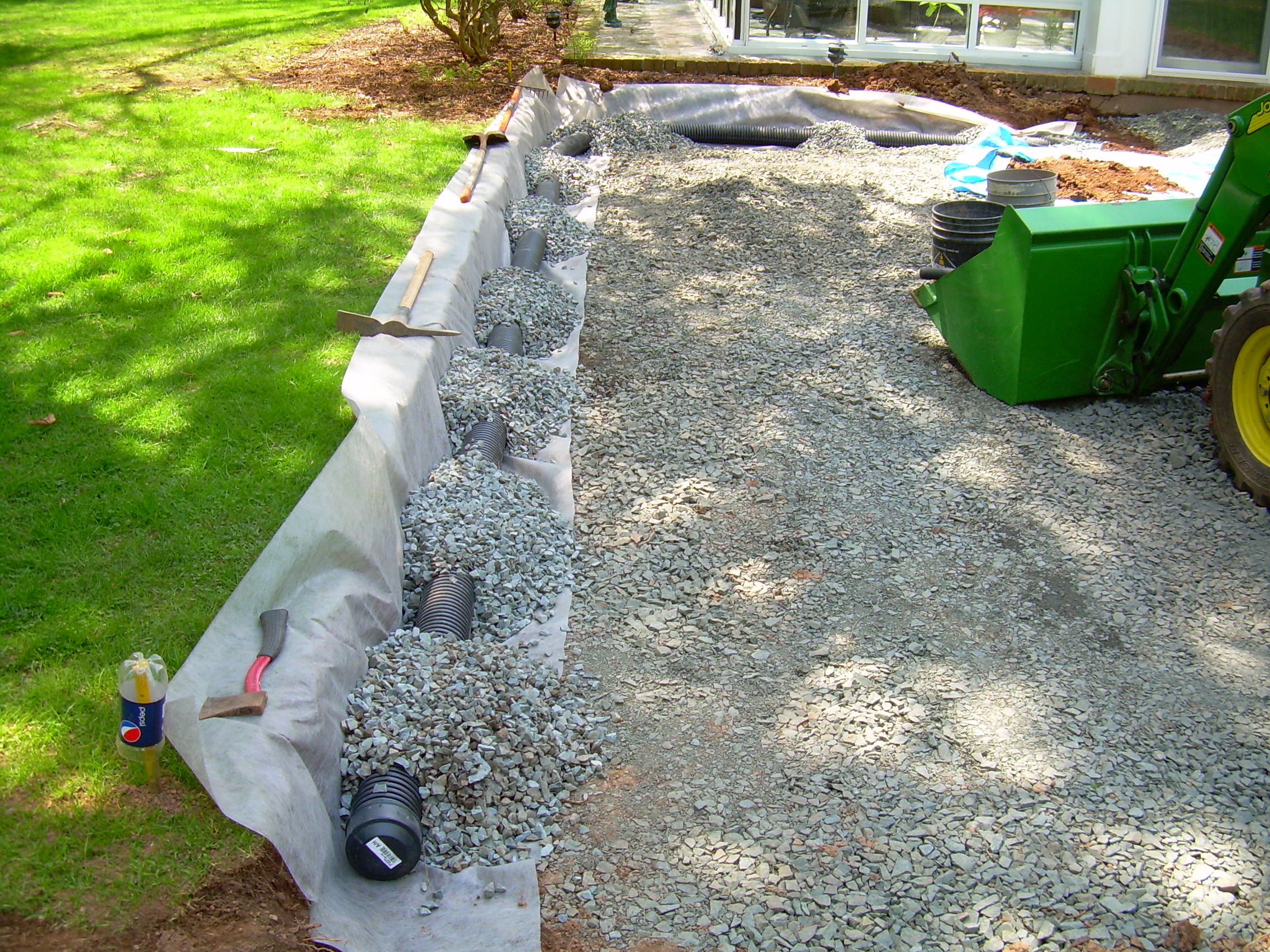

   / Help with Patio Stone Lay out #28
glad to see you remembered the drain tile!
#30
Making some progress, the use of a tripod level made getting the first courses set up perfectly level with 1 inch of pitch between them (20ft). Drain pipe is at the edge of the low side, tied into an existing unused leach field for an old septic system.
These stones are heavy, can only move 5-6 at a time before the Ford 1700 stands up in a wheelie :eek:
JB.
