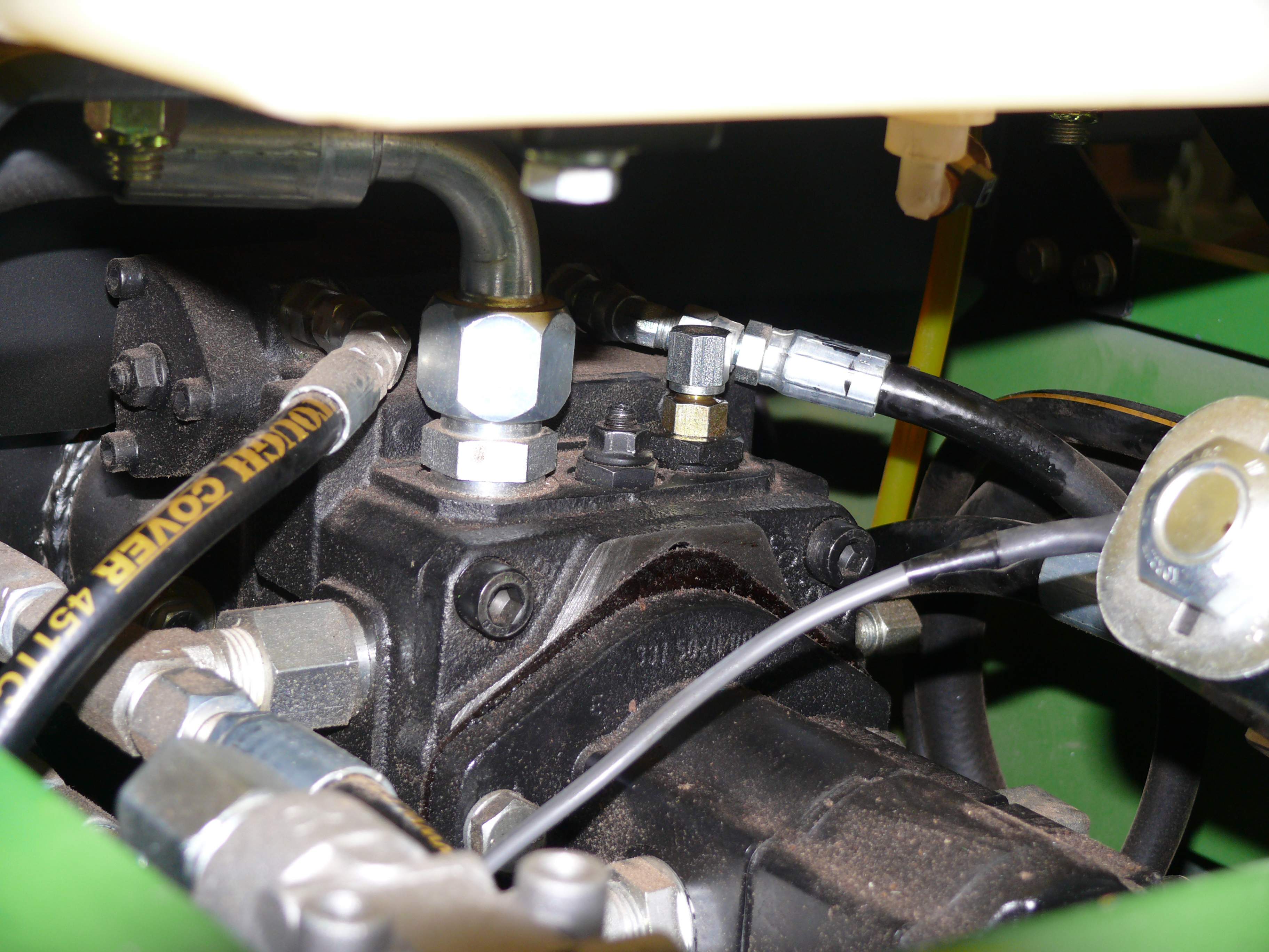

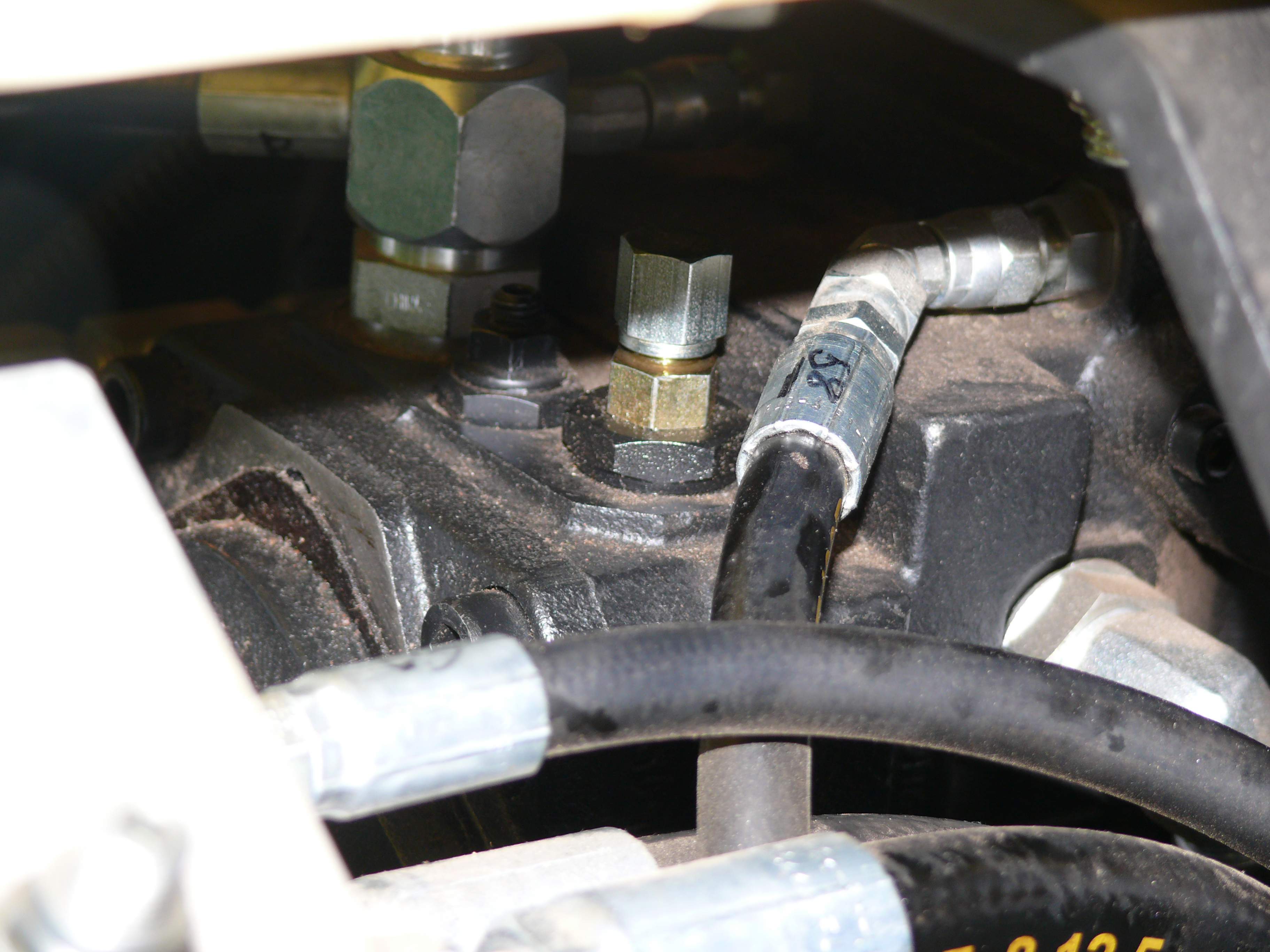

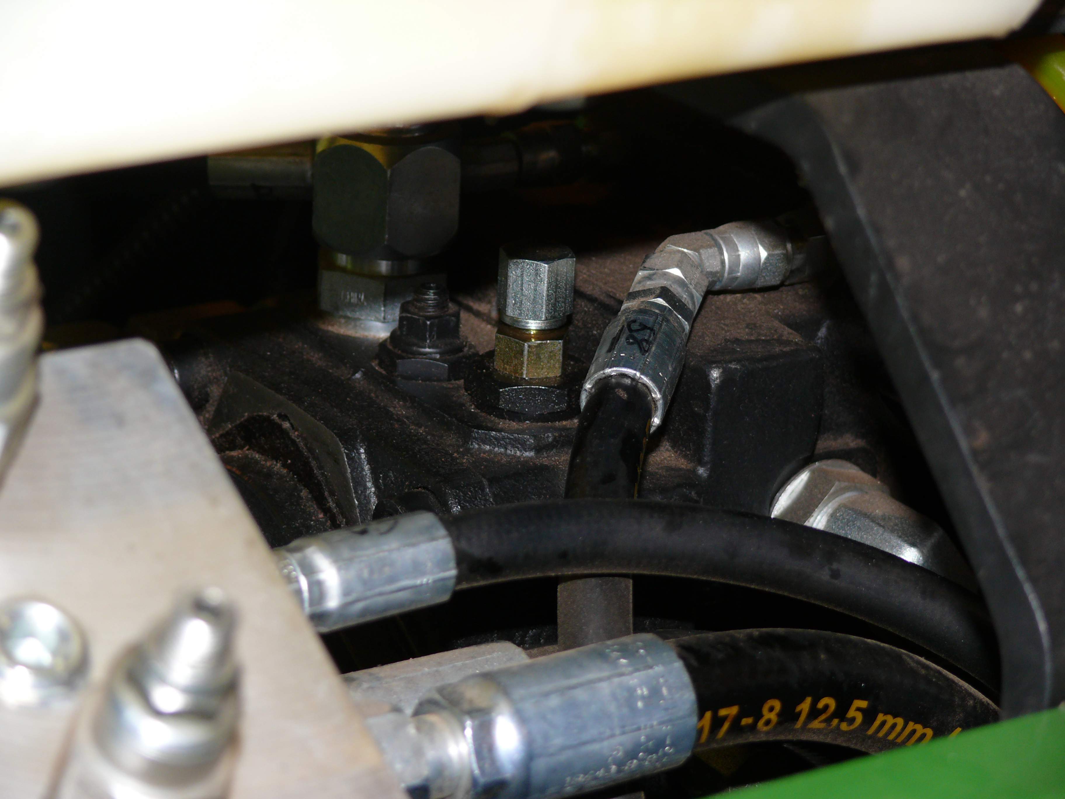

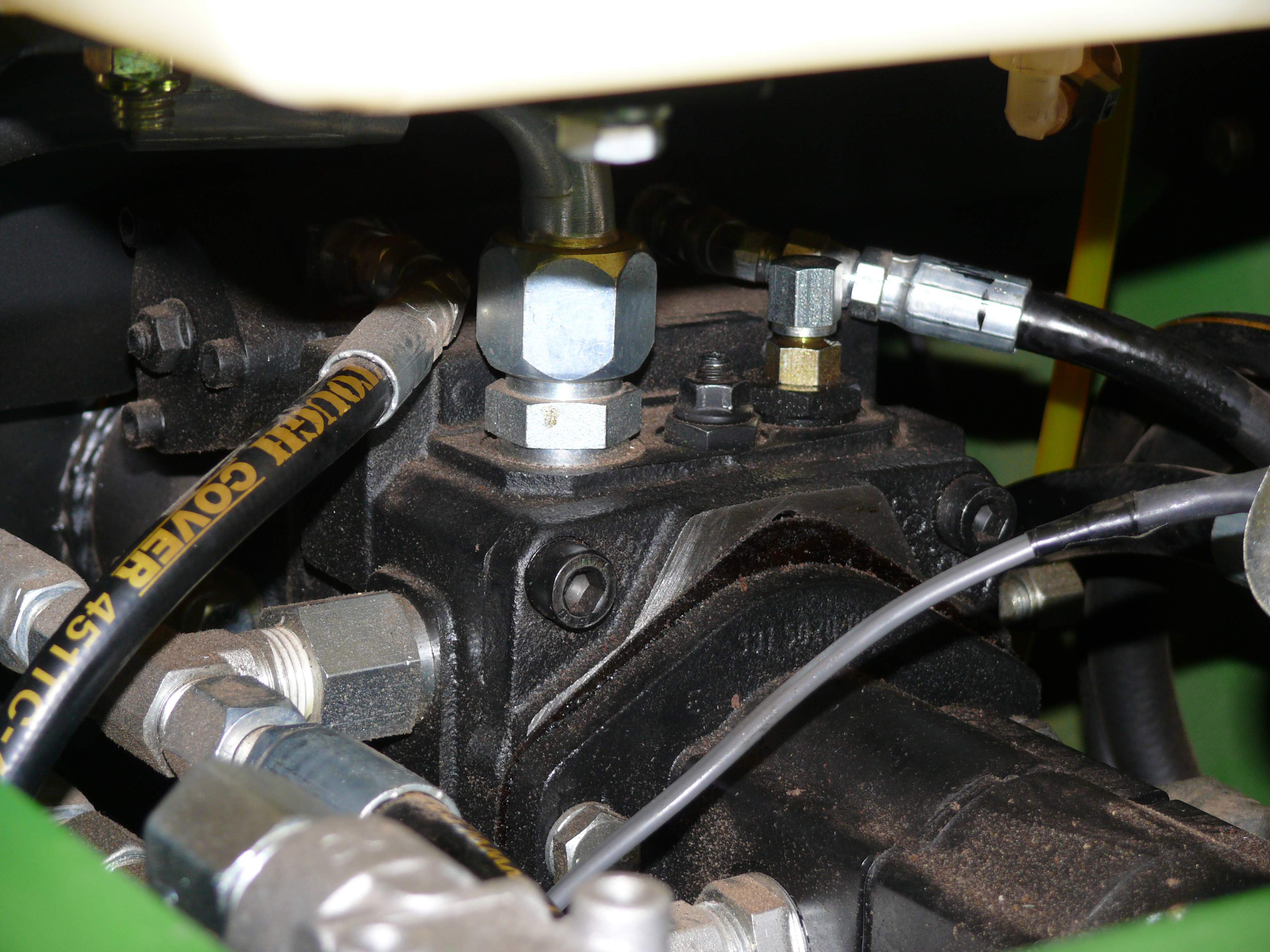

No, I forgot that the older machines are different that mine. On my 2010 PT 425 the bleed port has a cap on it. Once the cap is removed and the supplied hose with fitting is screwed on its open and ready. Thee is no additional "cracking" of anything required. The rest of the procedure is identical.
Thinking about it, I believe mine is like that too. Remove the cap and the port is open. Yikes! How quick the mind goes. :confused3:
   / Help needed finding the air bleed port #12

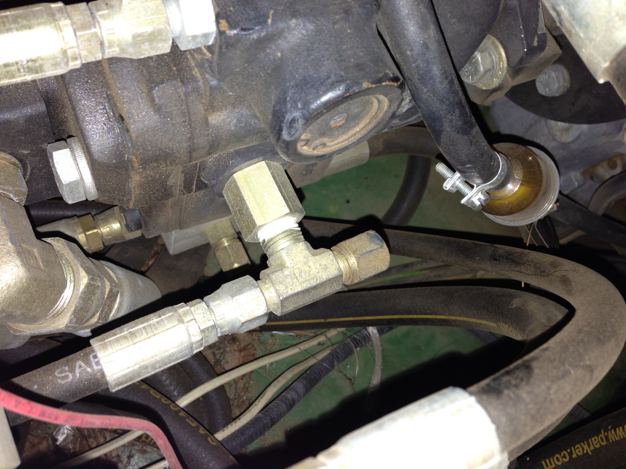

Same here on my 2005. I didn't have the "supplied" bleed hose last time I changed filters. But didn't need it. I just took some 1/4" gas hose, and just threaded it onto the tee where the cap threads on. No need for a fitting on it, since it isn't under pressure. Might have put a hose clamp on, just in case.
Below is a picture of my bleed connection. The right hand (aft end) of the tee-fitting has the cap you remove to install the bleed hose.
