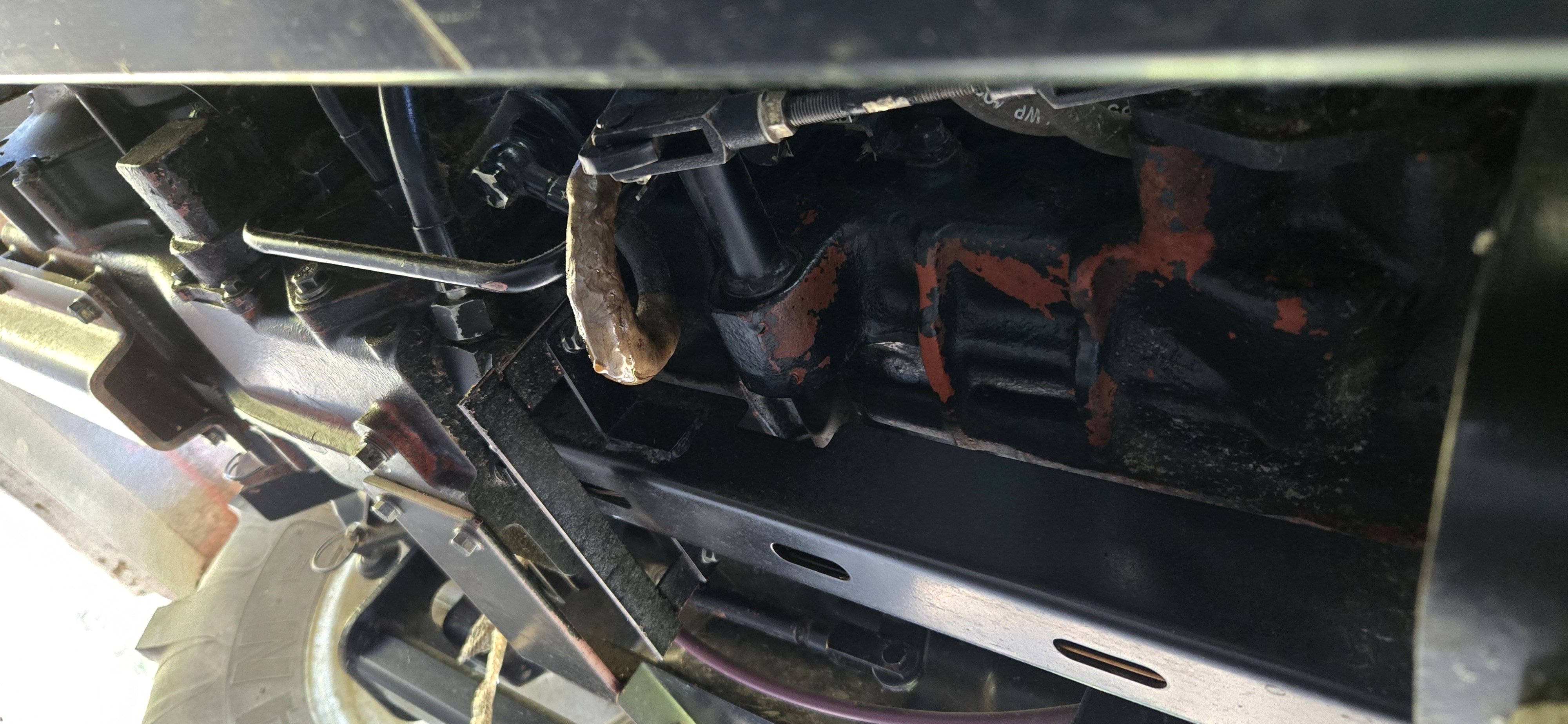

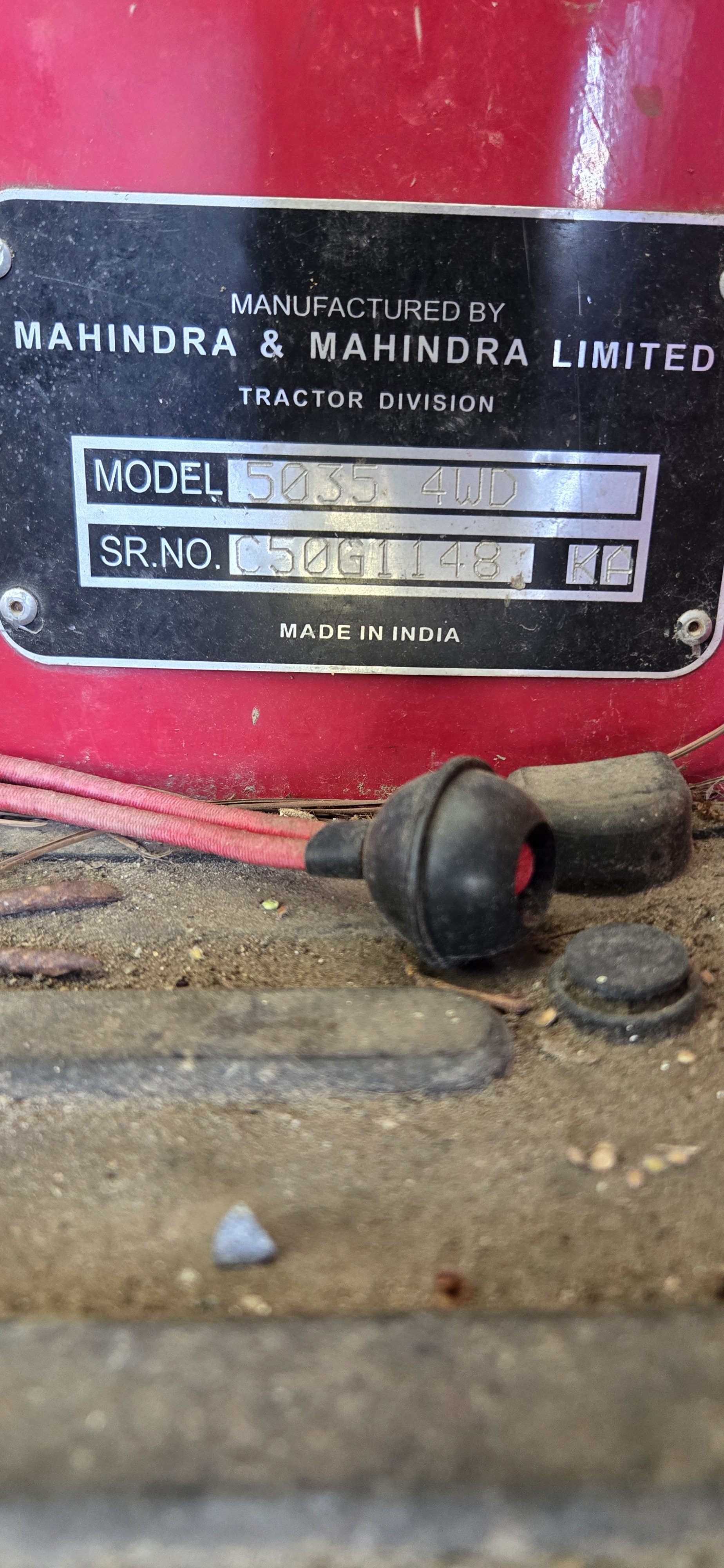

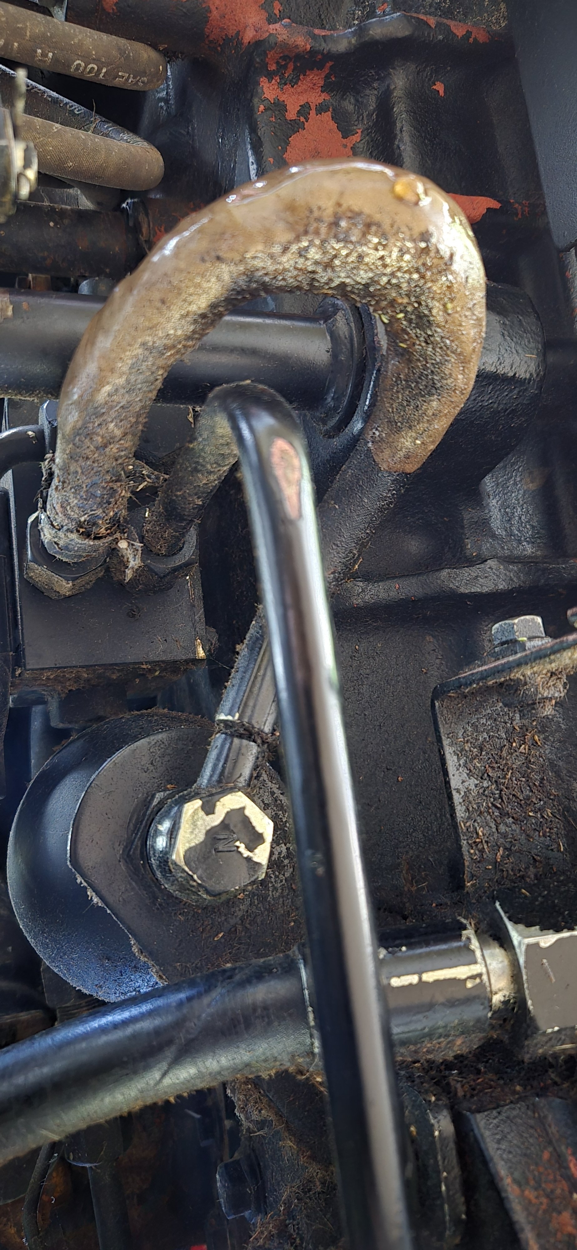

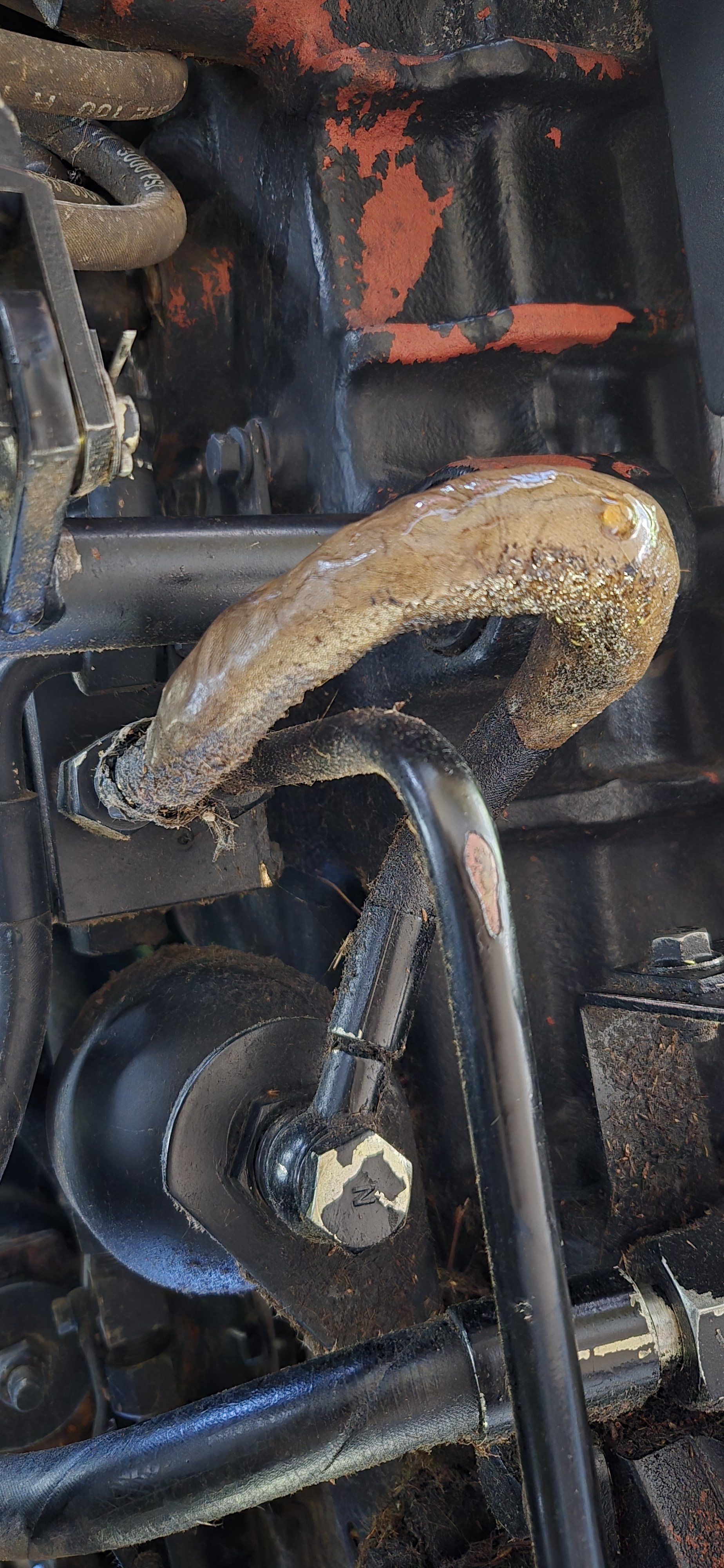

Hello all... country do-it-my-damn-self girl here. I've got a Mahindra 5035 Gear (purchased in 2009). I've had a hydraulic hose leak for a bit that I need to break down and repair. I wanted to just buy the part and swap it without having to deal with a hose shop, but I cannot for the life of me find this part. I'm attaching some pictures, hoping this will help you guys help me. The hose is about 1 foot long, a hard U bend to it, and it's located right under the seat, a little to the right (if you're sitting in the seat). Please disregard the weird color on the hose - that was me stupidly trying to do a temp-fix with some epoxy putty junk. I know - stupid and I won't do it again... be gentle with your reprimands. ;-) The hose appearance is a standard black hydraulic hose. Many thanks in advance for any help or guidance!

Does one end have a hose clamp? It's hard to tell.

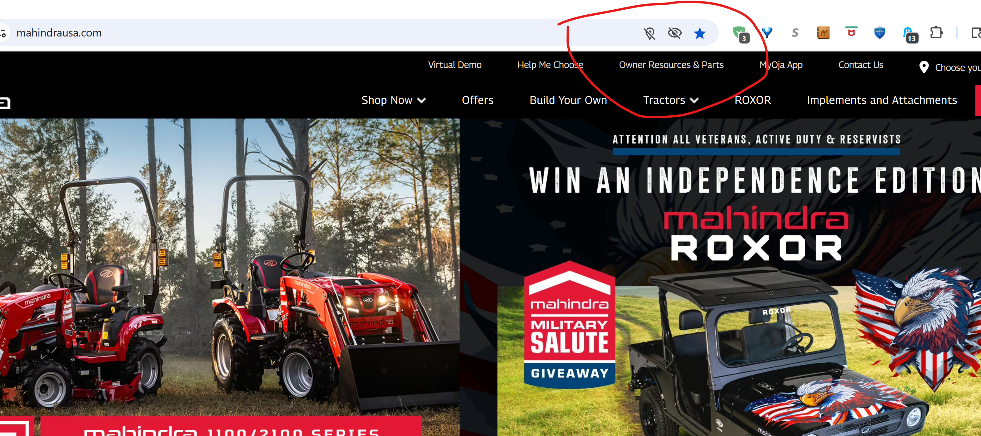

Your link dies a quick death--"Expired Token". You should just order it from your dealer. One end looks like a BSP Banjo. Can't tell what the other end is.

My local hydraulic shop is a lot cheaper than my dealerships. Remove it and have them duplicate it.

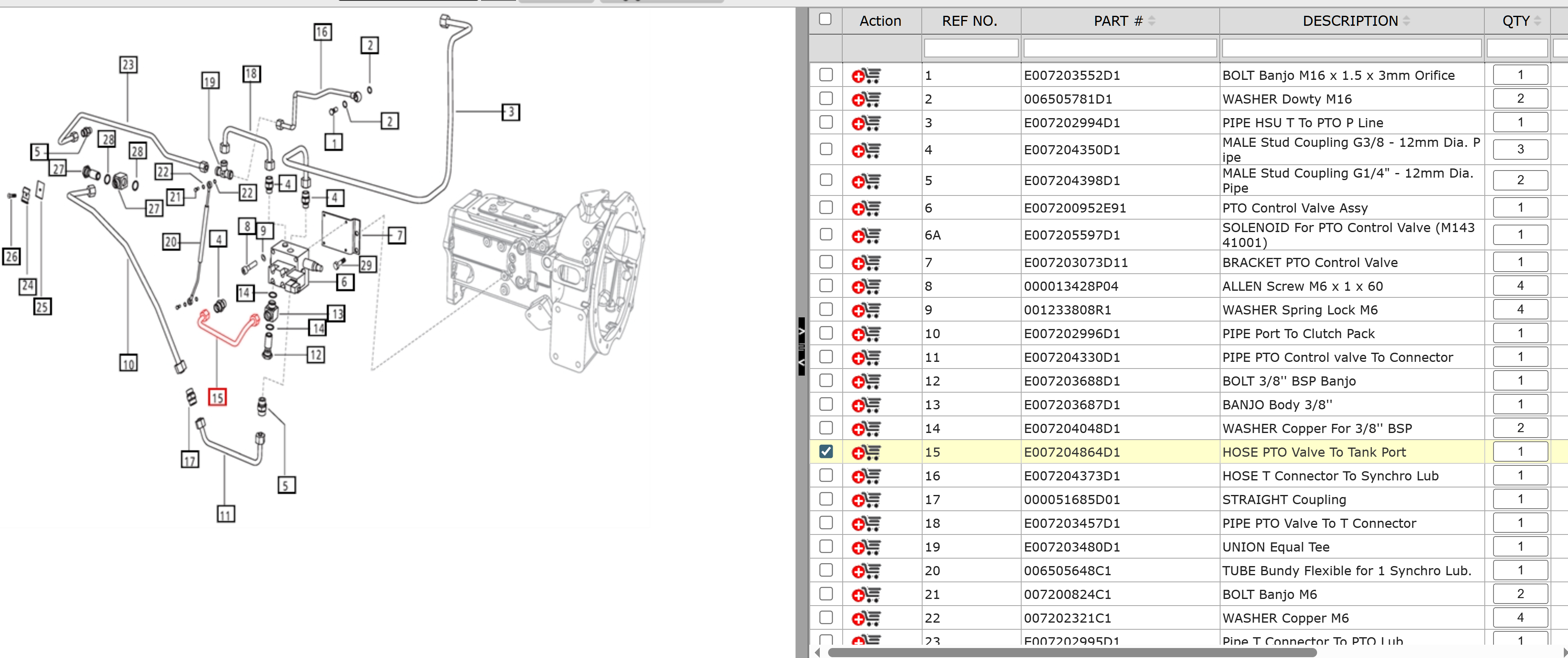

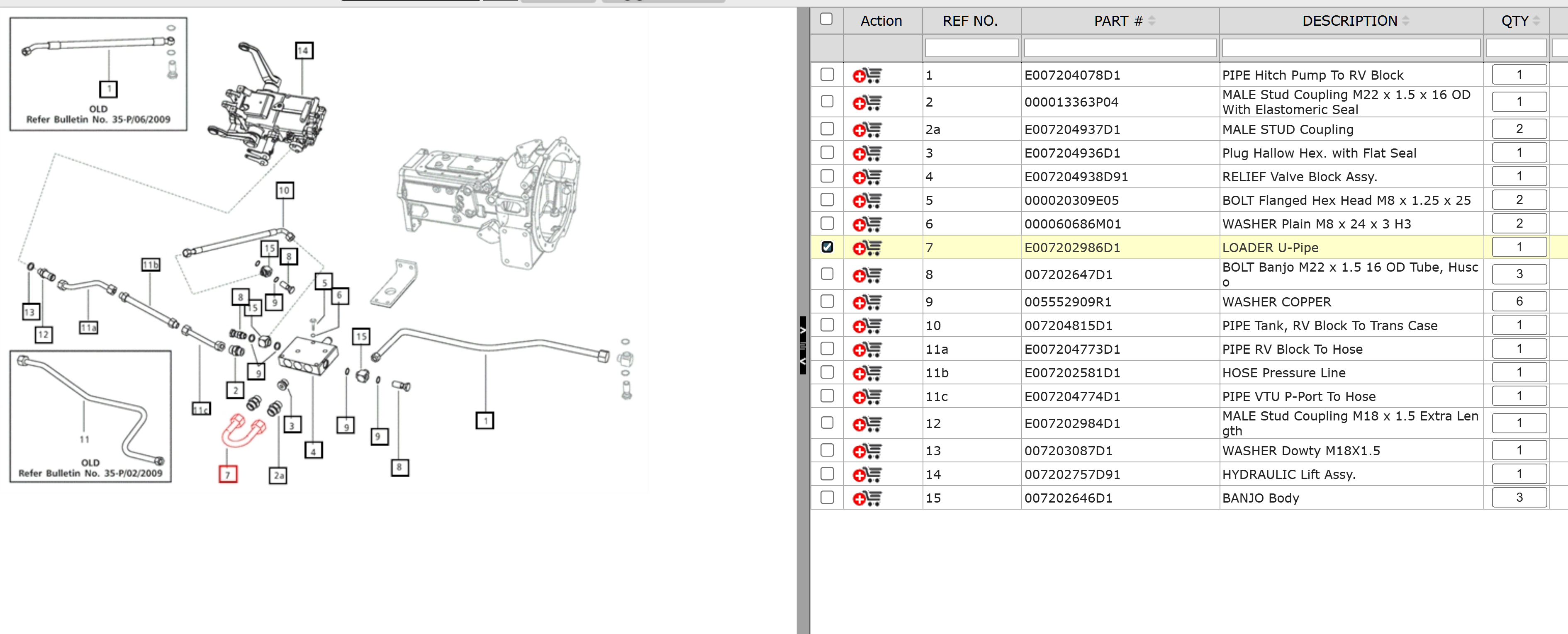

This hose?
   / Mahindra 5035 Gear - Help finding hydraulic hose part number #8
Or this one?

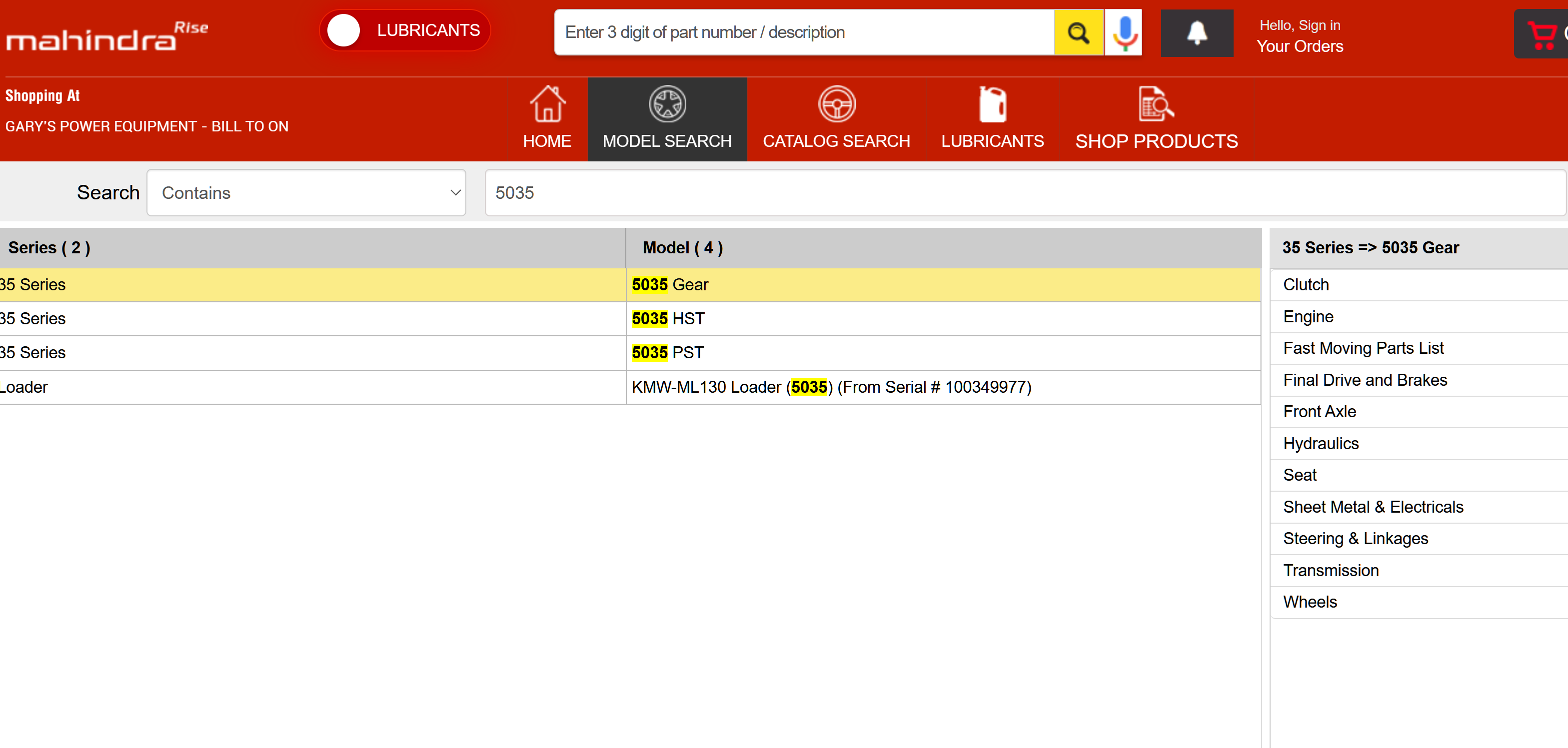

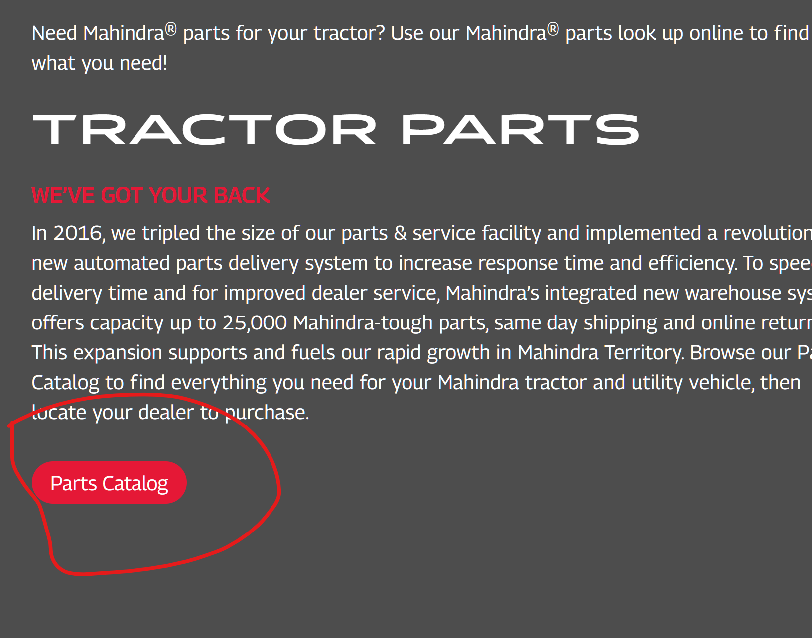

You might have to enter a zip code and pick a dealer before you can do the model search. Find the part, copy the part number and do a google search for it.

I don't think it's either of those. I've spent some time as well, looking for this hose.
The one the OP lists, goes to an accumulator, which for the life of me, I couldn't find in the parts catalog for that model.
