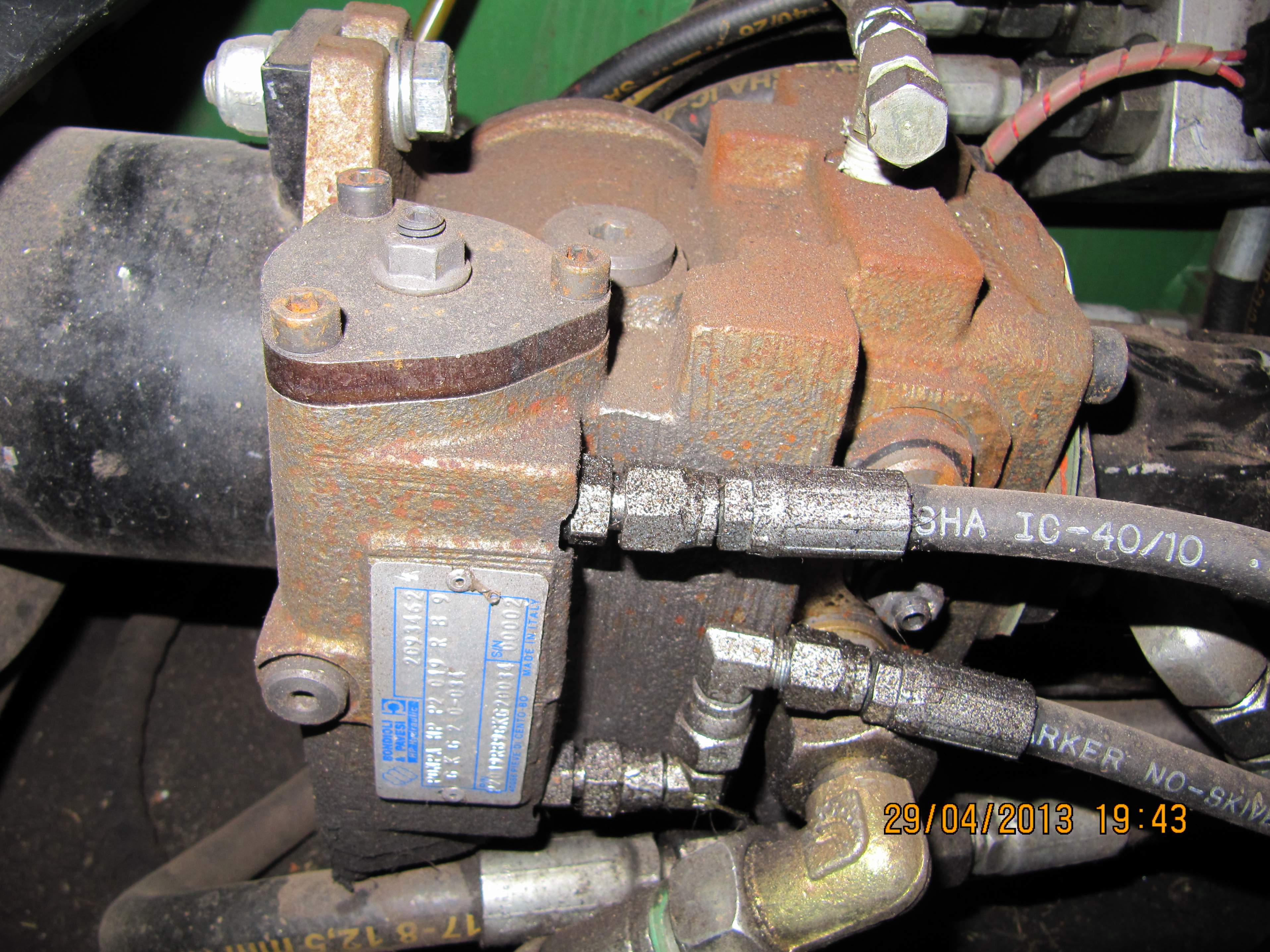

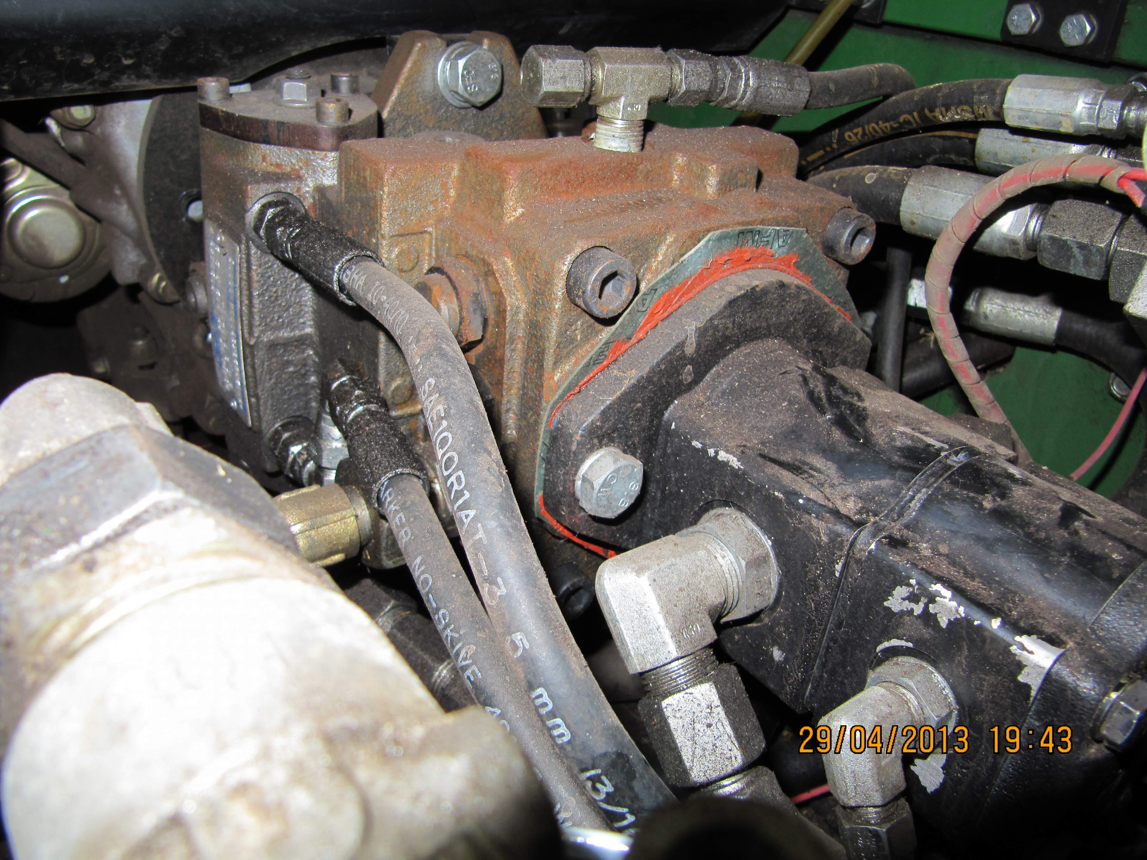

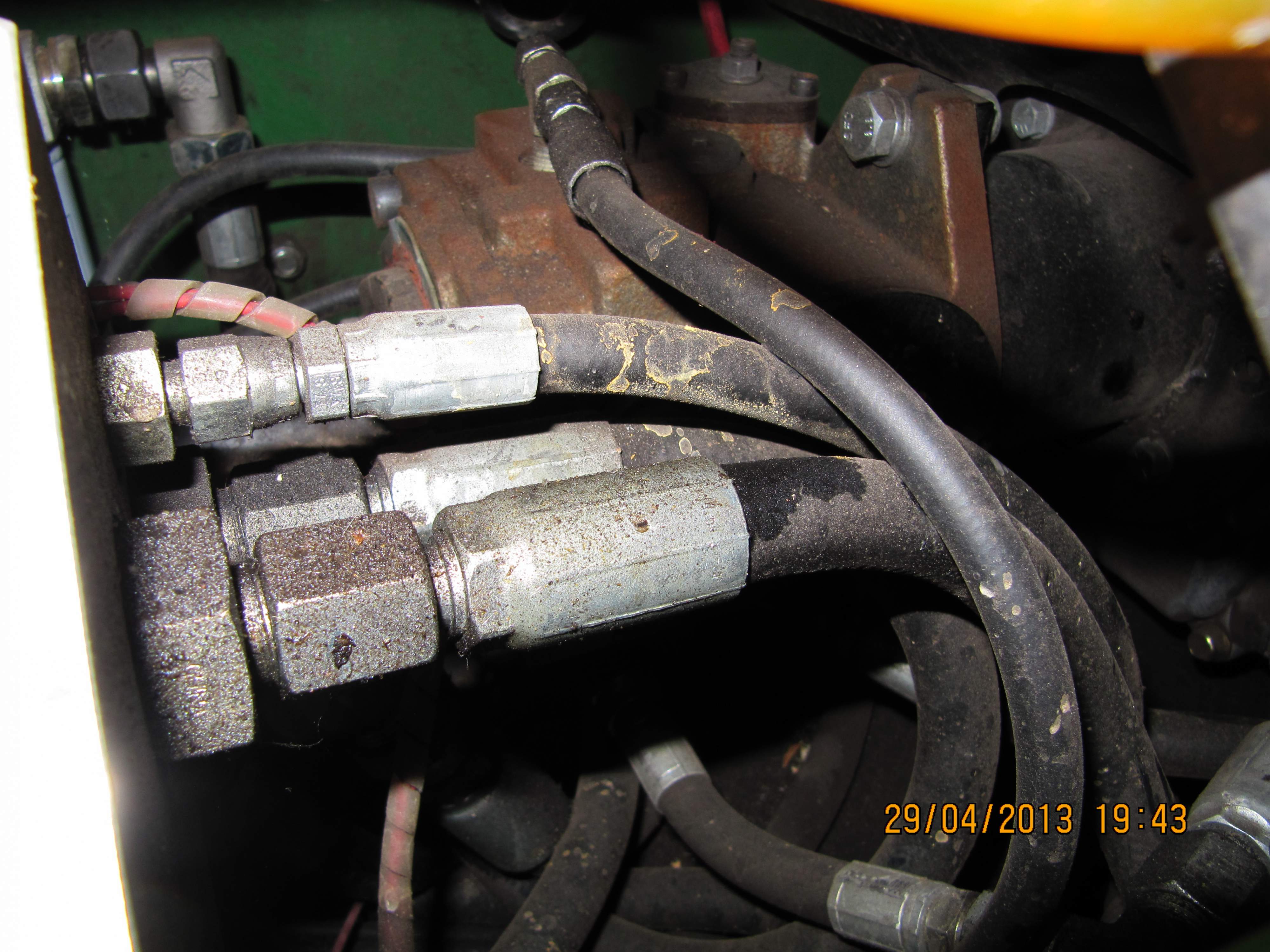

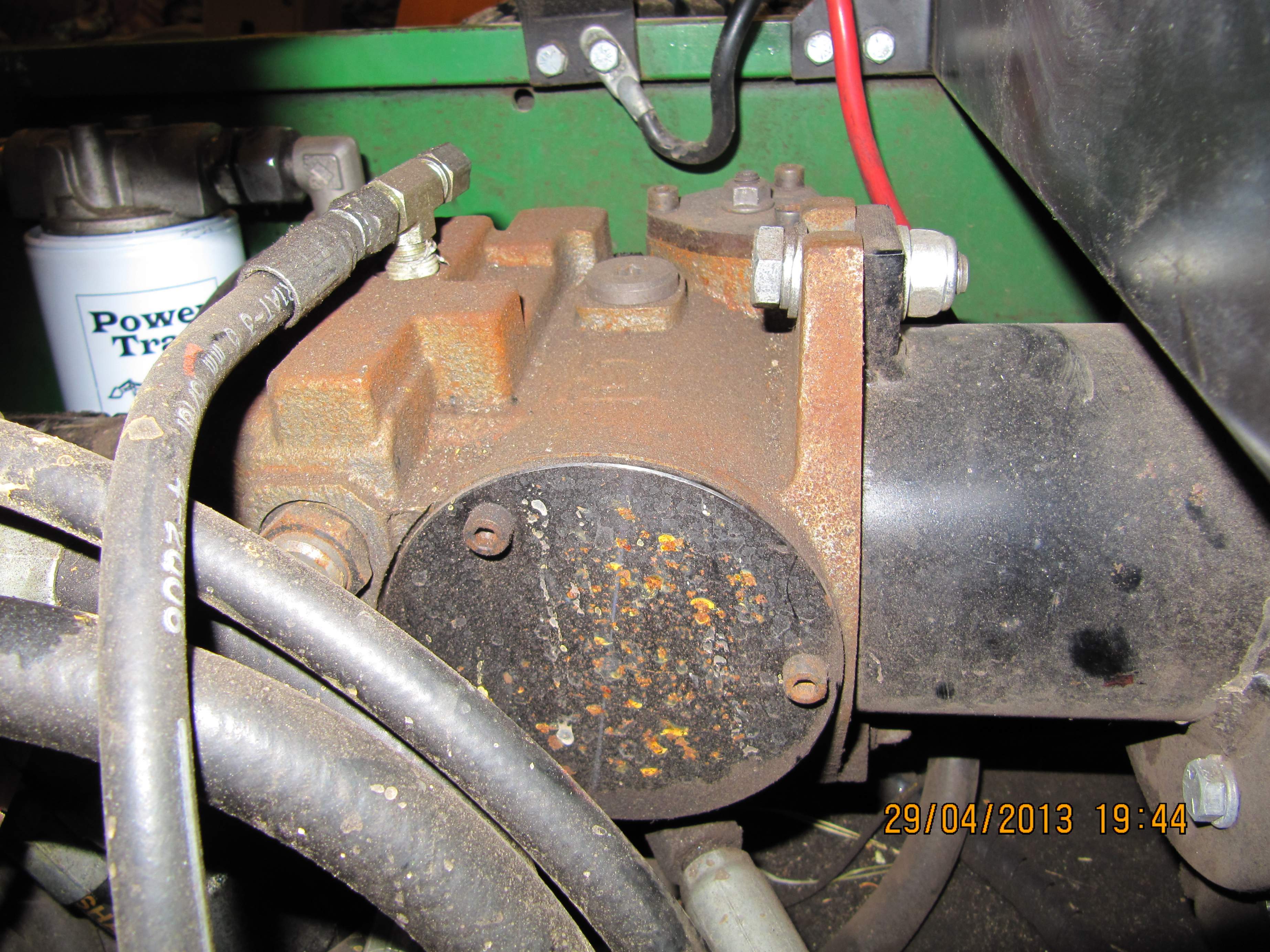

Hi again,
I've changed the hydraulic filter on my PT-425, and need to bleed the air out of the hydraulic pump.
It's a Bondioli&Pavesi model HP P2. I can't find the air bleed port.
I've tried the owners manual, but it's useless, as it describes another pump.
Also I've searched this forum, but none of the discussions seems to relate to my pump.
Some posts mentions a hydraulic hose used for bleeding air, which was supplied by Power Trac with the tractor. I did not get a hose when I bought my 425 - can I bleed it without one?
Any help will be greatly appreciated.

As for the location of your bleed port....
The bleed port on mine is on the side of the pump.
I have a cable operated pump on my 2001 model PT425. My cable attaches to the mechanism on the top of the pump.
Power Trac converted to a hydraulically operated pump sometime after 2001.
I thought the hydraulically operated pumps had the mechanism on the top of the pump as well, but could be mistaken.
From your pictures, it appears the hydraulically operated mechanism is on the side.
Could your pump be installed 90 degrees rotated and thus, your bleed port may be on the bottom now?
/ Help needed finding the air bleed port #5
I think your bleed port is the capped end of the t connection at the top. Don't hold me to it but it seems to me to be the logical choice as no other port has a cover.

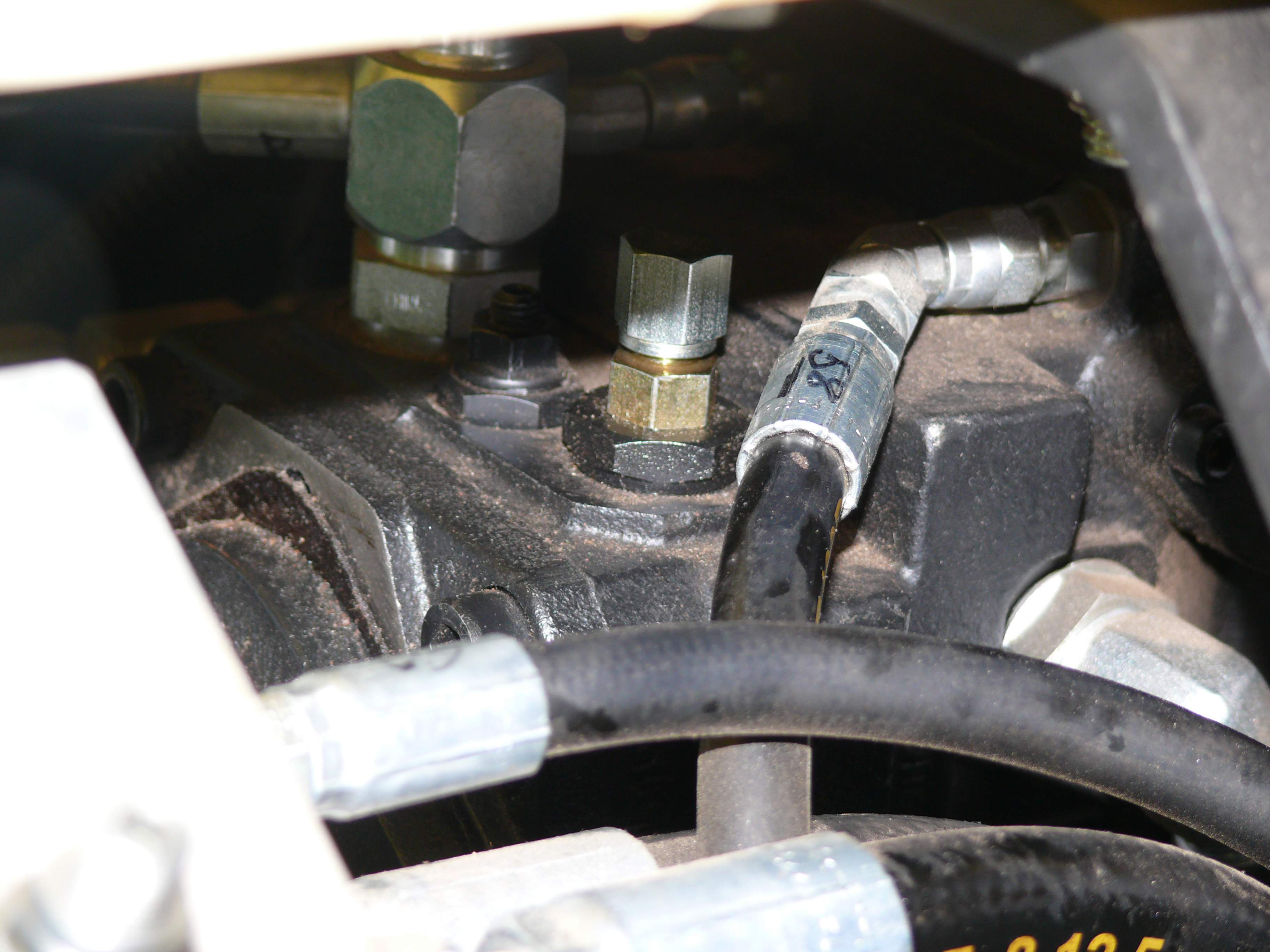

Same here on my 2005. I didn't have the "supplied" bleed hose last time I changed filters. But didn't need it. I just took some 1/4" gas hose, and just threaded it onto the tee where the cap threads on. No need for a fitting on it, since it isn't under pressure. Might have put a hose clamp on, just in case.
Below is a picture of my bleed connection. The right hand (aft end) of the tee-fitting has the cap you remove to install the bleed hose.
/ Help needed finding the air bleed port #13
I know this is an old post, but thought it might help some people out that have a PT425 out there. I know, or lets say I hope it was the correct point it directed me to on my 2015 machine.
I took the cap off the top, and hooked the line up and ran it into the tank, took the spark plugs out (figured it would crank a bit easier that way) and cranked until I had nothing but oil with no bubbles.
I might also make a note for those who don't know, get you a pan ready to put under the machine, as it will have oil come out the filter when you take it off, and drain out the hole in the front of the pan. (I wish i would have thought of that before I did it), and also you will need a oil filter wrench that will go around the 3 3/4" size, I just had the old style with the handle on it, and have now ordered one I can slip over it and use a 3/8" rachet to loosen it.
