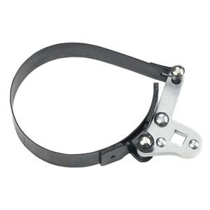

Bob, What kind of wrench are you using to get it off?
I just am doing what Terry said down at Tazwell on putting it on. If I have a pain in the butt taking it off next time I will not put it on as tight, but I do have the correct wrench to get it off now, so will see how hard it is.
   / Help needed finding the air bleed port #26
What wrench is that? Got a picture or link?
   / Help needed finding the air bleed port #27
I think this is the one I got a KD 2029 Band Wrench
   / Help needed finding the air bleed port #28
Thanks. I ordered one.
   / Help needed finding the air bleed port #29
Bob, it seemed to fit over the filter pretty tight, but you were able to get it on either way, to tighten, or unloosen the filter, where the one with the handle took 5 minutes to figure out how to get it though all the hoses, and wire looms I had in there. I think this should make the next filter change a lot easier, and the filter seemed to be just a hair under 3 3/4"
