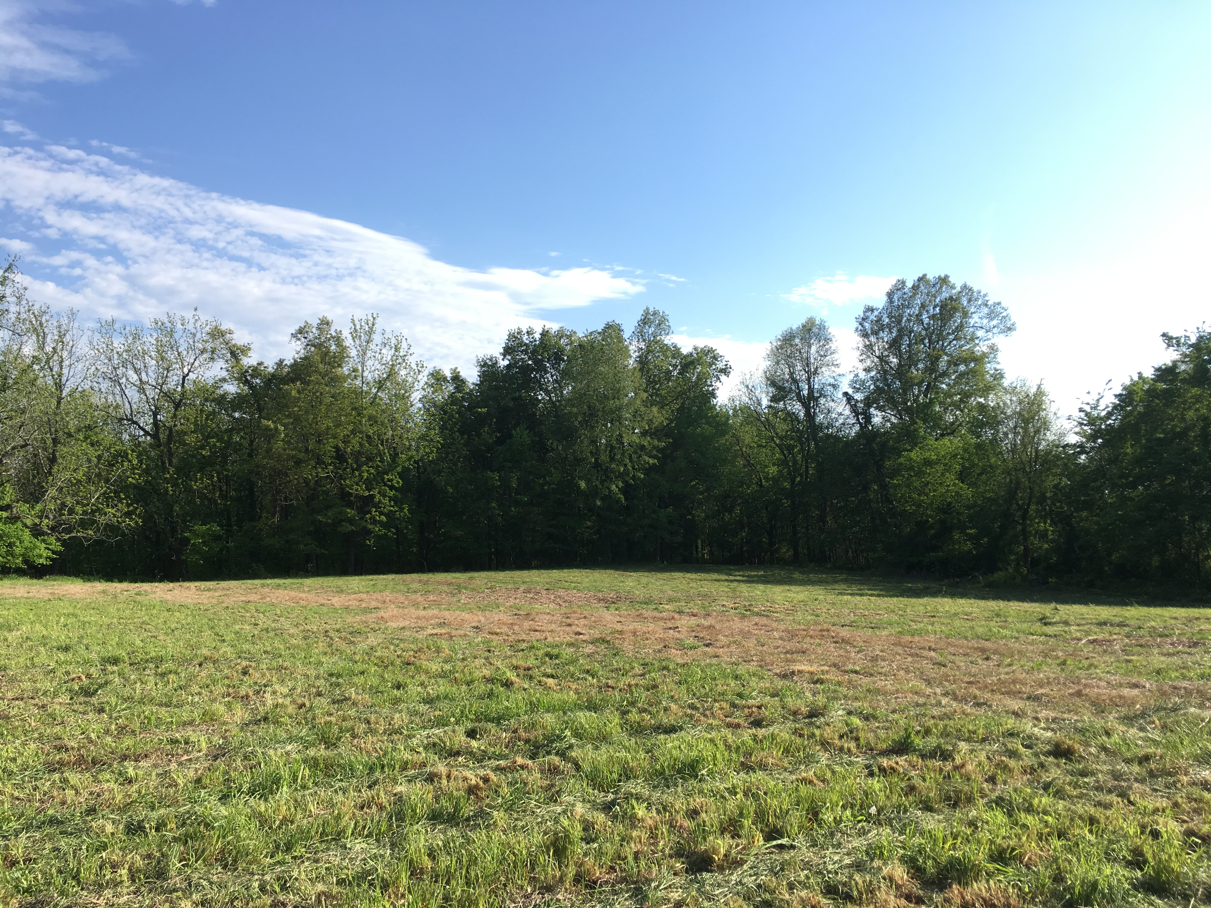

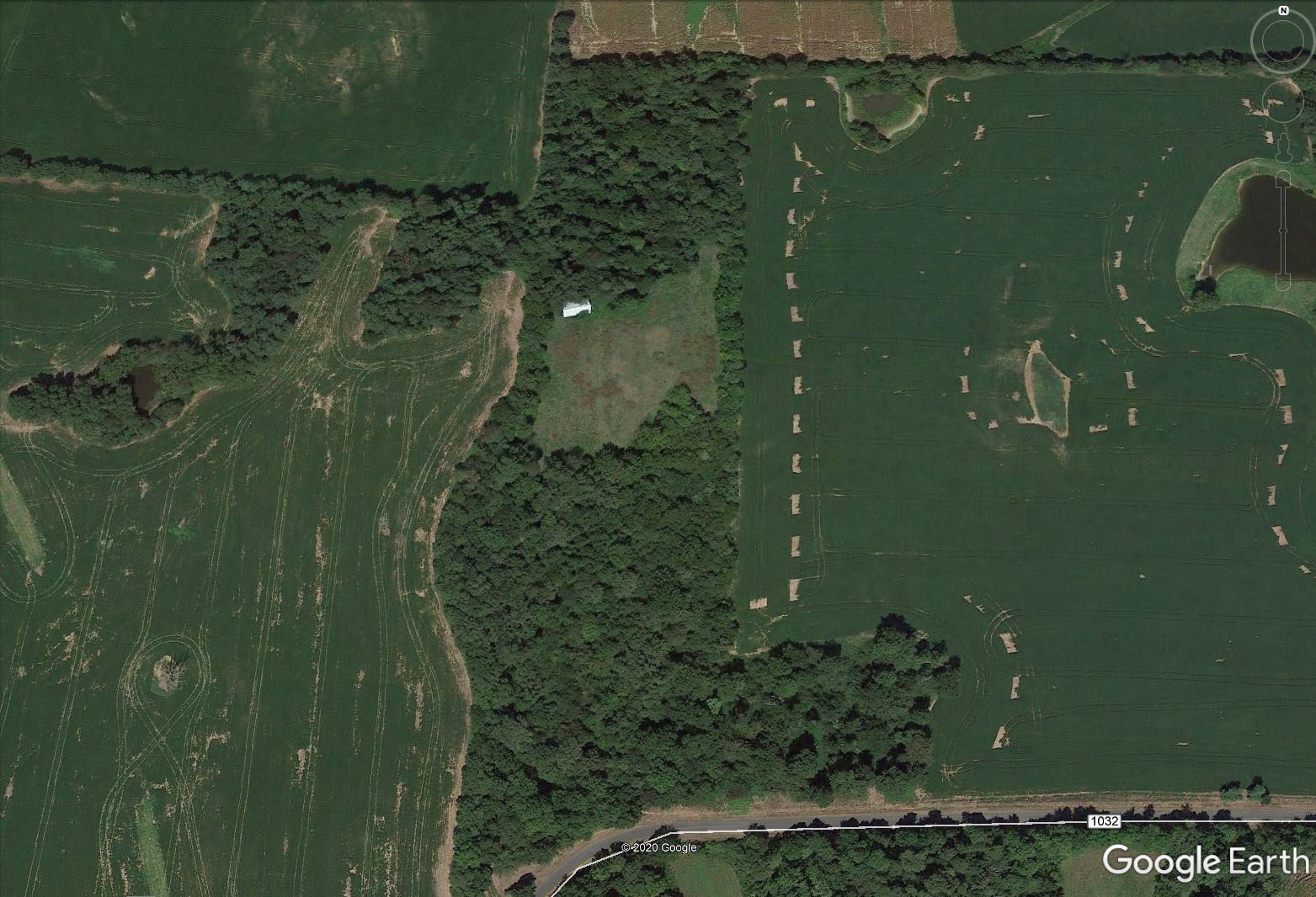

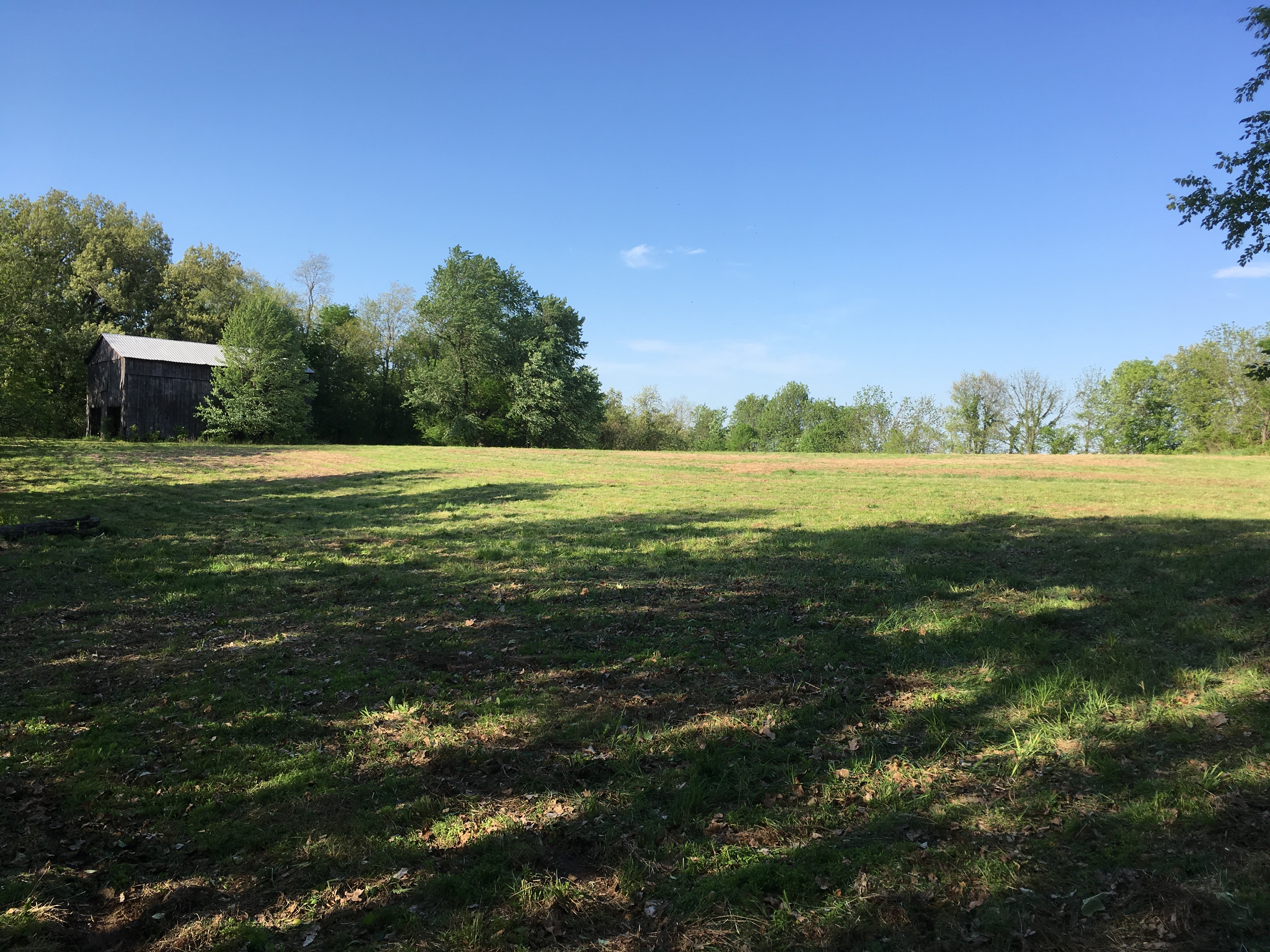

My wife and I just bought a property down the road that is an additional 15 acres and is primarily wooded. It has a long gravel driveway up through the woods to the clearing where we plan to build a home in the next two or three years. The clearing is about 3 acres that I currently keep mowed with the brush hog, but the woods have been neglected for many years and are full of debris, fallen trees, thorn thickets, etc. The property has a gentle slope up from the road to the top of the hill where the clearing is, but the back portion of the property (North of the barn) has some pretty significant hills. I've been doing some work out here but the current tractor just isn't cutting it. See below for some pictures to get an idea of the property. In the aerial photo it is the wooded property shaped like a boot.
New Tractor Uses
- Mowing. Initially just the 3 acre clearing and sides of the driveway, but as I clean up the woods I want to make/maintain trails and potentially even have the woods thinned enough to mow the entire property underneath the canopy of mature trees. Once home is built the 3 acres clearing will become a yard and will be mowed with zero-turn.
- Maintaining Driveway and grading
- Cleaning up and maintaining woods. This will involve removing a lot (and I mean a lot) of downed trees. Many are small, many are not. I think I absolutely want a grapple attachment and the ability to lift trees that are in the 24" diameter range. Will be collecting firewood as well.
- General FEL work
- Possibly fencing/post holes in the future but not a priority
Using the information given, I'd love to get your thoughts on what would be a good fit for my property and uses. Like I said, I feel like I have an idea of what I think I need to get the job done but I'm curious to hear from many of you who are more experienced than me to see if I'm under/over estimating my needs. Please let me know your thoughts and the reasoning behind them. If you have any questions, obviously don't hesitate to ask. Thanks!

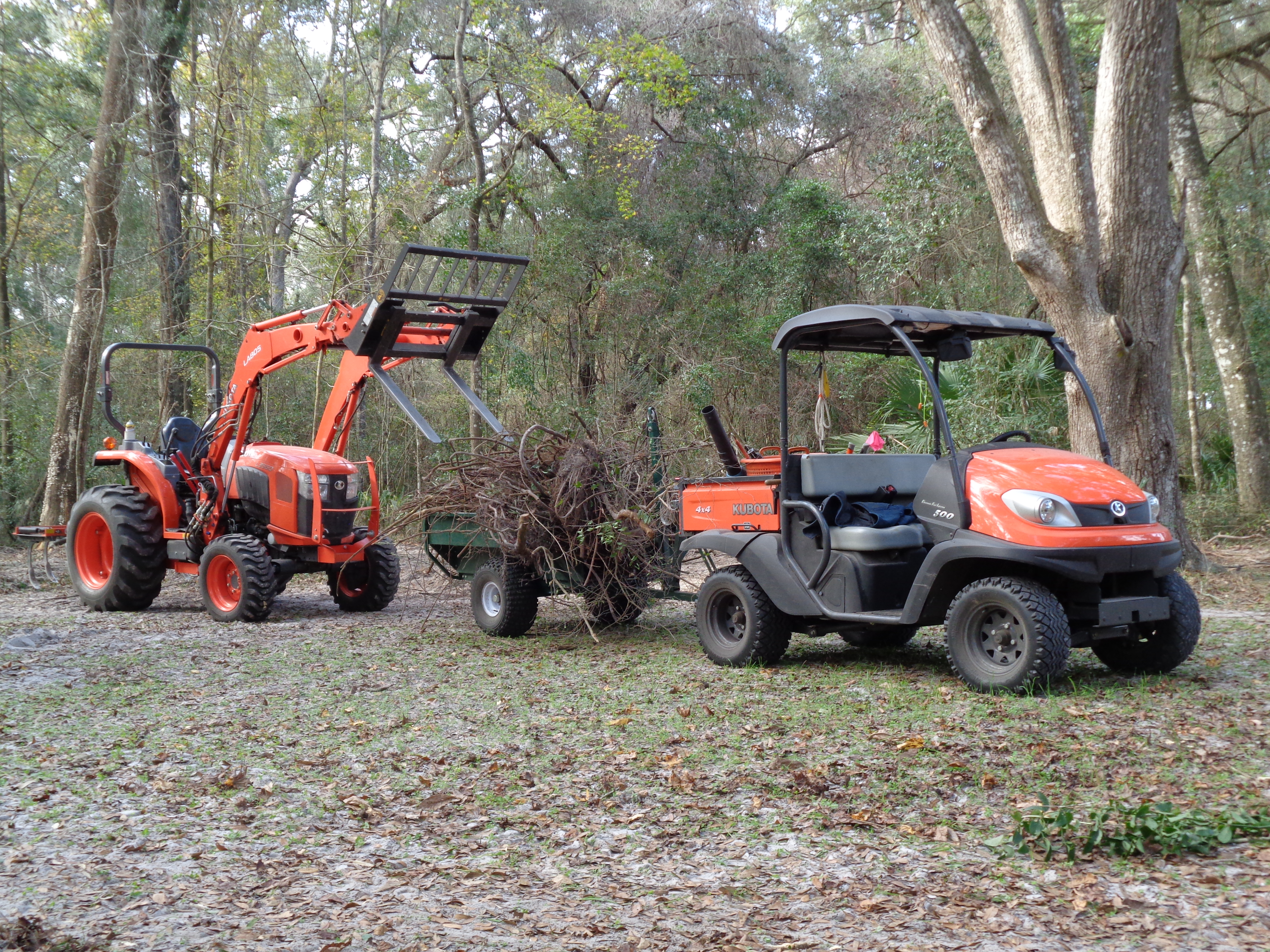

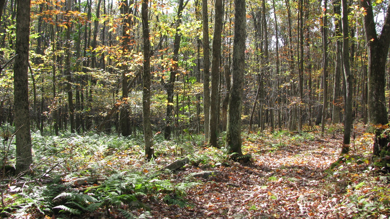

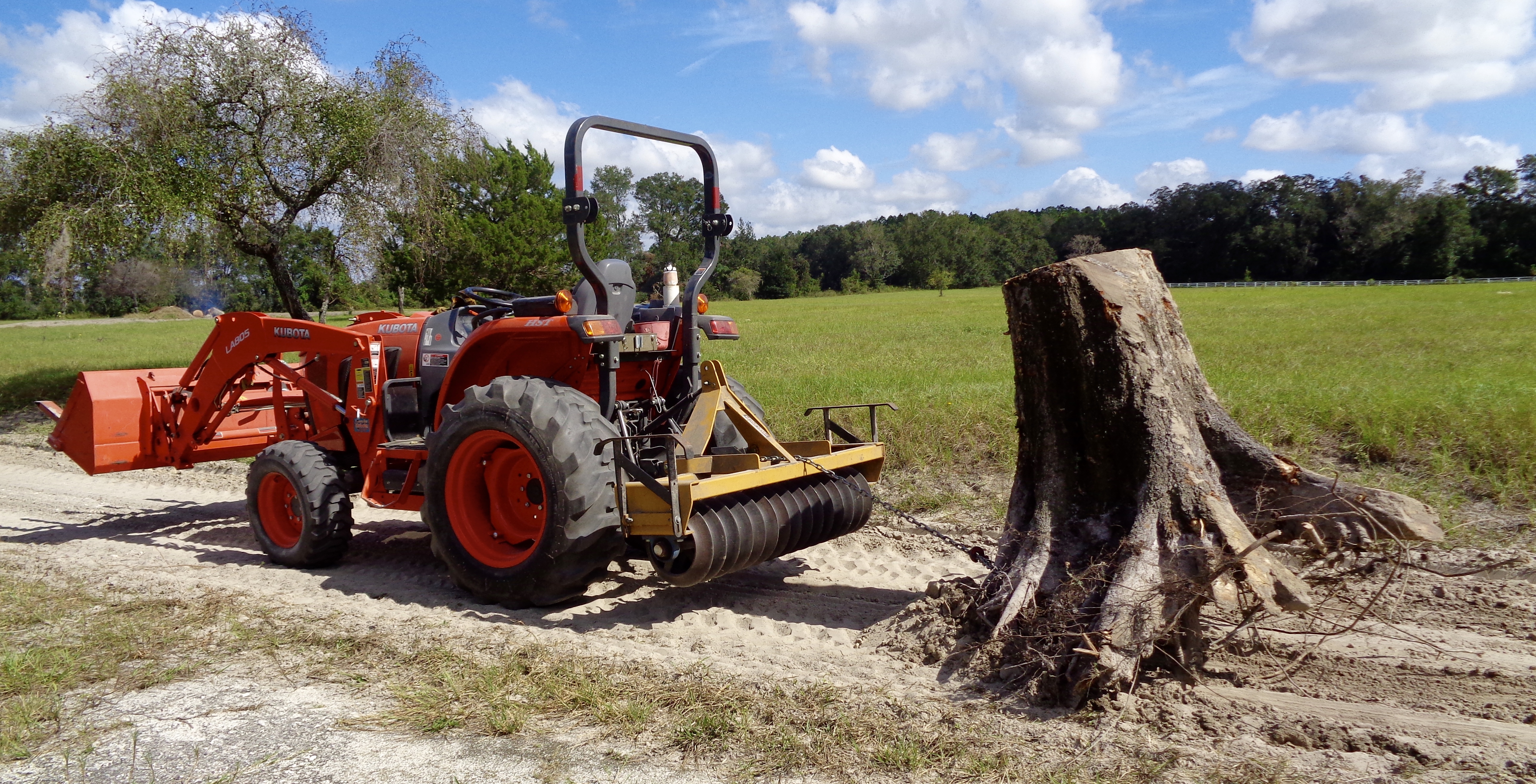

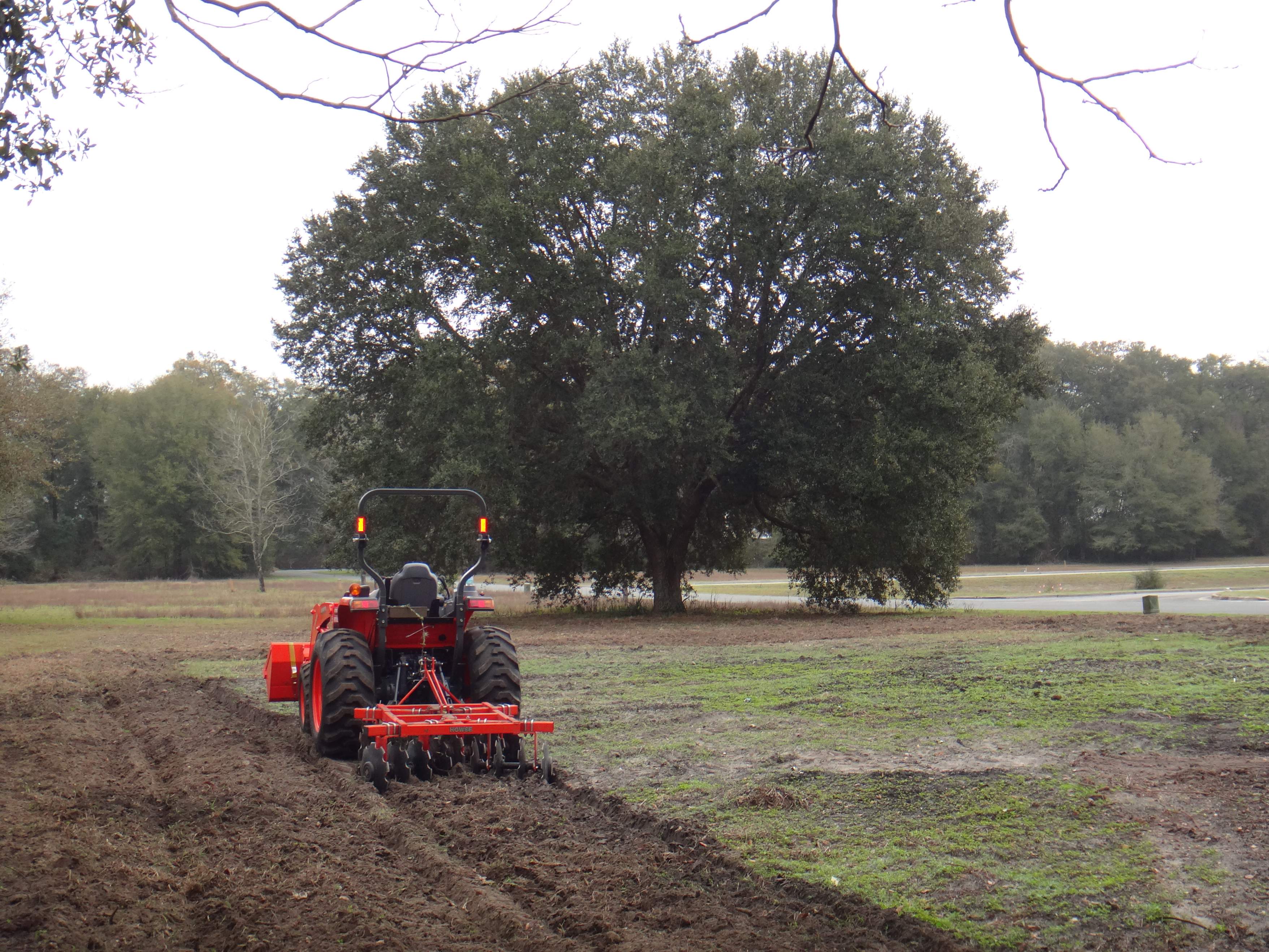

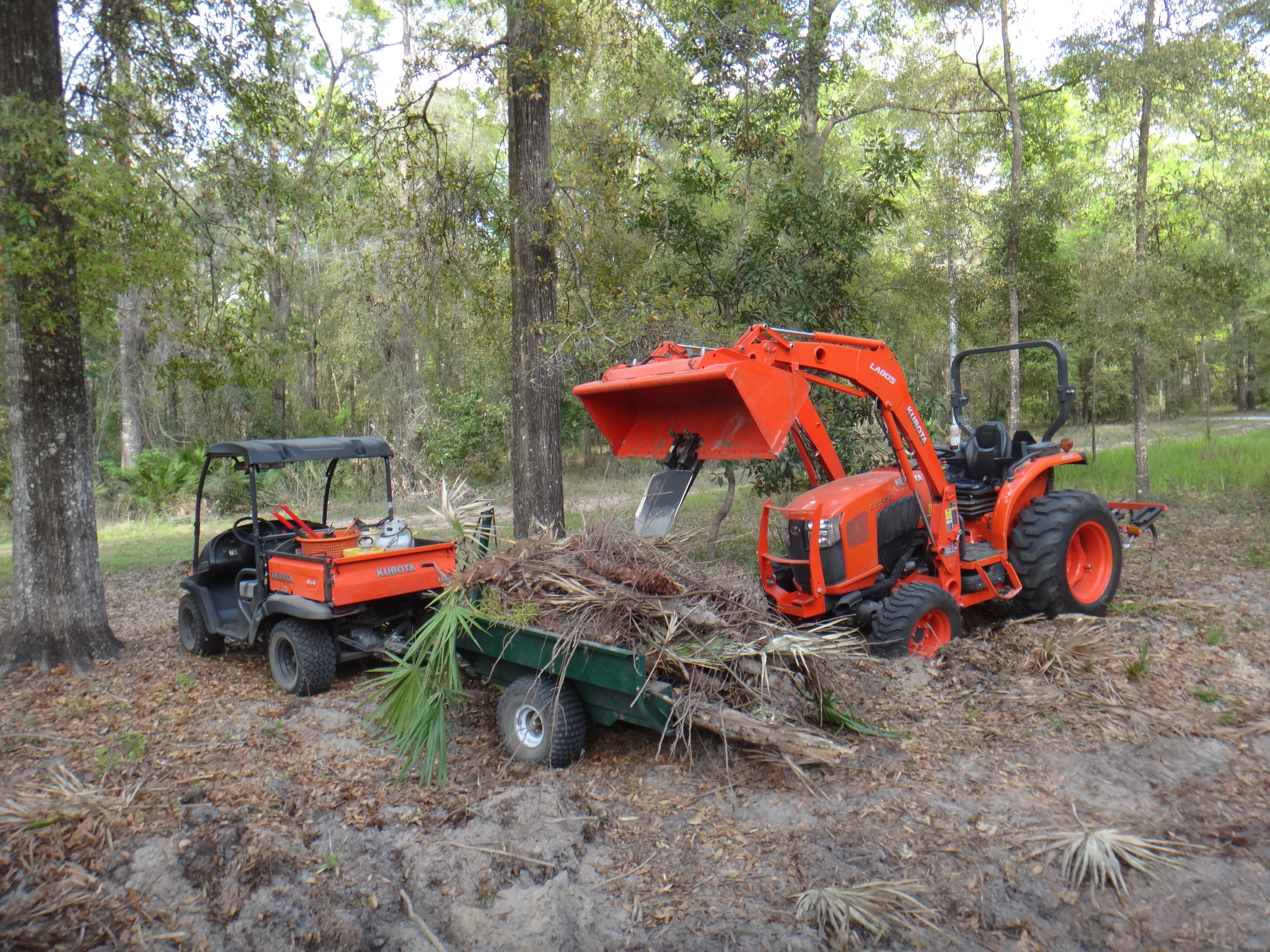

Your controlling application is removing a large quantity of trees and tree debris on 15 acres of sloping ground. Focus tractor research on tractor weight, tractor width, wheel/tire ballast, Three Point Hitch counterbalance and 4-WD. Most tractors have one standard FEL, sometimes one option, so FEL lift capacity is a sub set of tractor weight (+/-).
The weight of your Mahindra, ~~3,900 pounds, seems spot on.
Shop your weight range within tractor brands. Budget will eliminate some choices. Collect a dealer brochure for each tractor model in your weight range. I spreadsheet tractor and implement specs, often a revealing exercise. I have a column for cost per pound.
You need rear axle width for stability but at the same time you need to pass between trees.
Buy a 10' stick of 1-1/2" PVC pipe, which will not sag. Cut to 70" width and mark at 62". This will replicate the rear tire width of likely tractor candidates with R4/industrial tires. Walk around your property and determine how well your potential tractor will fit between trees. When I did this I found access required 60" width tractor rather than 66" width tractor which I had under consideration. As you may change your mind, or your varied needs change, I recommend a de luxe tractor, which will allow adjusting spread of R4 tires in increments. Economy tractors do not have R4 stance adjustment.
Tractors with a bare weight of 3,700 to 4,000 pounds will have a real life FEL lift capacity of around 1,700 pounds, including the grapple. This will be ample, ample on sloped ground. You will need two good chainsaws, one with a 15" bar and a second with a 25" bar to cut up trees.
You will need considerable Three Point Hitch counterbalance for max FEL/grapple lifts. Usually counterbalance is an implement but you may want a more compact 1,000 pound weight box to keep the FEL/tractor/counterbalance unit as short as possible for maneuverability.
You will be doing a lot of burning as well as operating in woods. Inevitably front tires will contact hot coals. Six-ply, tough, R4/industrial tires for you, which are routinely fitted to FEL tractors. Load the rear tires 3/4 with liquid to lower the center of gravity and help hold down the rear end. In warm Florida many 3/4 load rear tires with plain tap water. Some prefer external iron wheel weights to internal tire liquid.
I am only familiar with Kubota models. Deere offers de luxe models in the 4,000 pound weight range. Mahindra probably does not.
Within Kubota's model range I recommend 'Grand L' models with HST/PLUS transmission.
The L3560 is a singular lighter/narrower model with optional LA805 Loader. In the wider models I recommend L4760 with LA1055 Loader or L5460 also with LA1055 Loader.
Grand L models are well worth the money as you age. I am growing old with an L3560.
VIDEOS: Kubota HST Plus Transmission Features - YouTube
Kubota Grand L - YouTube
Good luck in your research. Anticipation is 50% of satisfaction.

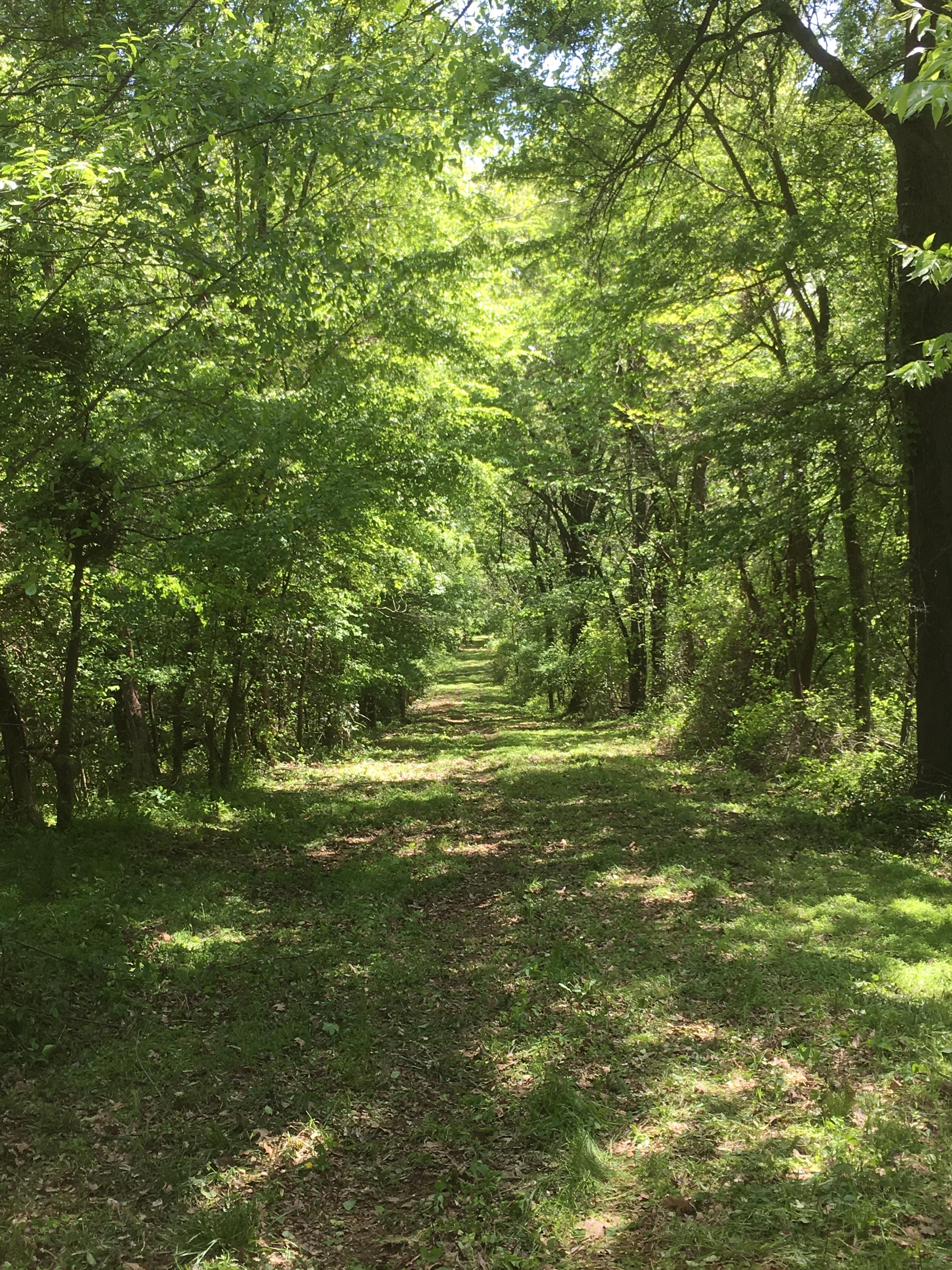

- Mowing. Initially just the 3 acre clearing and sides of the driveway, but as I clean up the woods I want to make/maintain trails and potentially even have the woods thinned enough to mow the entire property underneath the canopy of mature trees........
Others here are offering good advice on tractors, and I believe a grapple will get a lot of use. Do you have a UTV (side-by-side) Maddog? I have acreage that consists of a lot of woods and I find myself using my UTV in them way more than my tractor. Used it to carry my saw and Still brush cutter to put trails in. I only had to cut a few large trees because I tried to go around or between them but had to clear a lot of small stuff up to maybe 6" diameter. When I ride the trails now I carry a saw and loppers in the back to clean up whatever falls across them. UTV is handy for carrying cut firewood as well. I did use my tractor bucket (Kubota B7500 at the time) to carry material for fill in a few places and still do maybe once or twice a year to dump some stone in a wet rut or grapple something, but generally I find that a tractor with a loader and ballast box can be pretty cumbersome in the woods. Three maybe four times a year I run my ZTR over the trails with deck all the way up for keeping the weeds and grass down.
I occasionally walk through the woods to cut large vines or invasive plants such as multi flora rose. It is really none of my business but I will just ask.... why thin out the woods everywhere to mow? Wildlife appreciate and actually need all the undergrowth, small understory trees, standing dead trees, downed trees, brush piles, etc. and the rotting wood is good for making more soil. It is enough work just maintaining the trails I couldn't imagine trying to pick all the rock and tree debris in the woods and keeping it that way to mow.
Nice looking property BTW!

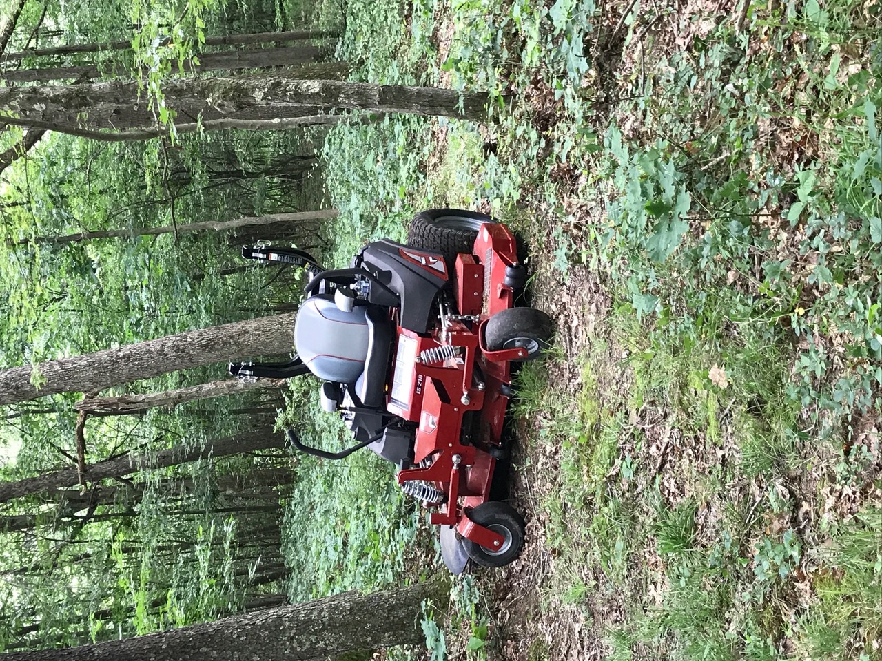

We do have a UTV. It's a 2017 Kawasaki Mule Pro FXT. Absolutely love it and use it daily. Short wheelbase, can be 3 seater with full size bed or 6 seater configuration with small bed. Best piece of machinery that my family owns. Here's a picture of me and my son picking up sticks pulling down some huge vines that had climbed an old oak tree along the driveway.
As for the woods, we are still on the fence as to what exactly the plan is. It seems to change daily. We've discussed full clearing of the back woods except for 20-30 mature trees, we've talked about clearing an area for a nice pond, we've talked about just creating trails and leaving the rest for deer/turkey (we currently have one main access trail cleared that loops around the back). That trail was cleared by an excavator and the trees are piled up along the side of the trail. We love the wildlife and they are especially abundant in our front woods which is going to remain as-is except for just picking up fallen trees and clearing deadfall that could be dangerous for the kids while they play in there. The back woods though is scraggly and mostly scrub trees that block what would otherwise be one of the best views in the county. Our building site is at the top of a hill and you can see for miles but the trees block most of it. Like I said, not exactly sure the plan. This is view looking East which is clear other than the treeline I'm standing in.
