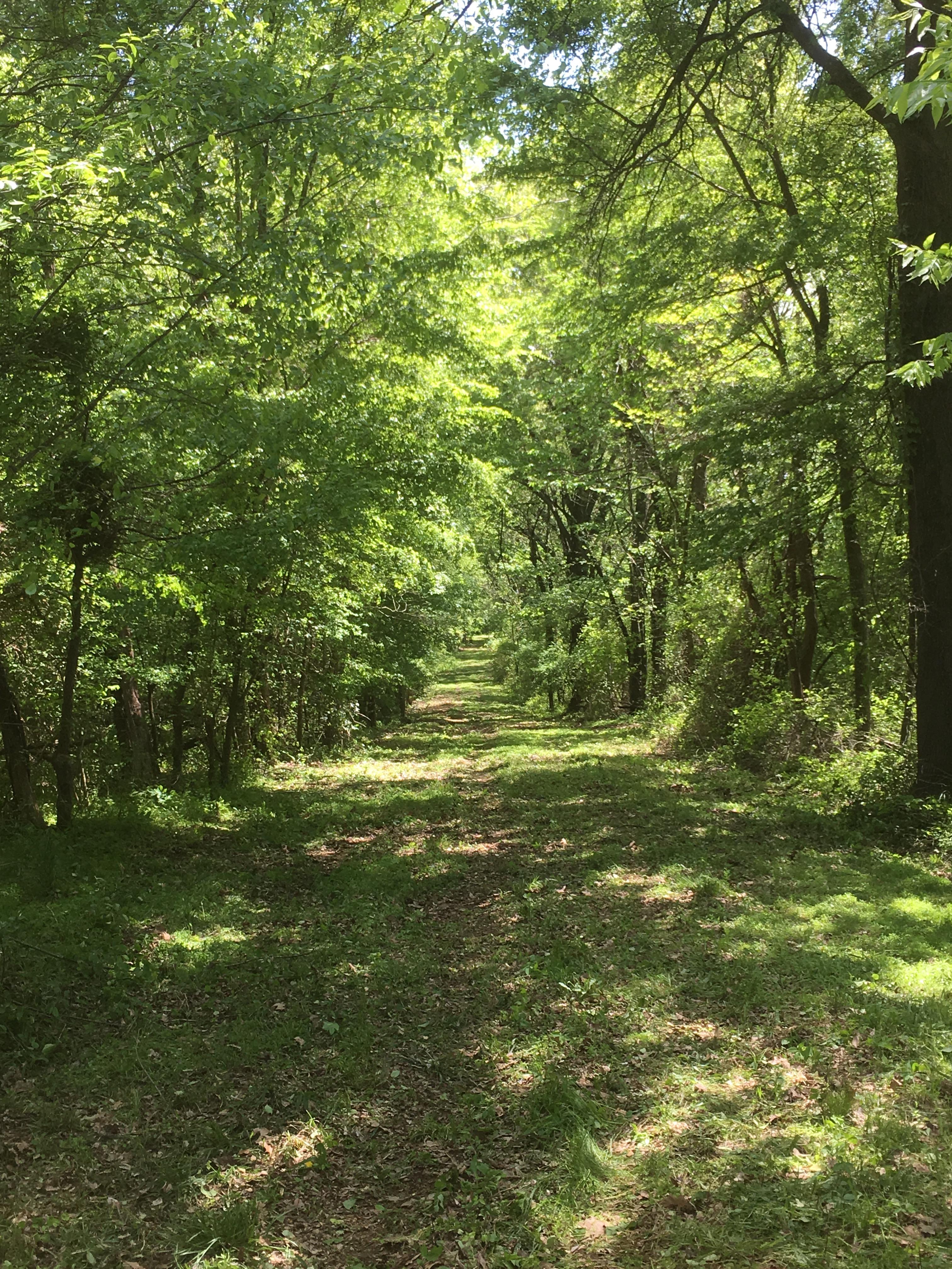

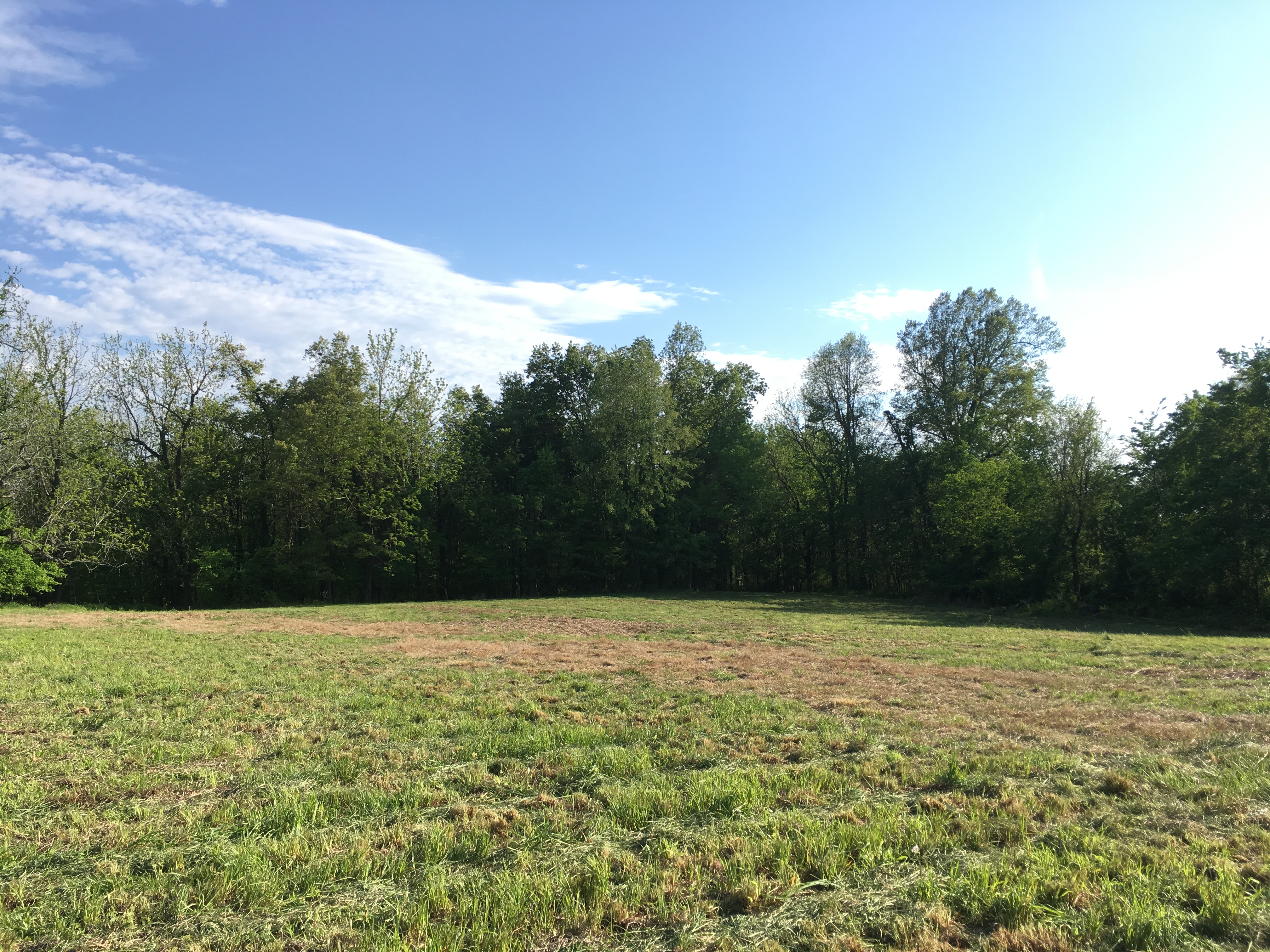

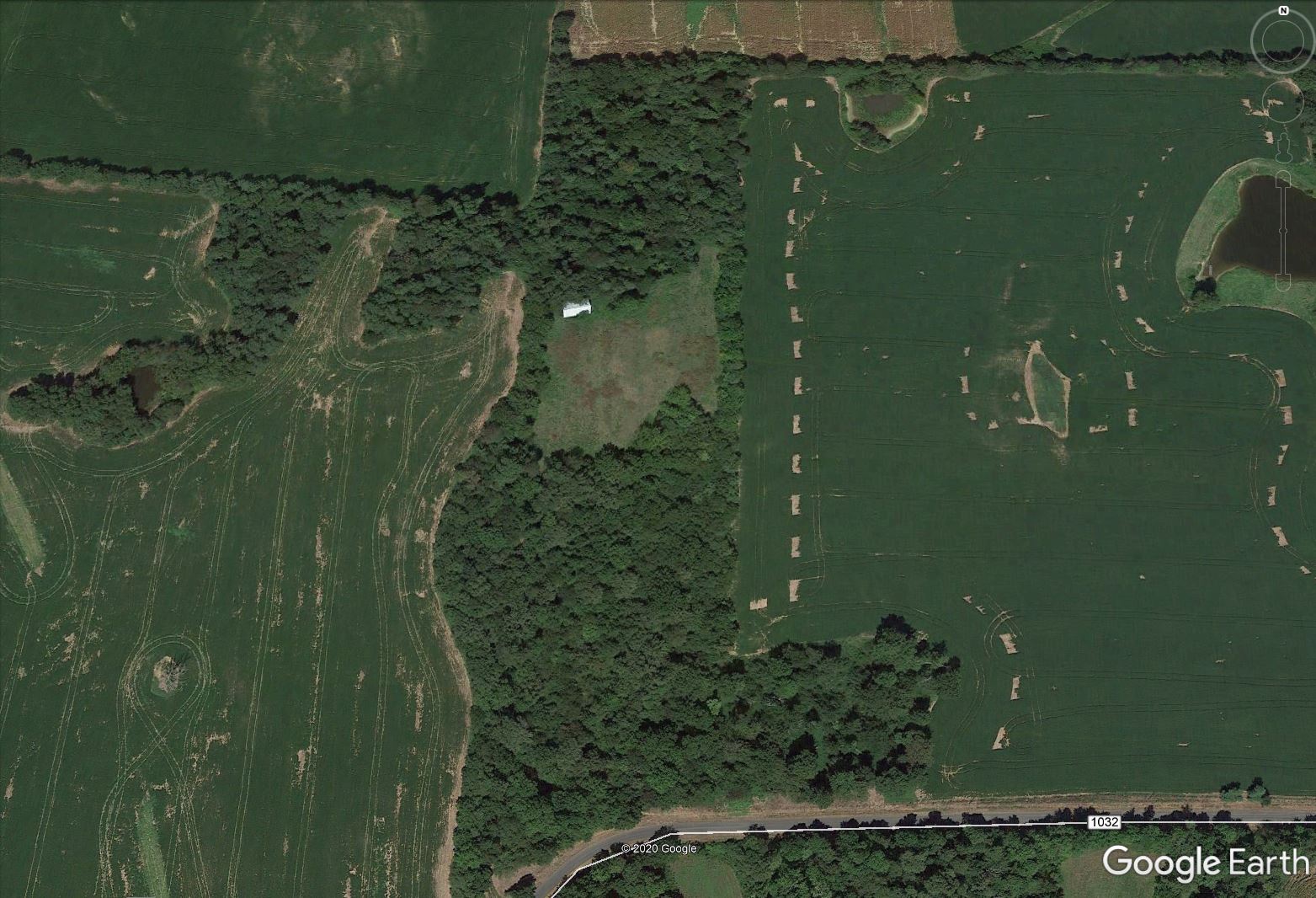

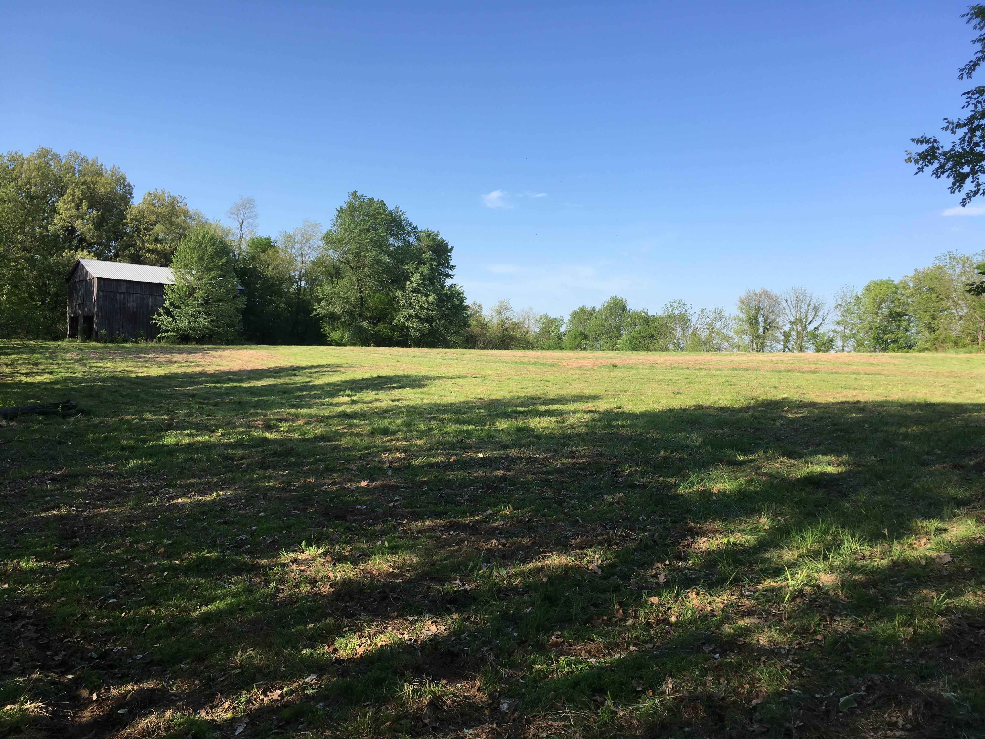

My wife and I just bought 15 acres, primarily wooded. The woods have been neglected for many years and are full of debris, fallen trees, thorn thickets, etc.
The property has a gentle slope up from the road to the top of the hill where the clearing is, but the back portion of the property (North of the barn) has some pretty significant hills.
- Cleaning up and maintaining woods. This will involve removing a lot (and I mean a lot) of downed trees. Many are small, many are not. I think I absolutely want a grapple attachment and the ability to lift trees that are in the 24" diameter range.
Moving tree debris is the OP's primary tractor task.
I find SSQA Pallet Forks entirely satisfactory on my flat land. For the OP's land, all sloping, some significantly hilled, I opine a grapple squeezing tree debris will make transportation of tree debris a safer proposition. A load shift on Pallet Forks could roll the tractor.
I've had individual logs roll over my Pallet Forks and crash onto the tractor hood with only dents as the result. The OP is giving consideration to a cab tractor. Logs might have broken tractor glass, had I a cab tractor.
