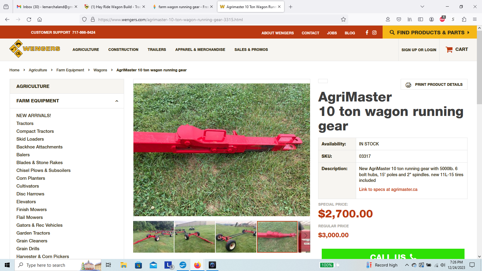

As others have mentioned the wagons with the pivoting front axle should not be considered at all. What ever wagon is used should have tie rod steering.
Also something else to be aware off many of the older farm hay wagons do not have bearings in the wheel hubs they are just bushings. When woreout they can be a nightmare to recondition to be usable.

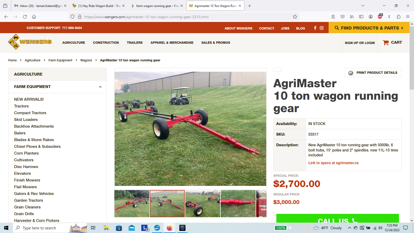

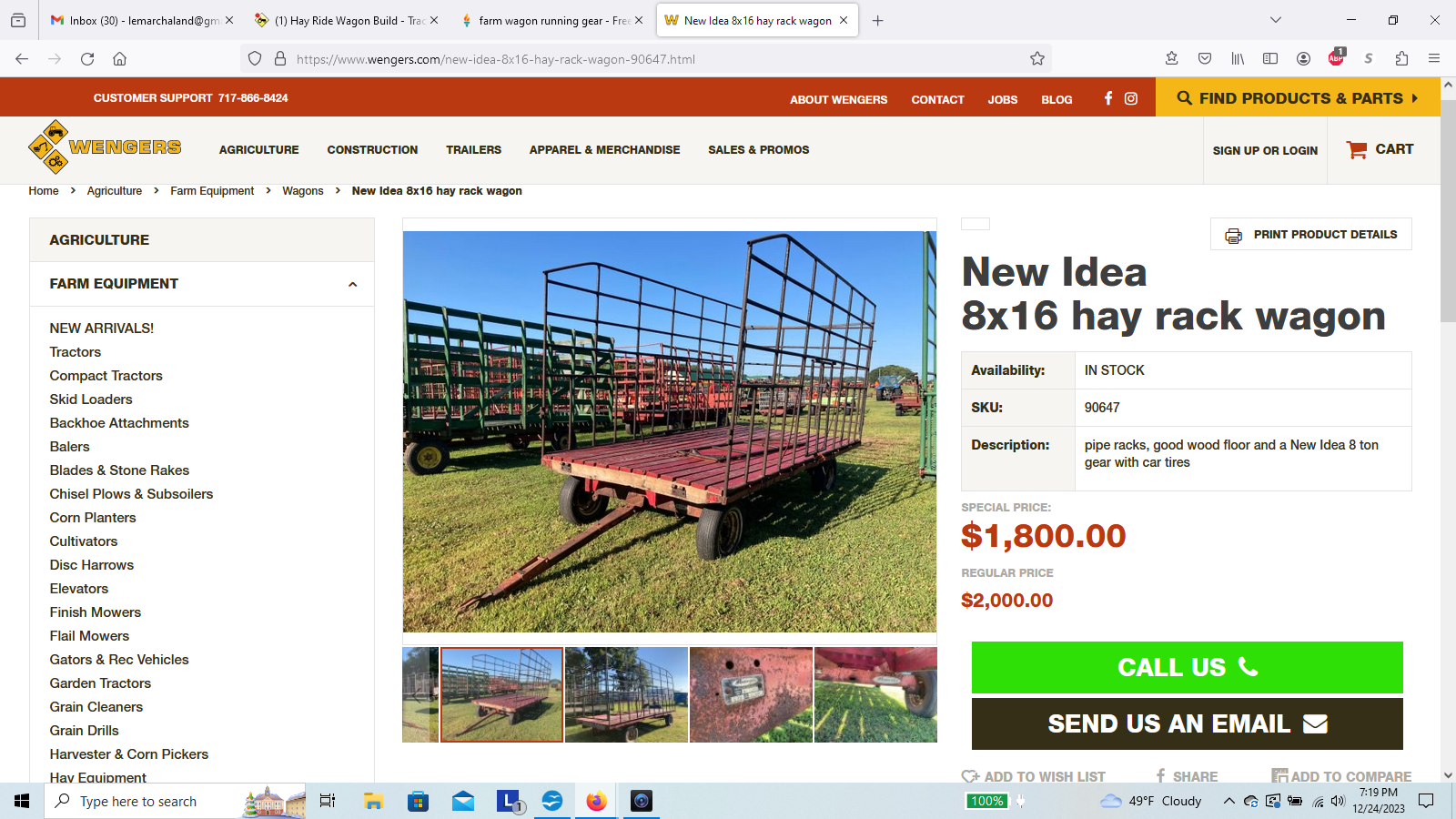

But here is a brand new running gear, in many areas you can find a lighter set (6 ton) for about half that,
This adjustable tongue is a very worth while option makes hitching up much easier,
you just backup to within 3 to 6 inches of your drawbar hitch hole unlatch and extend the tongue,
drop in the hitch pin then backup to latch the tongue in place and go.
On many of the newer running gear brakes are an option, if you are using a light tractor brakes and a manually operated controller would be nice, especially if your tractor does not engage 4wd when the brakes are applied.

Thanks Lou! I did not know some of the older gear did not use bearings. Bushings would be more problematic. I may have to look at newer stuff and plan on doing some traveling. Shipping I would think is pretty expensive.
One thing I will have to determine is if I can get it on my 20‘ trailer. 6’10” inside the top rail.

On a new or newer one I would be tempted to just put it behind a pickup and go. But one nice thing about all the running gear that I have worked on the "poles" or reach are removable and you would have the rear V with the wheels and the front V with the wheels and the tongue can be folded up or one bolt removes it so it can be easily fit on most any trailer.

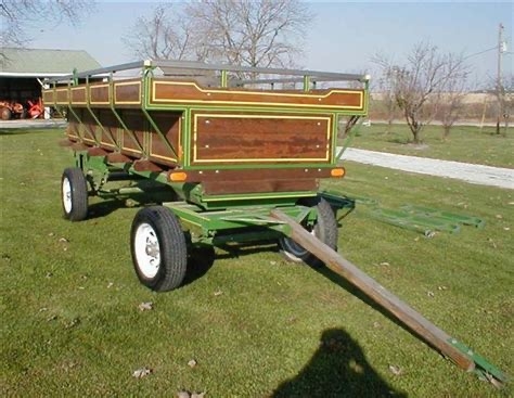

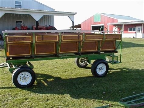

My friend is Mennonite and has a houseful of people right now. Possibly I can get some pics Wed. I don't remember exactly what it looks like but it's pretty, functional and pleasant for people to get on with nicer clothes.
Your wagon frame looks good with the tongue arrangement so you can back it up. A regular hay wagon tongue is difficult to back up. My friend's wagon I think is an Oliver with small springs built in. Here are a few ideas off the internet.

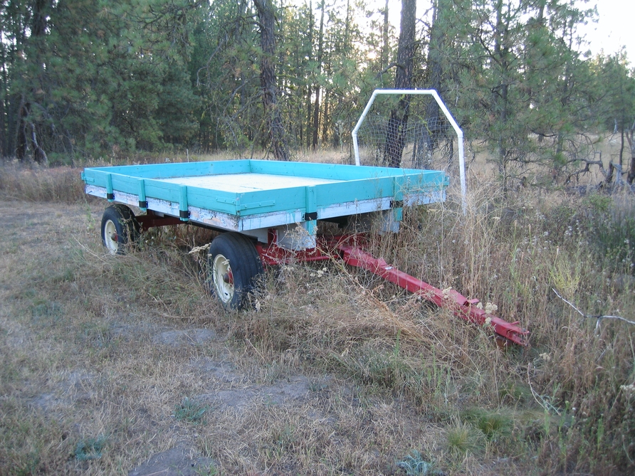

I have a farm wagon because I built one with brand new - ten ton - Horst running gear. As I remember - total cost was right around $1800. That was twelve years ago. I'm FINALLY getting pretty good a backing the thing up.
The two main beams - paired 2x12's. Also - 1" plywood - sandwiched between the paired 2x12's. Glued and screwed together. The cross members - 4x4 pressure treated timbers. I used steel gussets to tie the 4x4's to the main beams. The decking - 5/4 tongue and grove exterior grade plywood. The paint - a mix of all the leftover latex paint I had.
The deck is 8' by 12'. I had a local welding shop make the ten stake pockets.
Things I should add now. I've used this wagon - several times - to pull folks around the property. It can be a rough and bouncy ride. After the first time - one layer of bales completely across the bottom. A second layer form the side walls and forward end wall. A heavy rope across the wagon at each stake pocket( three ropes). For folks to hang on to and not get bounded out. I have a higher set of stakes and side boards for these "hay rides". The side boards are 2" lower than the two rows of side bales. This is really a fun ride. I pull them down to the far end of the property and we have a bonfire and weenie roast. This is a late fall or winter activity. When everything is damp or there is snow on the ground. Always concerned about wildfires.

My Horst running gear is an exact duplicate of the AgriMaster gear that LouNY posted. Right down to the extendable hitch. For me - this extendable hitch is a real life saver. Hook up the wagon - go to where the pine trees are - disconnect and use the grapple to load the tree trunks on the wagon. I now have a wagon that no matter how much @#$% - I CAN NOT move it. Back up as close as possible - the extendable hitch comes into play and hook up is easy.
Using brand new gear - the build was very easy and a lot of fun. I got a schematic off a web site. I think I just entered - "farm wagon build".
The empty farm wagon is heavy enough that I'm not able to pull it around the yard. I use my ATV to do that.
Yes - my great grandkids enjoy riding around the property on the farm wagon. Without any type of suspension it can be a rather jolting ride. I go slow. Don't want to bounce anybody out onto the ground.
