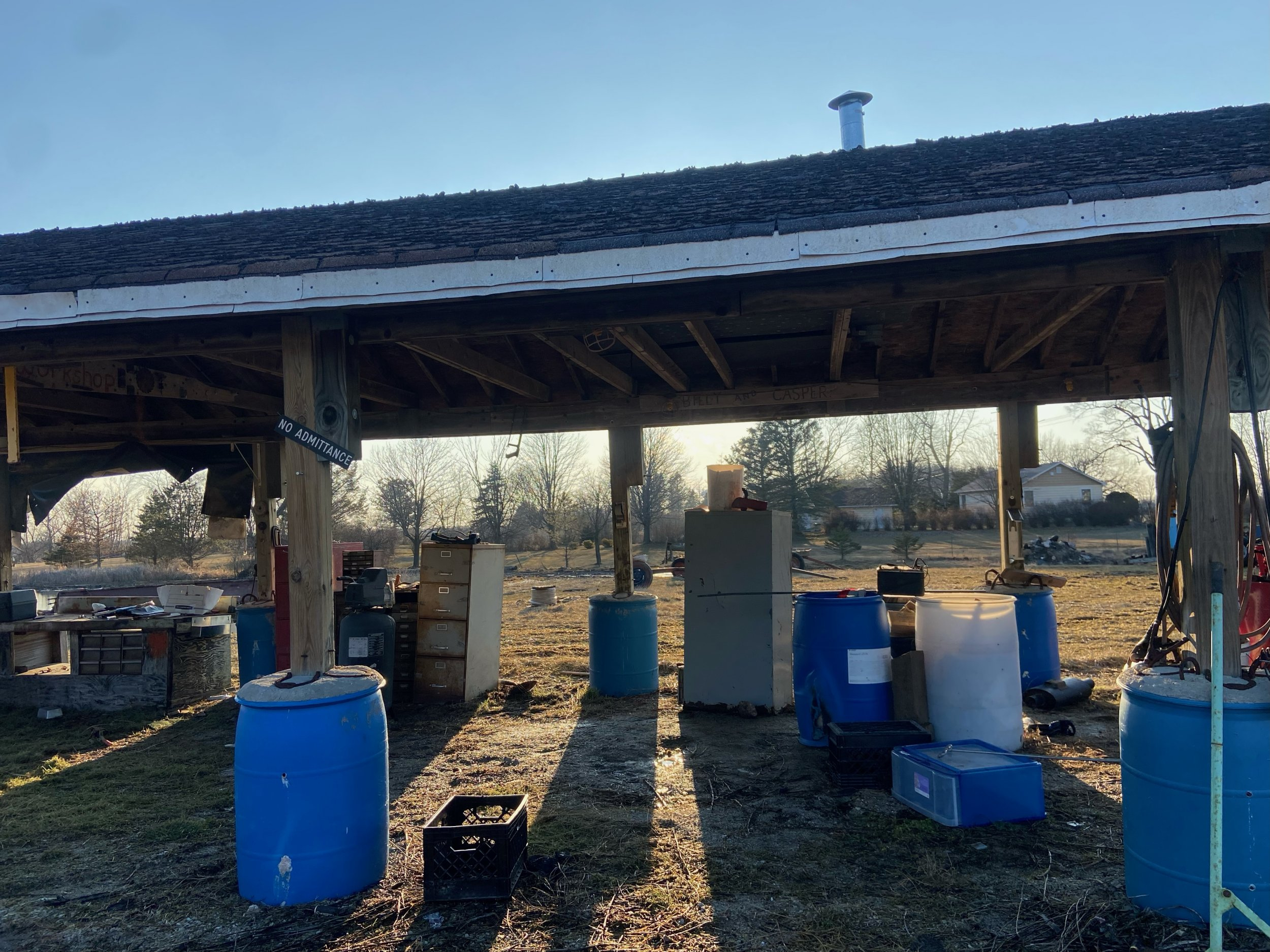

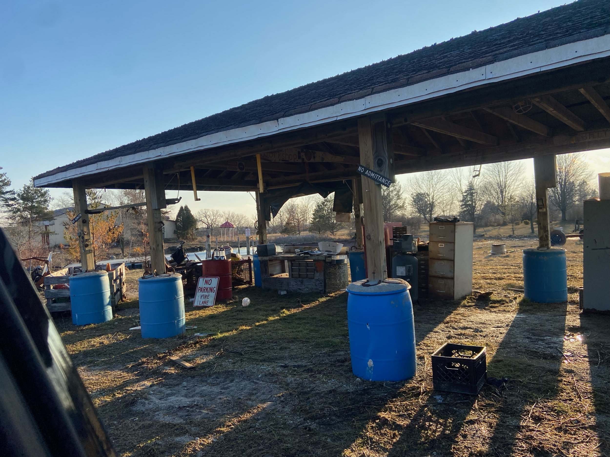

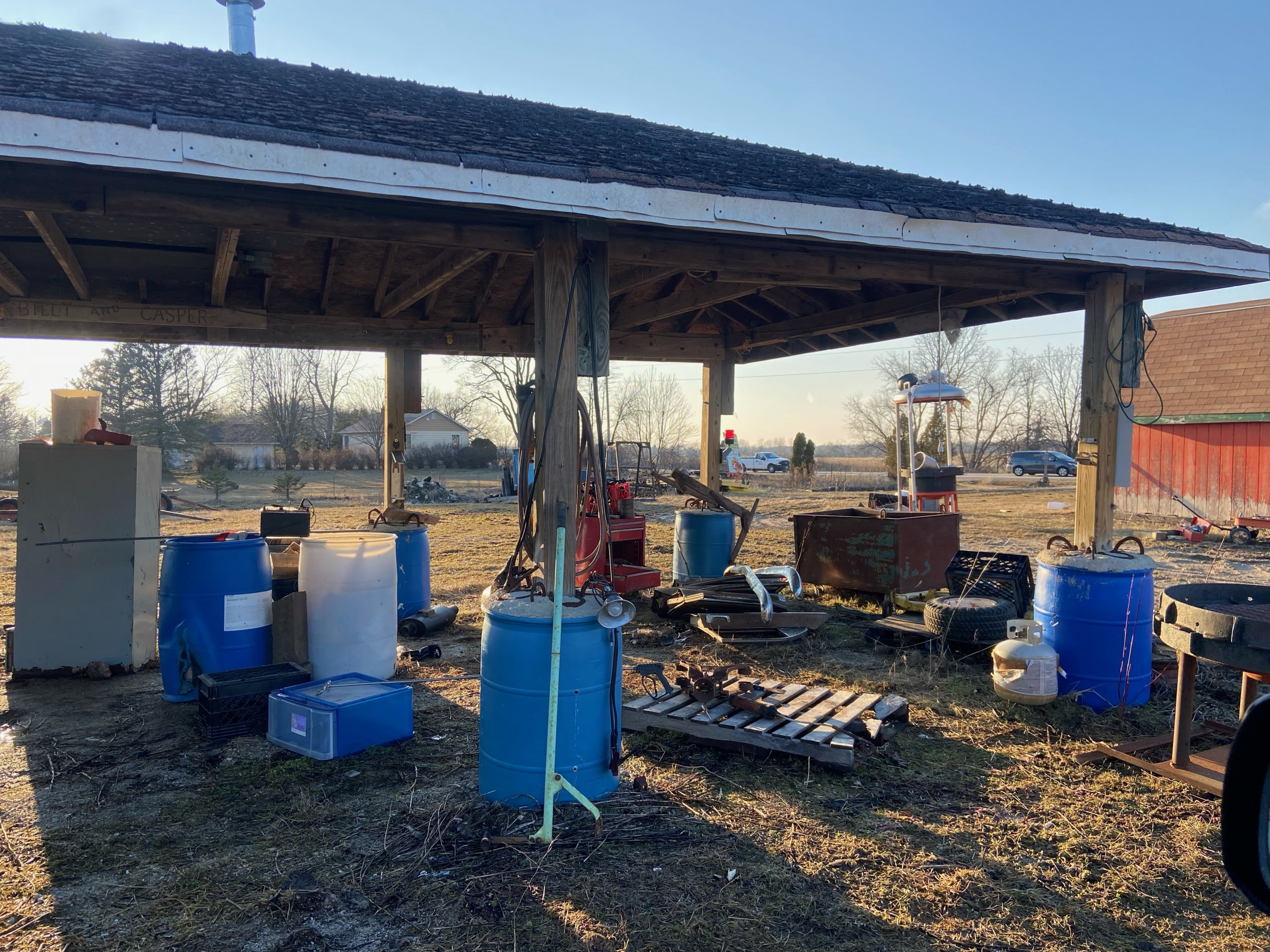

A gentleman not far from my place built a very well made lean-to/pavilion and used it for equipment service. He has passed away and the family wants the property cleaned up, the building included. I can have it for nothing, just get it out. It needs a roof, but it is well made. It is 44ft long, 16ft wide, about 8 feet tall around the perimeter. I would use it for the same thing, but I need some help figuring a way to move it. The site is pretty open, there is a heavy forklift on site as well as a heavy skid steer. My thought was to pull 3 hay wagons under the roof, place two 45ft telephone poles on top of the wagons, lengthwise and then bolt them together with shorter pieces of telephone poles (call them 6ft wide). Once this is under the roof, lift the ends of the telephone poles up to the roof and get the weight off of the posts. Chainsaw off the posts, and lower the roof onto the wagons. I would chain the wheels straight on the back two wagons and allow the from wagon to steer. He is about 1 mile from my place and it is a pretty easy ride over. I would pull it with my pickup.
My fear is getting telephone poles that long and they would make the roof too heavy. I also don't really need the big poles......any thoughts on another way/better way to do this? No, I'm not going to pay someone to move it. I don't think it is going to be worth the expense. And I have never hauled a hay wagon with the steering axle chained in a fixed position, thoughts?

If the forklift and skid steer can handle the weight, I'd give it a go.
/ Moving and repurposing a building, advice needed #5
If you could borrow a flatbed semi trailer with a front jeep, that would be the way to go. Back it in centered, thoroughly brace the building down to the deck and then remove the posts. If you were careful you could move everything to your place and reuse the posts if they are still good.
/ Moving and repurposing a building, advice needed #6
can the roof be sectioned into 3 x 15 ft pieces ?
a flatbed semi trailer sounds like a good option
if the roof can be slowly / carefully lowered off the post / barrels onto a trailer, that would be good
is the new location prepped, accessible, and ready ?
I think the roof and telephone poles would be too much weight for a pickup
all the best with this endeavour

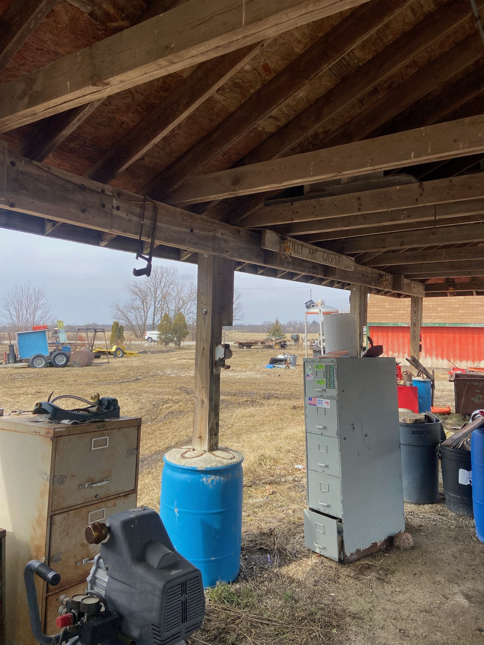

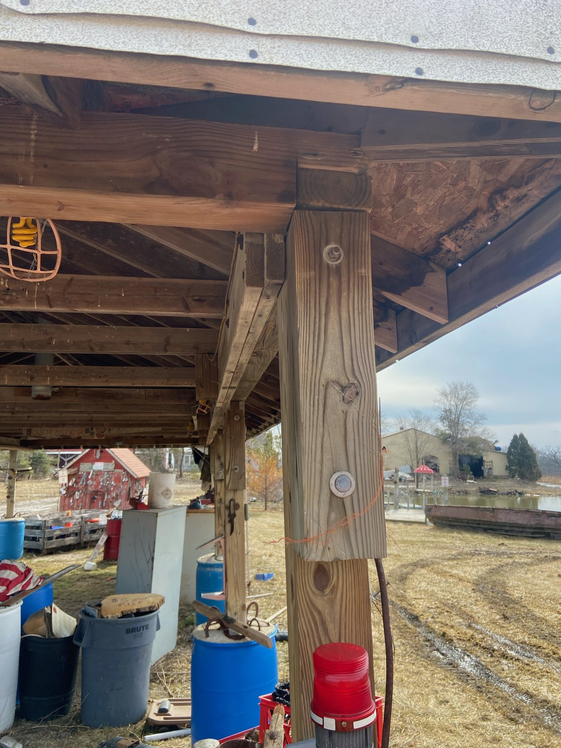

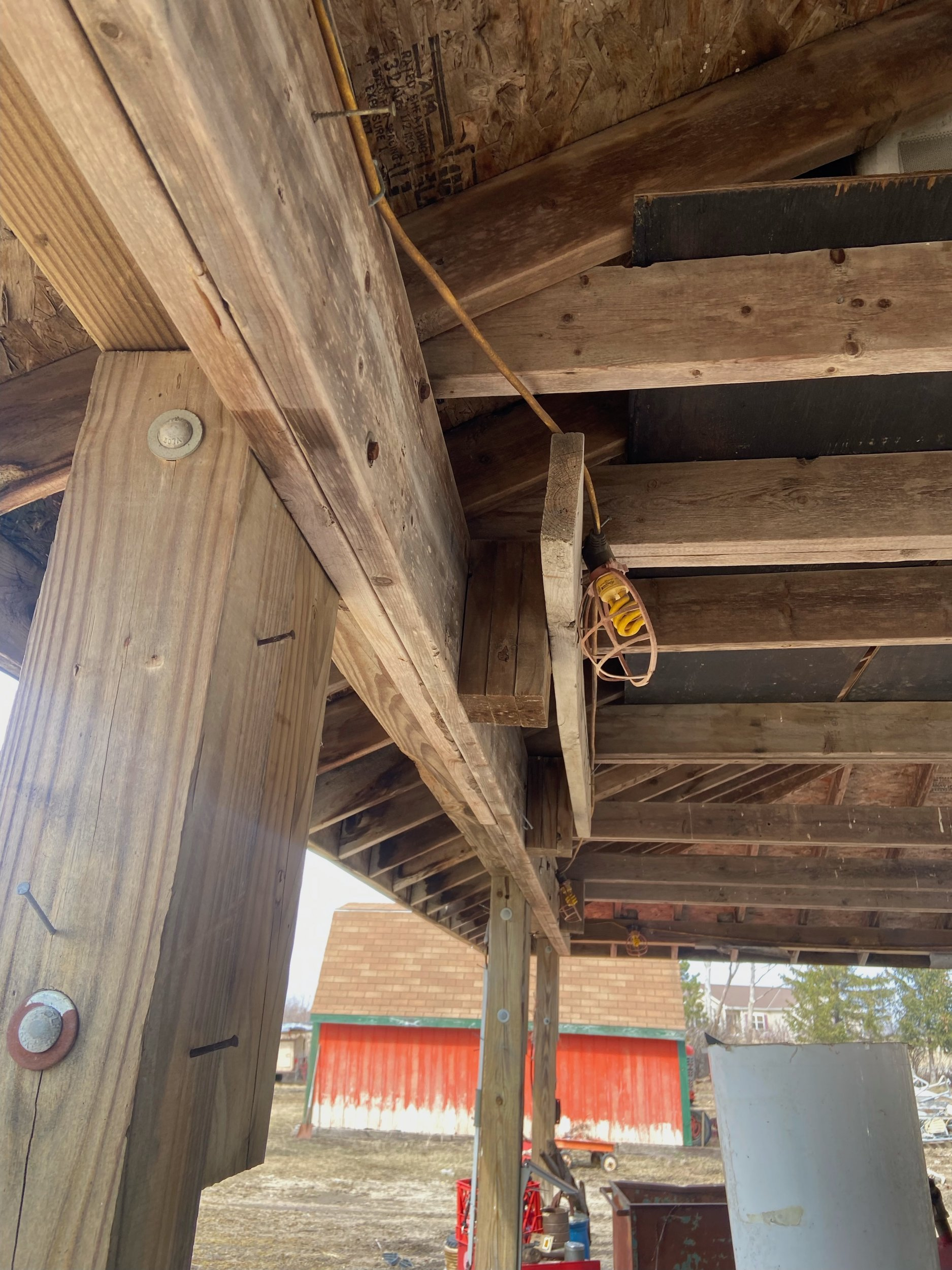

I went and looked at the building again, it has a large double 2x10 main beam/header running the length of the building. I can't get a hold of any 45ft telephone poles, the longest I can get is 32ft. My thought would be to add more bolts to the beam/header to stiffen it up, add another cross beam on the ends spanning the shorter ends versus trying to span the length. Lift the building with the added cross beam and use the existing main beam to raise it up off the posts. Once it is raised off the posts, lower it down onto the wagons. If I use a short telephone pole to rest it on a wagon, I can fix it in place in the center of the wagon so it can pivot while moving it. I have a couple 10 ton gears and the rest are unknown, but not as heavy.
On a side note, I don't know if my skid steer will lift the roof its an old Gehl 4500, 1100lb capacity and once the bucket is all the way up, that drops way down. I do have a nice Clark forklift, with deep forks, but the site is pretty soft and usually is.
