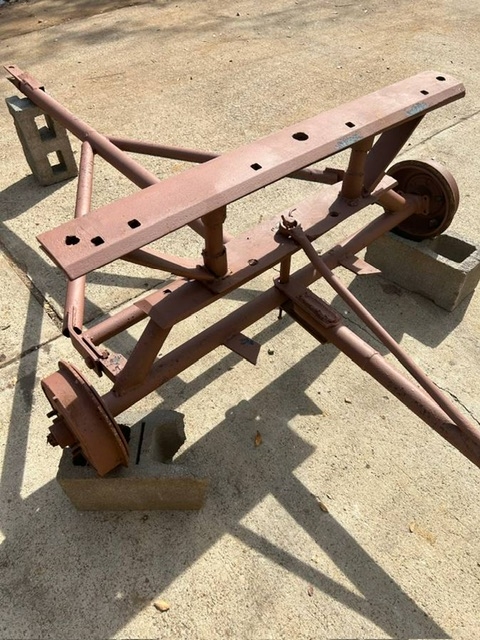

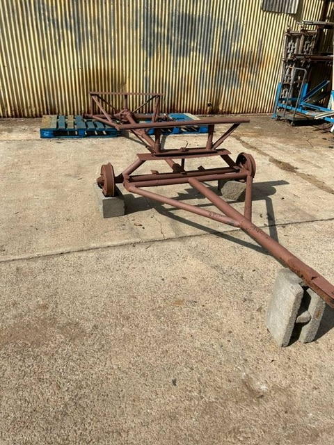

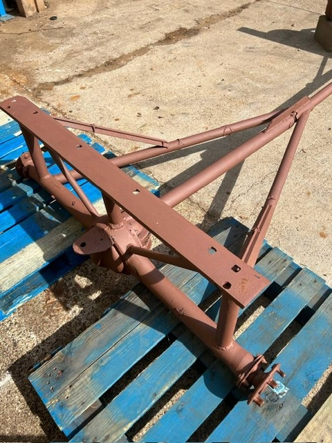

I have been looking for an old farm wagon running gear for quite some time. There is not many to be found around my area. I would like to build a wagon to do hay rides with the grandkids and such.
There is one that I just found but it looks homemade and not sure what the thought process was on this design.
The asking price is $300.00 but not sure this is the right candidate for my use. I will not be able to see it till next week but wanted to get some input from some of you smarter folks. Here are a few bad pictures.
Any thoughts on making a hay wagon out of this?

I've never built one before, pulled one before, or even seen one in person before. But for $300, I don't see how you could go wrong. If the axles turn and the bolt pattern isn't something odd like a mobile home, and you can get rims for it at a good price, I'd probably go for it.

I would rather have a real running gear's steering design than the one the OP posted.
/ Hay Ride Wagon Build
#12
That is one of my main concerns with this thing. Also the height the bed will be by the time I finish.

I would pass on the one that you have pictured. It looks to be of the fifth wheel design. That is the front axle turns on a pin sticking down from the frame. Instead look for one that has automotive style turning. That is it has tie rods and tie rod ends and leaves the wheels at the corners as you make the turn. The fifth wheel design can get tippy as you make it a turn.

A standard 16' utility trailer would be lower to the ground to get in/out, would have a suspension and could be used for other purposes. However, I see a lot of hay rides where no thought appears to have been given to someone falling out and hitting their head or breaking a limb.

With that style steering, the tighter you turn, the narrower the front (let’s call it) “effective axle width” decreases, relative to the wagon width. At 90° pivot, it’s essentially zero, a single point in the center. Here, the wagon is totally relying on the back tires, and frame stiffness, for lateral stability, to not tip over.
Given that the cargo is PEOPLE, and terrain, weight distribution can add additional instability to this design, I’d pass on that running gear.

Keep looking. That home made fifth wheel design is to tippy for hauling anything mildly heavy or expensive, especially kids.

I used a pivoting front axle hay wagon for one event, and couldn't get the hang of backing it up. For the next 15 years to present I used a 16' or 20' equipment trailer with fab'd side rails and hay bales for seating.
