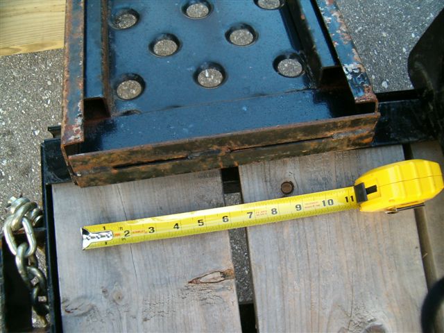

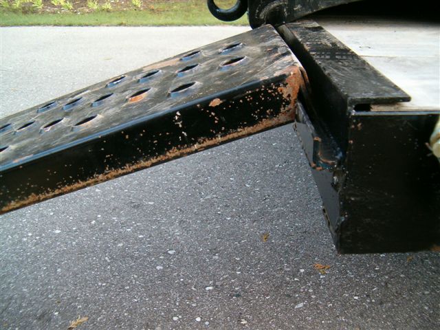

A picture is worth a thousand words:

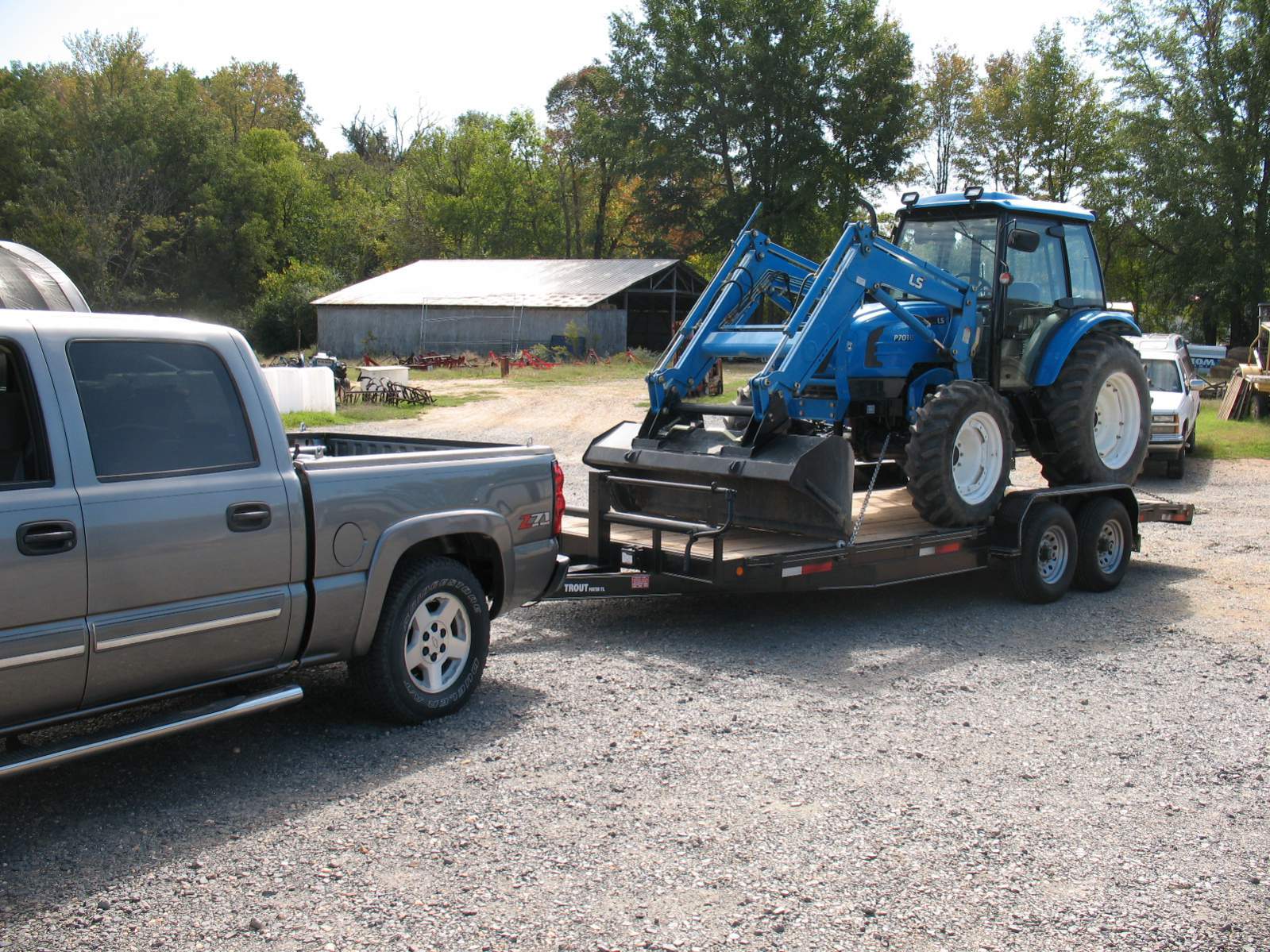

007.jpgI dont have pictures of my ramps but they are all 2x2x1/4 angle and I dont have a problem with them bending or bowing. 4000 # should be like loading a tinkertoy on a trailer with 7000# and up gross weight. The only problem I have with loading is that it picks up the rear of the truck when loading if you dont block up the trailer which I dont do, just continue to drive up the ramps and it eventually comes to earth but ramps dont bow and this tractor weighs in excess of 8500#. My only complaint is that when loading the B26TLB the back hoe drags a bit so the ramps could be a bit longer.

My ramps are the same.
I would block it up. There have been a few guys get killed or seriously injured doing what you do. The rear tires come up and now PARK and the parking brake are worthless. One guy on this site banged up his tractor, trailer, and F250 doing just this. He ended up with only a broken arm.
Be careful.
Chris
/ Hauling tractor with a car trailer? #67
Be careful.
Chris
That's true...I put my previous 8N with FEL and loaded tires on a car trailer to take to the new house and once the front tires made it to the deck, my truck lifted off the ground and moved 2' sideways...Thankfully it was on level ground and no damage happened...I blocked the trailer after that.
/ Hauling tractor with a car trailer? #68
View attachment 296384I dont have pictures of my ramps but they are all 2x2x1/4 angle and I dont have a problem with them bending or bowing. 4000 # should be like loading a tinkertoy on a trailer with 7000# and up gross weight. The only problem I have with loading is that it picks up the rear of the truck when loading if you dont block up the trailer which I dont do, just continue to drive up the ramps and it eventually comes to earth but ramps dont bow and this tractor weighs in excess of 8500#. My only complaint is that when loading the B26TLB the back hoe drags a bit so the ramps could be a bit longer.

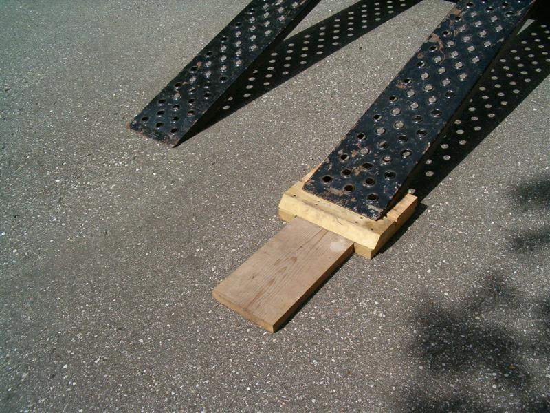

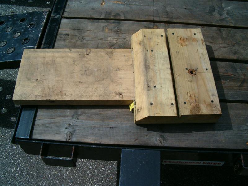

My TLB manages to drag a bit also but I made some wood plates that space the bottom of the ramp up 3" lowering the angle. That took care of the drag. So far as lifting the front of the truck I always try and prevent that by slipping in a couple of jack stands beneath rear frame of trailer and I even chock the front of tires to keep from pushing the rig ahead as I load the trailer.

/ Hauling tractor with a car trailer? #69
now I see why his ramps bend. I wouldn't load anything latrger than a scut or rider mower with them.
I use heavy 2" angle for most of my ramps.. my '3rd' ramp for my trikes is 3" angle, as it gets a huge portion of the tractor weight till the rears get to the other ramps
i think that wood block arangement will be dangerous. at least the way it is mocked up.
solid timber cribbing.. maybee.. beter ramps.. deffinately.
my life is worth way to much to use 'just barely-maybee' ramps loading LARGE pieces of iron...
/ Hauling tractor with a car trailer? #71
Be careful.
Chris
May be a bit dangerous but only if on a incline, otherwise it just kicks up a bit and then once the front wheels hit the trailer a bit, it settles back down. How in heck would loading a trailer cause the truck to just sideways 2 feet unless you had the wheels turned or your trailer jackknifed which is a big NO NO in all cases. I park mine straight in line with the trailer and front tires straight. I have a raised road bed out to my shop that I like to park the rear of the trailer up against it. It allows for less angle on the ramps and the frame of the trailer is only a few inches off the ground so it doesnt lift the truck wheels up off the ground before the tractor gets on the trailer. On flat ground the truck will skid forward a bit if someone isnt holding the brake pedal but nothing dangerous to do in my mind at least. I always use 4 wd on the tractor so it climbs up the ramps on its own.
Chocking the front would be good, but if I am going to carry around a bunch of loose material, I will just carry some jack stands to put under the trailer frame. I have been thinking that maybe I can design some support stand that will fold under the trailer and pin up after loading. That would avoid piling in a bunch of loose stuff in the truck. I think that would be pretty easy to build and install on the trailer.
