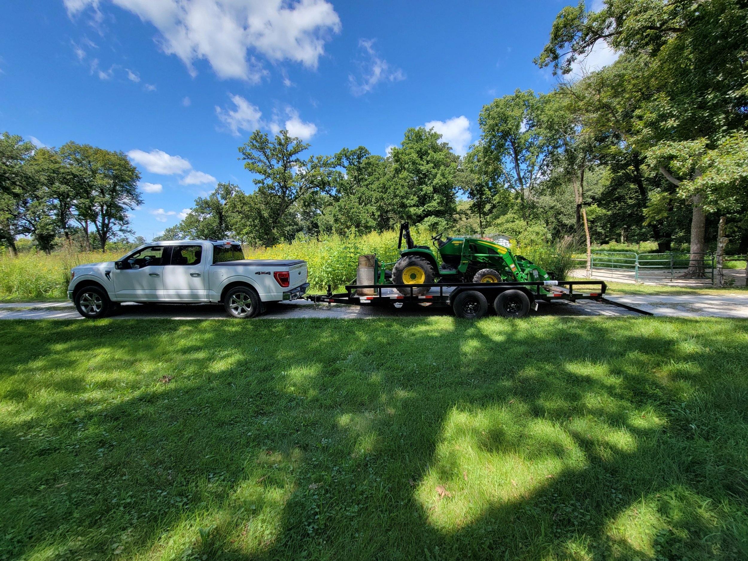

dieselscout, Your rig must be quite a bit longer than my 16 ft long outfit is. I put it on the trailer and discovered that I have more room than I expected. When I want to travel with mower, I may put that under the bucket and lift it into the trailer with the FEL while backing up the ramp. But for sure, there is quite a bit of room to jockey around. I'm am glad (so far) that I did not buy the 20 ft. rig. Ill post a pick in a minute.
I think I'll use a combination of chains and straps for holding things down.
With the block up against the front of the trailer, I have way too much tongue weight, so I would move back on the trailer somewhere.
I think your picture proves my point.
If you had a 5’ rotary cutter on your 3 point your grapple would be at or beyond the end of the trailer.
The result is you would have no way to adjust the load (forward or backward) in order to get the tongue weight needed.
I have at least 2 options. First, drive on forwards and put the bucket over the rail on the tongue. Second drive on backwards with the mower suspended from the FEL. The latter, I am 90% certain will work.

Looking at your picture the trailer might be a little nose heavy but I’m guessing. I think 18 feet is going to serve you well. Nice looking rig.

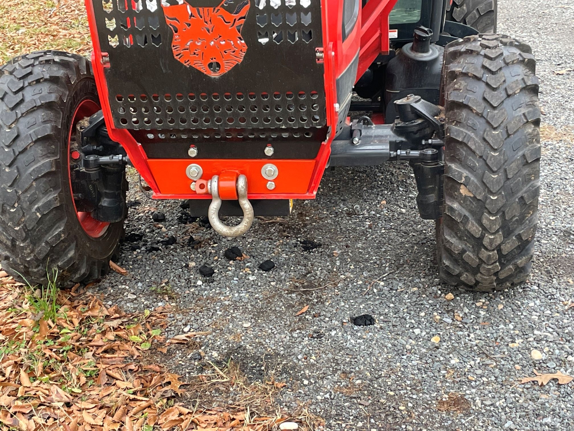

I hate strapping down my tractor, especially the front. I usually end up routing the straps over the front tube of the FEL, and then attaching to the front weight bar on the tractor, but it's hokey. I seem to remember reading somewhere that strapping to the front axle was a bad idea, but can't remember if that was in the manual or just someone on a forum. I really wish Deere had given us some hooks or eyes to attach to in the front.
Rear, I go to the axle or loops either side of drawbar, center rear. But since my tractor is towed backwards, rear straps aren't having to handle the hold-back under braking that the front straps see.
You could add a plate and shackle like I did to my Kioti, or weld some hooks to the grill guard / weight bracket.
That's exactly what I do, as I have the same tractor (same chassis, 6 fewer horses) and the same size trailer. I have indeed transported my tractor with brush cutter, and getting the weight balanced was not impossible, but did probably take me a few tries of configuration to get it right. That was a few years back, and I've hauled it in enough other configurations now that I don't remember exactly what I did.
I can say I almost never use my brush cutter and FEL together, so I may have left the bucket or even entire FEL at home. In other cases, I've been known to drop the bucket way up at the front of the trailer, and then back the rest of the rig on after. Another option you already named is to put the brush cutter under the FEL, which especially if you're dropping the bucket up front, can be done pretty easily and safely.
All of this is kind of a PITA, as I think I already said in my first post in this thread, but it works perfectly fine and is the compromise you make for the convenience of towing a smaller trailer in tight spaces. Everything is a trade-off, and the right trailer for one guy is not always the right one for the next, even when hauling the same equipment, depending on frequency and variability of configurations.
