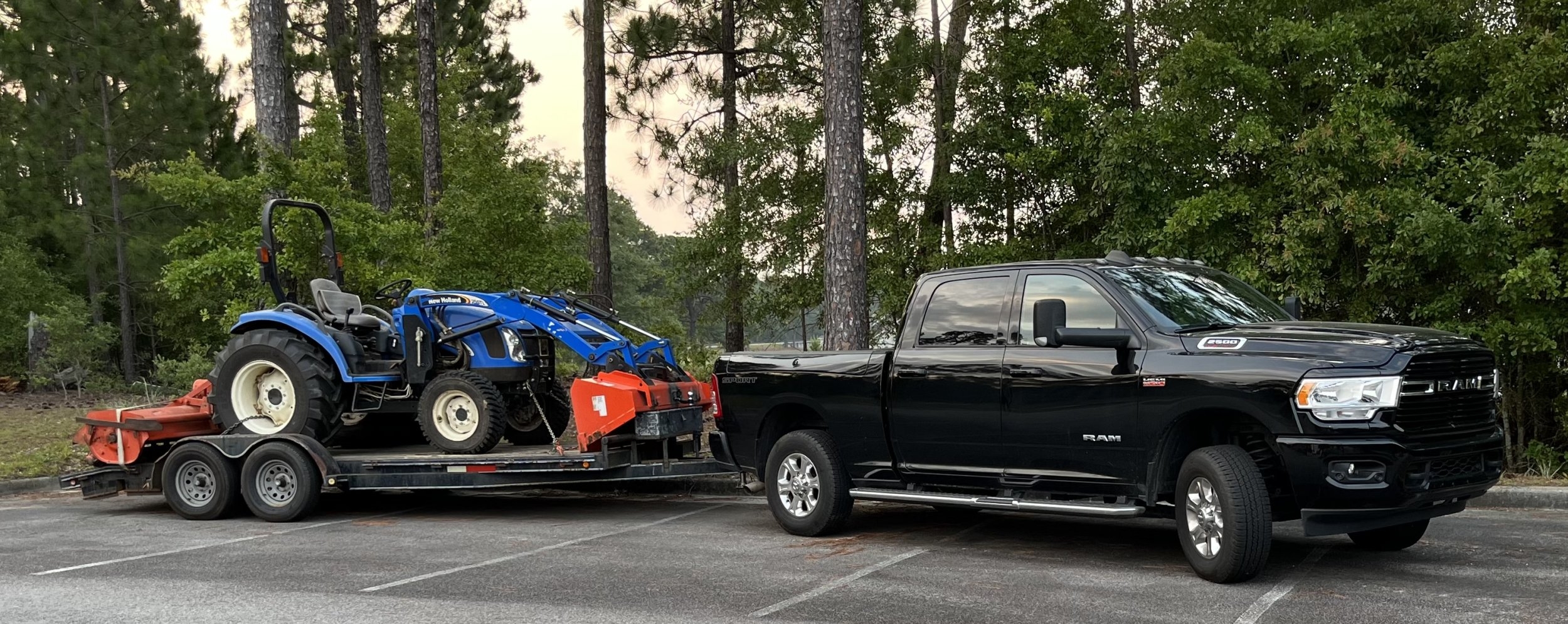

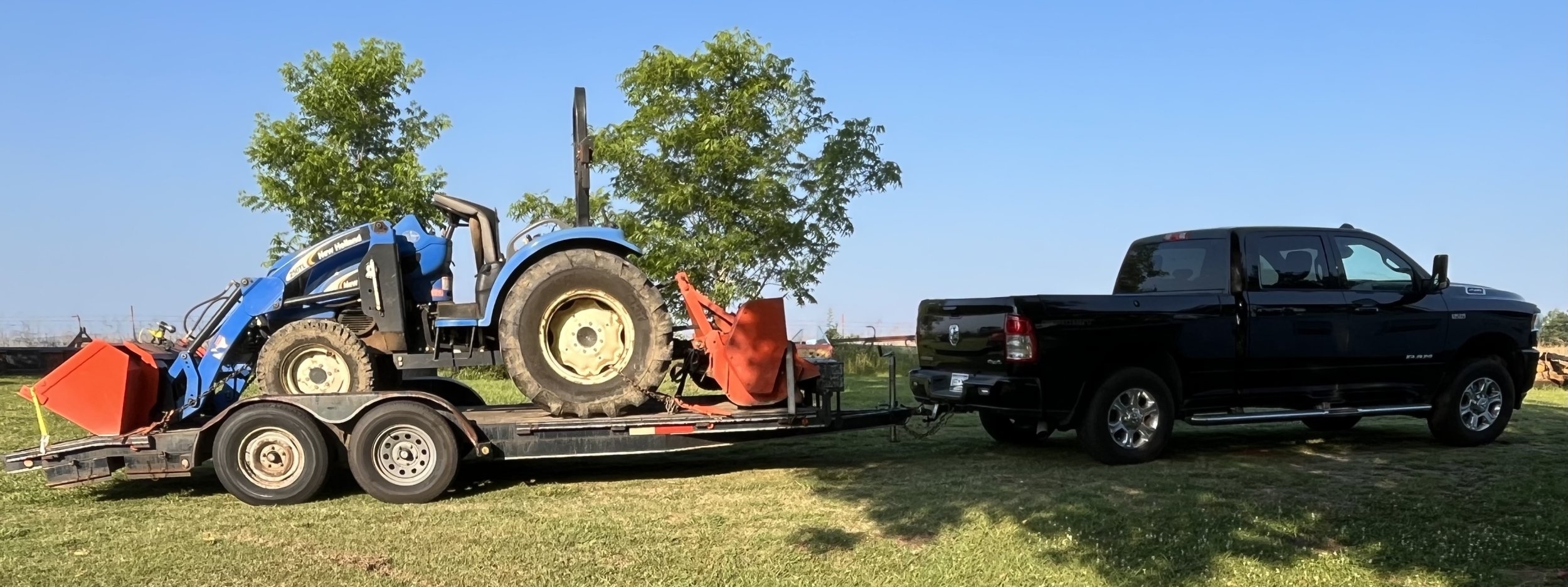

If you moving your tractor it needs implements to work with, so you need an even longer trailer.
I have a 18’ trailer and it is too short. I would like to get a 22’ trailer with at least 5200 pound (= 10k trailer) axles at a minimum, 6k or 7k pound axles would be better.
I have a 74” flail mower that is much shorter than 6’ bush hog and tractor is a New Holland TC45DA.
As you can see there’s little to no room to adjust the load and no room for a longer implement.
