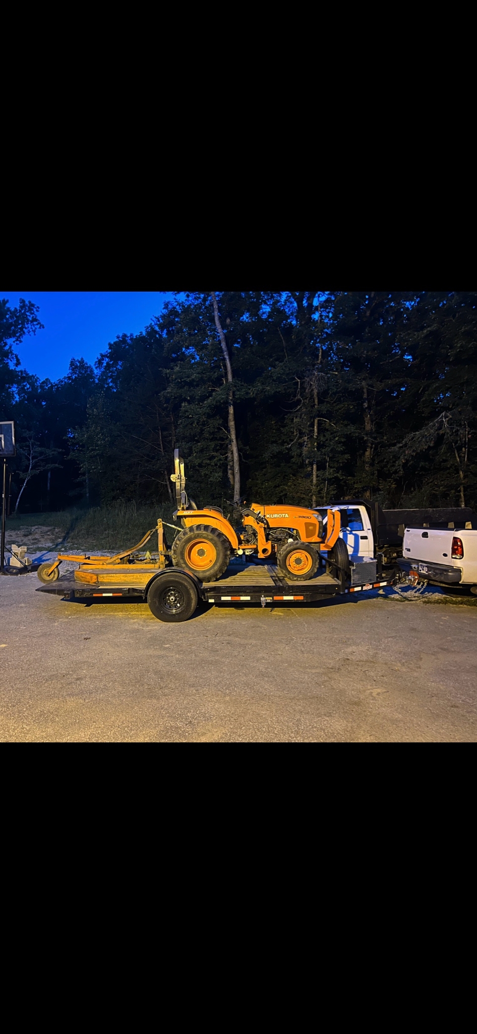

Single Axle with 10’ rails fit my BX23 perfect.
I wish I could find the pictures of this same trailer hauling Shelby Cobras and GT40’s back in the day…
Shelby is buried a few miles from here.
/ Utility Trailer for Subcompact Tractor #22
I guess I’m the only one that has towed several thousand miles my BX23 TLB on 10’ rail trailer?
The bucket sits nicely and secure on the tongue A frame and the backhoe is pinned both vertical and side to side.
I also have a 16’ enclosed trailer plus my 18’ 12k PJ dove tail…
I chose the smaller trailer so as to not haul another ton of trailer and inflict wheel scrub on the tandem trailer axles…
The PJ handles my JD 350C dozer with ease.
Also have a box trailer from my Craftsman Mower and. Dump Trailer that hauled the Kubota RTV900…
Can’t have to many trailers!

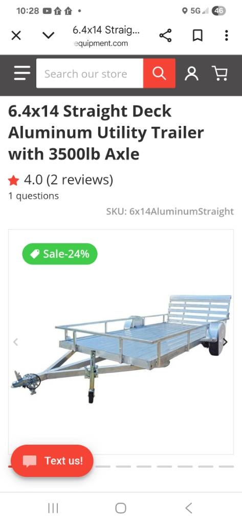

Just to clarify, the OP is wanting:
to tow a 2000# package
and spend like $2000, but able to go to maybe $3000
Although a 7x18, 9990# trailer is a good trailer, it in no way is a good match for his specific case. That trailer will weigh twice his package weight... And it becomes a burden as a general, light, Utility trailer, with his jeep.
While this trailer would "technically" work, although over budget; i dont like the safety margin... I'm also not a fan of aluminum trailers; too hard to repair; but for people in a salt environment, they might be great.
Steel, min width, 6', but I would prefer 6'4", just because; min 14', but 16' is better; 2 front tie downs, 2 rear tie downs; mesh ramp-gate; the ability to remove/lay forward/flat is nice; 2 axles, 3500# each, with atleast 1 set of brakes. Believe it or not, a wood deck is easier to load/unload/walk on, then metal, and should be cheaper, normal, 15 or maybe 16" wheels, painted steel is fine. Avoid 14/14.5/16.5" wheels. A spare is nice, but you can pick up a bolt on spare bracket and a spare wheel-tire after the fact
Used is fine; but consider the cost for 4 tires, lights, deck, and many used ones stop being the "deal" they look like.View attachment 3651589

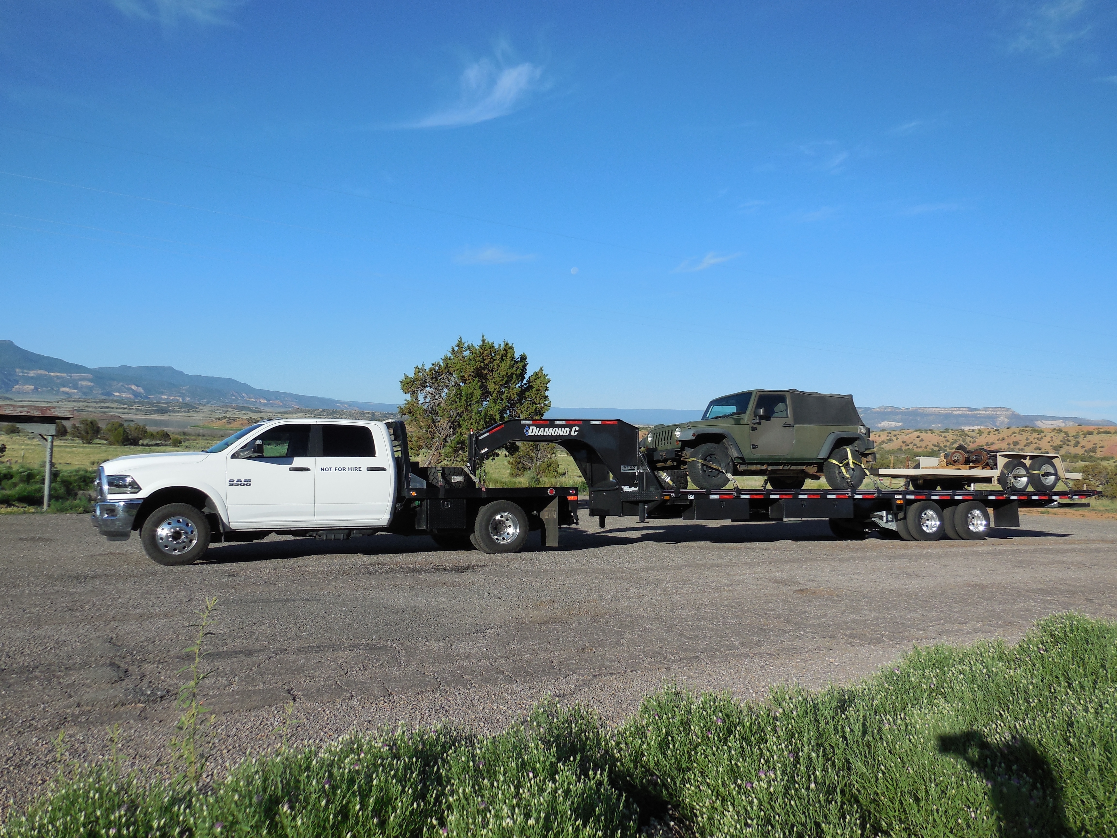

That Ram 3500 is the only thing I tow with, even if it's only five empty 325 gallon totes.
So far it has never been "too much tow vehicle". But it is marginal with 25K behind it.

This is what I tried to upload above; 6.4 ft x 14ft, aluminum, 3500# axle; and the trailer is Light. This would do what the OP needs, it's just kinda closer than I would choose to purchase for the task.

This is what I tried to upload above; 6.4 ft x 14ft, aluminum, 3500# axle; and the trailer is Light. This would do what the OP needs, it's just kinda closer than I would choose to purchase for the task.View attachment 3651611
The other nice thing about choosing something small and light is that you can use the tractor to pull the trailer around the yard, when doing things like tree and shrub trimming. Then if your disposal is off-site, you can hook the trailer to your truck to haul it all to the mulch facility.
We burn most of our trimmings, but I do make at least one or two big trips to the mulch facility per year, and this is exactly how I manage it with my 7000# trailer and larger CUT. If I had a 10k# trailer, I don't think I'd want to be doing grassy hills with it on my CUT, at least without adding a brake controller to the CUT.
Another advantage of keeping the trailer light, depending on your state laws, you may not need brakes. That means you won't need to haul it to an inspection facility, leave it there three days and pay $150 for a 120 seconds inspection every year, before driving back to pick it up and haul it home. Trailer inspections are a PITA, and 3x the cost of a car inspection, at least around here.
