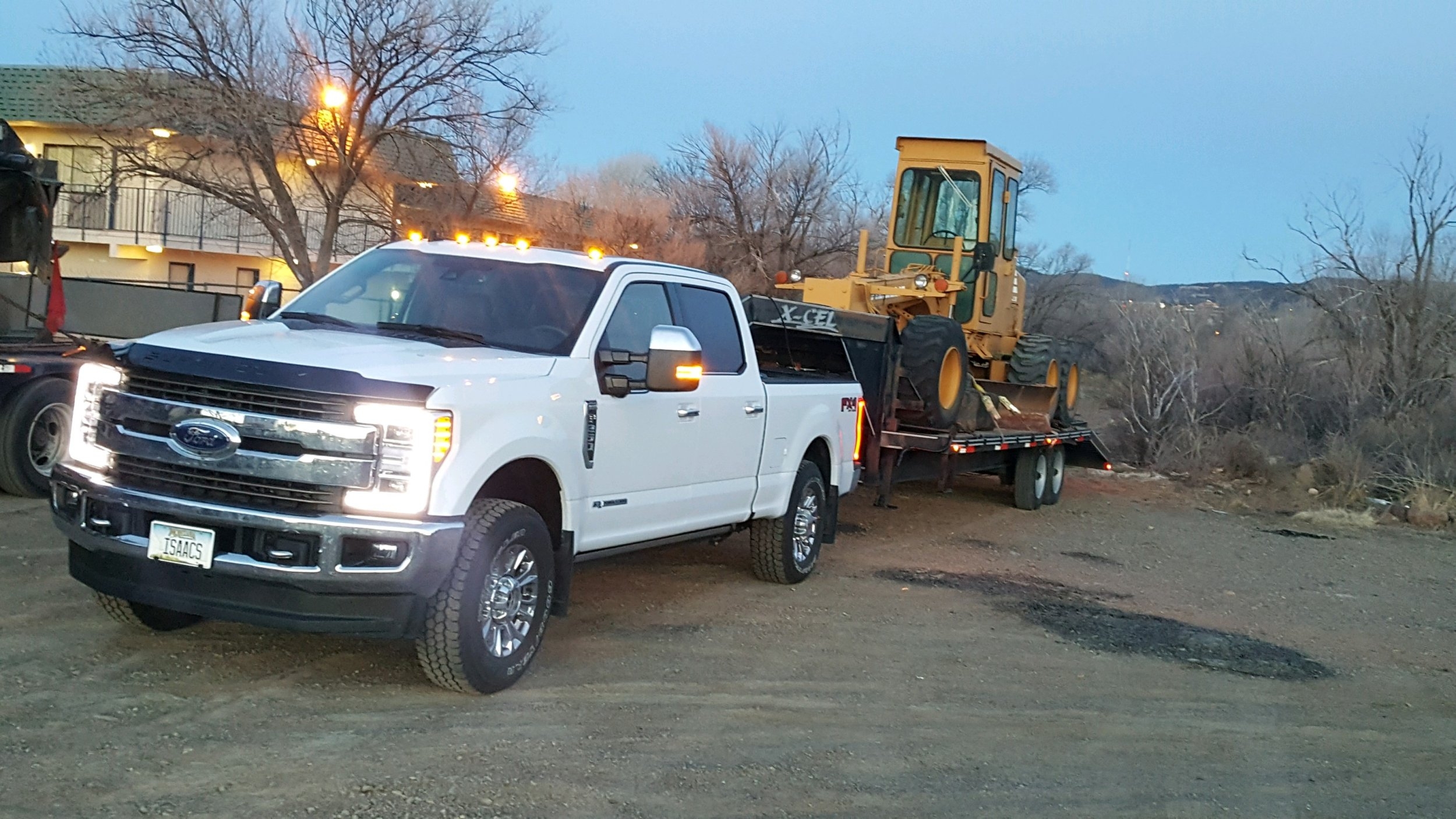

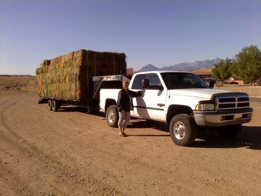

What I found with my narrow trailer, is, with a wide top heavy load, it was a little rocky. With a heavy, narrow, wheeled vehicle it was fine even tho the grader is a lot heavier than the load of hay. My wide frame trailer does have the sway control pipe so that may make a difference, so not quite apples and apples.

Did your narrower frame trailer have any sway control and what was the deck length? I've found that has more of an effect on the stability then the frame width.
View attachment 862384View attachment 862385
Did you switch to ford?
You loser LOL 😂 😂 😂
You loser LOL 😂 😂 😂
Lol, leave it to you to notice. My brothers, he is blind Ford loyal. Just bought a F-150EV:eek::unsure: for their 45th anniversary. I sold him my old trailer and the grader.
   / Trailer: dually to heavy singles, on 10k/12k axles...stability etc? #20
The old trailer was 102"x25' light weight 12" I-beam frame, 14lbs per foot I think, no sway control. 8k Spring axles.
The new trailer is 102"x28' light weight 14", engineered beam, with sway control. 8k Torsion axles.
