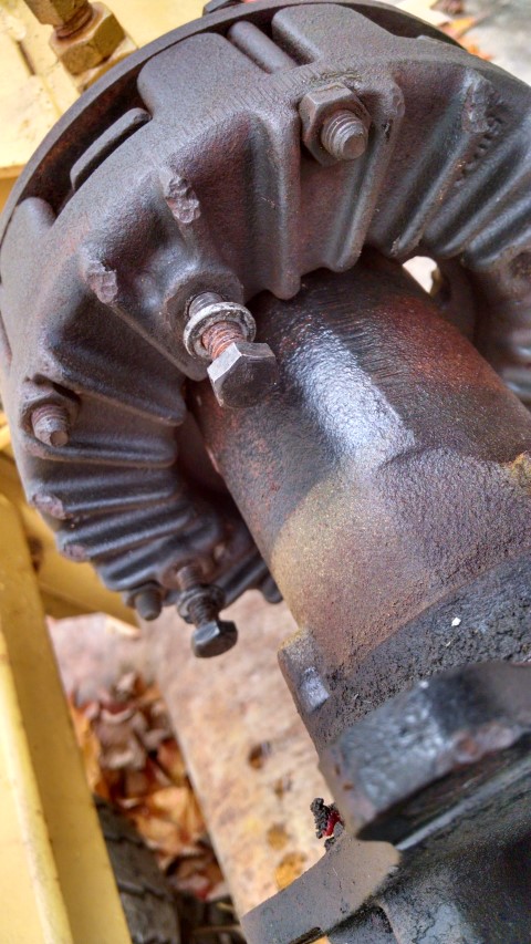

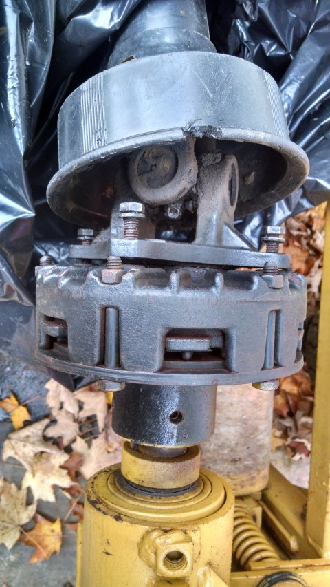

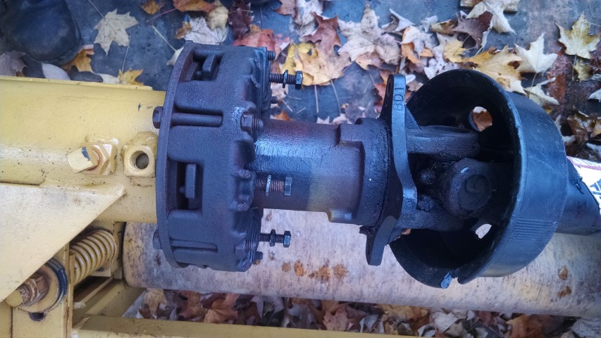

By smoking the clutch, I think he is talking about new clutches that have been coated with a protectant as it may sit out in the weather for months or years.
By loosing the nuts and springs, you release enough pressure that the clutch will spin if you bury the rake in the ground and rev up the tractor and let the varnish burn off, therefore the term smoking the clutch.
Then retighten the nuts to specs, and you are good to go.
If it is a used one, you might not have to smoke the clutch.
You could disassemble the clutch and look at the condition of the clutch pads.

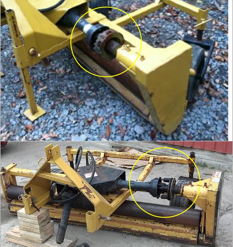

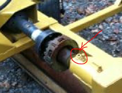

I have a question on the clutch. The top picture is the rake I have. I see the clutch is slightly different in another rake. Do they work the same way?

Here are a few pictures of the clutch assembly. Do I loosen up the bolts on the assembly then "burn" it?IMG_20141026_125704980_HDR.jpgIMG_20141026_125716890.jpgIMG_20141026_131001894.jpgIMG_20141026_131005895_HDR.jpg

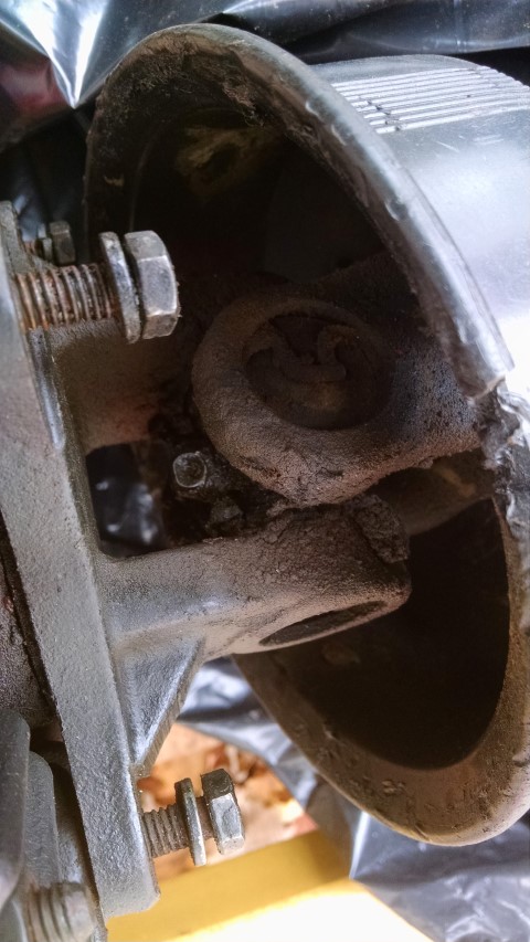

Took it completely apart and cleaned the assembly. I plan on putting a cover over the clutch to keep the weather off of it. The rake was missing the main PTO shield (I got one at TSC) and is missing the cover for the clutch assembly. The parts diagram looks like its a rectangular cover (open on the bottom) that mounts with just one bolt. Can that be right? I think it would shake and rattle with just one mounting point.
