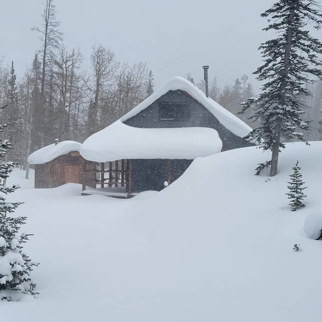

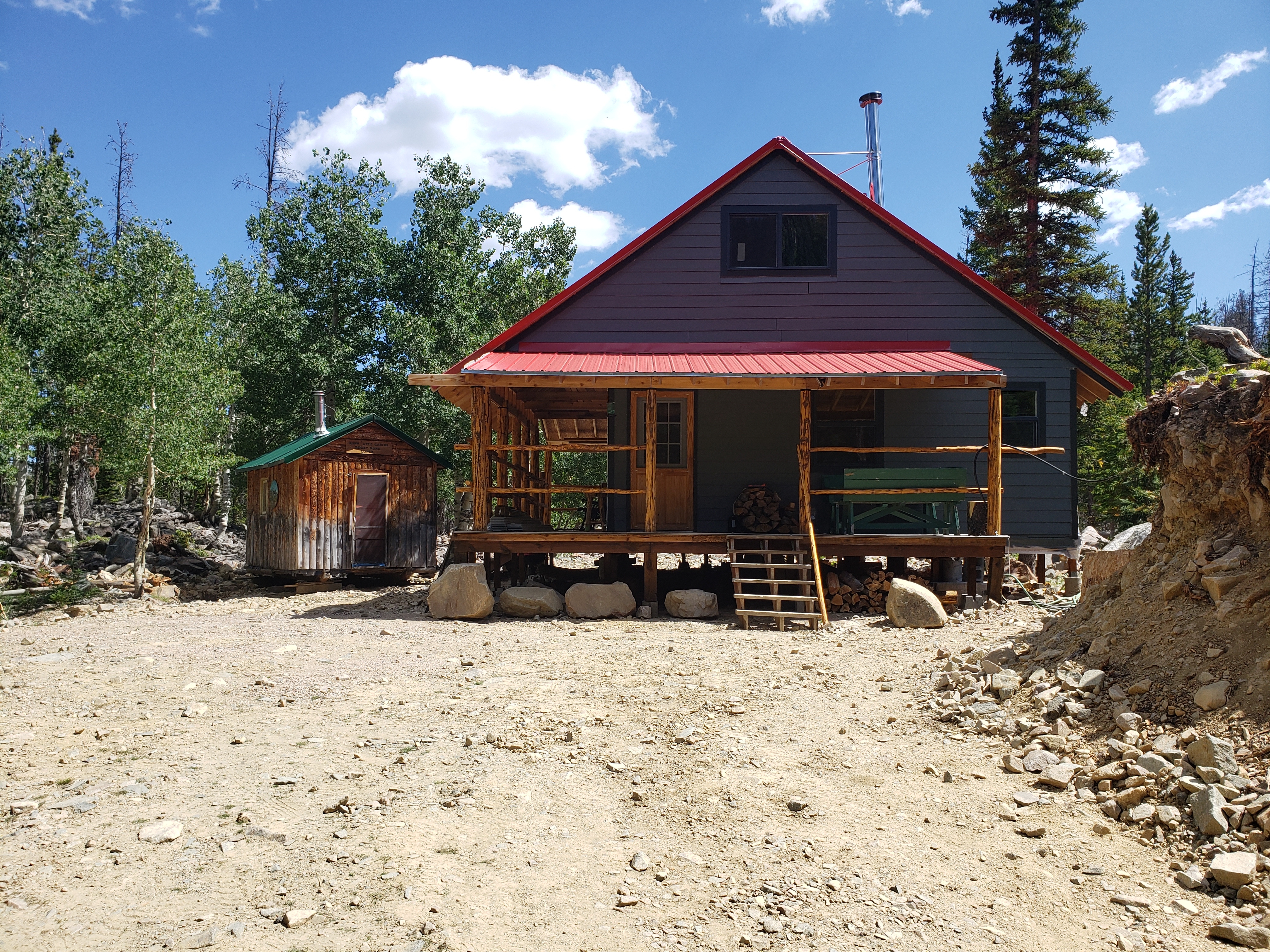

Tahoe is quite limited when it comes to trades and the competition is intense from high end builders plus the building season in the mountains is limited…
The cabin is a family cabin which I now have a minority interest…
My experience is hiring out could take longer than just rolling up my sleeves getting it done going the siding route…
Hiring a painter would be much simpler.

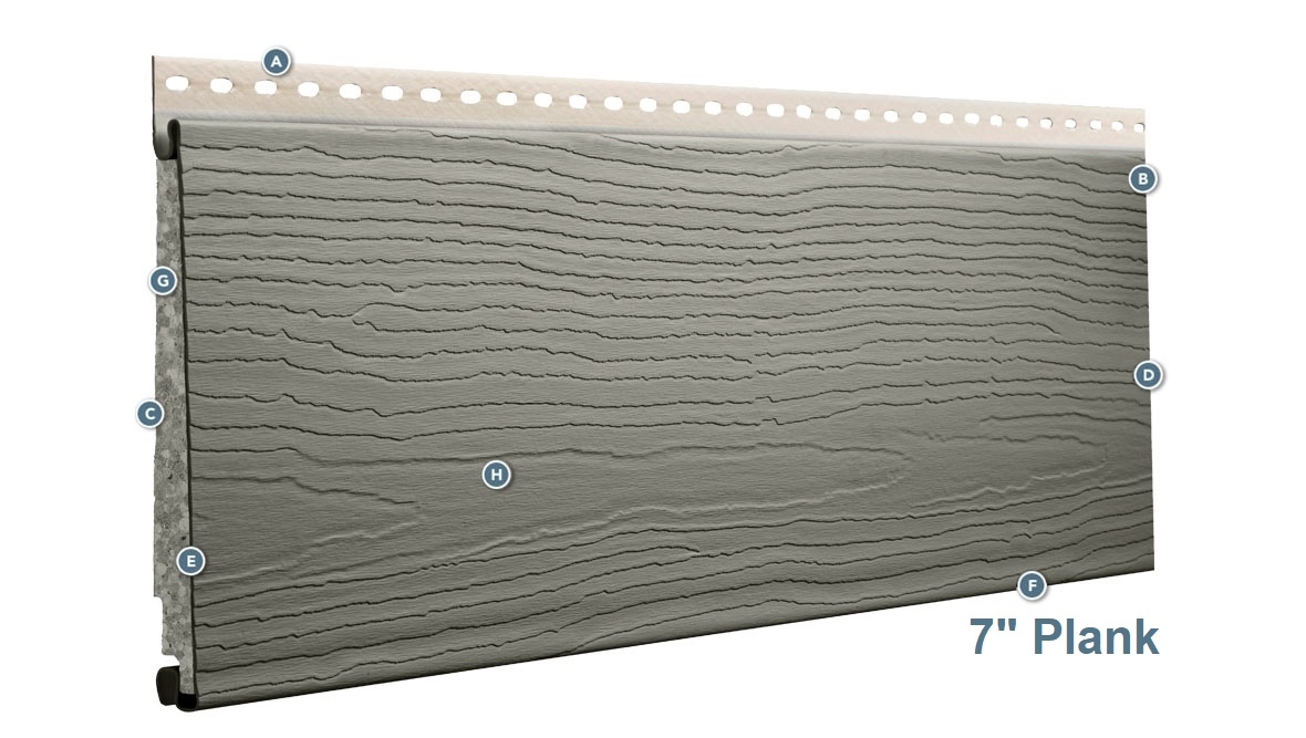

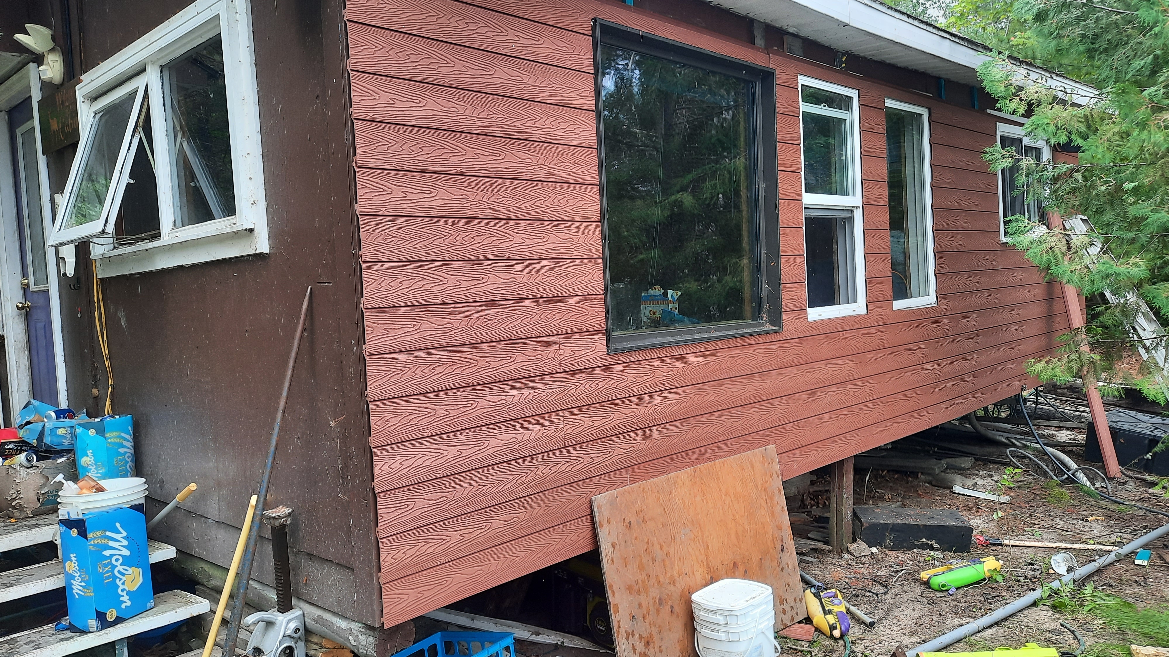

My thoughts only: Your siding looks like solid wood planks, probably at least 1/2 inch thick. If you were to rip it off you would need to replace it with some sort of wood backing, probably 1/2 inch OSB. Why rip it off to replace it with an inferior product if there is nothing wrong with it?
I would wrap it with a moisture barrier/vapor barrier-whatever is recommended for your climate and put up the Hardie.

It's DRY snow where you are, dry all summer too by the look!
That may be the difference.
The only difference between a dry snow and a wet snow is temperature.
As soon as the temperature rises, that dry snow turns wet.
Physics is unbeaten.
