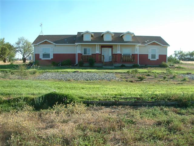

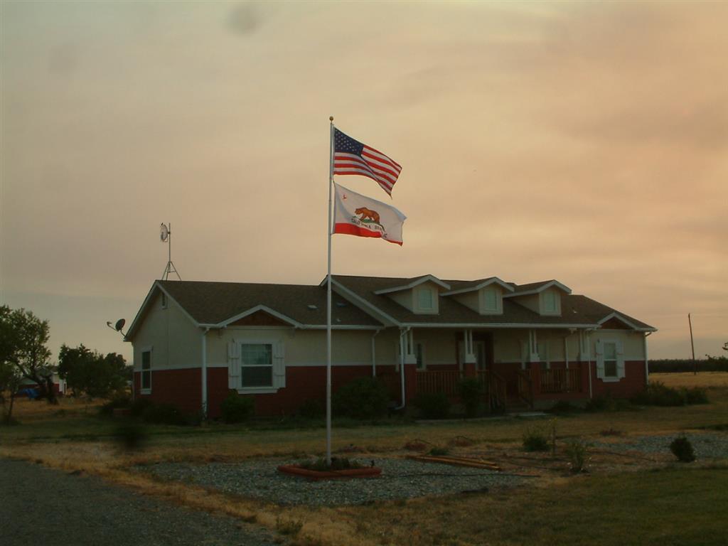

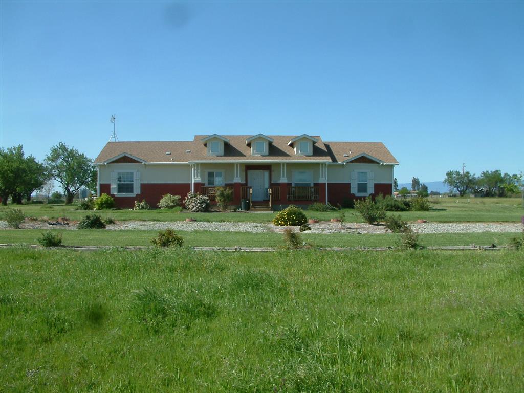

Here's the house on my 10 acre ranch built in 2005. Hardiplank on the lower part (brick red) and Hardipanel on the upper part (off white) with brilliant white trim.
Owned the place for 10 years. Repainted the trim. The off white color held up nicely. The red color is showing some fading (like all reds do) so I would have repainted it if I still owned the ranch.
Hope this helps.

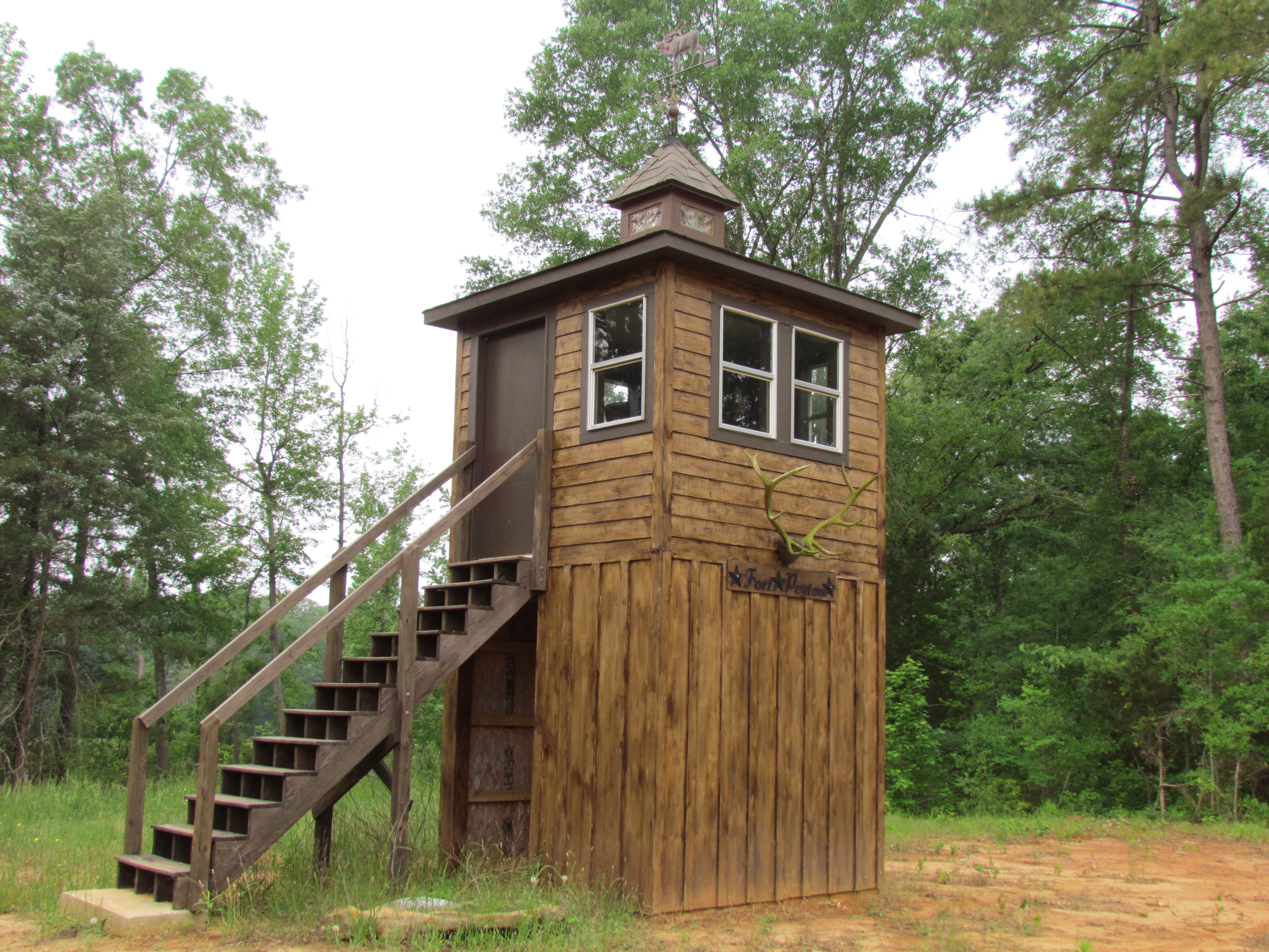

I've used the 12 inch wide Hardie siding with the 1x4 trim pieces to get the board and batten look with great success. I'm planning on doing it for the upper part of my house. Bottom story will be normal lap siding, and the eaves and second story will be vertical board and batten style.
This is my deer blind. I did the vertical Hardie on the bottom part of it maybe ten years ago? I forget exactly when I built it.

Thanks Eddie, that is exactly what I envisioned, minus the camo paint:)
How did you nail the vertical planks, did you float them, nails on one side, or just nail them down the middle?" What nails are recommended for attaching directly to 1/2 OSB? I have pneumatic staple, brad, finish and coil nail guns so I just want to know what type works best, I know the need to be stainless or dipped.
