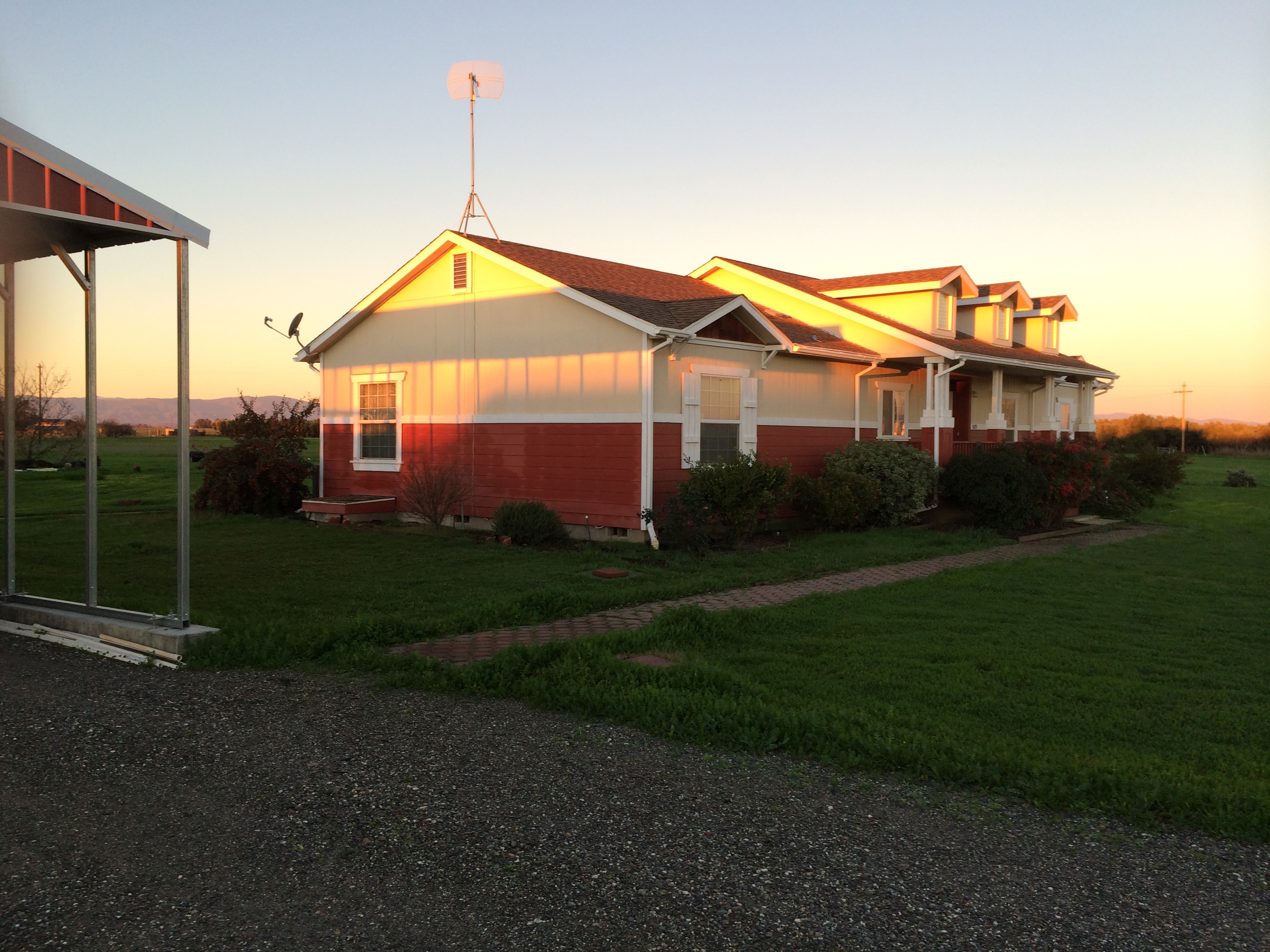

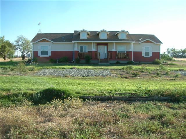

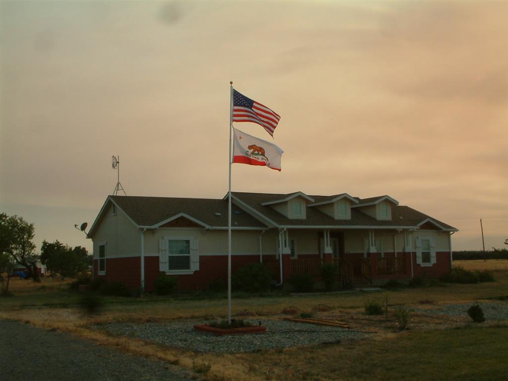

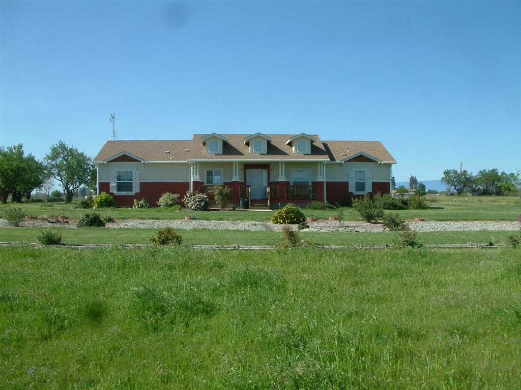

Here's the house on my 10 acre ranch built in 2005. Hardiplank on the lower part (brick red) and Hardipanel on the upper part (off white) with brilliant white trim.
Owned the place for 10 years. Repainted the trim. The off white color held up nicely. The red color is showing some fading (like all reds do) so I would have repainted it if I still owned the ranch.
Hope this helps.

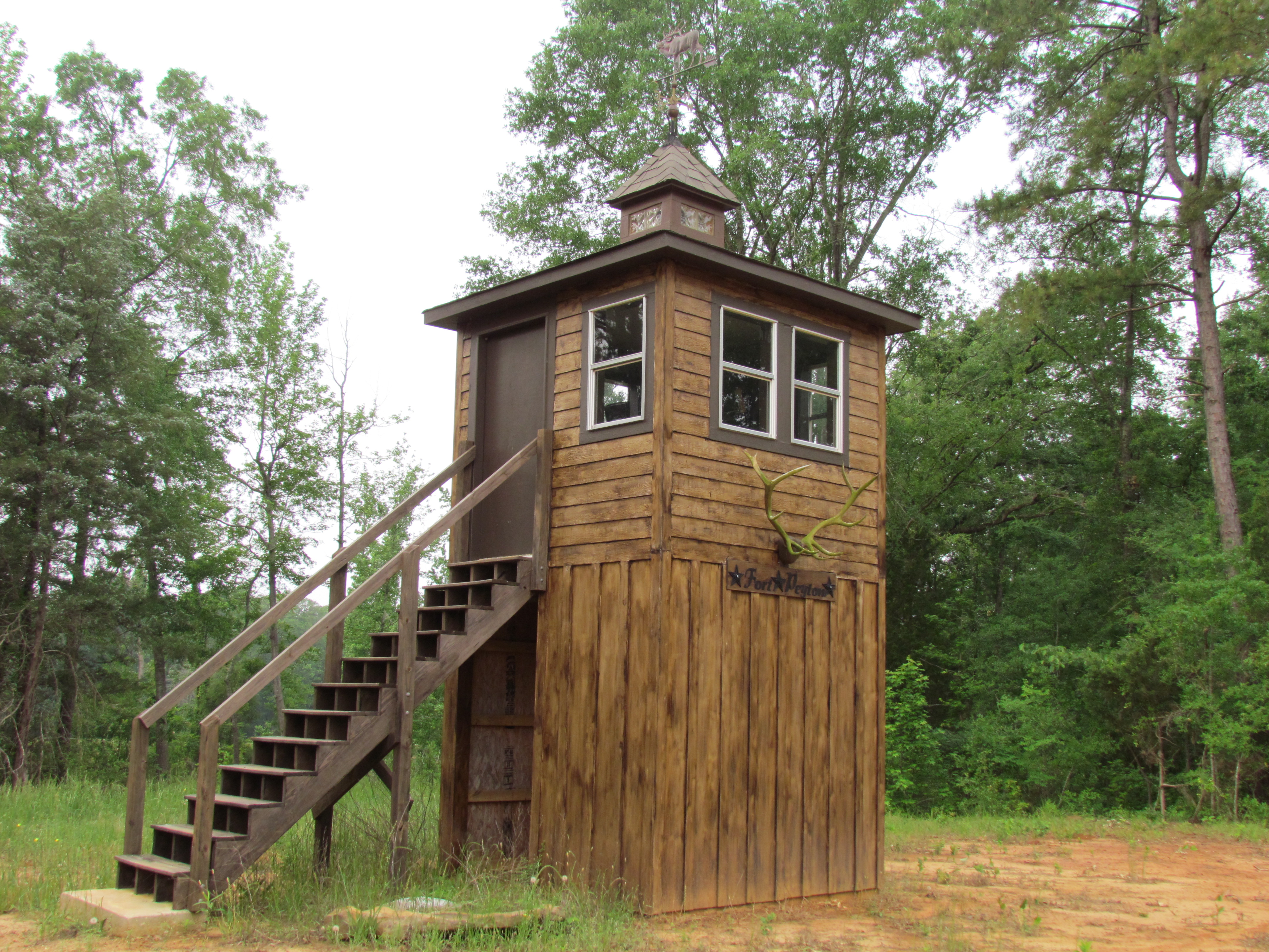

This is my deer blind. I did the vertical Hardie on the bottom part of it maybe ten years ago? I forget exactly when I built it.
Thanks Eddie, that is exactly what I envisioned, minus the camo paint:)
