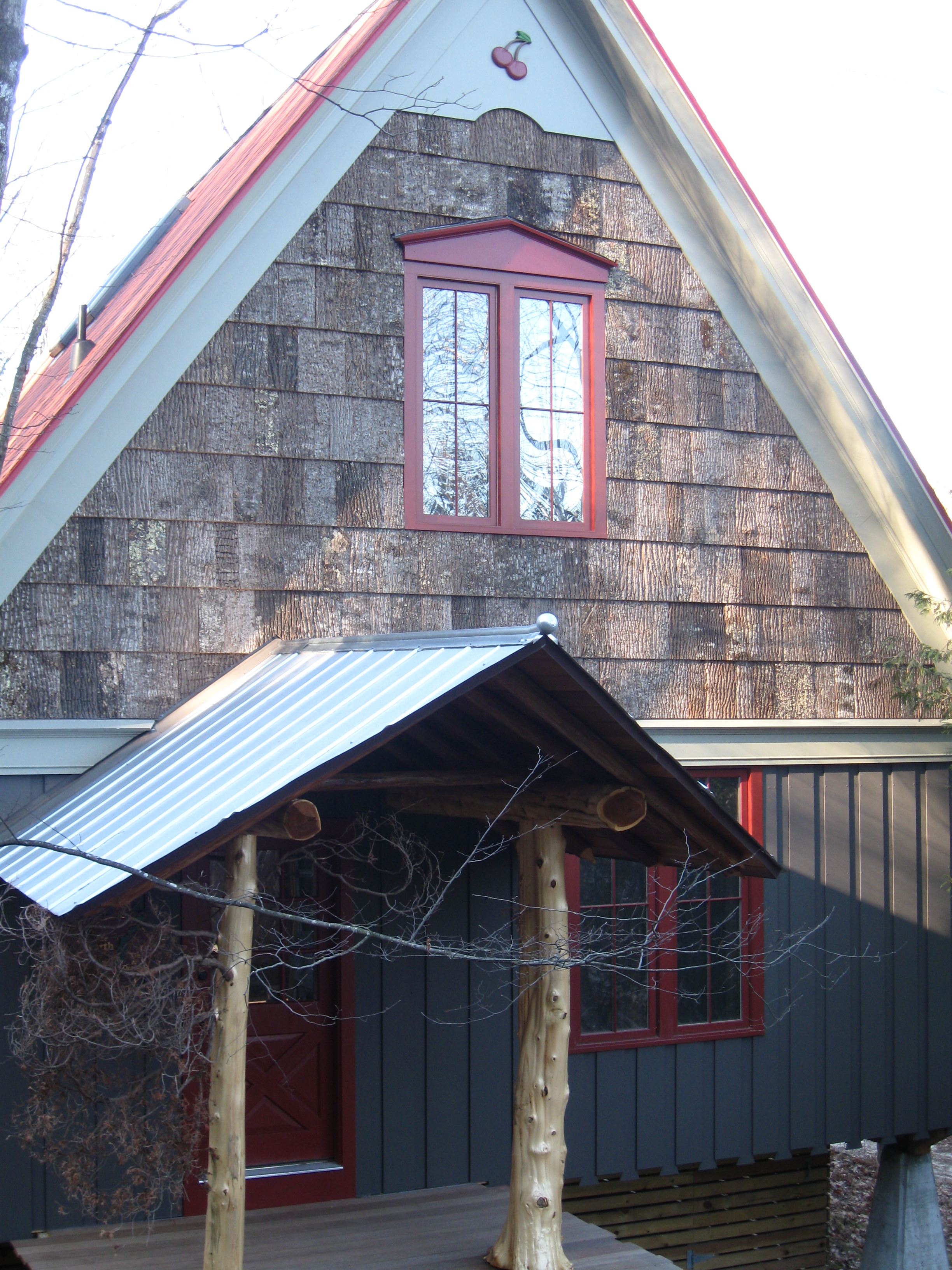

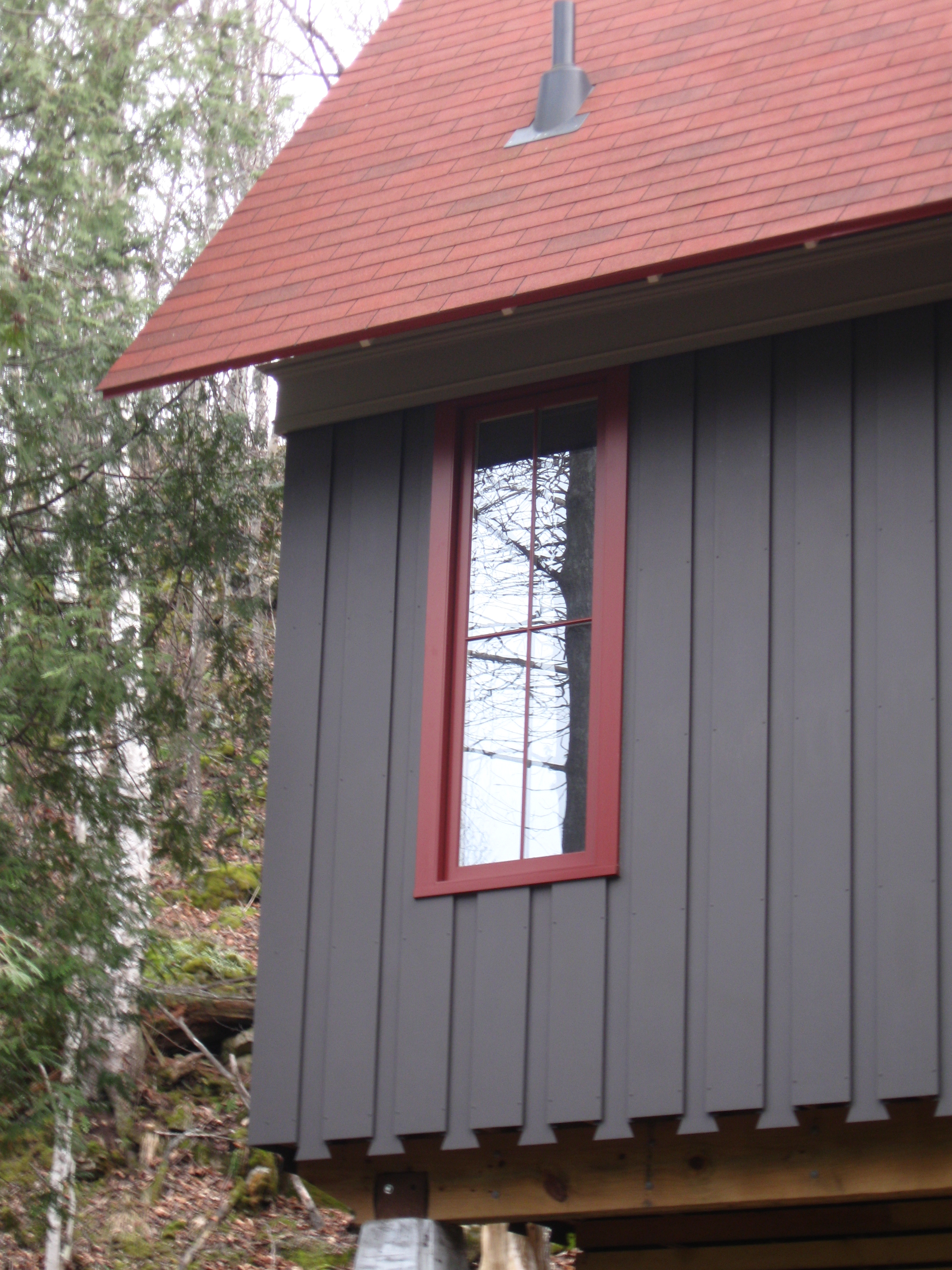

The big problem with Hardie is that the edge profile is rounded and they have their name pressed into the top edge. When spacing your panels you'll need to make sure the batten covers the name. I would suggest nailing both edges and then nailing the batten using a Maze nail through the gap. Check the instructions because I'm not certain if you'll need to hit framing when using a roofing gun to fasten both edges. Otherwise, you can always screw the siding on. I've seen break-out issues when using counter sinking screws so I used a flat head screw on my project. I used GRK #8x2" cabinet screws set in a 1/4" predrilled hole for the pictured project. The screws are exposed, but they're not very noticeable. With a wood batten, they could be totally concealed behind the batten. The pictured job used a Certainteed siding which is thinner, smoother than Hardie and also has a square edge. Because of curing problems, the product is no longer available. I was aware of the Certainteed problems when I installed the siding which is why the over sized hole was used.
