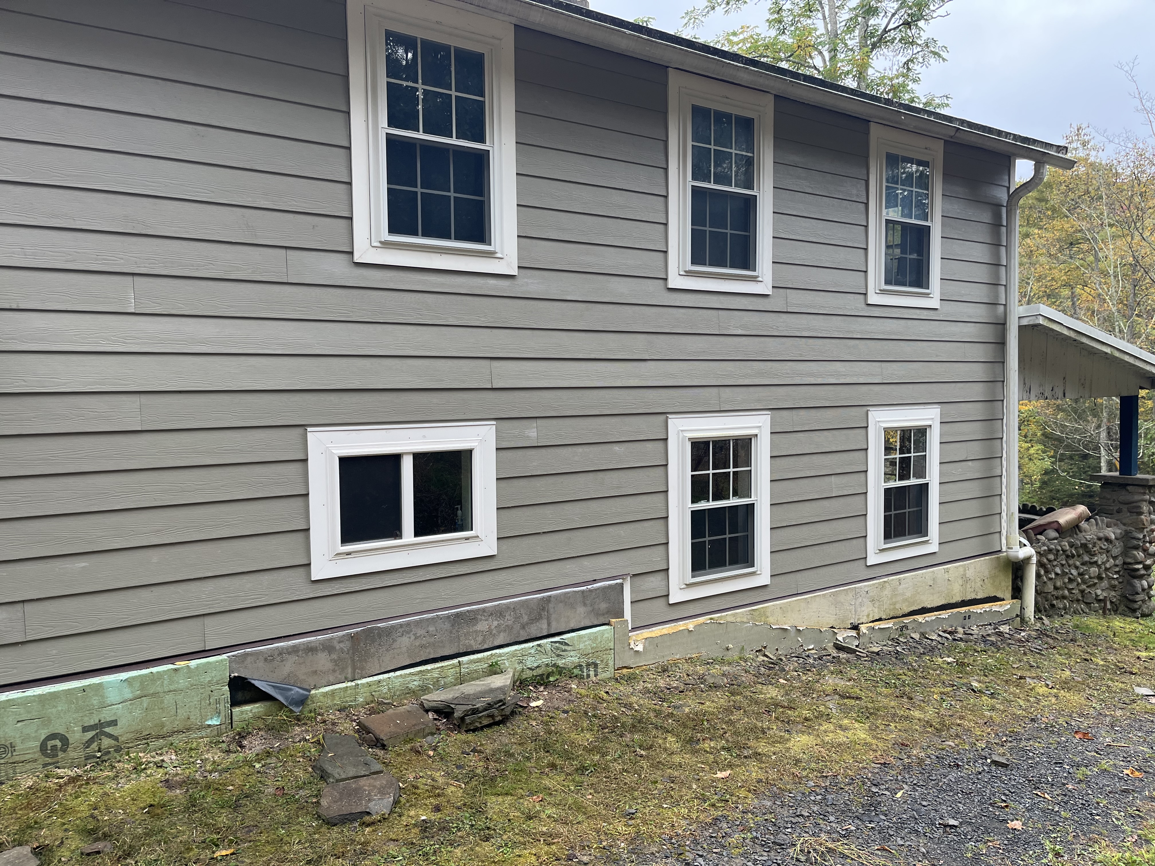

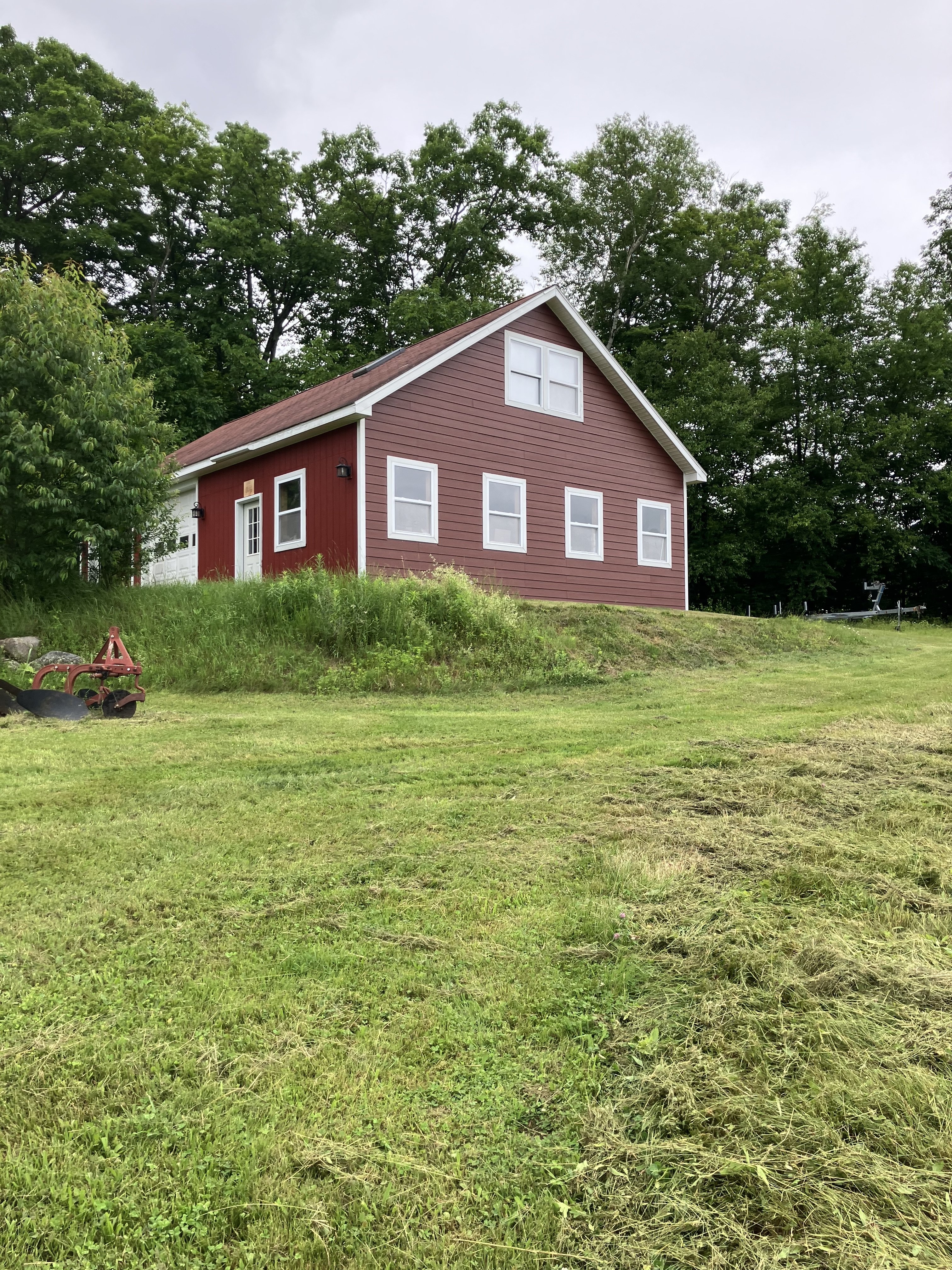

Hardy board does not hold up in S. Vermont snow country.
I put in on my cabin, in deep snow country. It seems to be doing just fine.
